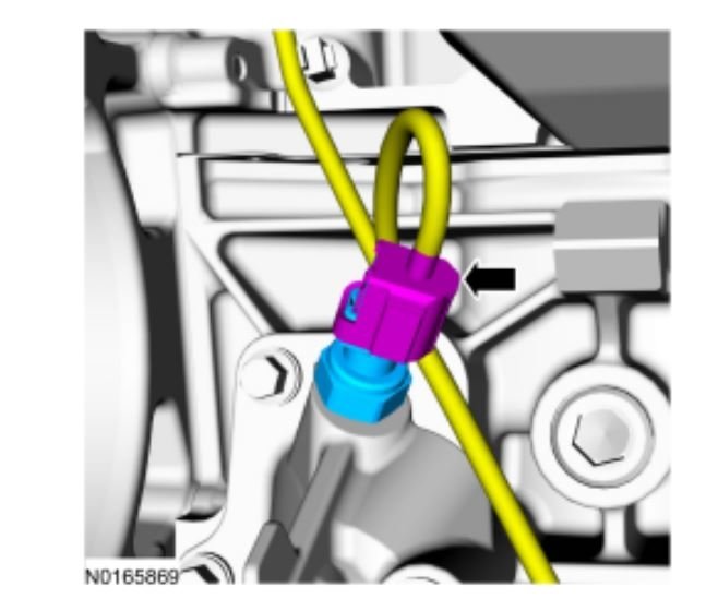

You can do the test yourself but if you never did this. it would be better to have a shop perform it.
You need to remove the oil pressure sensor and install the manual gauge.
Engine Oil Pressure (EOP) Switch
Material
Item Specification
Motorcraft® Thread Sealant with PTFE
TA-24-B WSK-M2G350-A2
Removal
4x2 vehicles
With the vehicle in NEUTRAL, position it on a hoist. Refer to Section 100-02 .
4x4 vehicles
Remove the generator. Refer to Section 414-00 .
All vehicles
Disconnect the EOP switch electrical connector.
Remove the EOP switch.
Installation
All vehicles
NOTE: If the oil pressure switch is to be reused, apply thread sealant.
Install the EOP switch.
Tighten in 2 stages.
Stage 1: Tighten to 14 Nm (124 lb-in).
Stage 2: Tighten an additional 180 degrees.
Connect the EOP switch electrical connector.
4x4 vehicles
Install the generator. Refer to Section 414-00 .

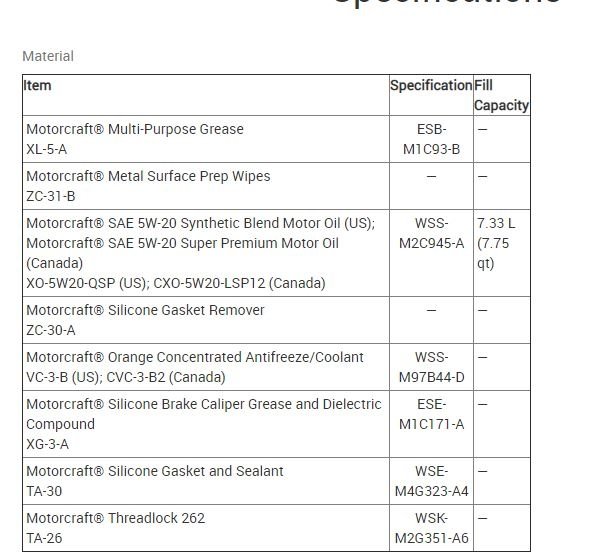

This is different topic but what’s the best oil for my truck? I used blend before but what's the best for these engines with 100,000 miles?
Jan 12, 2021 at 8:00 AM
I attached the recommendation below. No additives of any kind.
Jan 12, 2021 at 8:14 AM
NICKNOCELLA22
  • 35 POSTS
Do I need to use Motorcraft?
Jan 12, 2021 at 4:17 PM
NICKNOCELLA22
  • 35 POSTS
I read that Marvel Mystery Oil helps clean everything, but I can’t find that oil around any stores by me. so like what brand is good besides that Mobil or Castrol or something? can I use full synthetic or no?
Jan 12, 2021 at 4:18 PM
I would use the Mobil one fully synthetic for maximum protection.
Again, no, forget about the Marvel oil. It does nothing for you. The oil has all the additives you need.

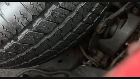

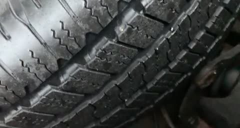

Also every time I drive and turn it feels like the tire shakes. I try to look at it but I can’t clearly see it but when I drive something on the front feels like it out of align.
Jan 13, 2021 at 5:27 AM
One thing at a time. Let us see what the issue is with the engine.
