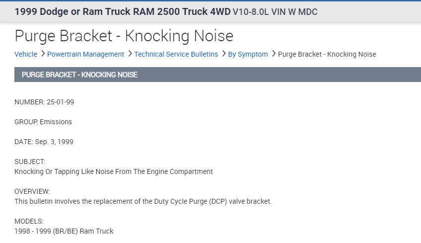

When you hear it, is there anything as far as throttle pressure that can change it or stop it from knocking? At 100,000, there shouldn't be bearing issues unless it has had a hard life, or the oil wasn't changed on a regular basis. Also, are you using the correct oil weight?

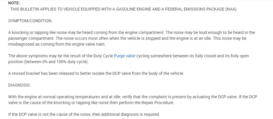

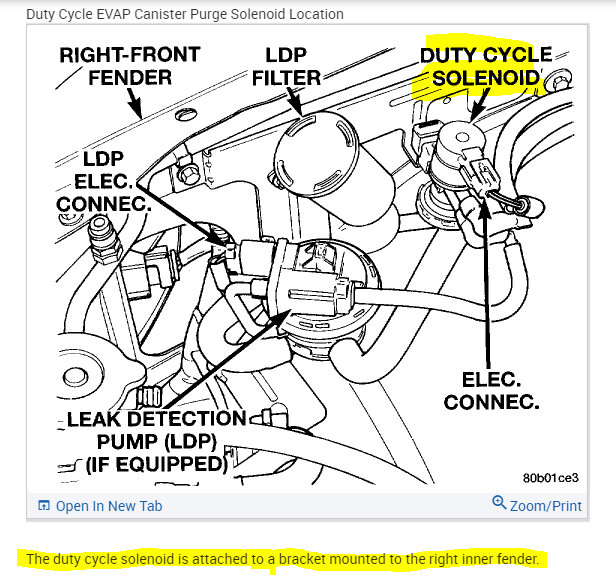

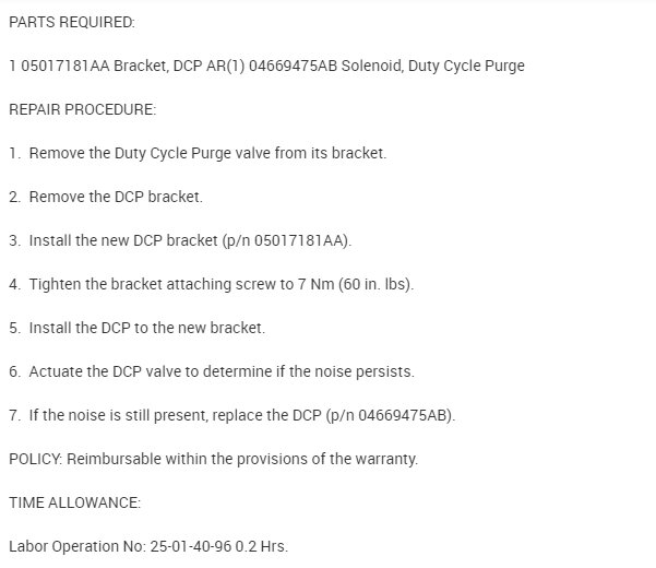

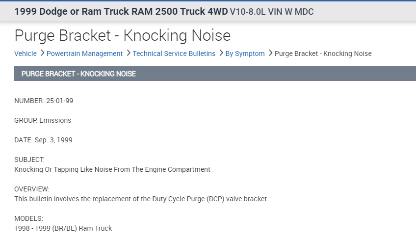

Now, I did a little research on this and found a technical service bulletin (TSB) related to a knocking noise that is misdiagnosed as an engine knock. Instead of the engine, the Duty Cycle EVAP Canister Purge Solenoid bracket makes a knocking sound.
Take a look through the TSB below. The last pic I attached is the part's location.
Let me know what you find.

Were you able to review the technical service bulletin I attached above to confirm that this isn't the issue? Also, is it loud enough to record and upload for me to hear?

Yes, I couldn’t find anything noticeable.

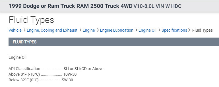

Why does it make the noise before starting? You indicated it is building fuel pressure. In 40 years of working on these vehicles, I've never heard such a thing. Are you sure we aren't getting fuel into the engine oil due to a fuel pressure issue? That could thin the oil.
Also, I don't know what the temperatures are where you are located, but what oil weight are you using? See pic below.
Aug 7, 2023 at 6:38 AM
STUBBORNLY
  • 7 POSTS
The distance definitely complicates things.
The noise before starting is fuel pressure building If I bump the starter three times it will build good fuel pressure and push any air out then it starts easy. The fuel in-line check valve is stuck open and will not hold fuel rail pressure.
I’m in western Oklahoma.
Temperature doesn’t change the noise.
I’ve always used Rotella 15-40 in my engines. Had good luck so far. This started a little while after the oil pressure sensor broke off going down interstate and lost all the oil.

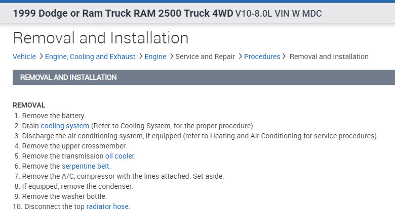

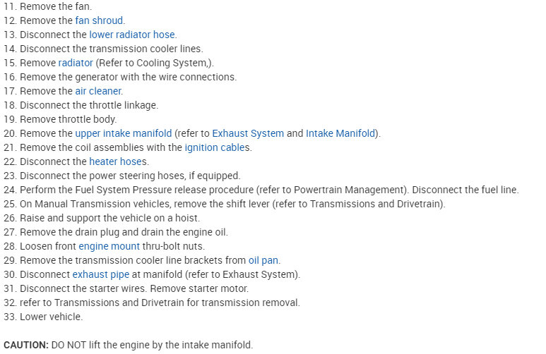

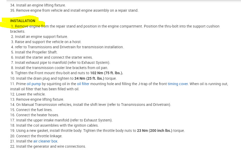

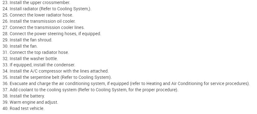

Aug 8, 2023 at 10:35 AM
  • 110,241 POSTS

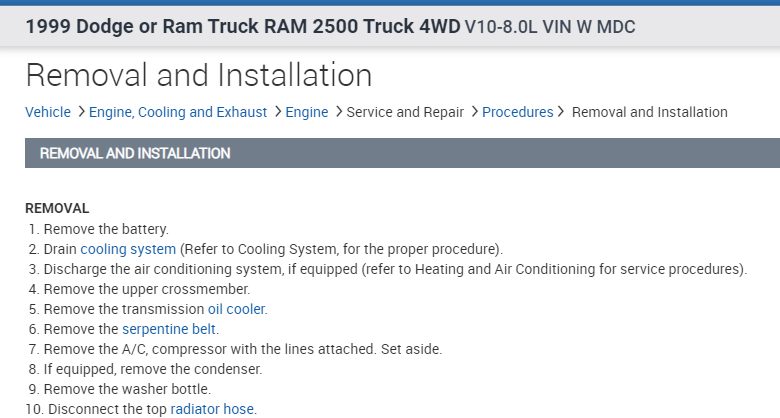

If you plan to remove it, I attached the directions below. Normally, the manual provides pics to go along with the directions, but for some reason, they didn't on this engine.
Take a look through them and let me know if they help. Also, when you lift the engine, don't attach the lift to the intake. The engine is too heavy and will cause damage.
