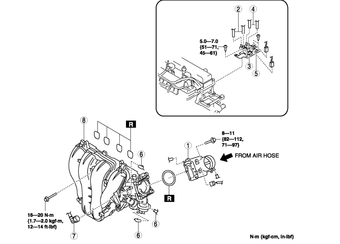

When I am parked or have my foot on the brake, my car will rev, sometimes up to 3 or 4 on the dial. The original error code was the Mass Airflow Sensor. We changed that yesterday, and it is still revving and it shut off twice within ten minutes in a parking lot. It shut off without making a sound. We took it to get the code checked and it still says Mass Airflow Sensor.

It sounds like the throttle bore is dirty. Here is a guide to help you fix the problem. Leave the actuator plugged in so it doesn't disturb the computer. The diagrams for your car are below.
