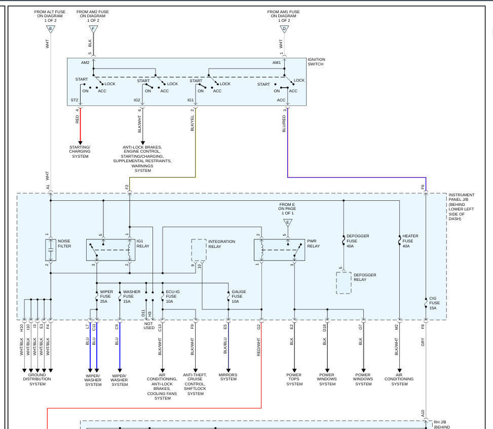

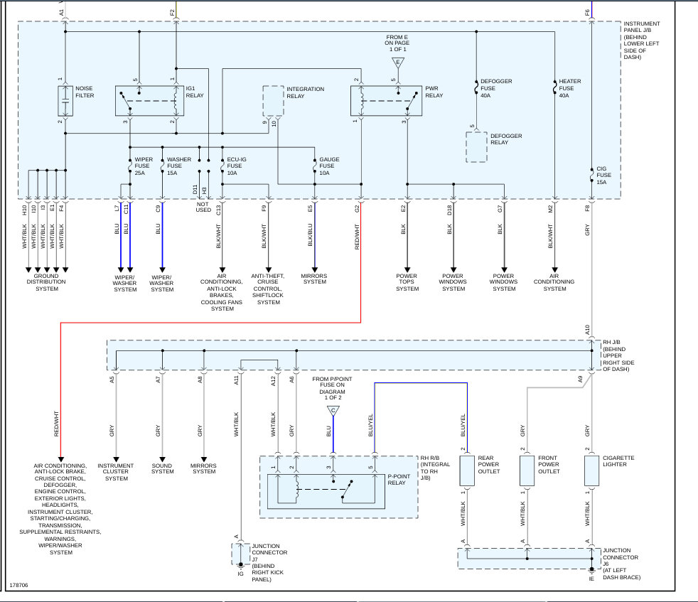

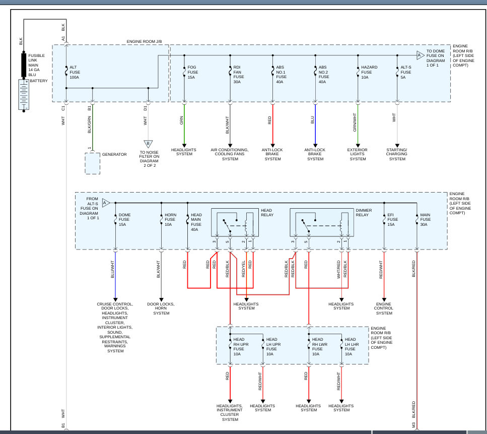

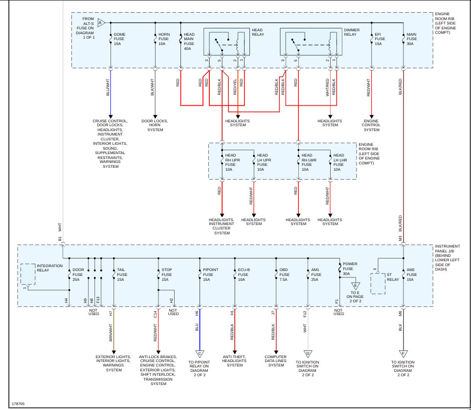

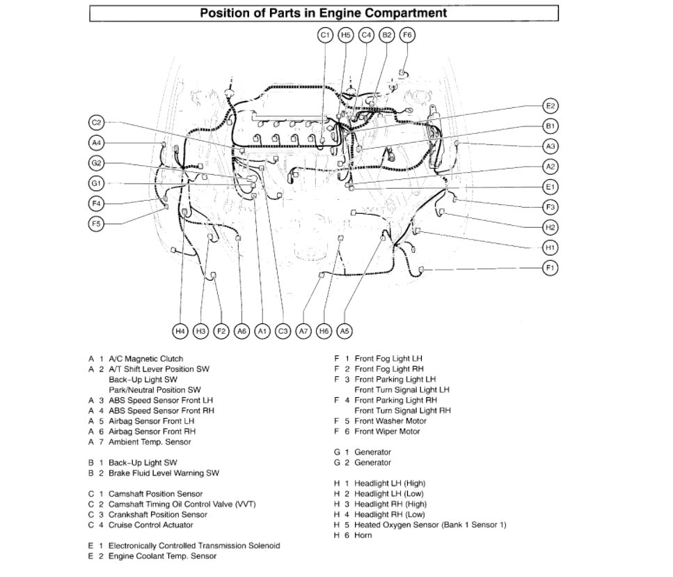

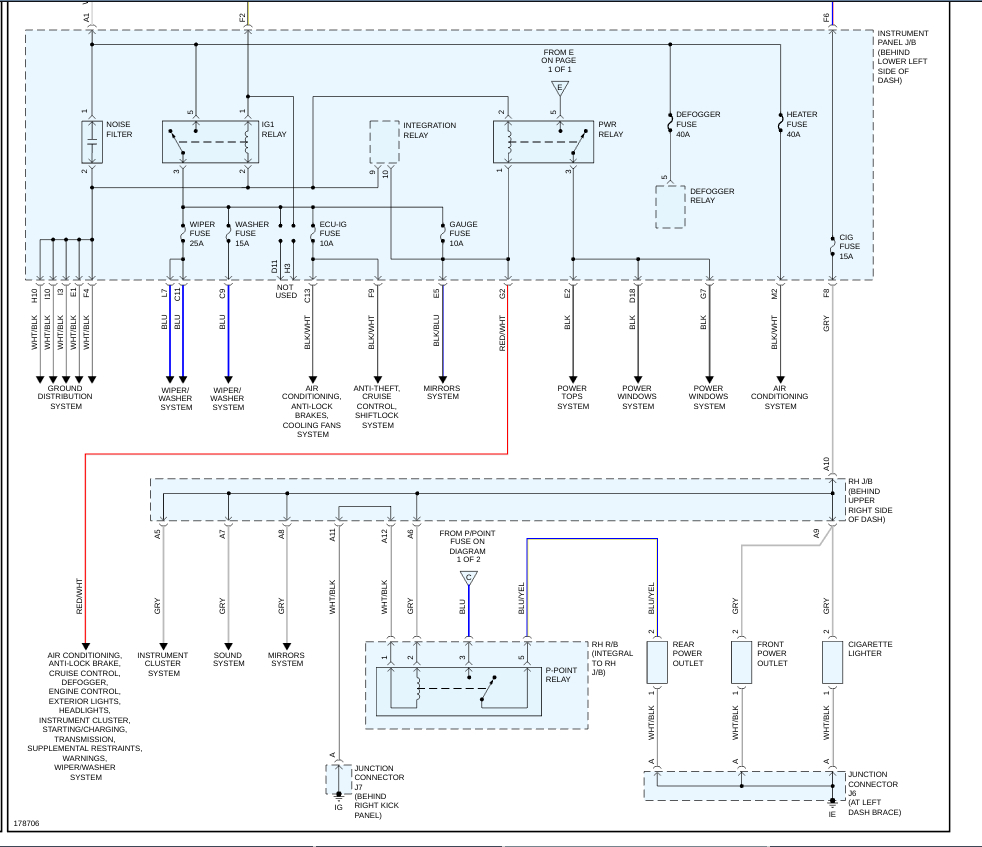

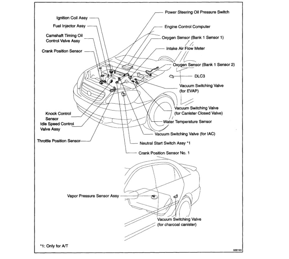

Starter good, but no crank, not running, no fuel or fire. Not sure how to track wiring and check computer. No check engine light but everything else seems to be okay.
Tuesday, December 24th, 2019 AT 7:27 AM
SCGRANTURISMO
  • 4,897 POSTS

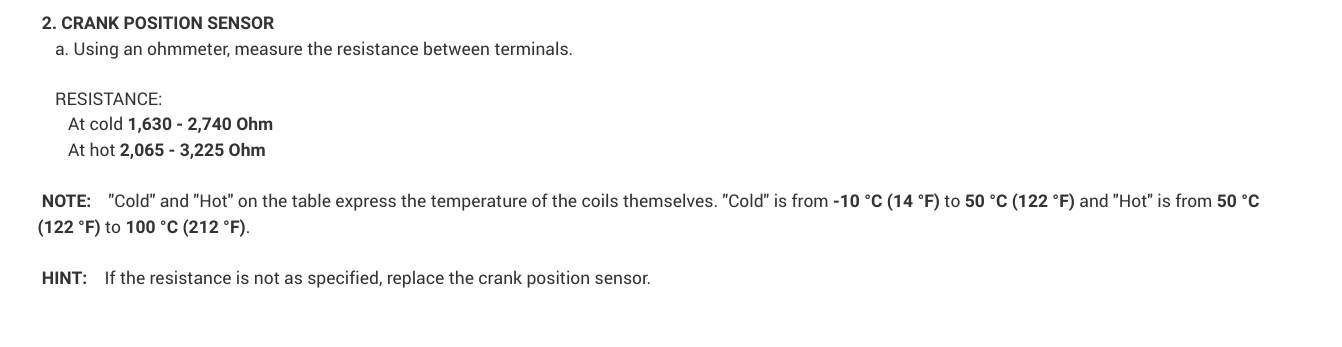

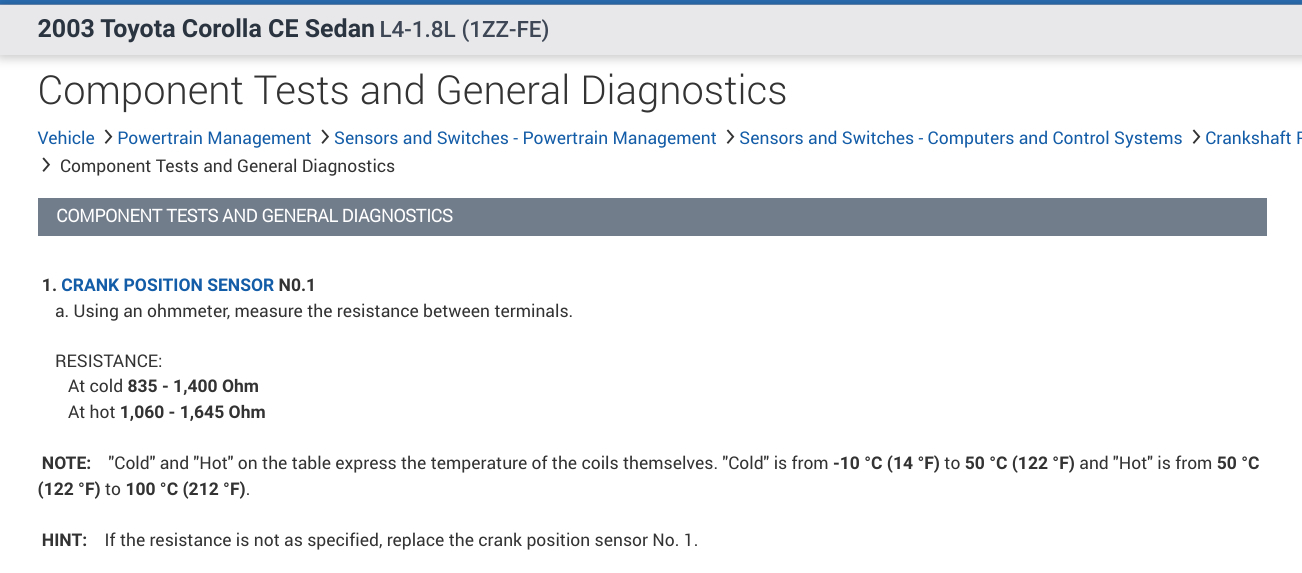

This could be a problem with your vehicle's Crankshaft Position Sensor[CKP] or the wires connecting it to the harness. In the diagrams down below I have included a diagram with the location of the CKP and a diagnostic troubleshooting guide for the CKP as well. I have also included a the wiring diagrams of the Power Distribution for your vehicle. Please go through these guides and get back to us with what you are able to find out.
Thanks,
Alex
