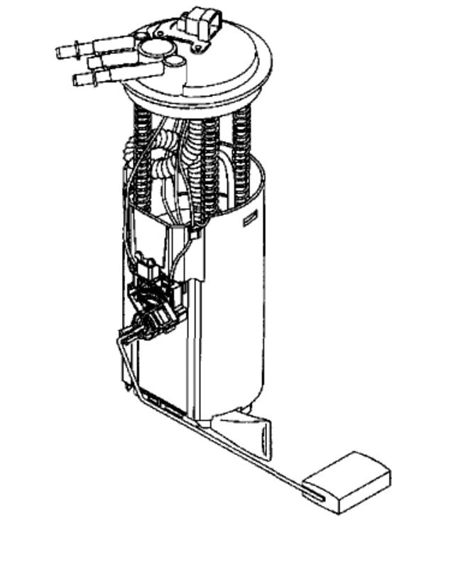

This sounds like a fuel pump or the crankshaft angle sensor has gone out. When you turn the key to the on position without cranking the engine over can you hear the fuel pump run in the tank for 5 seconds? We should run the codes to see what's going on.

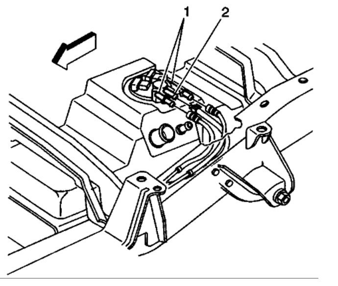

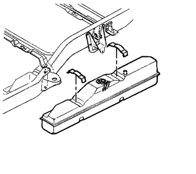

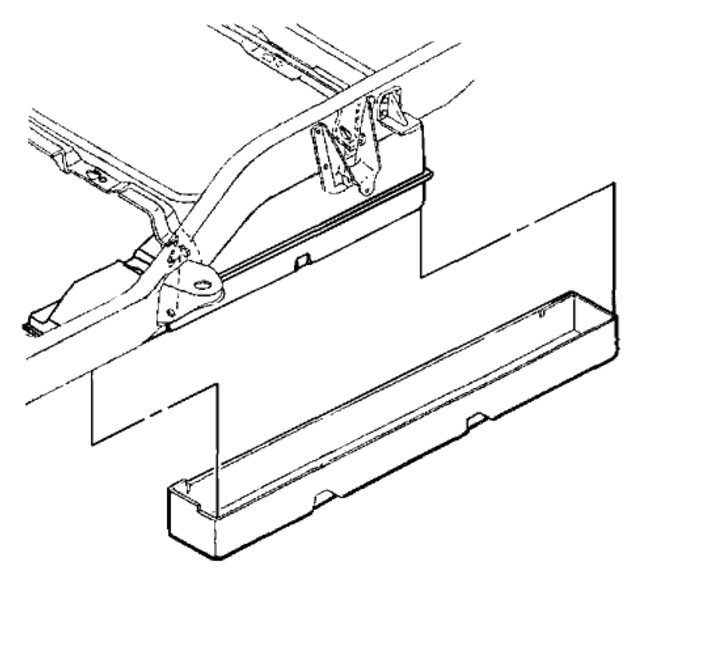

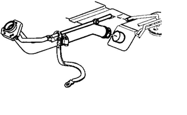

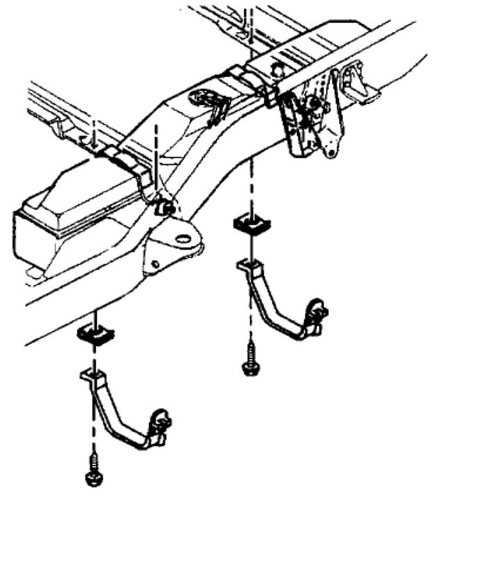

Here is how to change out the fuel pump and crankshaft sensor. The fuel pump failure is very common. Check out the diagrams (below). Let us know what happens and please upload pictures or videos of the problem.
