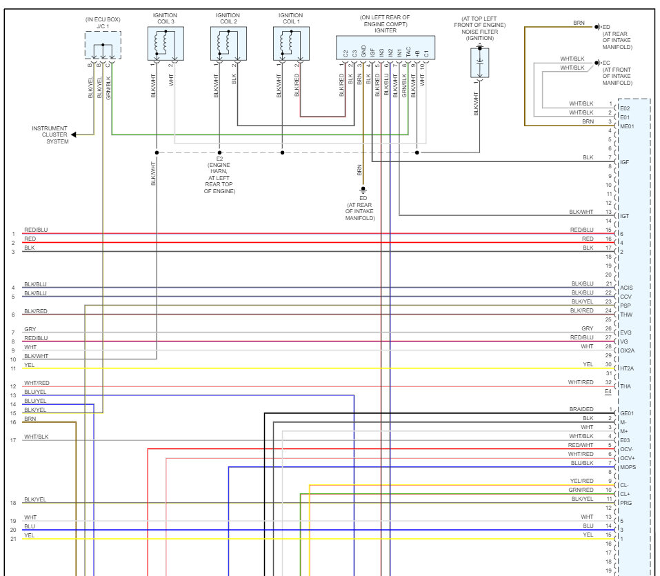

complete circuit diagram of the engine with transmission?
2004 LEXUS ES 300
426,341 MILES • V6 • 2WD • AUTOMATIC
BLESSING EWOBOR
  • 753 POSTS

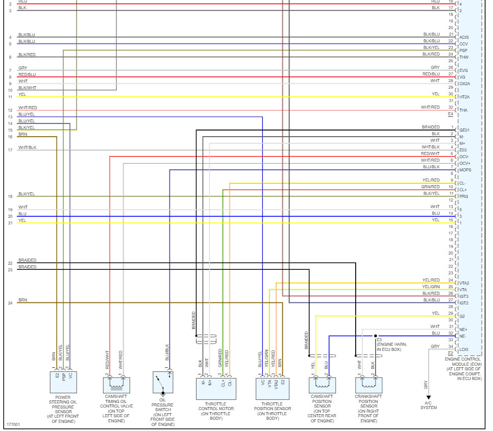

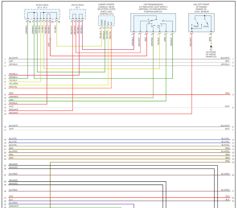

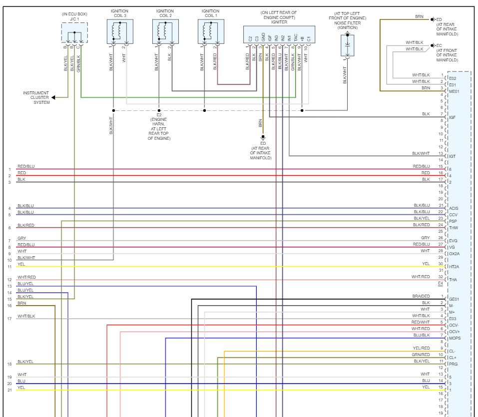

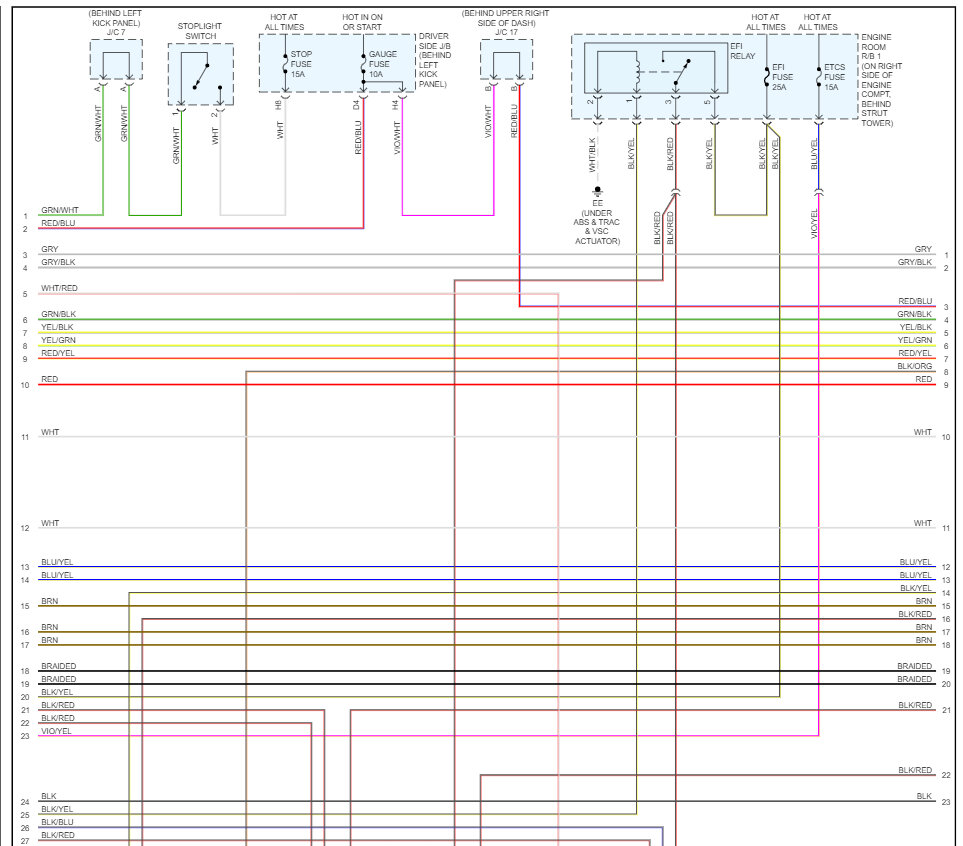

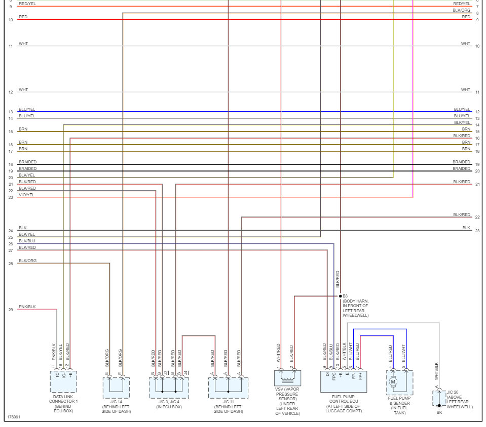

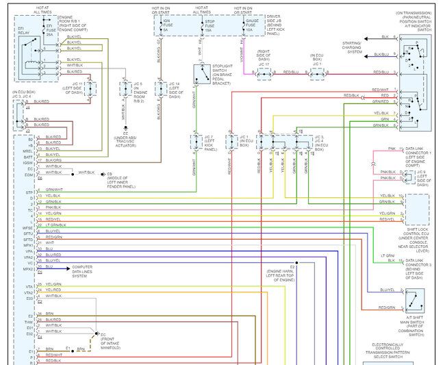

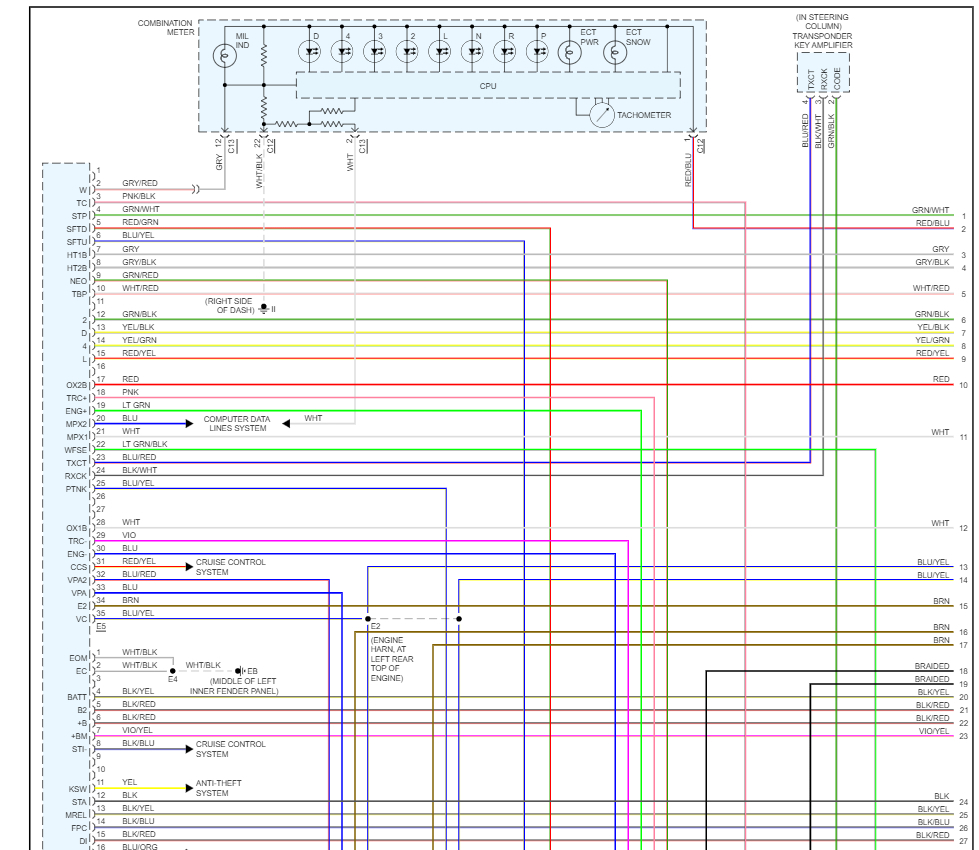

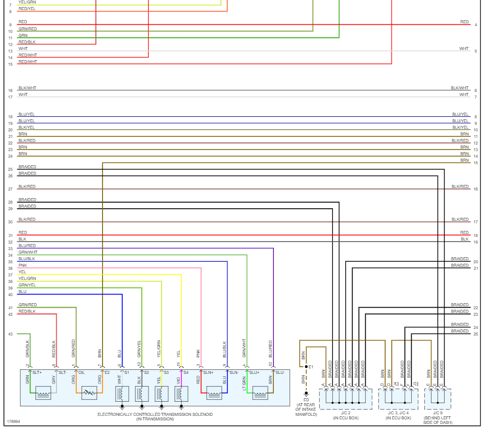

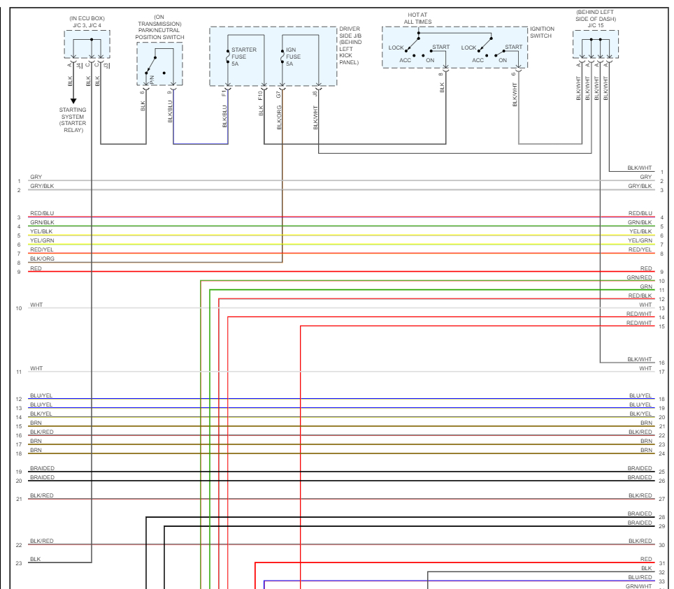

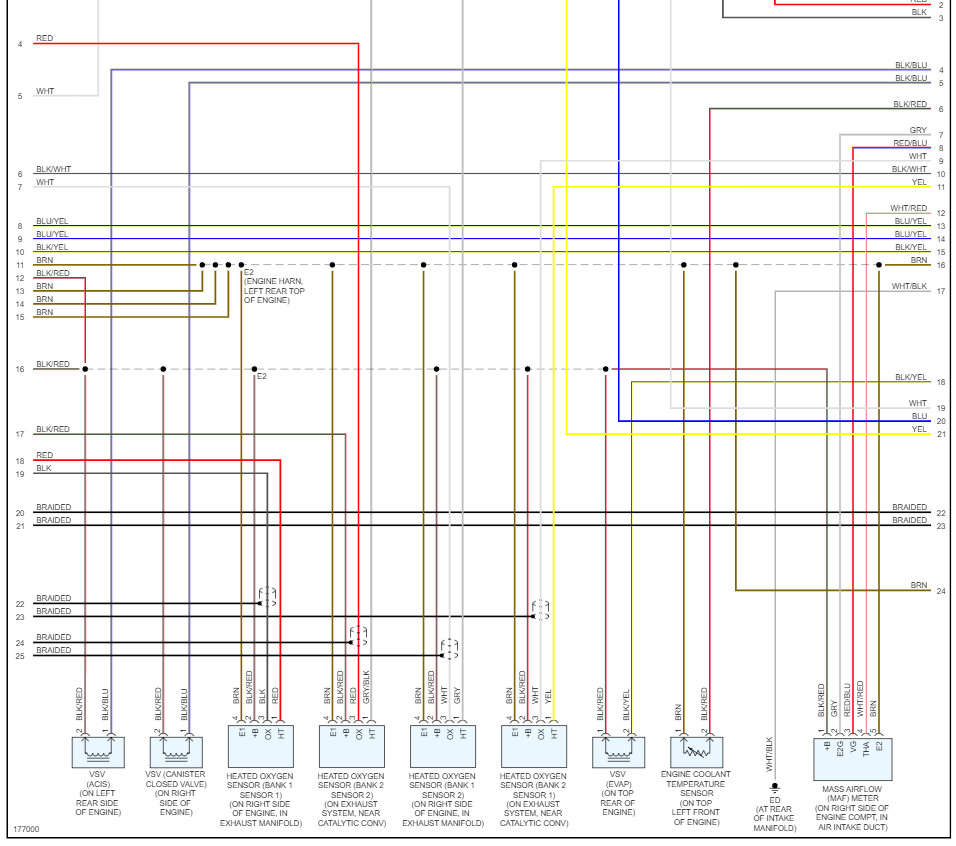

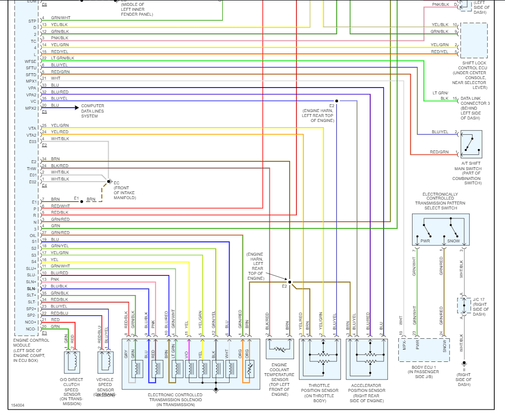

The vehicle has been in a workshop and some technicians have worked on the vehicle. The vehicle is experiencing rngine misfire and most of the coil wires has been altered. Please could you help me with the complete circuit diagram of the engine with transmission to trace some of the wires.
Mar 21, 2023 at 12:26 AM
  • 55,433 POSTS
No problem, here are the engine and transmission wiring diagrams and I have included a guide to help you test the connections.
Check out the images (below). Please let us know if you need anything else to get the problem fixed.
