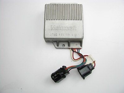

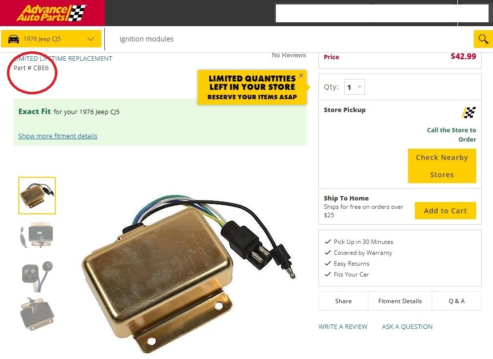

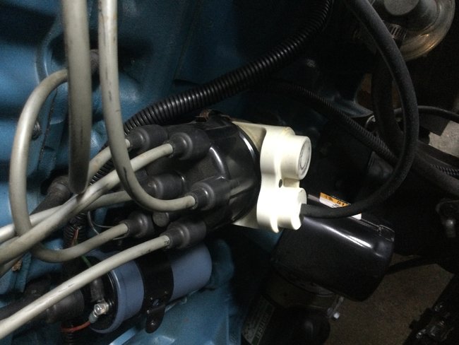

Does it have points or electronic ignition? There may be several types.
I'm sending 2 common types (pics) Can you verify which one you might have?
Sometimes they hide under the hood.
Can you name anything else that may be new under there?
Lastly, has it ever run perfectly for a long time for you?
The Medic
Jul 19, 2021 at 1:14 PM
AWGEEZ911
  • 12 POSTS

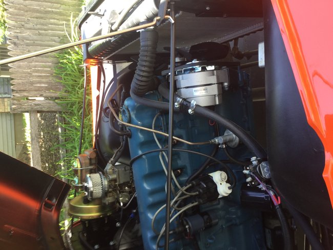

Thanks KaseKenny, and hello CJMedivac, the engine is a 4.2 L inline 6. I ran her yesterday and she cut out after 3/4 minutes, it seems to do both, sometimes she just shuts off and other times she spits and sputters and the shuts off. In either case one turn of the key and she starts right up. She has points, included picture of distributor. Of the two pictures you sent she has the gold one. Also included picture. New wiring harness 3 years ago, new ignition switch, new coil, new alternator. I purchased the Jeep in 2015 and it’s never run perfectly, always had the problem with it cutting out. Thanks for your help, look forward to your reply. Go Army

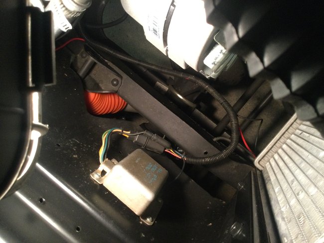

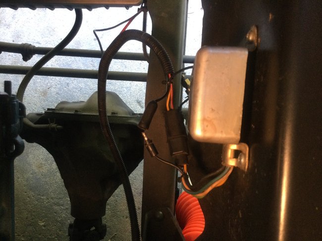

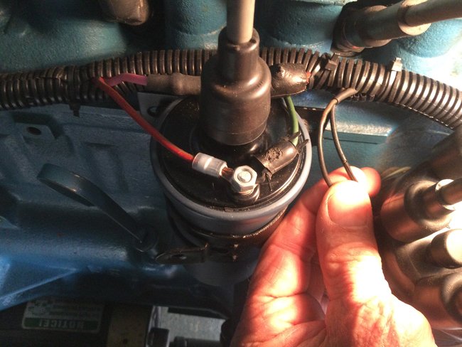

Hi Med, jently jiggled and moved the wires, noticed a crack in one of the two wires coming from the distributor but when I played with that wire it had no effect on how she ran. However when I played with the wires coming out of the ignition module she cut out. Narrowed it down to the black rubber connection for the ground wire. Seems like it’s just a push together connection with no positive locking mechanism. So I pushed it together as best I could and wrapped some electrical tape around it. We are having thunderstorms right now, as soon as they pass I’ll take her for a spin.

Lets fish a small "zip tie" around the 2 connector halves. Sorta part the wires if possible and and go between them
to get all centered up pulled tight.
Please send a pic of exactly the loose connection so that I may verify the best fix I can come up with.

Hi Med, took the Jeep for a couple of more runs and no problems, thank you. I included a picture of the ground wire connection that was lose.
