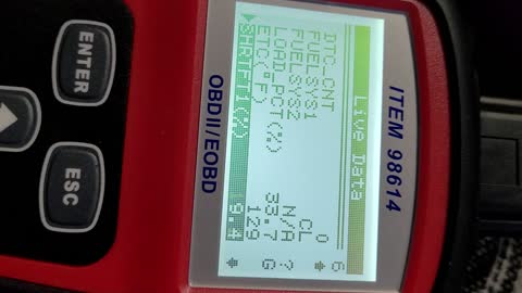

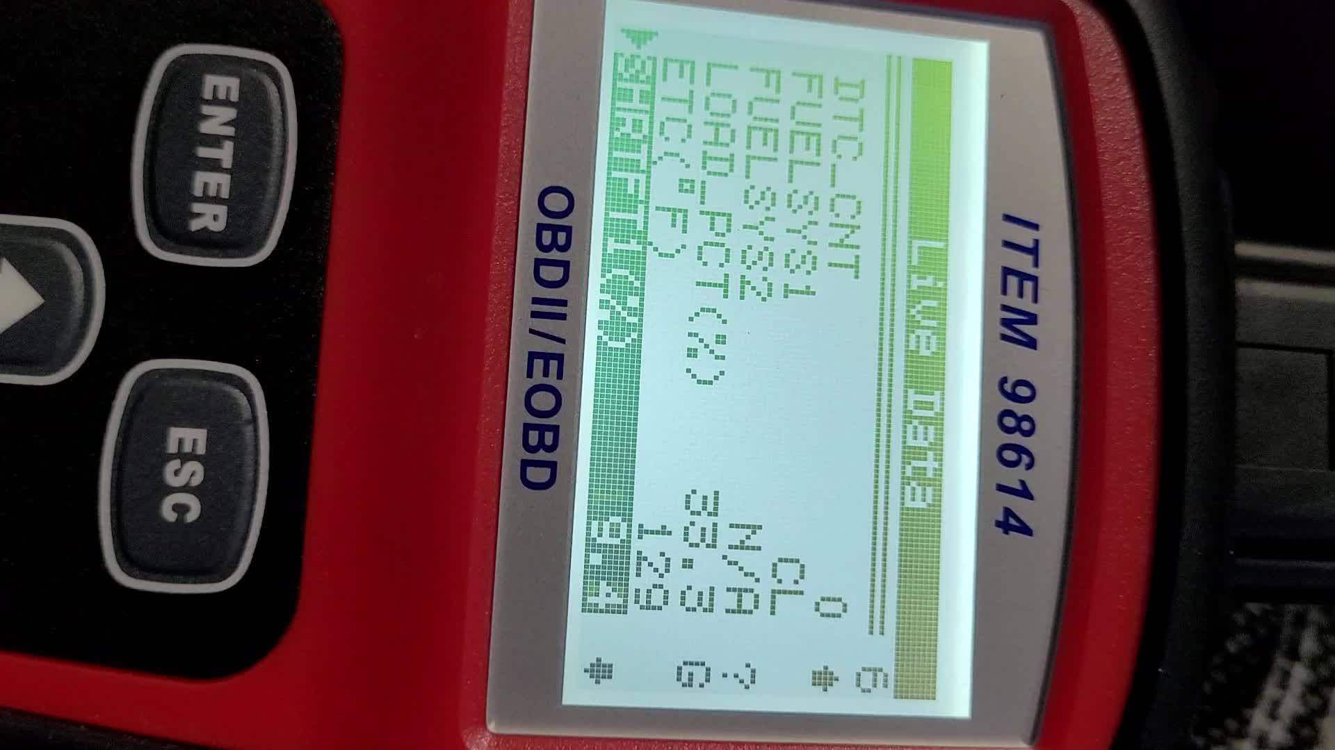

When I feel it is going to cut out while driving the tachometer will drop/stumble 100 RPMs with the engine. It does not jump around.
The SHRTFT1 (%) was usually around 7.0 but would go up to 10.0 and down to 3.9 mostly staying between 7.0 and 10.0. I attached a 30 second video of the numbers changing.

If the trims are going up that high, chances are there is either a vacuum leak or low fuel pressure. I was unable to see the trims in the video. However, in a perfect world, the trims would be 0. When it goes into the + numbers, the computer is adding fuel to the engine. When it drops below 0 into the negative numbers, that indicates it's trying to lean the fuel mixture.
Normally, trims are between -10% and +10%. but they should be adjusting back and forth and not just in the + side.

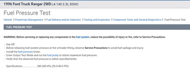

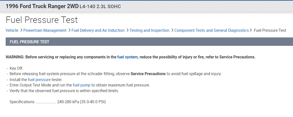

Have you checked fuel pressure? Have you checked to see if there are any vacuum leaks? Here are two links that explain how to look for both:
I attached the manufacturer's specifications below for pressure.
Let me know what you find. Also, watch fuel trims when you feel the problem starting.
