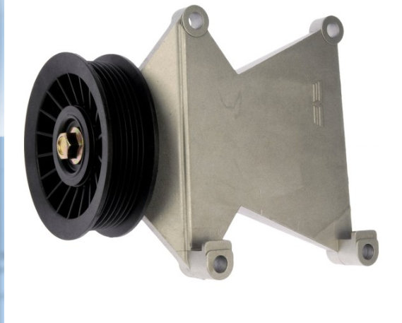

I had a similar issue going on with my 96 2.3l. If the engine is stalling as soon as the AC is turned on, check the IAC. For me, it was the compressor itself that was siezed up at the clutch/pulley and since repairing the already leaking AC system would have cost me more than what I paid for the whole truck, I removed the compressor and replaced the serpintine belt with a shorter one that was made for non AC models
Monday, January 6th, 2020 AT 11:47 AM
Thanks for the addition to the site. I am sure that will help others. Another option is to remove the compressor and just install a bypass pulley. Clearly this is not directed to you because your got yours resolved but another option for those that could see this. Some times there is no a belt option for non AC cars.
Thanks again for adding this info.
