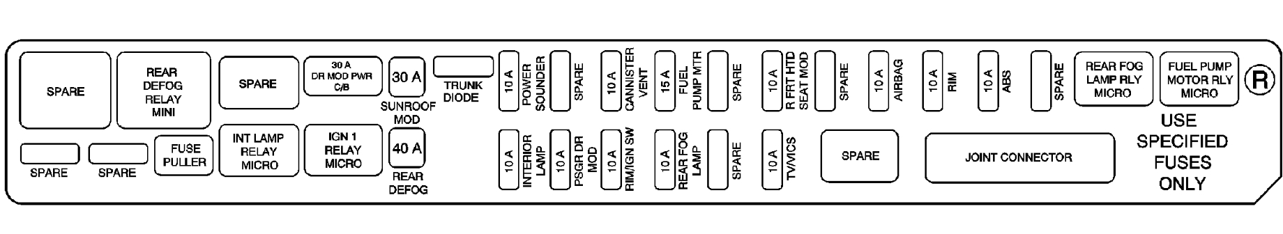

I was driving one day, and my car shut off. I thought I was out of gas, so I had someone bring me gas and it took a few times, but it started. I got it home and it hasn't started since. Apparently, I hit something, and it bent my fuel line, so I replaced that. Then I thought that it was the fuel pump, so I replaced that, and it still won't start, it cranks and it tries to start but it won't
Jul 14, 2022 at 10:01 PM
  • 55,423 POSTS

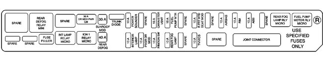

When you turn the key on without cranking the engine over can you hear the fuel pump run for 5 seconds in the tank? If not, when you replace the fuel pump did you use an AC Delco unit? I would check the fuel pump relay, here is a guide to help you test the relay. I have also included the relay location under the hood in the diagrams below.
This guide can help as well:
https://www.2carpros.com/articles/car-not-running-advanced
