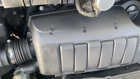

engine cranks but does not start, codes P0008, P0016, P0017, P0300, P0301, P0303, P0305, and P0497?
145,000 MILES • 6.3L • 6 CYL • 4WD • AUTOMATIC
EL COYOTE'
This is my son's car. Purchased in August, '23. He stopped at the grocery store and the car wouldn't start again. It has stored the following codes: P0008, P0016, P0017, P0300, P0301, P0303, P0305, P0497. Multiple listings of the same codes-some are stored, some are pending, and some are permanent. The engine will crank over and act like it is firing but no starting. I know this engine family has issues with stretched timing chains. Some of the codes seem to indicate a timing issue.
It is almost impossible for me to get to the crankshaft sensor as I have no lift to get the car in the air. I suspect it could be a failure but until I can get to it, I'm stuck trying to determine the reason the vehicle won't start. As a side note but one, I think might contribute to the issue is this: Previous owner had new tires installed at 121,000 miles and they are not the right size. The correct size is supposed to be 255/65R18. The ones that are on it are 225/60R18. My son is trying to save money up to get the correct size put on. I am thinking this could be a contributing factor affecting various computer controlled items such as engine rpm, speedometer, ABS system, etc.

I don't think the tires size will matter with such a small difference as long as all tires are the same size. Also, I can tell if the engine is hurt or not if you upload a short video with your phone of the engine cranking over. You can upload it here with your response, it will save us a lot of time. Here is what the codes mean:
P0008: This code is related to the engine's mechanical timing.
P0016 and P0017: These codes are also related to the timing of the engine.
P0300: This is a generic code indicating a random/multiple misfires detected.
P0301, P0303, P0305: These codes indicate misfires in cylinders 1, 3, and 5, respectively.
P0497: This code indicates a low purge flow in the Evaporative Emission System (EVAP).
So, this does point to the timing chain and at 145k it is the season for it. If you don't want to load a video a compression test can tell us as well, please follow these two guides:
and
https://www.2carpros.com/articles/car-not-running-advanced
Please go over these guides and get back to us.

Here is a video i grabbed of cranking the engine:
Dec 29, 2023 at 8:37 AM (Merged)
  • 55,721 POSTS
Yep, that engine is hurt. There is no or very little compression, you can proceeded it taking the timing cover off. Yes, the 2011 Chevrolet Traverse equipped with the 3.6L engine is considered to have an interference engine design.
