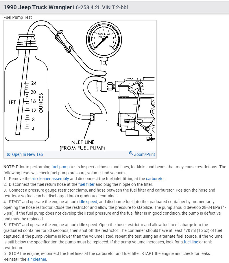

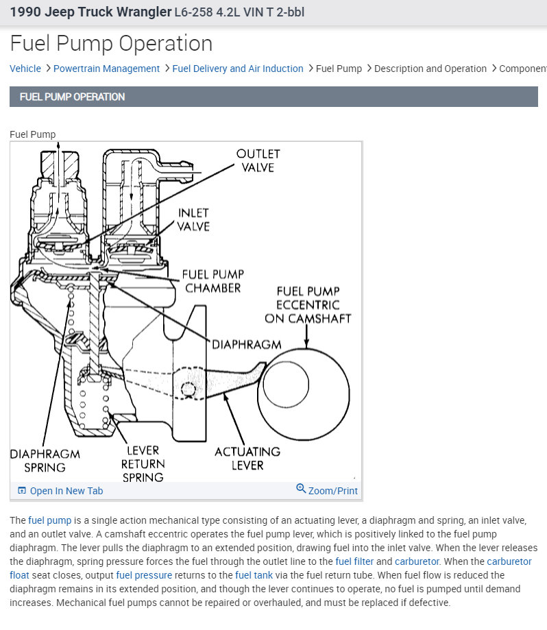

The warning light does not come on and I do not hear the fuel pump engage. Does the 1990 Wrangler have a fuse for the fuel pump? Where would I locate the relay? Any other possible electrical issues that may cause the fuel pump not to work? The fuel pump was not showing any sign of going out.
Jan 8, 2022 at 9:20 PM
SQM
  • 6,383 POSTS
That was actually the changeover hear for the Wrangler from carbureted to fuel injected.
If you have a carbureted engine, then the fuel pump is a mechanical pump and dot does not have relay or fuse.
The fuel pump is mounted to the front corner of the engine block and is actuated by the fuel pump lever contacting the camshaft.
I have attached the diagrams as well as the testing procedure for the pump.
Have you checked for spark?

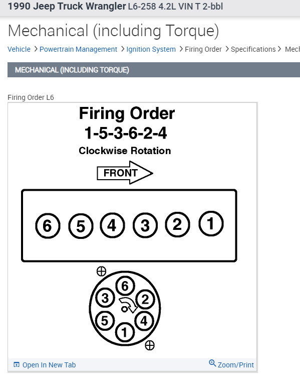

Thank you for your help. One more question (for now). When i changed out the spark plug wires, I did not pay attention to the length of each wire. Is there a diagram that shows which wire goes to which plug? I know which plug goes to which distributor post. I just need help on which wire should be used to connect each plug to each post.
Jan 9, 2022 at 4:09 AM
SQM
  • 6,383 POSTS
I have attached a diagram below. It shows the firing order and which post on the distributor cap correlates to which cylinder. This will help you make sure the wires are correct.
Let me know how it goes.
