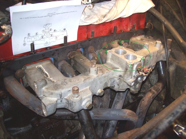

Picture 1) Carburetor to intake bolts, I feel sure you don't have a torque wrench to tighten them.
Let's use a regular old wrench. Grab it about in the middle and just "snug" the four nuts in a "cross" fashion.
How about laying you hood gently back on the windshield frame.
Remove your breather.
Take a few good left and right and overhead shots of your engine in good light.
A few good ones over the carburetor too!

Carburetor mounting (check the torque). It should be 13 ft-lbs tighten all four bolts in a criss-cross fashion.
Beings that it's only 13 ft-lbs, the "click" or "break" of the torque wrench will be very "mild" and hard to detect (when to stop).
So basically, it won't take much to be to specs!
