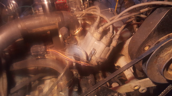

CJ, I see you have a wealth of knowledge and answers on here. First of all, thank you for your service.
I have owned at least a dozen jeeps. I recently bought a 1978 CJ7 with an AMC 304 motor. The previous owner(s) have tweaked the motor, it has a cam. When I first drove it, it sputtered and drove terribly. First mechanic I took it to stated coil was hooked up backwards and they put new coil in and removed, yes removed the resistor! Ran crappy.
Took it to the next mechanic and he discovered no resistor problem and put one inline to the positive side of the coil. I see you mentioned that in another thread that is no go. It ran like crap. Mechanic said couldn't fix it some thing is wrong with the engine.
Third mechanic I took it to, said the problem was that the carb was full of crap! Ran great! until Thanksgiving day! Turned over and it started briefly. I continued to turn it over, several loud super loud backfires (it has cherry bomb mufflers) no crankie. Spark was weak. The next day, I decided to check the coil. Ohm resistance was out of spec so I bought another one and change the coil myself (got one from Autozone specifically for this make and model). There is nothing on the package that says for use with or without a resistor. It's "Hecho in Mehico" duralast. However, in my diagnostic I did check it again.
Okay I am taking a breath and going to let you read this before I get too far into this.

Oh and to advise you how I am testing for a spark. I pulled a plug with the wire on it. I ground out side of plug, no spark. I actually took a wire and completely wrapped it around the plug and ran the other side to the negative on the battery. No spark while trying to crank it. Starter works fine, motor turns over it cannot start without a spark! I do not know much but I do know that!
Nov 28, 2016 at 10:06 AM

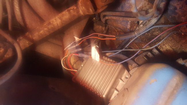

Ignition control from Autozone F102 Hecho in Mexico. I know it is not bolted down and it needs to be for heat distribution and maybe grounding too I just slapped it back on after my failed attempt to get Autozone to check it to see if it is bad. This is the new one I recently bought.

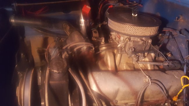

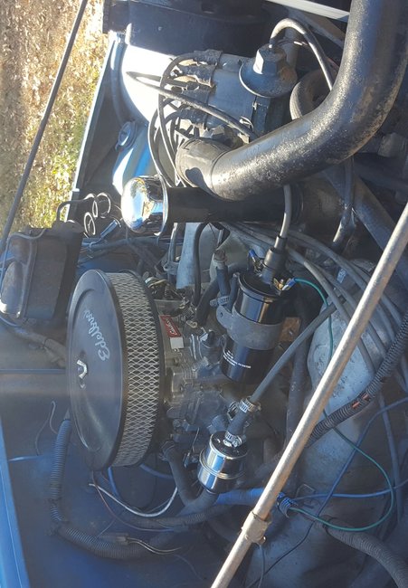

Picture of motor. Edelbrock carburetor mostly new.
Nov 28, 2016 at 10:27 AM

My illustrious distributor looks mostly new probably is I do not have the history on it. Inside is pretty everything looks brand new on the inside. Plug wires are newish, checked resistance on a couple, especially the one going from coil to distributor and it checked okay.
Nov 28, 2016 at 10:28 AM

Better picture of motor.
Nov 28, 2016 at 10:31 AM

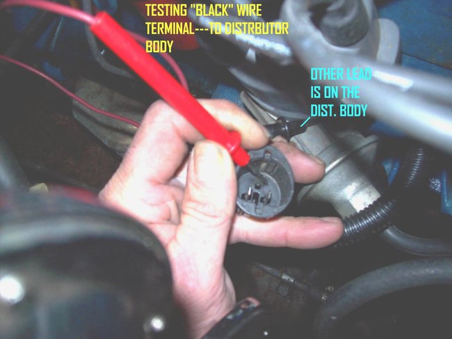

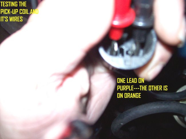

Mr. Distributor.
Have you pulled him out/ even up at all, your distributor after it ran well?

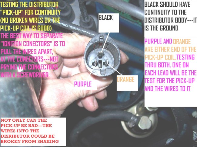

Have you pulled the distributor cap and watched the button turn while being cranked?
Try to firmly/ gently turn the rotor button with your fingers (engine off!) Will it turn a lot under pressure (a little CW and CCW movement is normal) Just making sure the drive gear pin is not sheared.

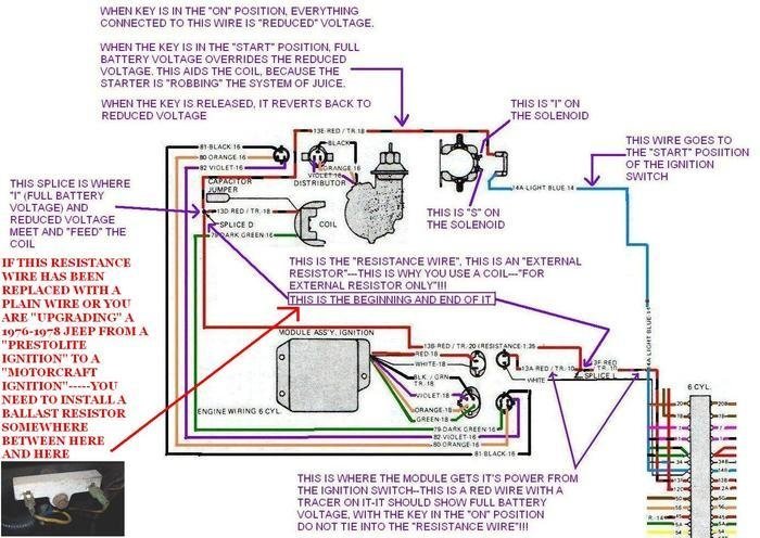

You now have a Motorcraft ignition (introduced to CJ's in 1979)
You need a coil for a 1979 (no internal resistor)
and a ballast resistor ( as the 1978 did not have a resistance wire-but the 1979 did!)
Are you wired as I show in my pics below? This is from a 1979 wire diagram. Let's check it good!
Showing a continuity test for distributor also.
(I upgraded my 1977 to Motorcraft too, Too many quirks with the whole Prestolite deal that left me stranded too many times).
Still got the good old mechanical fuel pump on your engine?
This may all be a review, but we have to know we have not missed something stupid!
The Medic
Nov 28, 2016 at 12:21 PM

Medic, I will check the distributor. What about twelve volts being on both sides of the coil, is that correct? Could you advise where to get that ballast resistor? I will check everything in your pictures as well. Is the coil I linked you to the correct one? Mechanical fuel pump. I know it is getting fuel my issue is no spark.
Nov 28, 2016 at 10:46 PM

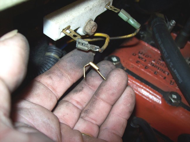

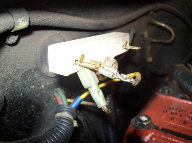

This is the one that it calls for on a 1979.
http://www.autozone.com/ignition-tune-up-and-routine-maintenance/ignition-coil/duralast-ignition-coil/111930_576402_17367/?checkfit=true
Ballast resistor-
.8 or .85 OHM will work,
"i Believe"- Well all of them have a pocket on the backside in which the resistor coiled wire is in.
The ones that are wide open tend to let the coiled wire maybe bounce/ move about while you are bouncing the Jeep on the road.
To me these seem to fail/ coiled wire breaks- Jeep is now dead in the water
I think the one I got last was from NAPA auto parts, It had ceramic/ or something poured over the coiled resistor wire (like a ceramic cover over pocket) I have had this one a long long time.
If you can find it anywhere, try to go with that type (OHMs the same as I mentioned) Online pics may keep you from traveling everywhere!
Should you become dead in the water, check the ballast. Just to get you in, you can temporarily bypass the ballast using a Jumper Wire/ Tying the two wire together/ use a "Piggy back" (Picture Below). Put the piggyback on one side and leave it there until you need it. Going this route, it is just "plug and unplug". Nothing' else needed! Get a new ballast soon so that everything is back to normal!

So the orange and black wire coming out of the fuse box, connects to the ballast which in turn connects to the positive side of the coil. It will also have a direct connection (without ballast) to the red wire on the ignition module if my math his correct here.
Nov 29, 2016 at 8:14 AM

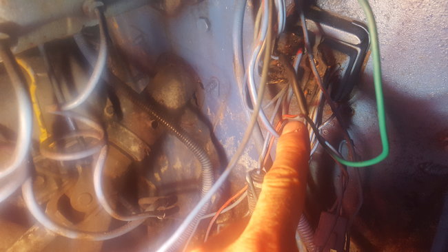

CJ Medevac, I may have found part or all of the problem.
I have no power on green wire that goes to the negative side of the coil with ignition on while putting the other side of a test light on the positive side of the battery. My understanding is this is how you check to make sure the coil is grounded through the distributor.
I checked both the ground wire to the dist and green wire back to ICM and both have continuity. One note, the ICM is not mounted on the fender at this time. Does it have to be to get a common ground? Where is the ground for the ICM? This is the first thing my mechanic asked me, where is the ICM grounding and check that.

Ok, progress made. I've got a spark, albeit a weak one. I put the old ICM back on. Green wire passed diagnostic by lighting up test light when I put the other side of the test light on the positive side of the battery. The plug makes a spark but intermittently and weak. This was the reason I changed the ICM in the first place! It wouldn't start and once I checked the plug I noticed it was weak. Turns out the new ICM was bad! The old one may be bad too and cause the weak spark. Going to get away from the Auto Zone one and pick one up from NAPA tomorrow.
Another interesting note. The red w/ black striped wire coming off the side of the solenoid wasn't hooked to jack crap! I spliced it into the red wire going to the coil. I have so many wires I pulled out of the tubing it looks like a spider web all of the top of the motor. Bound and determined to get this started!

Don't worry about the negative side of the coil (for now)
Everything else look EXACTLY like my diagram? Wires going all the way to components as shown?
You need to mount your ignition module on the fender
Scuff a dime sized bare spot around the bolt holes
This puppy gets grounded by the case.
Beings that I had Prestolite before (like you did-I think), The newer Motorcraft Ignition Module was not even there to mount!
I had to mount mine out of the way of my three train horn bugles.

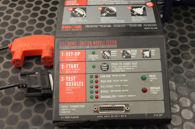

dAMMMITTTTTTT!!!! New Duraspark box (SECOND ONE AS FIRST AUTOZONE ONE DIDN'T PASS ONE OF THE DIAGNOSTIC TESTS LISTED BELOW) and still weak spark. aaaaaaaaaaaaaaaaaaaaaaaaaaaaaaaaaaaaaaaaaaaaaaaaaaaaaaaaaaaaaaaaaaaaaaaaaaaaaaaaaaaaaaaaaaaaaaaaaaaaaaaaaaaaaaaaaaaaaaaaaaaaaaaaaaaaaaaaaaaaaaaaaaaaaaaaaaaaaaaaaaaaaaaaaaaaaaaaaaaaaaaahhhhhhhhhhhhhhhhhhhhhhhhhh hhhhhhhhhhaaaaaaaaaaaaaaaaaaaaaaaaaaaaaaaaaaaaaaaa aaaaa.
I'M AT WITS FREAKIN END WHAT THE MOTHER OF ALL JEEPS IS WRONG WITH THIS PIECE OF S***
I did this complete diagnostic check listed here: http://www.jeepforum.com/forum/f8/86-cj7-i6-stalled-power-coil-but-no-spark-936569/
EVERYTHING passes 100% and continuity is good between everything. I've got a new coil, a new resister, a new Duraspark NAPA box and I've soldered every connection! When I crank the engine the spark is weak and intermittent (not consistent). The only thing this could be at this point is the distributor I suppose because there is not much left to check!
Dec 2, 2016 at 10:37 AM

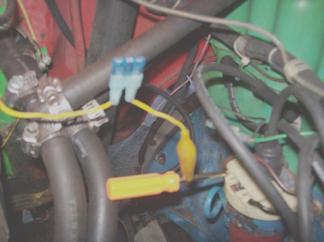

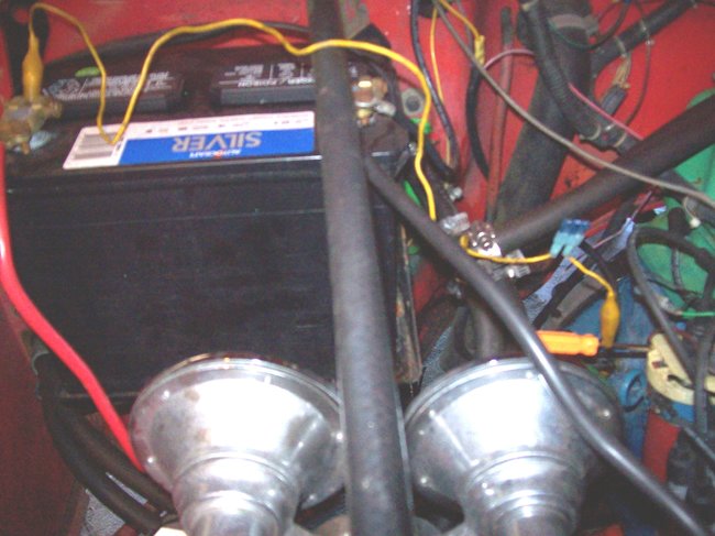

If it were Motorcraft, maybe it has a resistance wire (no need for the ballast) Can you test the wire to see if it is a resistor wire (or have you replaced it with a regular wire?). I'm suggesting may be that the needed resistance has been doubled (I'm guessing).

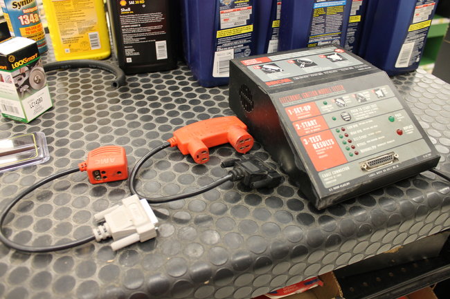

Try this! AS A TEST
Pos battery to Pos coil
See my 1st two pics, see if spark improves
Temporarily disconnect "I" at solenoid, maybe solenoid is somehow dragging it down
You tested this puppy at an auto store? Pics are of Advance Auto Parts Machine

Affirmative on the '79 coil it is for electronic ignition. Your module that you have is for '79-early 80's
