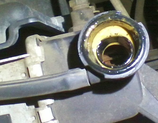

What can cause the engine coolant to smell like some kind of solvent? There was some yellow milky substance under radiator cap, but did not see much inside the radiator. It did not show under oil fill cap or inside valve cover or on engine dip stick.
I found coolant level to be 1.75 gallons low and possibly cooked.
Pep Boys told me that (if) it is not oil or transmission fluid that some radiator stop leak products can cause this also. PS: I found the oil level in engine to read 2.75" higher than the max fill level on the dip stick. I have not yet drained the oil to check for coolant filling up the oil pan.
I just bought this car without being able to open the radiator cap until hours later when it had cooled down. = Dumb purchase.

Yes, it sounds like you have coolant in the oil from possible head gaskets or an intake manifold.
You will need to have a leak down test done to confirm the results.
It sounds like you need some major work.

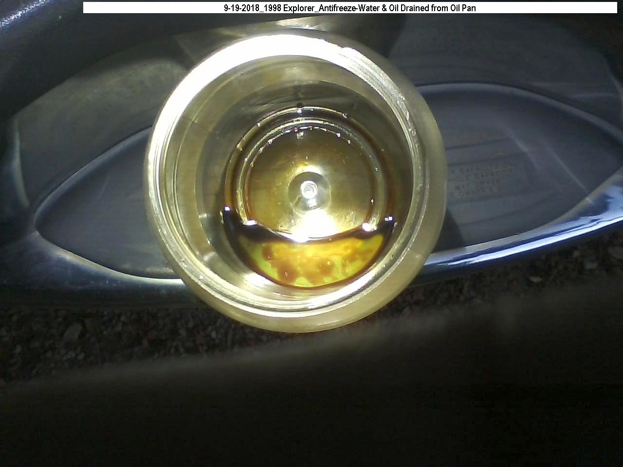

Hi Roy, no, I have not yet tried the UV kit, I did not know about them. I did manage to get the oil drain plug out and allowed approximately (one) ounce of cold fluid to drain into a clear plastic bottle, see image. Then drained out (one quart). But did not see any more antifreeze, but the oil color is a dark brown/black color using a white light LED flashlight, viscosity seemed more like warm oil, not like a milkshake. Question, how can the hydraulic lifters can be flushed after the repairs are done? Also, what is your opinion about those head gasket sealant products like bars leaks ans steel seal for a temporary fix? I tried Bars leaks on my 1991 explorer's V6 a few years ago, it seemed to work for a while as long as it was not a cold night, but then the coolant leak came back. I am thinking of retiring both the 1991 and 1998 Explorer's to California's salvage yard in the sky, but with the 1998, I cannot do that this month. Horse and buggy days were easy, but not allowed now, too much methane.

The coolant is no good in the oil. Most likely a head gasket. I would do both gaskets while the job is being done.
No to the head gasket additive. It has no effect on a head gasket. All it does is clog up the radiator and the heater core.
There is no flush for the lifters. Just use good clean oil.
