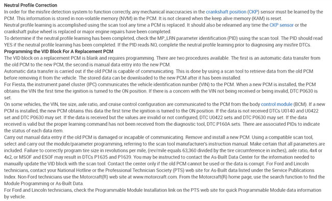

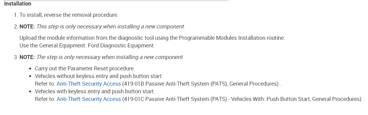

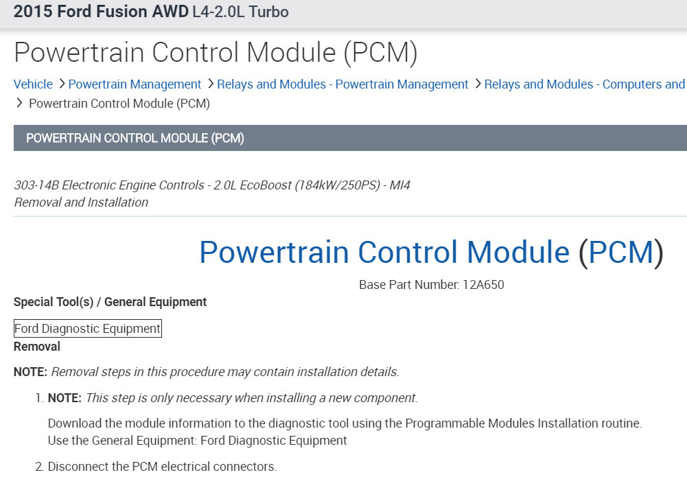

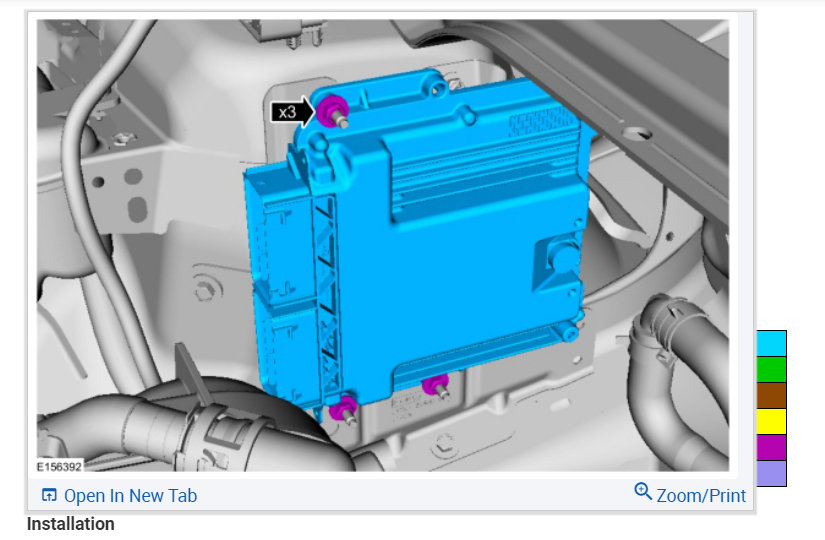

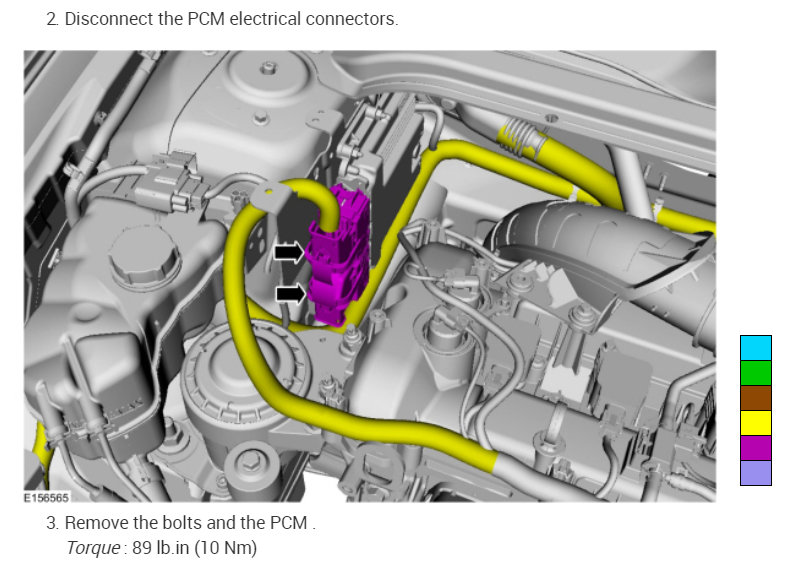

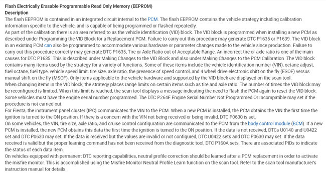

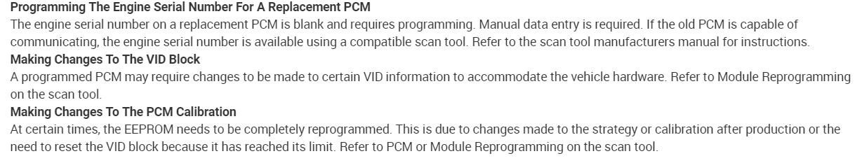

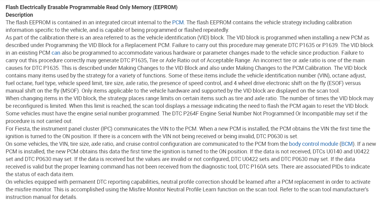

I checked out the wiring diagrams for this sensor and they go straight into the PCM which I believe is bad. To be sure use the video link above to scan the CAN. Here are instructions on how to change the PCM out in the diagrams below. Check out the diagrams (below). Please let us know what you find. We are interested to see what it is.
