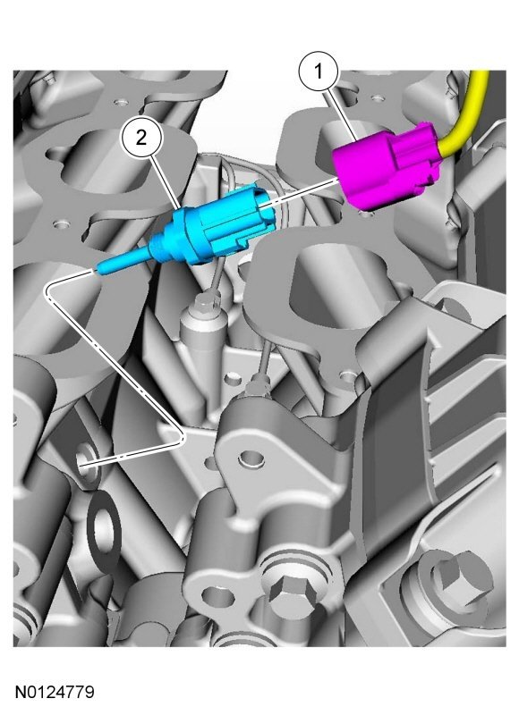

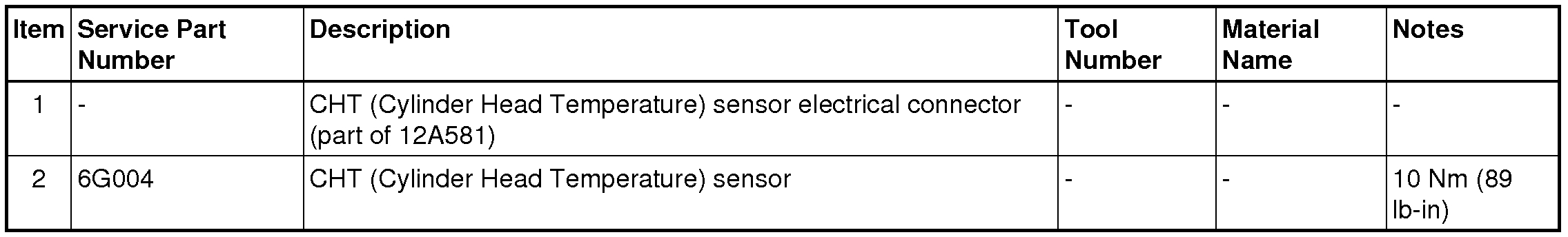

Finally, here are the directions for replacing the sensor. The last two pictures correlate with these directions.
____________________________
Cylinder Head Temperature (CHT) Sensor - 3.5L Ti-VCT, 3.7L Ti-VCT
Exploded View
Removal
WARNING: Before beginning any service procedure, refer to Safety Warnings.Failure to follow this instruction may result in serious personal injury.
1. Remove the lower intake manifold. For 3.5L Twin Independent Variable Cam Timing (Ti-VCT) engine, See: Intake Manifold > Removal and Replacement > Lower Intake Manifold.
2. Disconnect the CHT (Cylinder Head Temperature) sensor electrical connector.
3. Remove and discard the CHT (Cylinder Head Temperature) sensor.
Installation
1. NOTE: Do not reuse the CHT (Cylinder Head Temperature) sensor. Install a new sensor.
Install a new CHT (Cylinder Head Temperature) sensor.
- Tighten to 10 Nm (89 lb-in).
2. Connect the CHT (Cylinder Head Temperature) sensor electrical connector.
3. Install the lower intake manifold. For 3.5L Twin Independent Variable Cam Timing (Ti-VCT) engine, See: Intake Manifold > Removal and Replacement > Lower Intake Manifold.

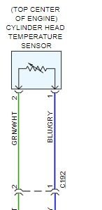

I''m glad to help and glad you got it fixed. I attached the sensor wires schematic which stretch across several pages of schematics. If you need or want something specific, let me know.
