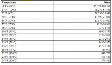

MONGLOR
THE FAN RUNS ALL THE TIME MY ENGINE IS A 360 CUBIC INCH CARBORATED. I JUST CHANGED MY OIL NOT WATERY. THE OVERFLOW TANK IS AT THE RIGHT LEVEL. I THINK IT MIGHT BE A VACUME BLOCK IN THE RAD OR HOSES HOW DO YOU RESOLVE THAT? IT MIGHT ALSO BE THE COOLANT TEMPATURE SENSOR BUT HOW CAN I TELL IF ITS NEEDING REPLACED. THANKS FOR TRYING.
Saturday, October 3rd, 2020 AT 12:50 PM (Merged)
BLUELIGHTNIN6
  • 16,542 POSTS
You can purchase flush kits at most part stores. you use a garden hose and the kit to flush out the cooling system. this will knock out any blocks in the system .
to test the sensor, turn key OFF, disconnect the wire connector from the sensor. connect an ohmmeter between the sensor terminals. ohmmeter readings should be within specs listed below, if not then replace sensor.
https://www.2carpros.com/forum/automotive_pictures/261618_Noname_800.jpg
