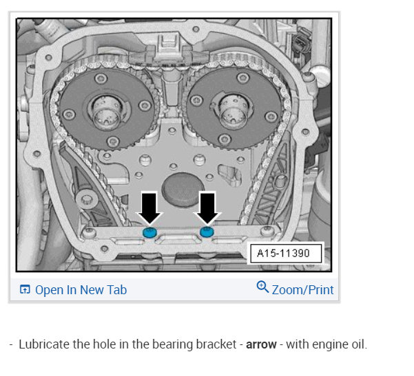

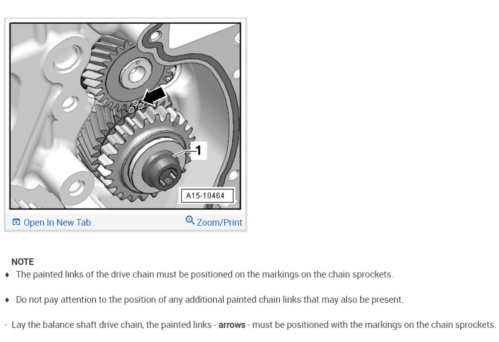

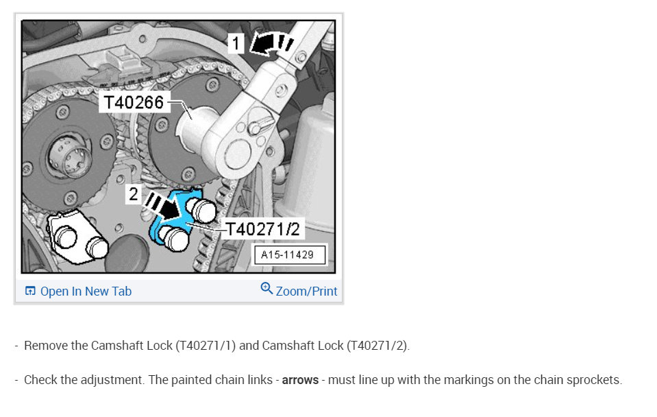

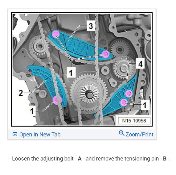

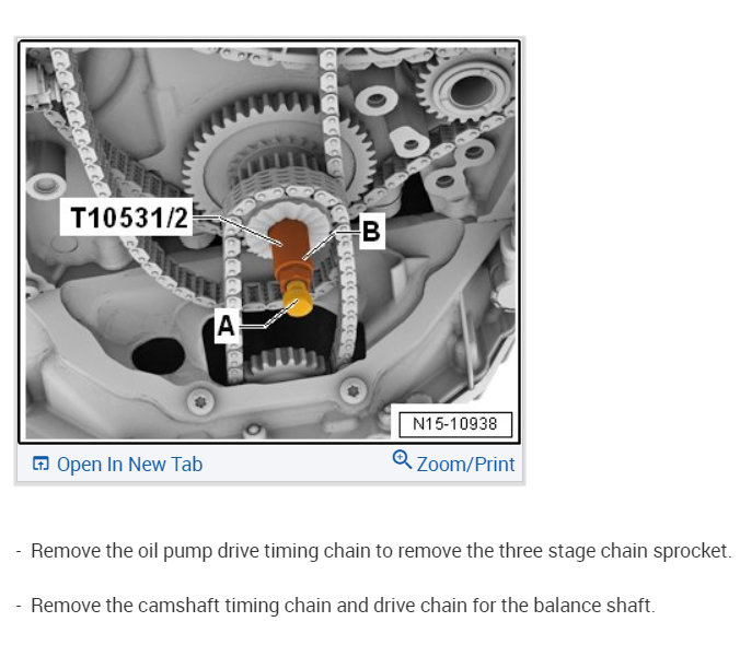

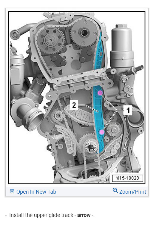

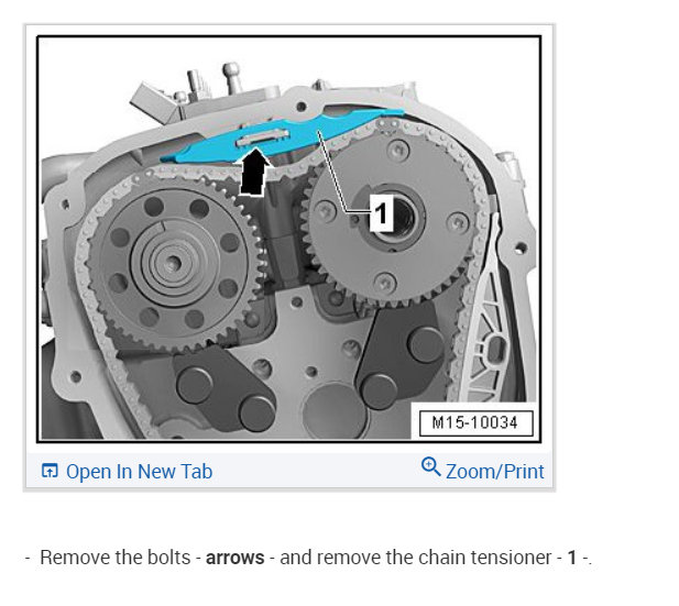

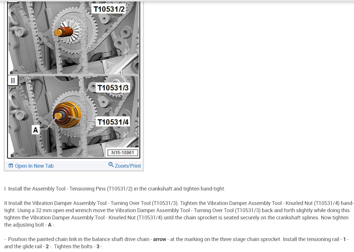

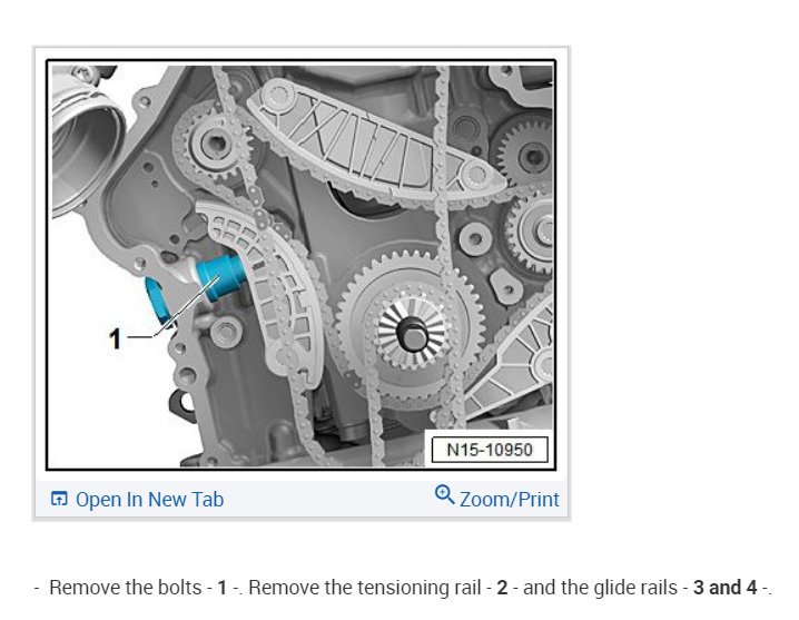

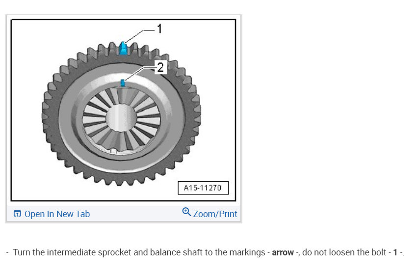

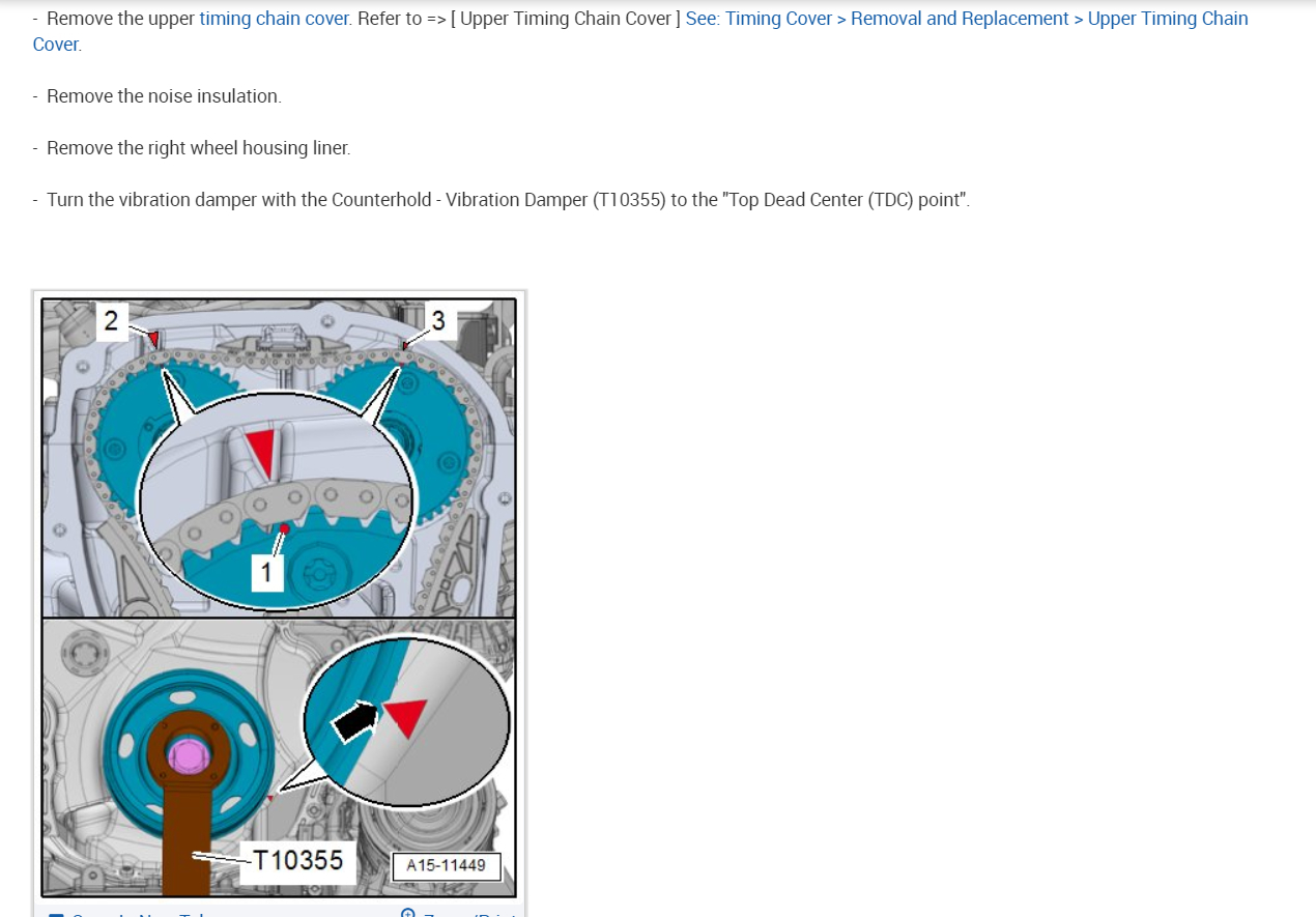

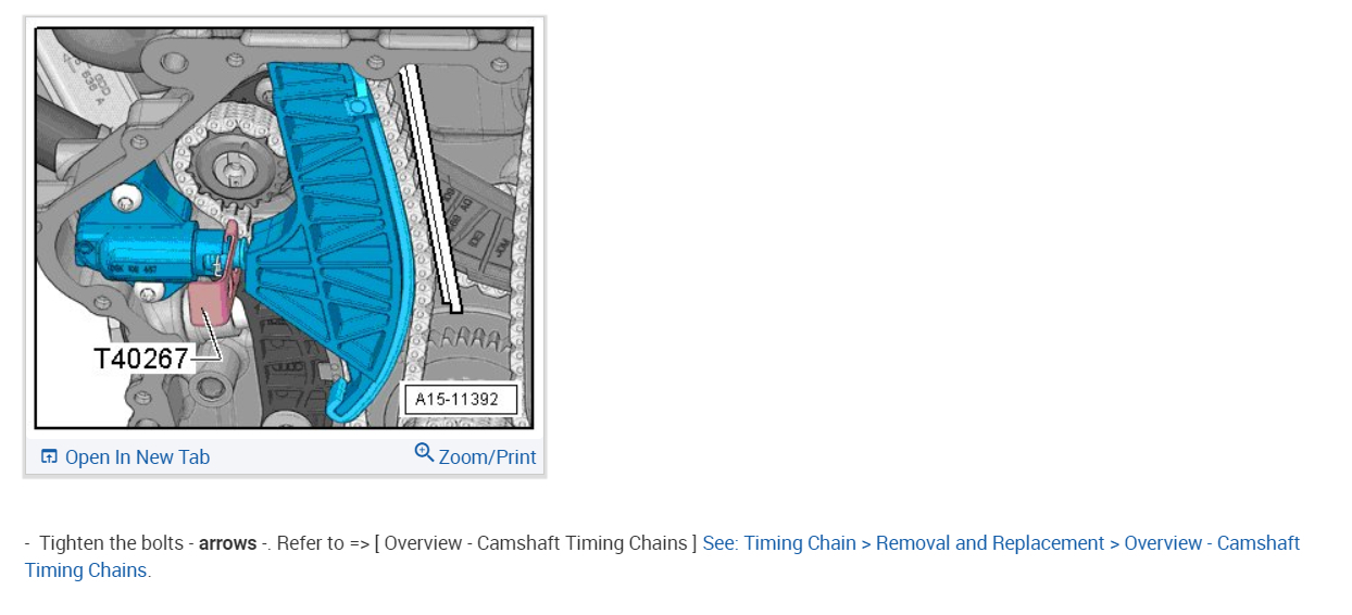

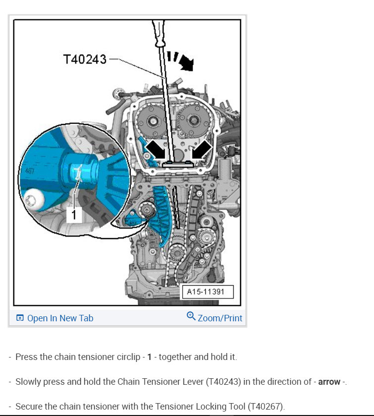

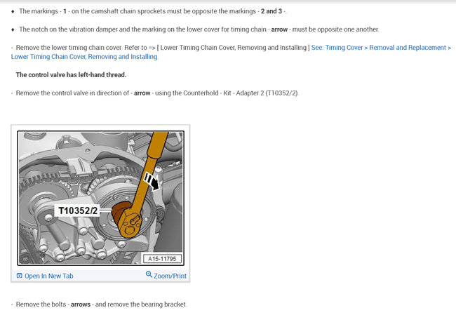

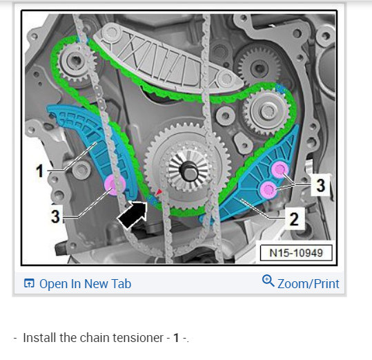

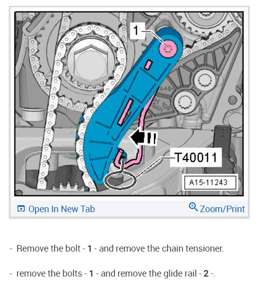

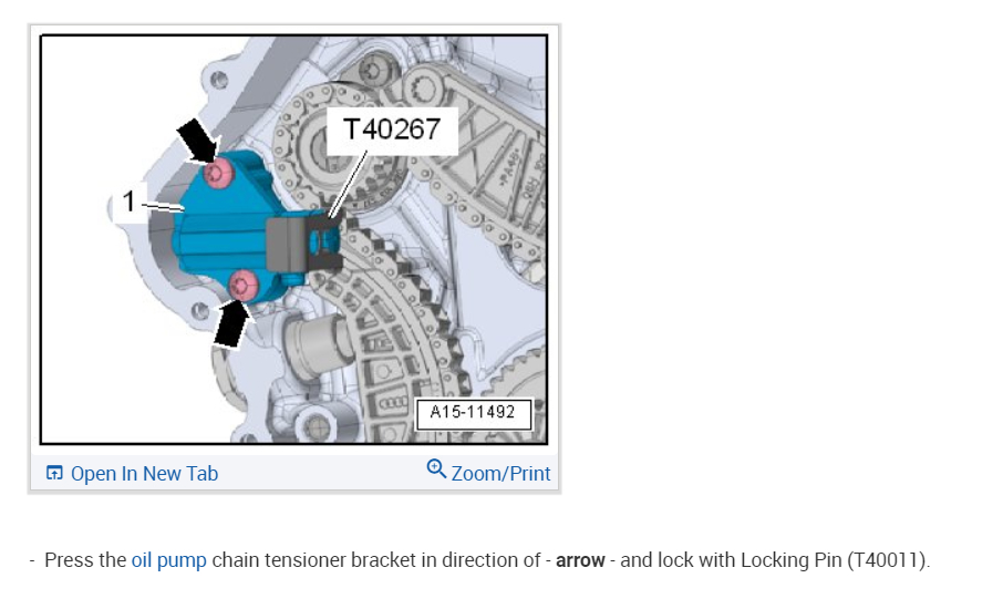

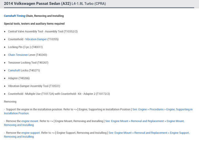

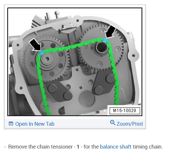

So I removed the rubber cover on lower timing chain cover and the tensioner is about reaching its limit. So I put it inside my garage and I would need to do a chain job on it before it's too late, I guess the chain has stretched. I know it needs special tools but I always invest in tools. Doing a job like this and since timing is off, would you start by removing the chain where it is now and then time everything then put in the new chain? Or would you put it in time first then move on? My thing is how will I put a car in time if the chain has already stretched? It would not sign up.
Thursday, June 25th, 2020 AT 6:09 AM
KEN L
  • MASTER CERTIFIED MECHANIC
  • 48,654 POSTS

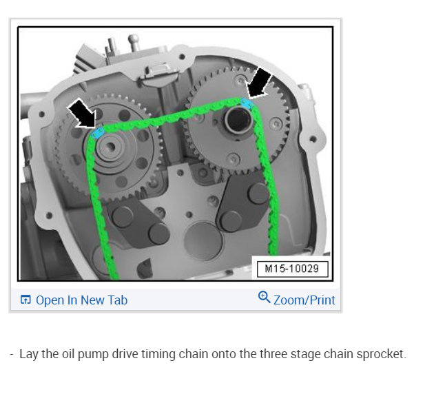

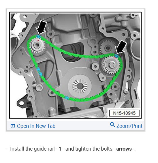

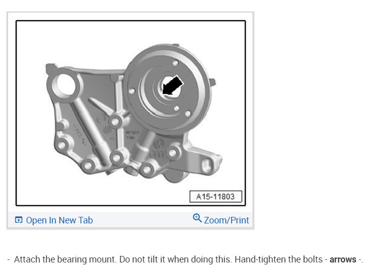

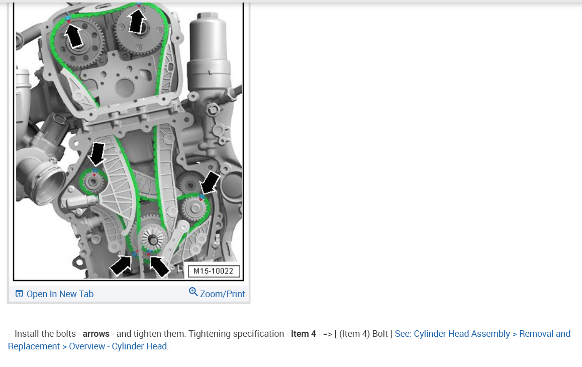

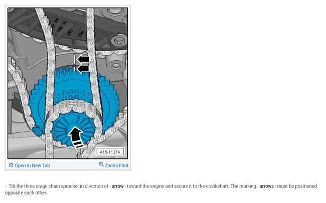

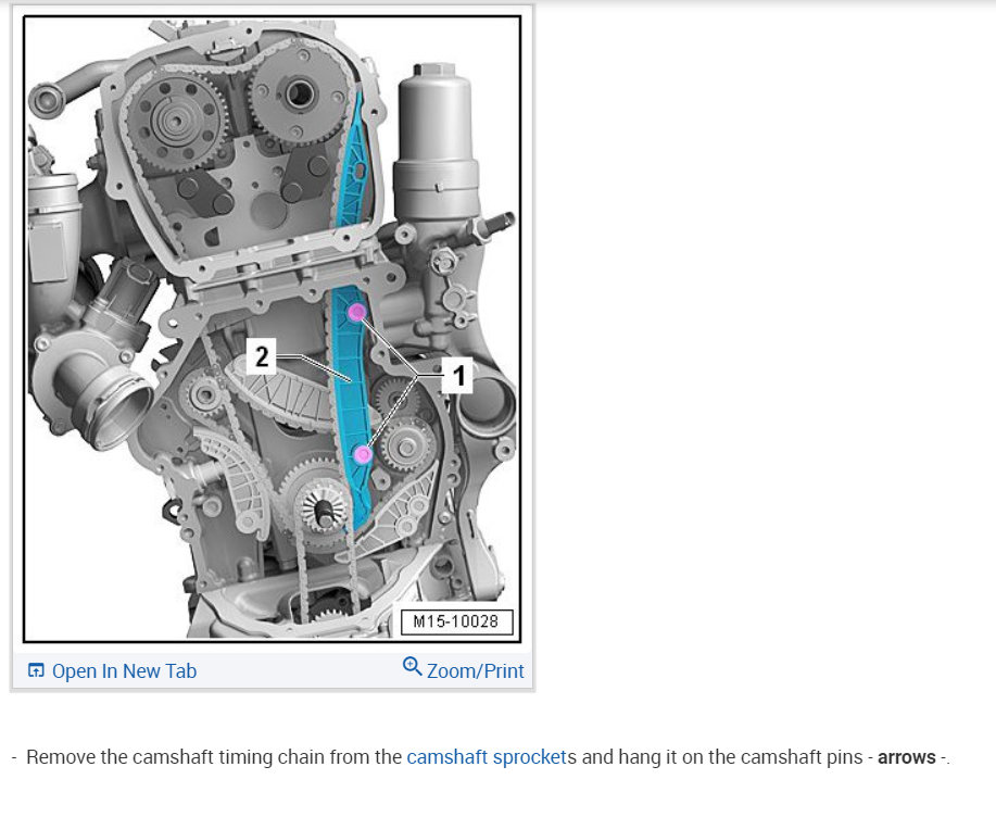

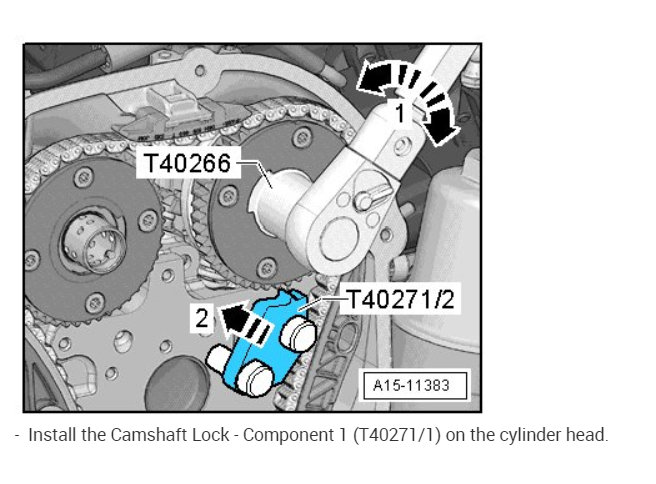

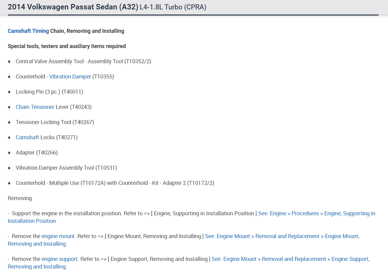

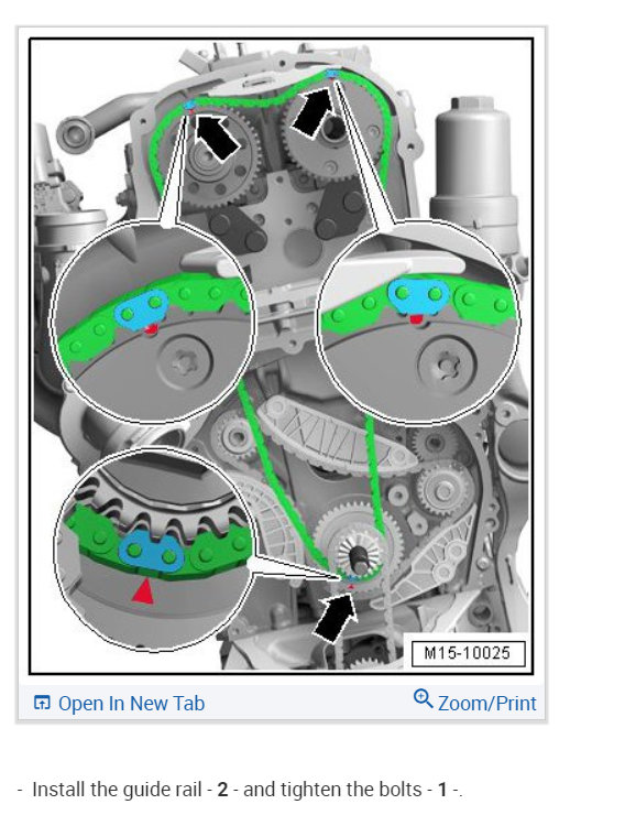

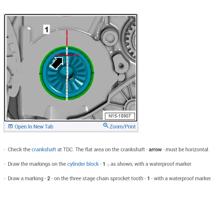

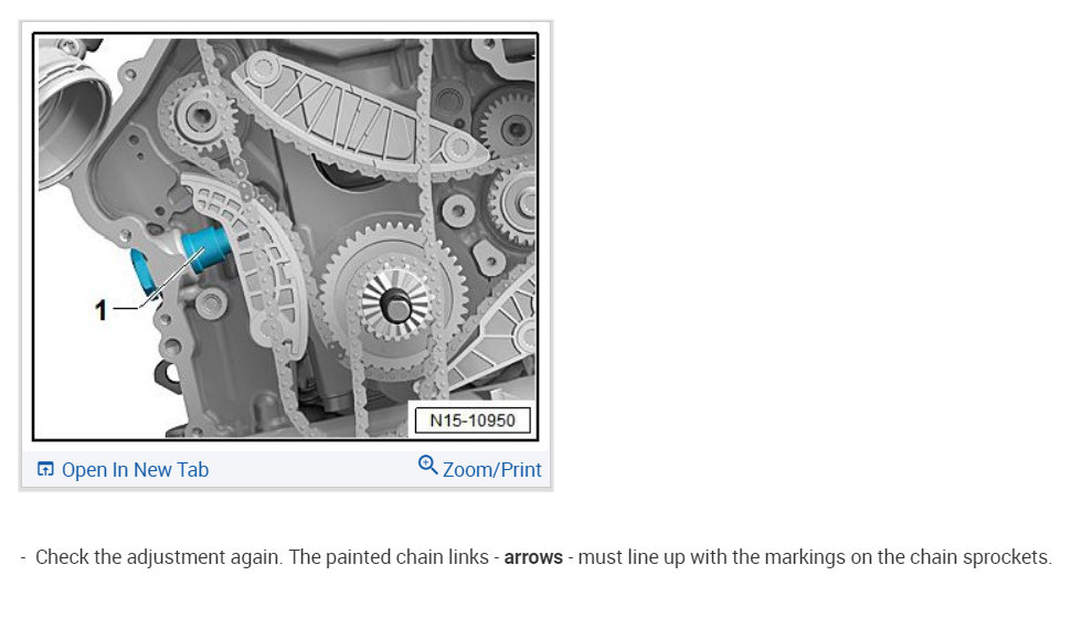

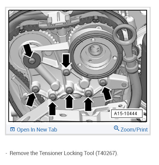

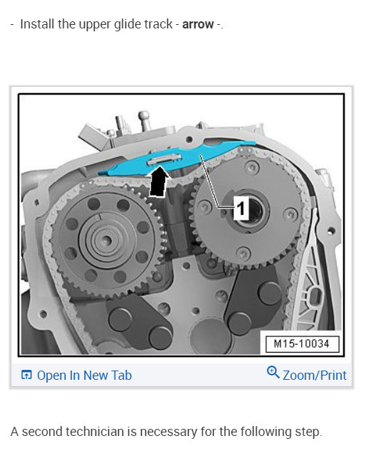

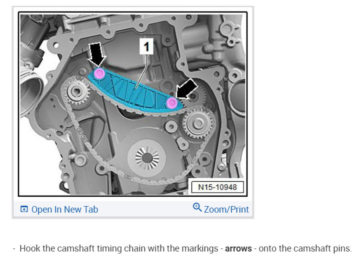

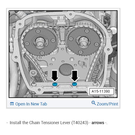

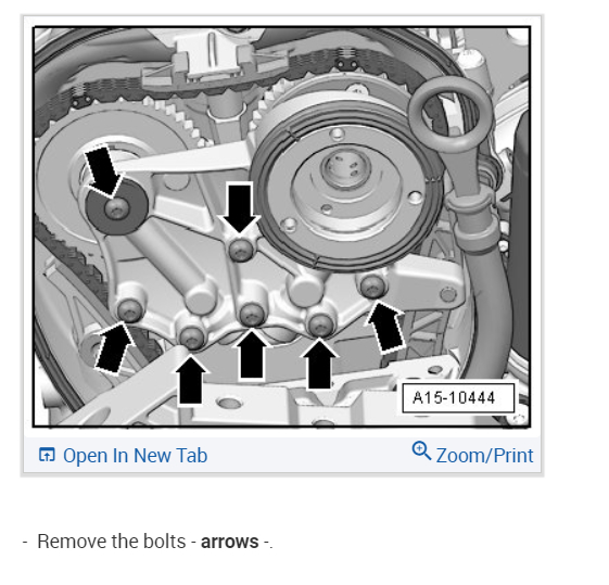

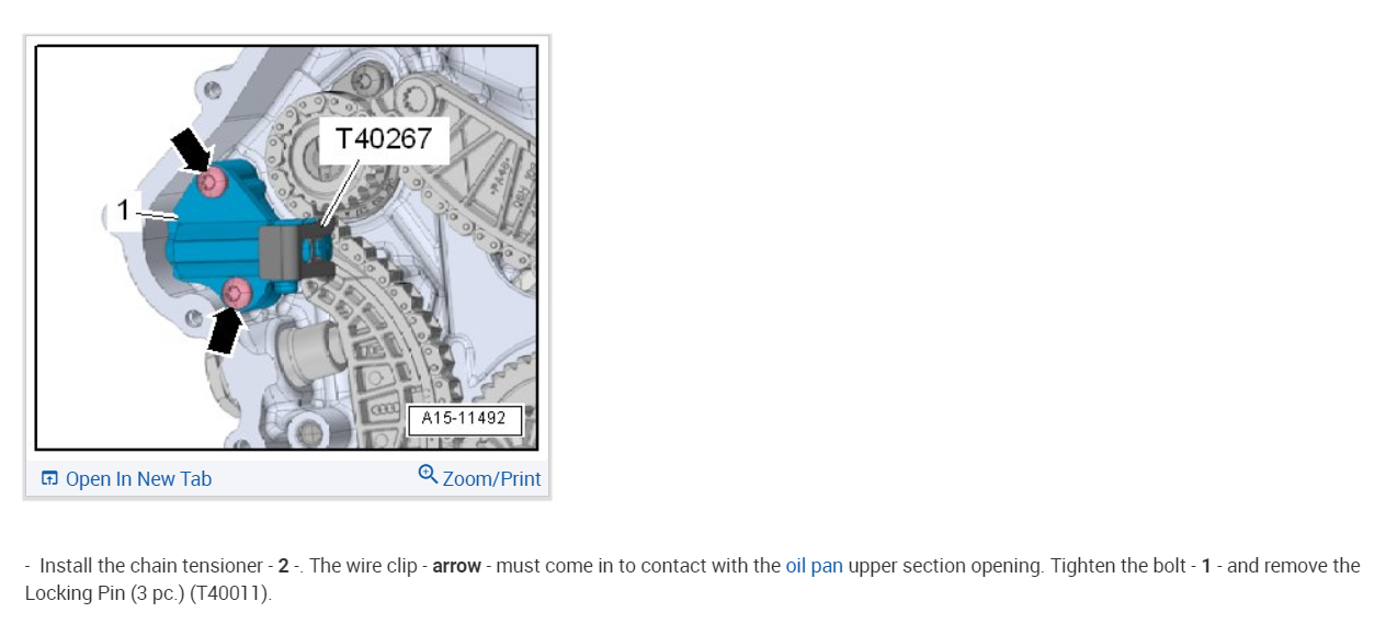

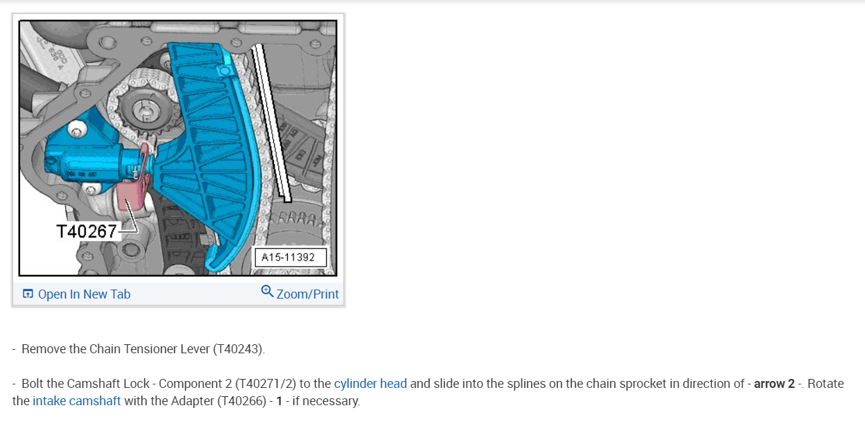

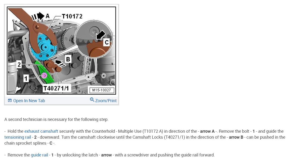

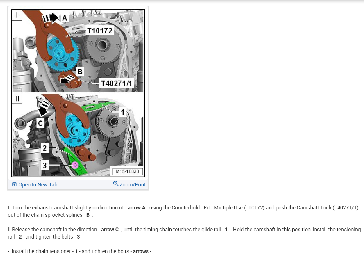

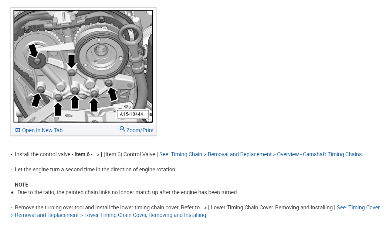

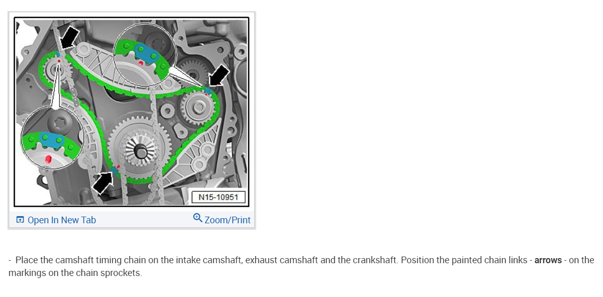

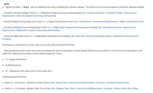

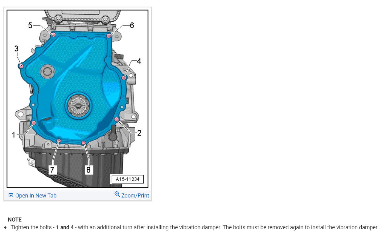

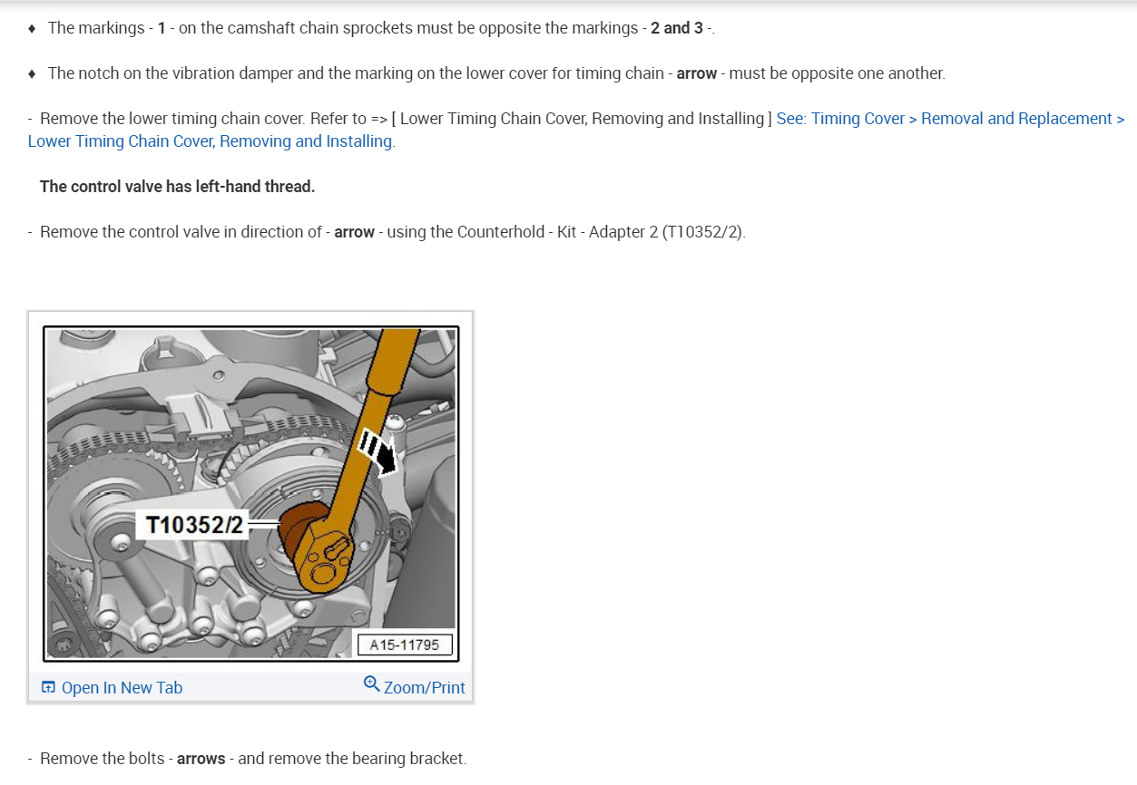

I though it could be the chain. Here are instruction int he diagrams below to show you how to do the job. Check out the diagrams (below). Please let us know what happens.
Thursday, June 25th, 2020 AT 11:44 AM
NASER NASER
  • 836 POSTS
I appreciate it a lot. But how you address it? If it's stretched and cannot be aligned. How would I go about beginning? I ordered the kit for all these tools. Or it doesn't matter right now since its out of timing.
Thursday, June 25th, 2020 AT 11:49 AM
KEN L
  • 48,654 POSTS
Order the new timing kit then realign the marks you should be all set.
Thursday, June 25th, 2020 AT 11:51 AM
NASER NASER
  • 836 POSTS
What am asking is, I cannot align it first before removing the chain, because the chain is stretched. So would you leave it like it is, remove the chain, realign and install?
