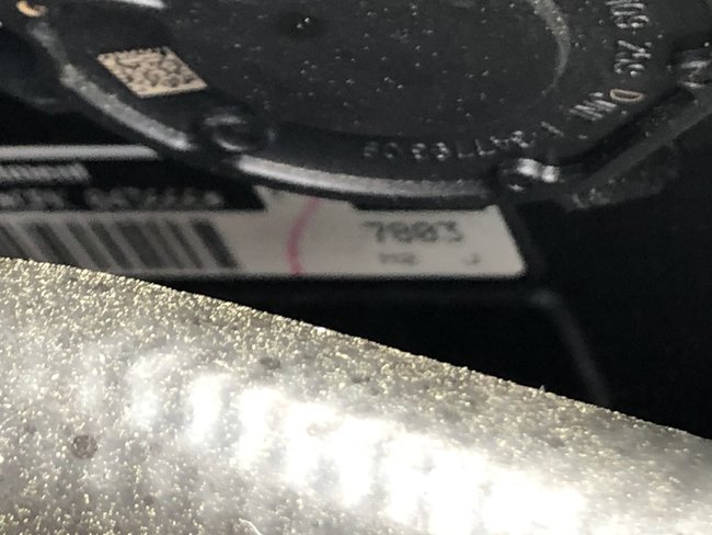

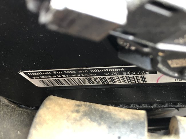

Hey, I need a production date and if it falls under the CPKA or CPRA engine code. There's a sticker just below the cam phaser that has a bar-code on it. The engine code is by the bar-code.
The two codes you have that I feel are the cause of the issue relate to the cam and crank sensors. Something is not timed correctly.
Jun 2, 2020 at 12:20 PM

It should be near the timing cover. If you can't find it, there should be a number stamped on the top of the engine block where it attaches to the trans. It really only deals with emissions designs, but I want to get the right info. If you are in CA or in a state that requires CA emissions, then chances are it is a CPRA.
Jun 2, 2020 at 1:11 PM
NASER NASER
  • 836 POSTS
Has been a Florida car all its life time, am in Alabama. I will check and see what i can find.
Jun 2, 2020 at 1:28 PM
NASER NASER
  • 836 POSTS
Here.
Jun 3, 2020 at 1:49 AM
NASER NASER
  • 836 POSTS
It says there was an answer to the question, but i don't see one.
Jun 3, 2020 at 2:29 PM

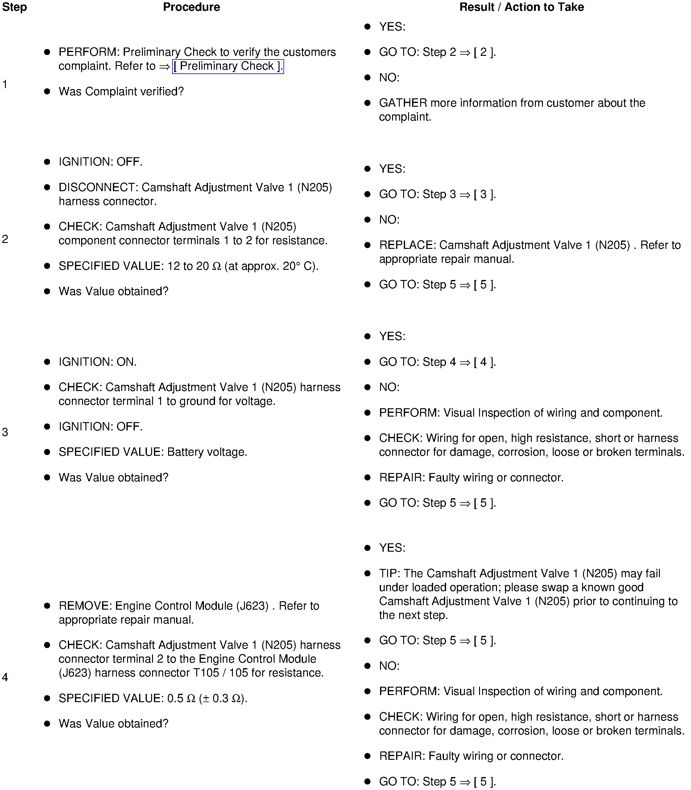

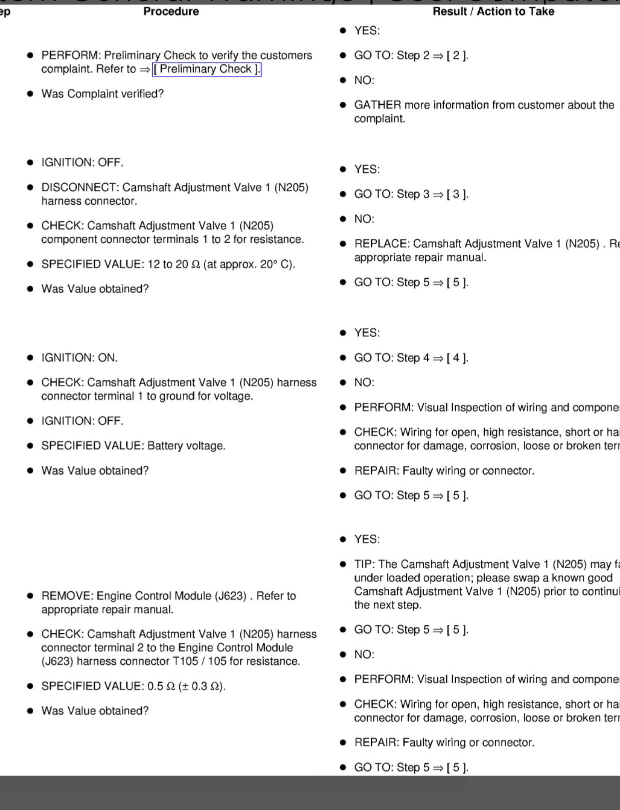

P0016
2014 Volkswagen Passat Sedan (A32) L4-1.8L Turbo (CPKA)
Camshaft Adjustment Valve 1 (N205), Checking
Vehicle Powertrain Management Computers and Control Systems Testing and Inspection Component Tests and General Diagnostics Camshaft Adjustment Valve 1 (N205), Checking
CAMSHAFT ADJUSTMENT VALVE 1 (N205), CHECKING
General Description
The camshaft's task is to operate the valves at the right time and in the right order to control the charge cycle. Camshaft adjustment using the Camshaft Adjustment Valve 1 (N205) varies the opening times of the valves to suit all operating conditions. This ensures ideal charge cycles within a wide range of engine speeds and loads. Fuel consumption and pollutant emissions are reduced, torque and smoothness increased. In engines with a double overhead camshaft the size and positioning of the valve opening overlap can be influenced, enhancing characteristics in full-load and part-load operation. In continuous camshaft adjustment, the adjustment is infinitely variable within specific parameters.
Special tools, testers and auxiliary items required
Multimeter.
Wiring Diagram.
Scan Tool.
Test requirements
Fuses OK.
Battery voltage OK.
Switch OFF All electrical and electronic accessories.
Vehicles with Auto. Transmission, ensure Selector Lever position is in "P".
Vehicles with Manual Transmission, ensure Shifter Lever position is in "N" with Parking Brake applied.
Coolant Temperature: 80° C.
Observe all safety precautions: [ Safety Precautions ] See: Computers and Control Systems > Technician Safety Information > Generic Scan Tool.
View clean working conditions: [ Clean Working Conditions ] See: Computers and Control Systems > Technician Safety Information > Generic Scan Tool.
For Hybrid vehicles refer to: [ High Voltage System General Warnings ] See: Computers and Control Systems > Technician Safety Information > High Voltage System General Warnings.
Test Procedure
Pics 1 and 2
Jun 4, 2020 at 2:03 PM

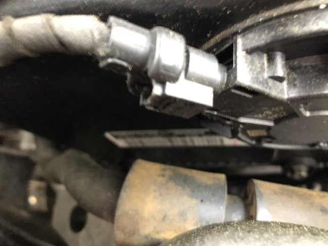

in the first part where you describe the camshaft adjustment valve N205 , and camshaft position sensor in the second part, where are those located? In the first part for the N205, are they asking to test the resistance on the harness ins or the sensor's pins?
Jun 14, 2020 at 12:46 AM
  • 110,244 POSTS

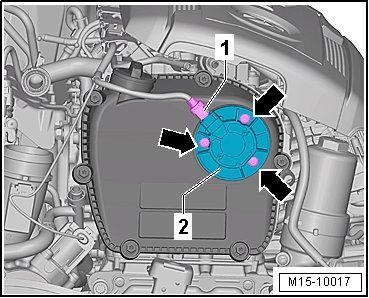

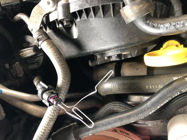

Naser, that is for the harness, pins 1 and 2.
Remove the engine cover to access the adjustment valve (N205). The attached directions and pic refer to removal.
Camshaft Adjustment Valve 1 (N205), Removing and Installing
Removing
- Remove the engine cover. Refer to => [ Engine Cover, Removing and Installing ] See: Access Cover, Engine > Removal and Replacement > Engine Cover, Removing and Installing.
- Unclip the coolant and fuel lines and set them aside.
- Disconnect the connector - 1 - from the Camshaft Adjustment Valve 1 (N205).
pic 1
- Remove the bolts - arrows - and then the Camshaft Adjustment Valve 1 (N205)
Jun 14, 2020 at 10:15 AM

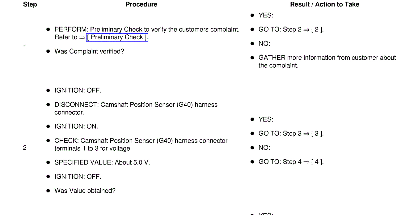

Found camshaft position sensor, voltage at terminals 1 and 3 is 5 v with ignition on.
Jun 19, 2020 at 7:12 AM
  • 110,244 POSTS

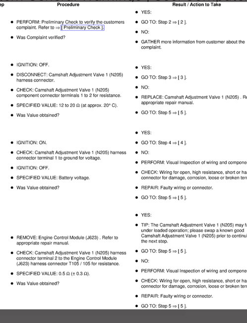

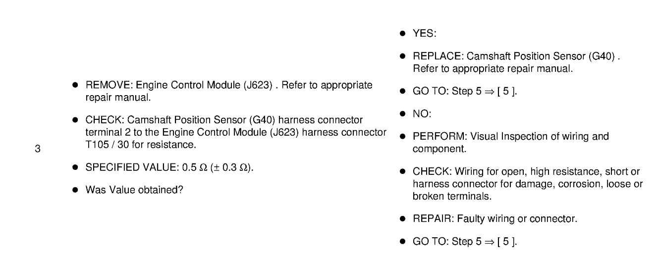

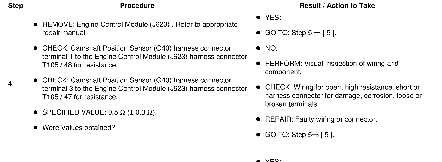

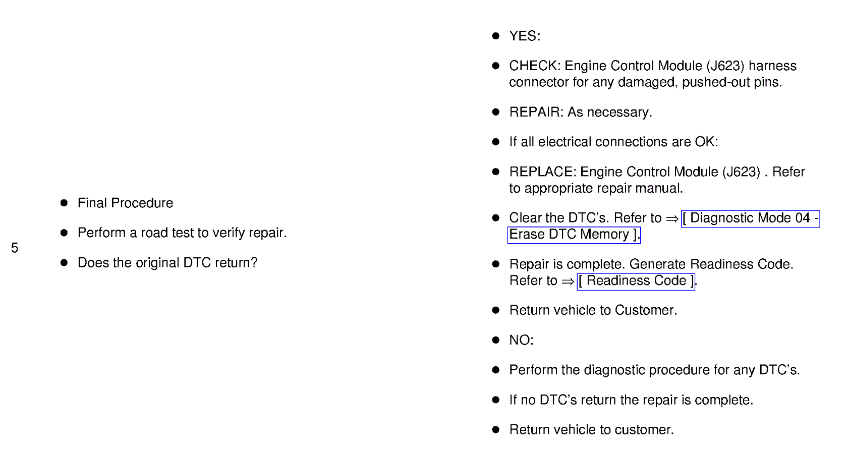

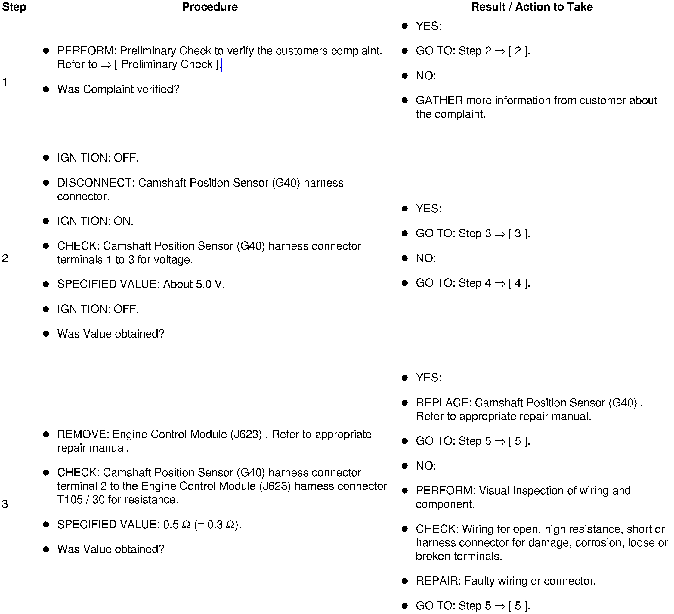

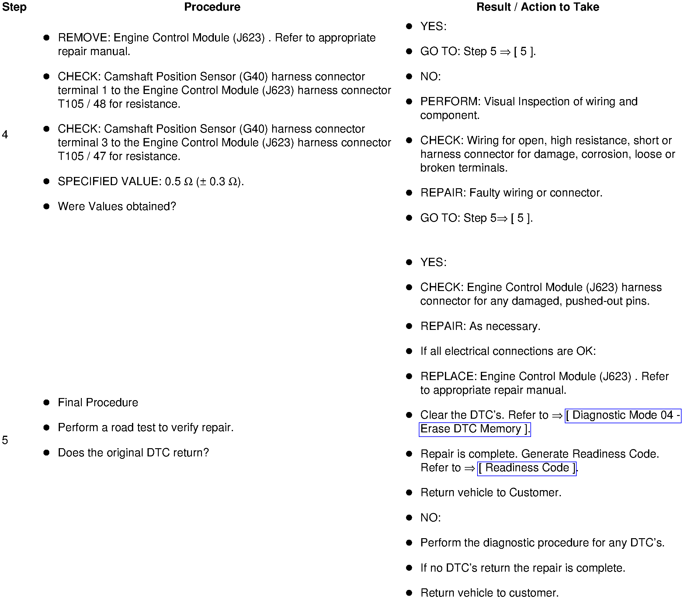

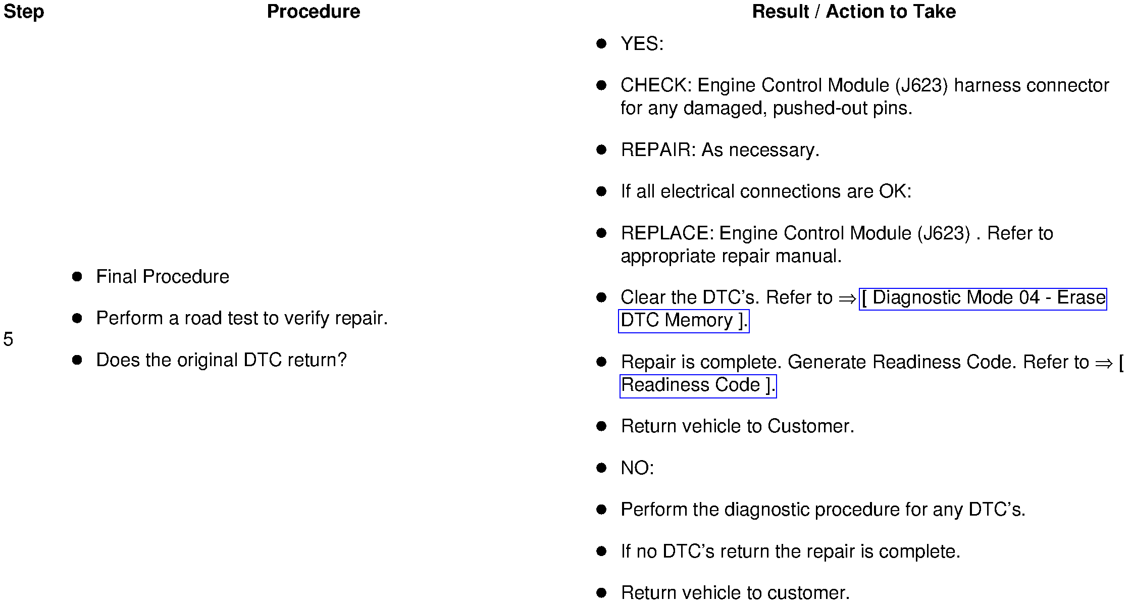

The voltage is spot on. I attached 4 pictures below. They are the diagnostics specific to this issue. Take a look through them and let me know if you have questions.
The pictures are in order of testing.
Jun 19, 2020 at 12:10 PM
NASER NASER
  • 836 POSTS
Harness connector terminal they mean the connector pin?
Where is the engine control module located? And when they say remove it meaning just unplug it?
Am guessing we looking for continuity issues?
Are the engine control module connectors usually labeled?
What about the fact that there is nothing i can get out of the camshaft adjustment valve?
Sorry trying to get my head around it. Am hoping it's not a chain/timing issue.
Jun 19, 2020 at 12:17 PM

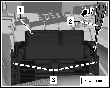

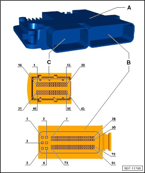

  • 110,244 POSTS

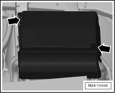

As far as labels, I attached info and a pic (pic 1) related to pin locations. Yes, you need to confirm continuity.
Unplug the module, but make make sure the battery is disconnected before you disconnect or connect the ECM.
Under the hood. Remove the E-box cover inside the engine compartment (see pic 2) to access the ECM. See pic 3
Engine Control Module -J623-
Vehicle Powertrain Management Relays and Modules - Powertrain Management Relays and Modules - Computers and Control Systems Engine Control Module Locations Components Engine Control Module -J623-
ENGINE CONTROL MODULE -J623-
Control Modules
Engine control module -J623-
154-pin, Pin Arrangements:
pic 1
A - Engine control module -J623-
Connector:
B - 94-pin connector -T94- on wiring harness
C - 60-pin connector -T60- on wiring harness
Note:
154-pin connector -T154- consists of connectors
B and C

Please let me know what you mean by you can't get anything from the camshaft adjustment valve..
Jun 19, 2020 at 12:50 PM
NASER NASER
  • 836 POSTS
For p016 you sent me some instructions on checking the camshaft adjustment valve, so i followed it and found no resistance between the two pins in the harness connector. Also not getting voltage between either of the pins and ground. The sheet is attached.
Jun 19, 2020 at 1:08 PM
  • 110,244 POSTS
Are you checking the component or the harness for resistance? The resistance should be when checking the component. If there is no resistance, then it's bad. When you check the harness side, that is where power should be. If there is none, then you need to start tracing wiring to see where the open is. However, before going crazy, make sure there is continuity to ground via the harness. If there is no ground, it will show no power.
I hope that makes sense.
Jun 19, 2020 at 1:35 PM
NASER NASER
  • 836 POSTS
I think I misunderstood you when I asked previously, I checked resistance between the pins on the harness, I think I tried to check resistance between pins on the sensor unit and no reading was found. So check if there is continuity between the harness pins and ground? what should it show on the multi-meter?
Jun 19, 2020 at 1:43 PM

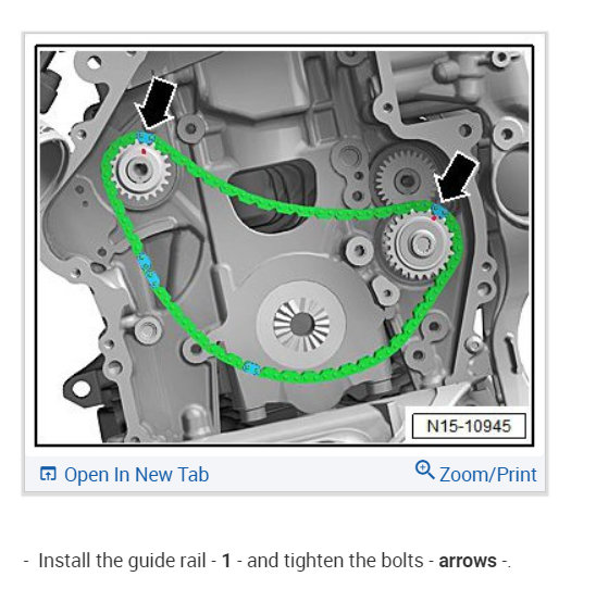

Jun 20, 2020 at 6:16 PM

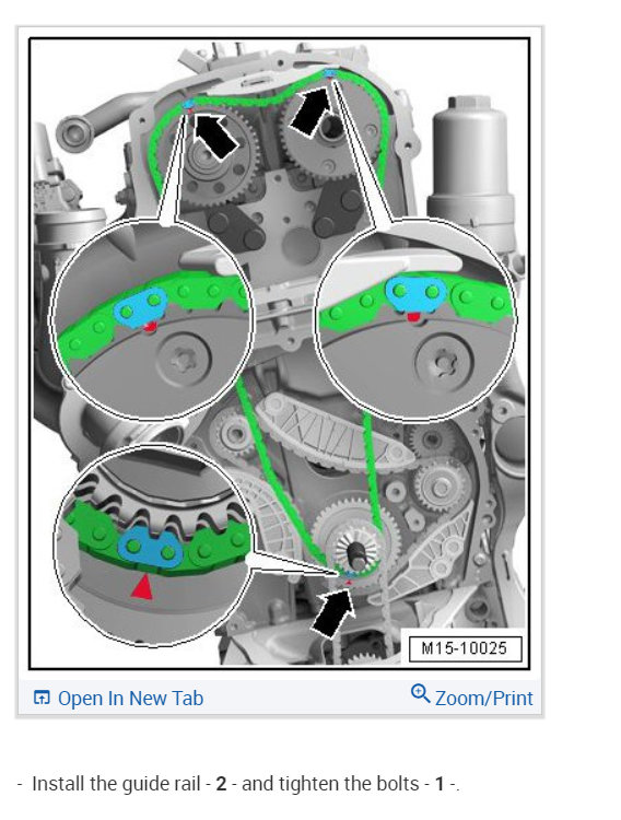

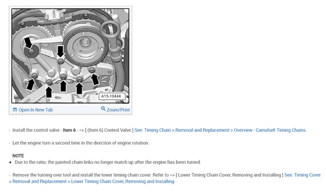

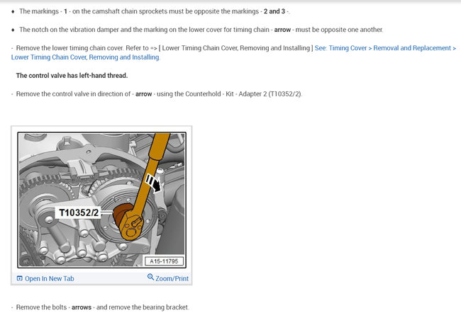

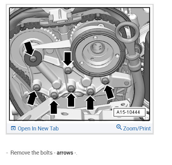

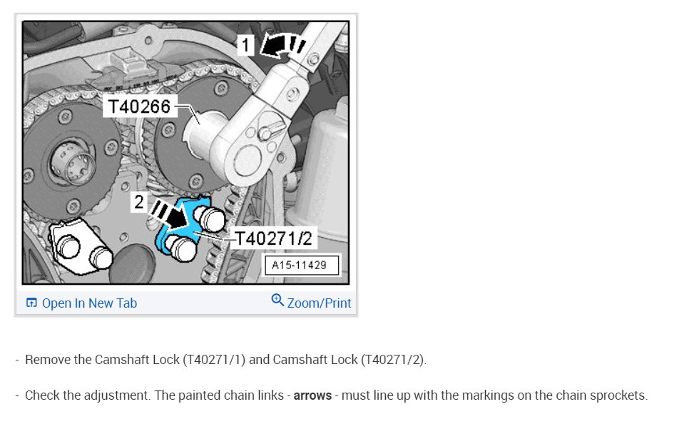

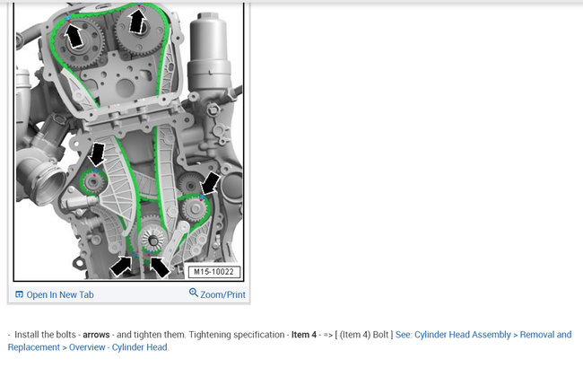

  • 55,433 POSTS

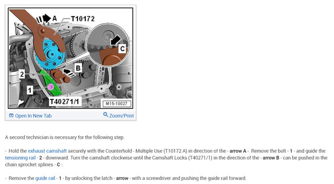

Yes, the cam codes and the noise is telling us the camshaft phaser is worn out or the oil pump pick up screen is plugged. can you look inside the valve cover to check for oil sludge build up please? If so remove the oil pan to clean the screen. Can you please shoot a quick video with your phone so we can see what's going on? that would be great. You can upload it here with your response.
Jun 22, 2020 at 3:10 AM
NASER NASER
  • 836 POSTS
But sludge would cause it not to have any power? Maybe due to sludge in the valve cover and the sensors not able to read?
Jun 22, 2020 at 3:20 AM

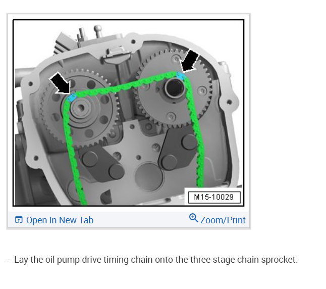

  • 55,433 POSTS
Yes, if there is no oil pressure getting to the phaser the camshaft is fully retarded. Or the timing chain/belt could have jumped a tooth causing the noise and low power.
Jun 23, 2020 at 4:44 AM
NASER NASER

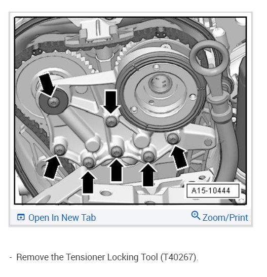

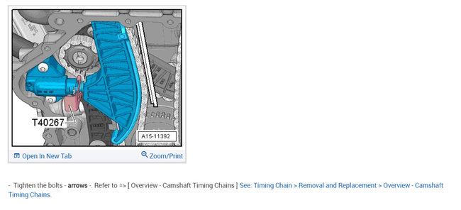

  • 836 POSTS

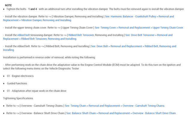

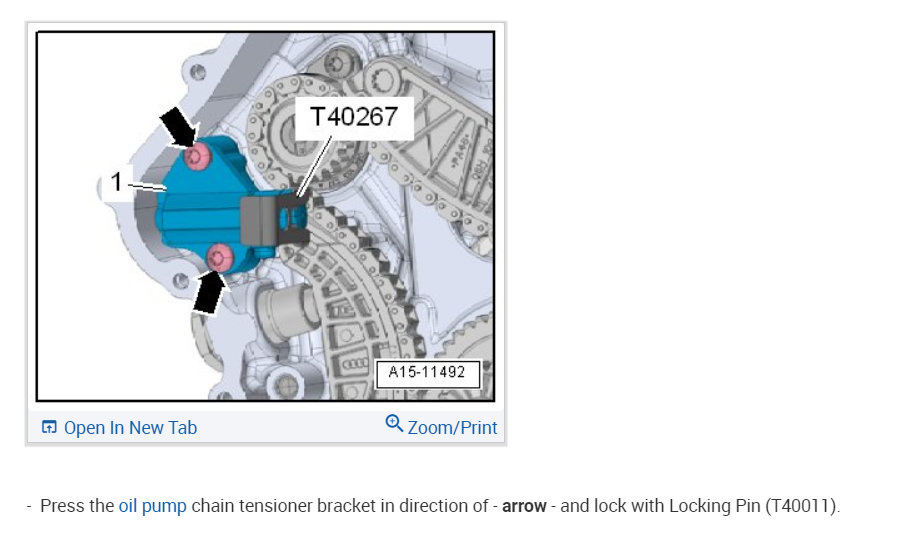

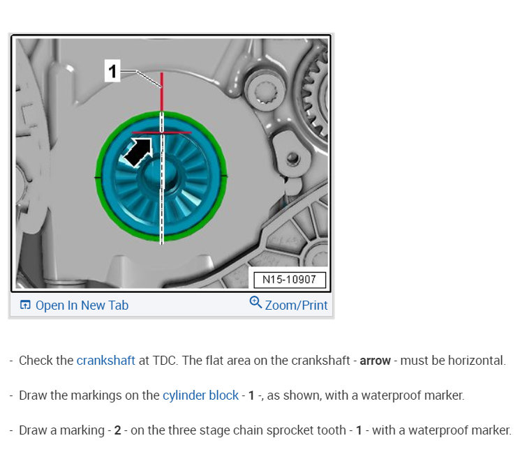

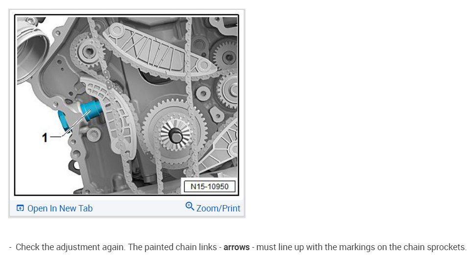

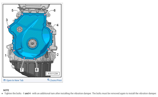

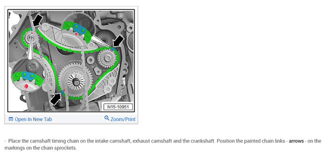

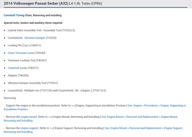

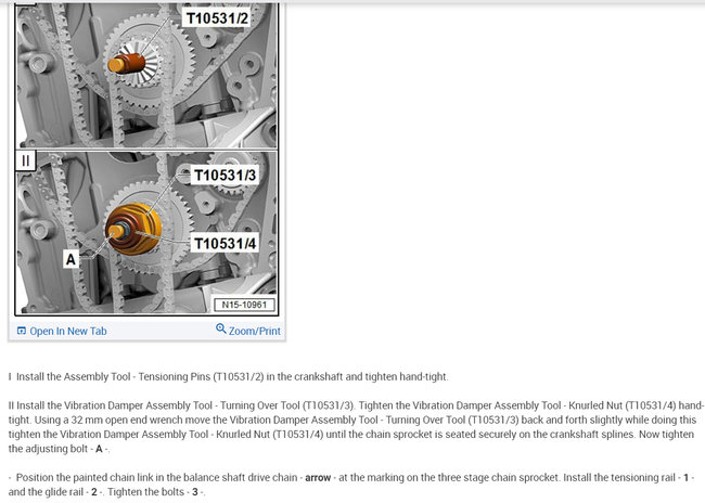

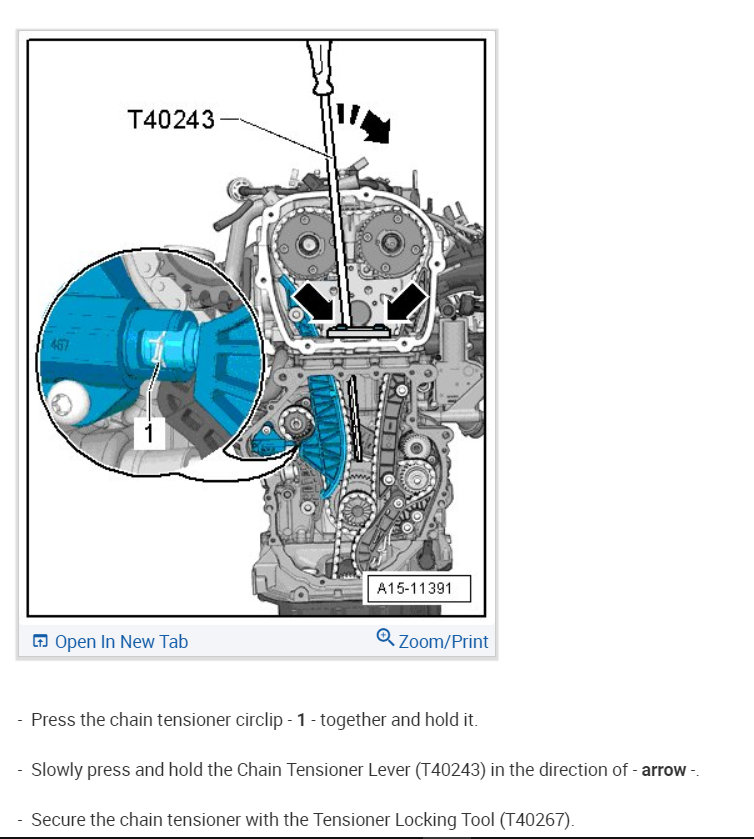

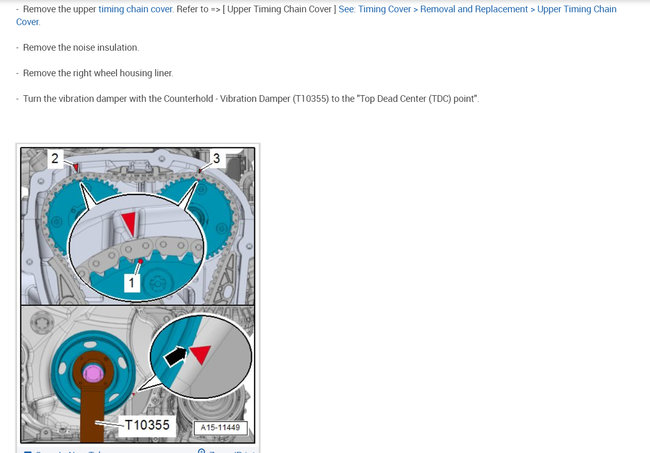

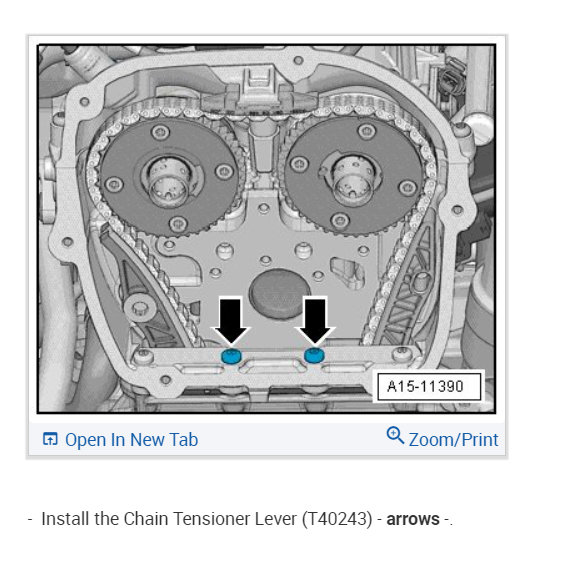

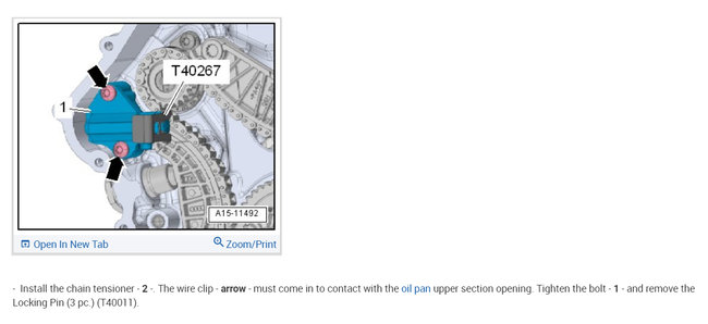

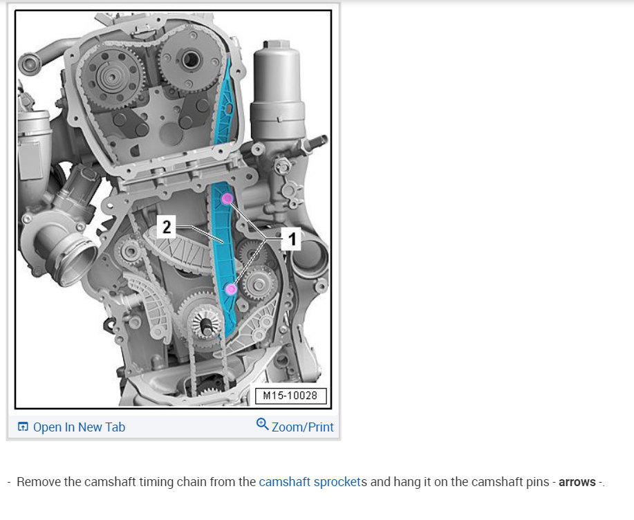

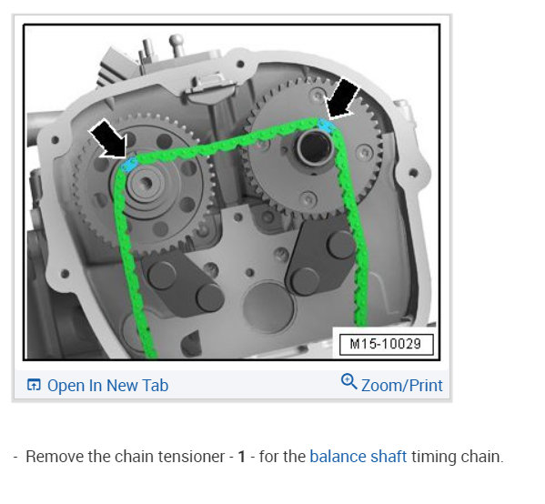

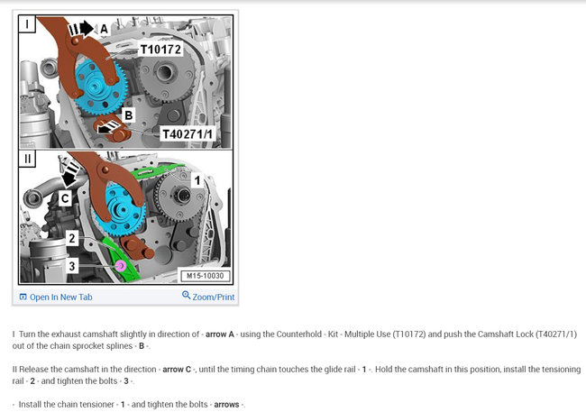

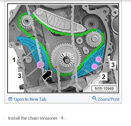

So I removed the rubber cover on lower timing chain cover and the tensioner is about reaching its limit. So I put it inside my garage and I would need to do a chain job on it before it's too late, I guess the chain has stretched. I know it needs special tools but I always invest in tools. Doing a job like this and since timing is off, would you start by removing the chain where it is now and then time everything then put in the new chain? or would you put it in time first then move on? My thing is how will I put a car in time if the chain has already stretched? it would not sign up.
Jun 24, 2020 at 11:09 PM

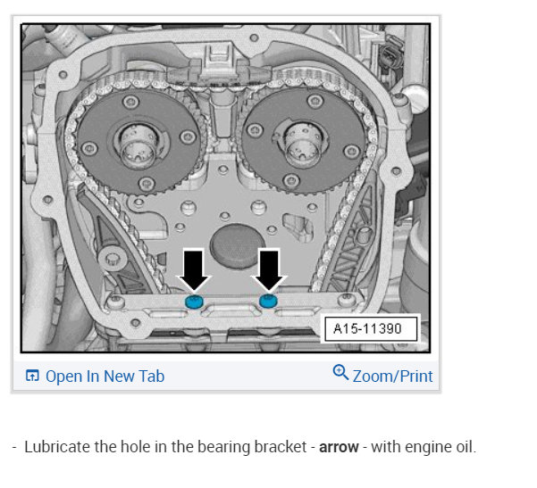

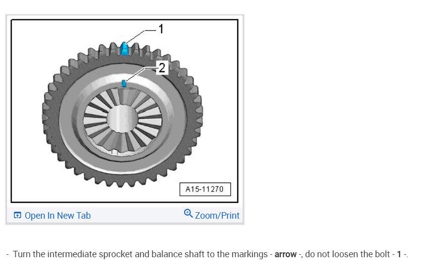

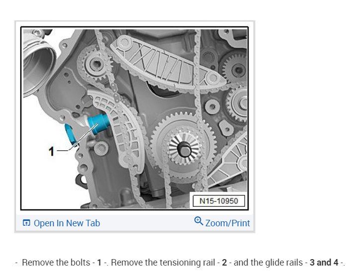

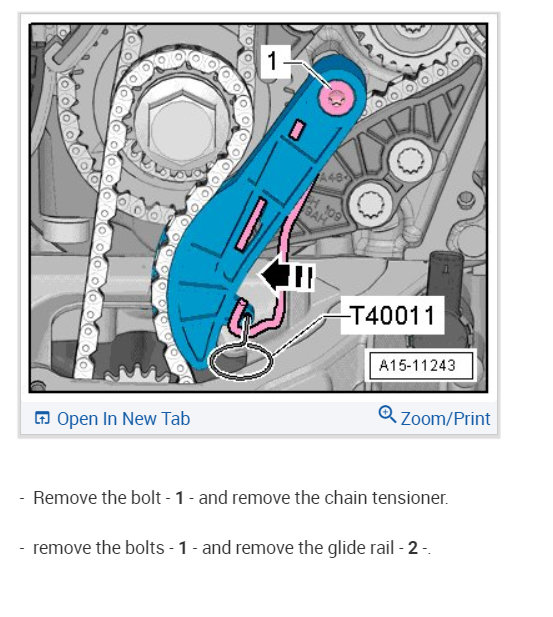

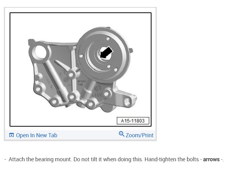

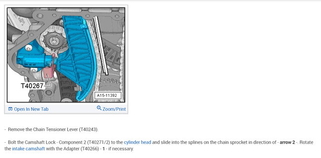

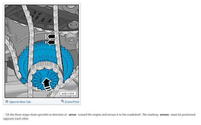

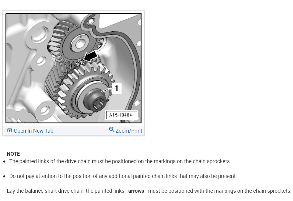

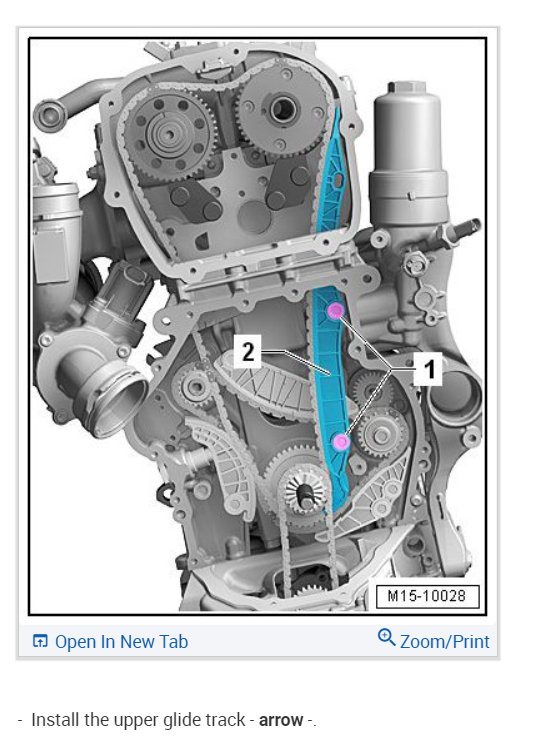

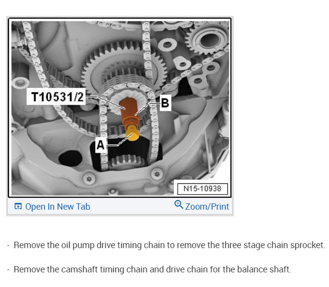

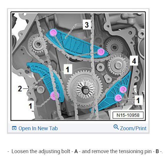

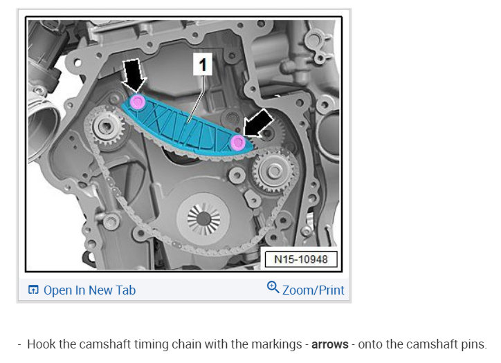

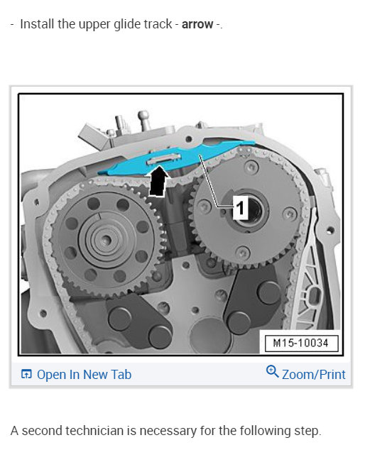

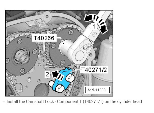

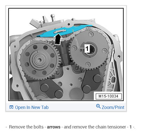

  • 55,433 POSTS
I though it could be the chain. here are instruction int he diagrams below to show you how to do the job. Check out the diagrams (below). Please let us know what happens.
Jun 25, 2020 at 4:44 AM
NASER NASER
  • 836 POSTS
I appreciate it a lot. But how you address it? If it's stretched and cannot be aligned. how would i go about beginning? I ordered the kit for all these tools. Or it doesn't matter right now since its out of timing.
Jun 25, 2020 at 4:49 AM
  • 55,433 POSTS
Order the new timing kit then realign the marks you should be all set.
Jun 25, 2020 at 4:51 AM
NASER NASER
  • 836 POSTS
what am asking is, I cannot align it first before removing the chain, because the chain is stretched. So would you leave it like it is, remove the chain, realign and install?
Jun 25, 2020 at 5:09 AM
