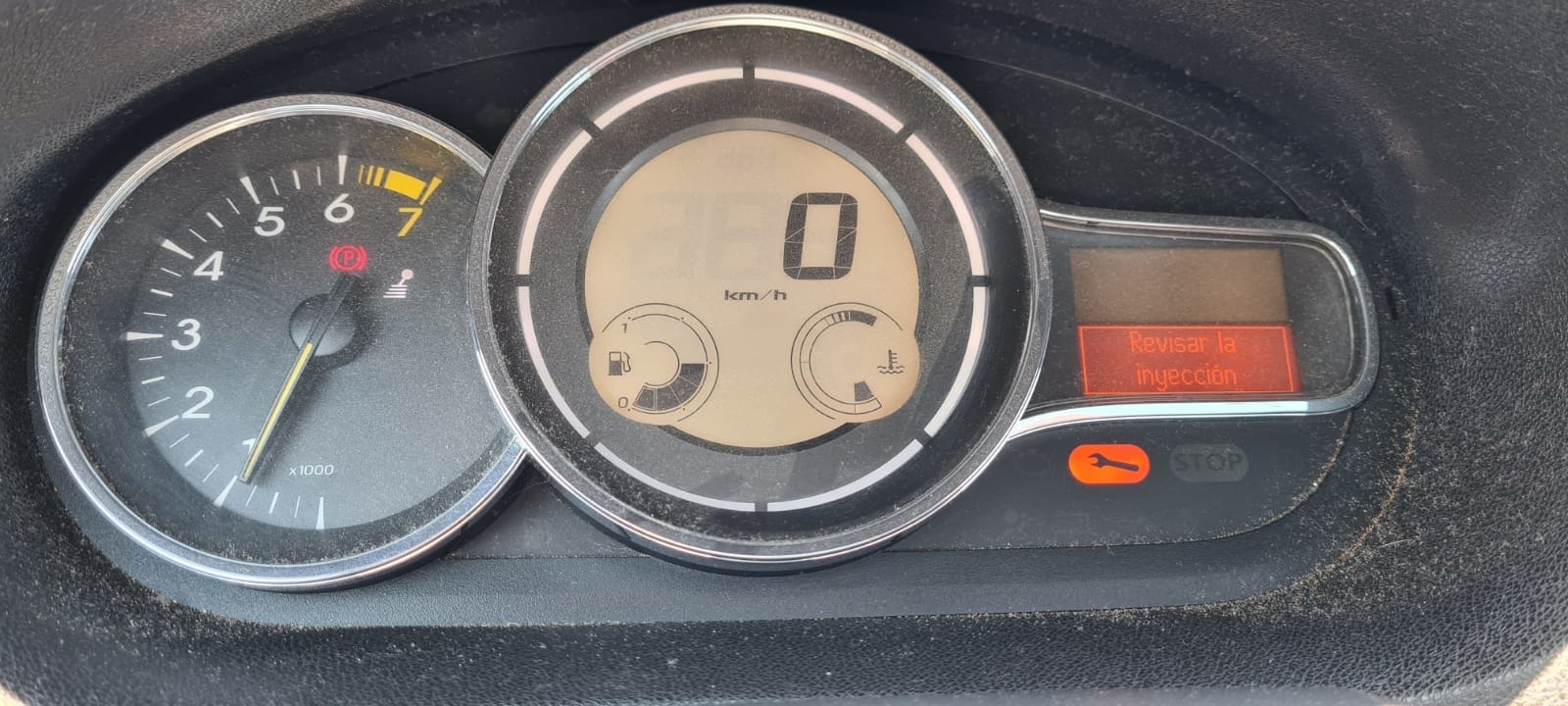

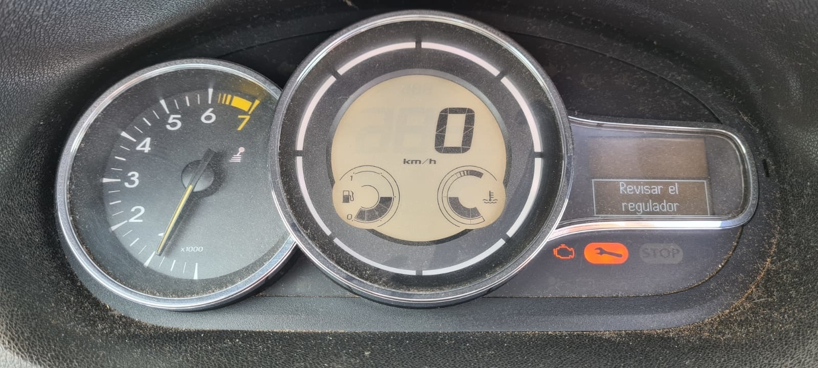

SAMANTHA HAINSWORTH
  • 14 POSTS
These are the warning lights that show up. The air conditioning or cruise control does not work either.!!!
Jul 29, 2021 at 12:23 AM
  • 110,244 POSTS
I believe that indicates an issue with the fuel injection system. (I think it's Spanish, correct?). The people who replaced the engine would have had that apart. Have you contacted them?
Jul 29, 2021 at 6:26 AM

  • 110,244 POSTS
It could indicate a fuel pressure issue, an injection issue, or anything related to the fuel supply. Was the vehicle still running okay with the light on?
Jul 30, 2021 at 1:18 PM
