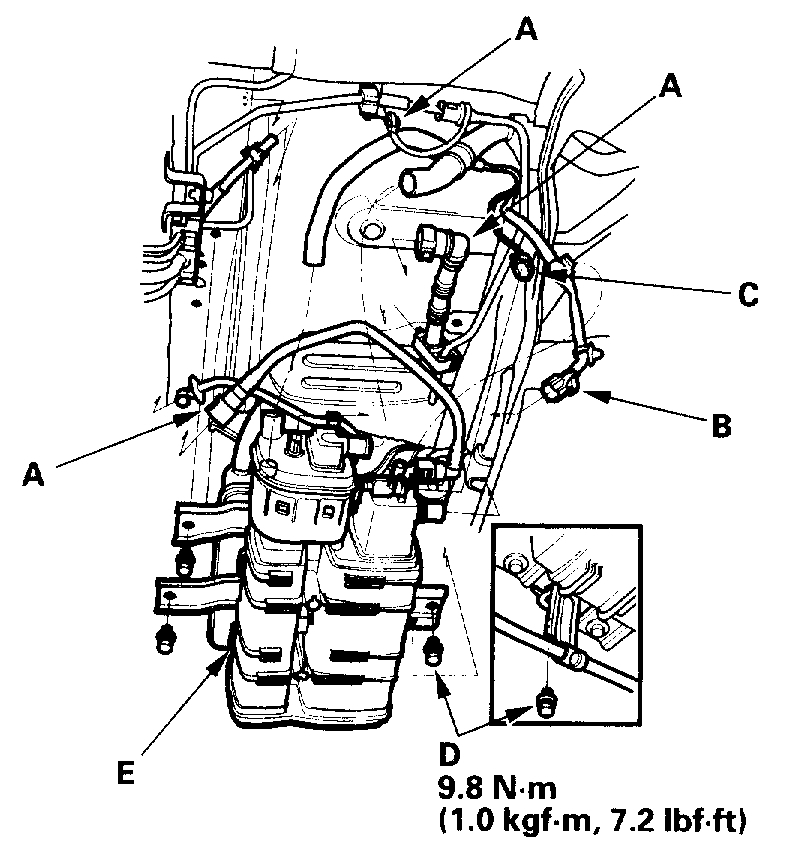

The car is thirteen years old. I have replaced all parts over the years runs great passed smog last year no problems. about a month ago had catalytic converter replaced and o2 sensor down side and replaced the old gas cap with new factory one. today check gas cap came on one hour, then check engine light came on. the codes came on last week po497 and po455 brought back to mechanic tested the EVAP valve which was replaced two months ago it was okay. this leak sounds like it might be a hose. the engine light never came on last year. just within the last three months. like I said the car runs great for the mileage. I have to bring it back on Monday to do smoke test. they said the leak if there is one they will find it. please advise crazy leak.

I have to be honest. The one code is most likely causing the other. There is a large leak in the EVAP system. In my mind, that is the cause of the low purge flow.
With that in mind, yes smoke testing will find the leak, but most times you can find a large leak without doing the test.
I don't know what you live, but if you are in an area where the roads are treated with salt and other chemicals, first check to see if the filler tube (where you add gas) is rusted. You will need to look under the vehicle to locate the fuller tube. It goes from where you add gas to the tank.
Next, check for disconnected or damaged hoses at the EVAP canister. Often times they will dry rot and leak. That canister itself may have even failed. The part is under the vehicle near the fuel tank. You have to simply remove a cover to locate it as well as the hoses related to it.

EVAP Canister Replacement
Picture 1

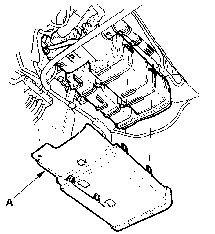

1. Remove the EVAP canister cover (A).
Picture 2
2. Remove the hoses (A), the FTP sensor 3P connector (B), and the EVAP canister vent shut valve 2P connector (C).
3. Remove the bolts (D)
4. Remove the EVAP canister assembly (E)

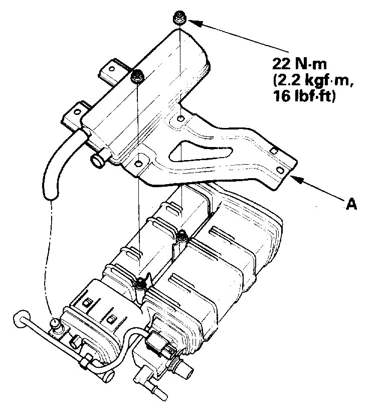

Picture 3
5. Remove the EVAP canister bracket (A).
6. Install the canister in the reverse order of removal

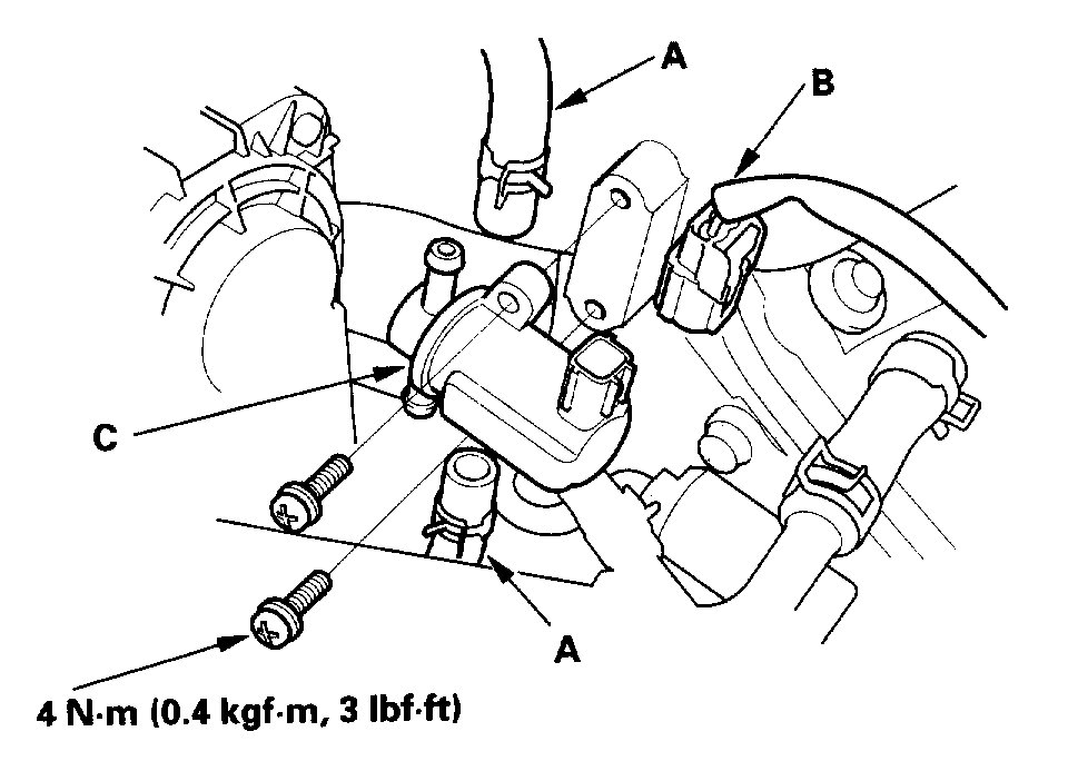

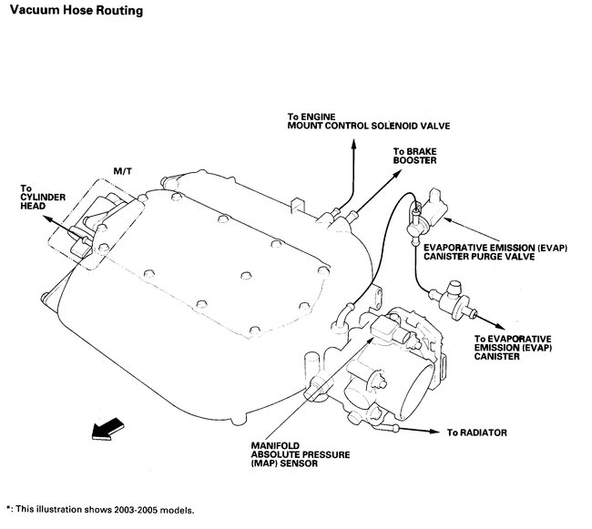

Next is the canister purge valve. It is located under the hood of the vehicle. See pic 4 for location. Check to make sure there are no disconnected or damaged hoses to it.
Here are the directions for replacing it. I'm adding them to help locate and see what is required for removal and inspection.
EVAP Canister Purge Valve Replacement
See Picture 5
1. Disconnect the hoses (A) and the EVAP canister purge valve 2P connector (B).
2. Remove the EVAP canister purge valve (C).
3. Install the valve in the reverse order of removal.
