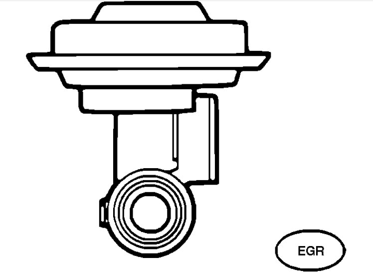

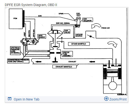

  • 110,244 POSTS

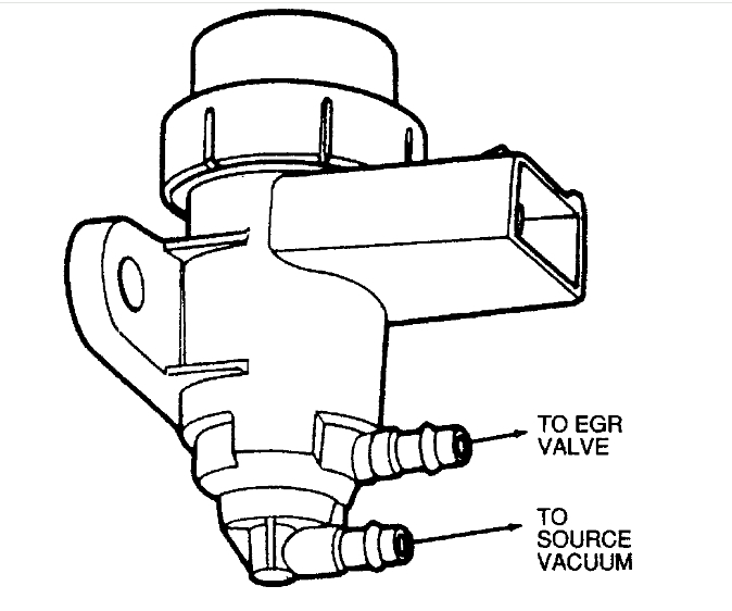

There is an EGR vacuum regulator solenoid (pic 1 below). It is a simple on or off switch. It should have two wires to it. The PCM regulates the vacuum it allows to reach the EGR valve. If you have vacuum, that isn't the likely cause. As far as testing, disconnect the electrical connector and apply 5v to the connector pins to see if you hear it moving internally or allowing and then stopping vacuum.
If you have a bi-directional scanner, you can actuate the sensor via the scan tool.

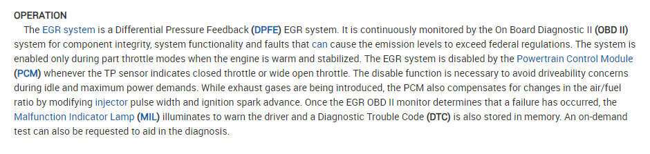

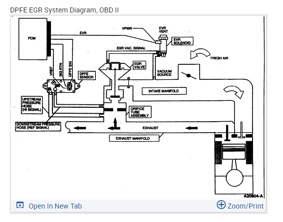

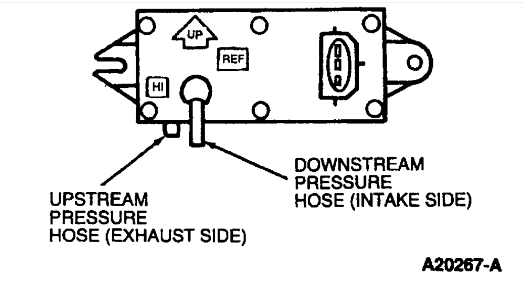

Also, there is a differential pressure feedback EGR sensor (DPFE). See pic 2. This sensor converts a varying exhaust pressure signal into an analog voltage which is digitized by the Powertrain Control Module (PCM). That information is then used to determine EGR flow.
If you look at the last pics, it is an exploded view of the system. I copied and pasted how it operates in the very last pic.
Let me know if this helps.

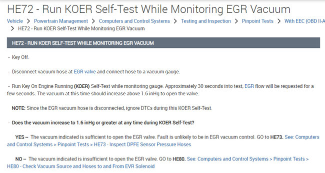

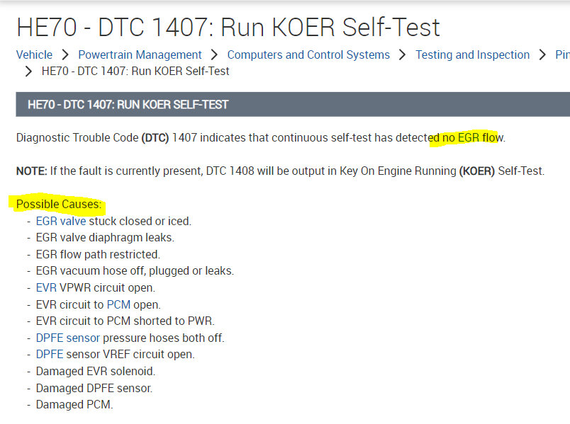

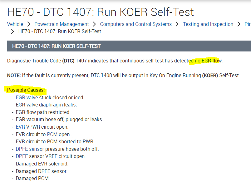

The code indicates there is no EGR flow. Let's do this the long way. I attached step 1 of the diagnostics for the P1407 in pic 1. It indicates test HE70. I skipped test HE71 because it is specific to a P1408 which isn't relevant.

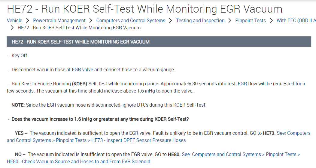

We know the code is present (1407), so pic 2 is test HE72. Perform that test and let me know the results. Once I have them, I will know what test is next.,
joe
Aug 12, 2024 at 12:53 PM
BENSJETS8147
  • 29 POSTS
Trying to borrow a vacuum tester. AutoZone did not have one at the time. The car is starting in closed loop, and of course I'm only guessing, but that lets me to believe the EGR is always closed. Would it hurt anything to continue to drive this way? I will update you about the two tests you recommended as soon as I can get them performed. Thanks.

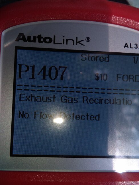

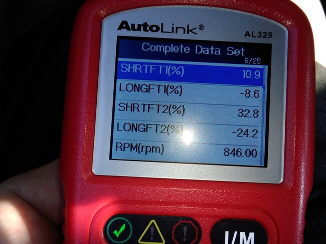

  • 29 POSTS

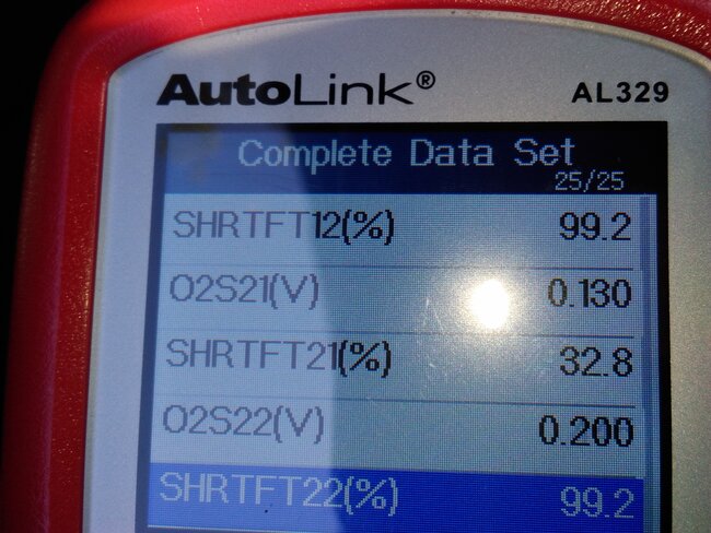

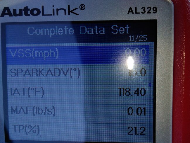

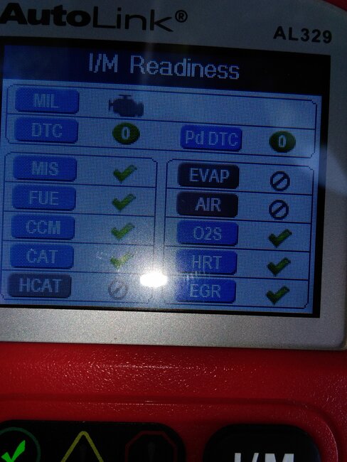

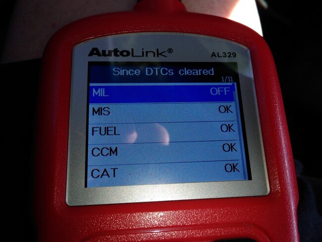

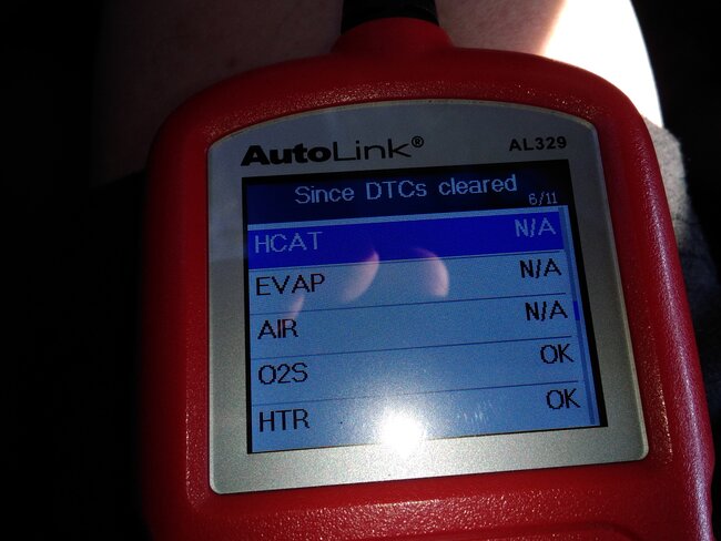

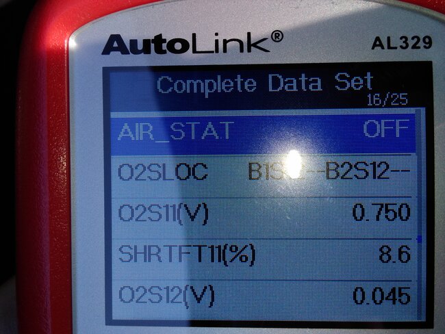

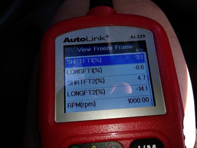

I could not get a complete on my cats, so I unhooked the two sensors that run the EGR, and unplugged vacuum to the EGR and plug the line. Then I drove it for about 30 miles and it ran okay. I pulled over, plugged everything back together, and within a mile I got a complete on the cats. I'm going to try to send you pics of my scanner. Check them out and any thoughts my ears are wide open. Sorry for the bad pics but I'm using a cheap government phone. Yes, I am a very poor person. I think if you blow them up a little you will be able to see them better. Good luck my new friend.
Aug 14, 2024 at 12:49 PM
  • 110,244 POSTS
Wealth is not a form of money. It is being a good person. I have a feeling, you are a lot wealthier than you think.
As far as the pics, the fuel trims are all over the place. They should remain between -10 and +10%.
At what point were they at 38%? That tells me the computer is dumping fuel to add for a lean fuel mixture.
Aug 14, 2024 at 2:10 PM
BENSJETS8147
  • 29 POSTS

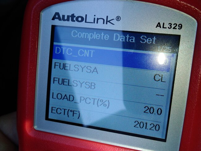

You are absolutely right about wealth. It comes in many forms. I'm in my fourth year of remission from having throat cancer, Hallelujah!! All the pics were taken when the car was idling, and after about a 30-mile drive. I'm getting between 20 and 23 mpg jumping around town and short drives. Never had it on a trip. As far as deciphering what my scanner is telling me, that is one of those times I speak of, I have enough knowledge just to get myself in trouble. I'm sure you are a very busy person with your own life, and this large task you have taken upon yourself to help other people such as myself, so you are very wealthy in your own right. You take your time trying to help me. I realize I have dumped a lot into your lap. I think when they swapped the motor from a 2001 into a '94 they created a lot of problems. I have no idea where to start. It does run rich all of the time, and I'm not willing to spend a lot of money trying to fix it. If it were something simple, that would be different. I bought the car for $500 thinking it would make me feel young again driving with the top down, and it does that when it is running. Thanks again.
Aug 14, 2024 at 2:33 PM

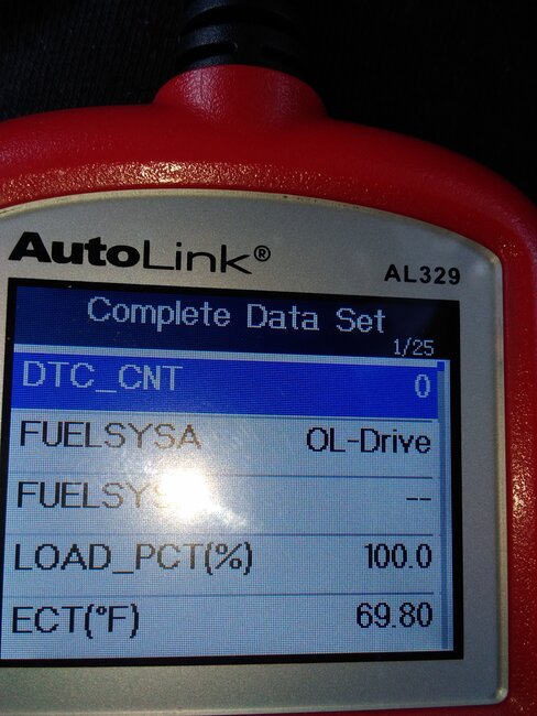

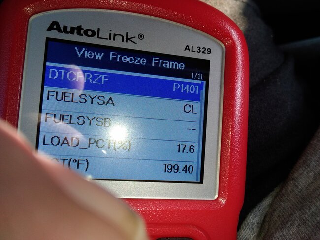

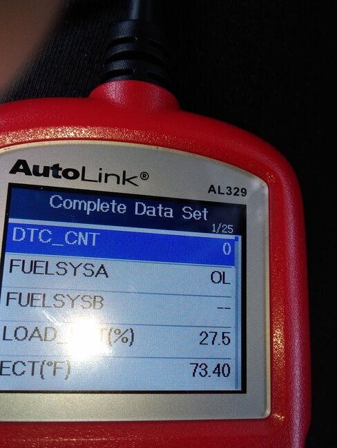

BENSJETS8147
  • 29 POSTS
First pic is the actual first start of the day. Next two taken before starting.
Aug 15, 2024 at 5:45 AM
  • 110,244 POSTS
The first two indicate it is in an open loop. Is that correct? Also, were you able to get the ECT reading before starting?
Aug 15, 2024 at 12:18 PM
BENSJETS8147
  • 29 POSTS
The middle pic shows the ECT at 69.80 (F) before starting and yes, this is the first time I actually have seen an open loop. Took it for inspection today and it did not need anything, so maybe I will try to keep it for a bit longer. It is running terribly rich though, and will probably gobble up the new O2 sensors and destroy the cats if they are not already destroyed. I will try to take pics of the fuel setup and EGR setup. Looks funky to me, but I'm not sure what it is supposed to look like. I'll send those pics later down the road when I get them taken.
