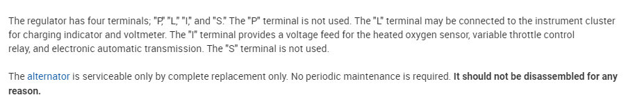

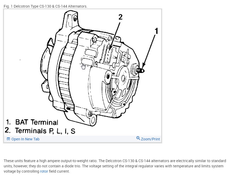

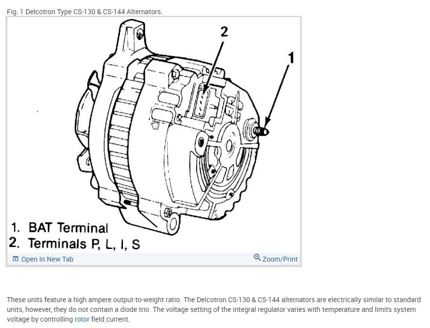

I have seen Alternators cause this issue so just unplug the connector on the alternator (not the B+ power wire). Basically you want to unhook the PCM from the alternator and you do this by removing the connector (number 2 in the attachment).
Let me know if it keeps running with this unplugged and the ignition is off and we can move onto something else.
