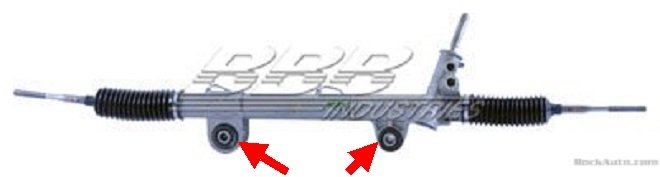

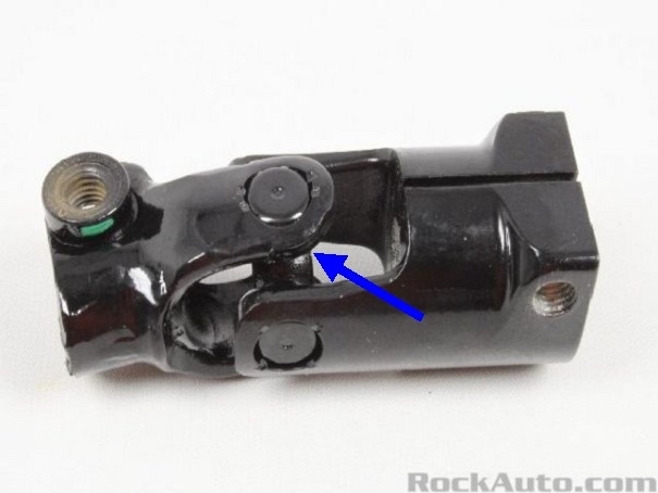

Since day 1 my vehicle had too much play when driving at speed. I decided to get an alignment that made the problem worse. brought it back then they tell me I need tie rod driver side. I get that fixed then got it realignment and it's not much better. when I'm driving on any road it's hard to stay in the middle of the lines very jerky in the steering. I just weed ant it fixed it's a family vehicle.

There's something else going on besides one worn tie rod end. Have you noticed any clunking in the steering wheel? Steering wander can be caused by a number of things, worn tie rod ends being just one of them. The coupler shown in the photo is in the steering shaft under the dash. If its universal joint is worn, an alignment won't solve that cause of steering wander. You should feel the clunking in the steering wheel, and you would observe when turning the steering wheel slightly from side to side, the wheels don't respond right away.
Another, more elusive cause of steering wander is the rack and pinion steering gear is loose and sliding left and right. This can usually be felt through your feet, but can be hard to identify. The mounting design of your steering gear doesn't lend itself to falling victim to loose hardware, but it does use a pair of rubber bushings that could be deteriorated. Those are shown with the red arrows in the second photo.

Do you still hear or feel any clunking in the steering system?

Part of what you described can also be caused by a bad alignment. If "total toe" is not correct, the two front tires will be steering in slightly different directions. The vehicle will follow the tire with the most weight on it, which is usually the right one. When you hit a bump or pass an intersection, some weight shifts to the left tire, then the vehicle will follow that one momentarily. You'll be constantly correcting the direction of travel.
If you feel something suddenly change or shift, especially when you're part-way through a sweeping curve, something is loose and moving around. Loose or worn mounting hardware for the steering gear, and deteriorated control arm bushings are common causes.
