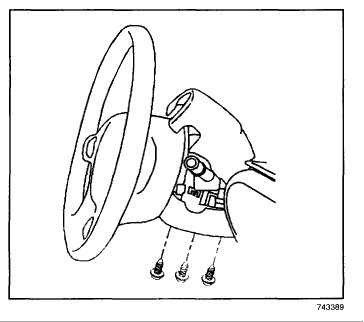

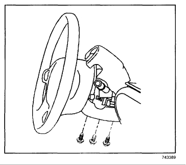

To replace it you remove the trim panel. To do that you remove the three screws from the steering column cover and remove the upper cover. Now remove the two screws in the trim panel at the top edge of the display area. Then gently use a pry tool to remove the trim panel retainers. Disconnect the hazard switch and use a screwdriver to press in the retainer tabs and remove the switch from the front of the trim panel. Snap the new switch into the hole, attach the wiring and reinstall the trim panel and steering column cover.

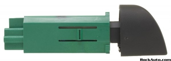

Thanks for responding. I did buy a new Hazard Warning Switch last year. This one: http://www.rockauto.com/en/moreinfo.php?pk=1190887&jsn=3 Are you saying that the tabs are part of the hazard switch itself (the part that I linked to)? Because the problem I'm experiencing now, with the new hazard switch, is the same as I was experiencing with the old hazard switch: the switch won't stay down when pressed. When the new hazard switch was installed, no tabs broke off of it.

If you look at the picture of the switch you can see the tabs just below the button that keep it from pushing through the dash. Your initial description sounded like you meant you pushed on the switch and it had pushed through the trim panel and was floating.
If you are pushing the button and that isn't staying in, that is a failure inside the switch itself. There is a U shaped wire with a spring that moves in a Z shaped slot. When you push the button in, the wire shifts into a different spot and holds the button down. When you push to release it the wire moves again and lets the button up.
Not something that can be repaired, instead you replace the switch assembly.

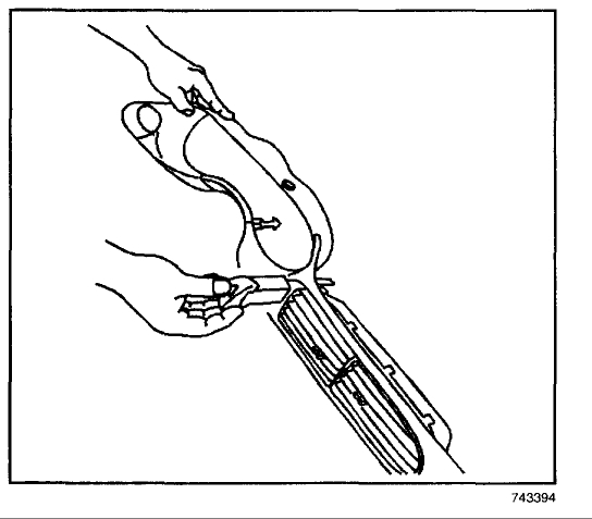

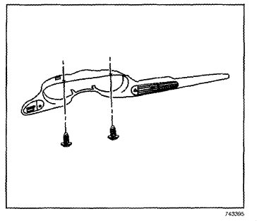

Here is the GM factory diagram and switch replacement instructions pulled directly from GM tech system.
Removal:
1 Disable the SIR system
2 Remove the instrument panel (I/P) cluster trim plate from the I/P carrier.
3 Disconnect the dimmer switch electrical connector if required.
4 Disconnect the electrical connector from the hazard warning switch.
5 With a small flat-bladed tool release the retaining tabs for the hazard warning switch.
6 From the back side of the I/P cluster trim plate, push outward on the hazard warning switch. This will remove the switch from the I/P cluster trim plate.

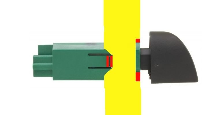

The trim panel is just a piece of plastic, there is a hole molded into it that the switch fits through. There is a recessed area that the outer tabs set in (red points toward button) and the inner tab (red lines to the left) simply squeezes into the hole and expand once they are through the plastic.
In the crude image I attached the two red areas right under the button are the only pieces that keep the switch from pushing through the plastic. If they broke off the switch could push father through the hole and as a result the button doesn't push in far enough that the internal toggle can lock it down (on). Instead of ON/OFF you would have push and hold for on.
