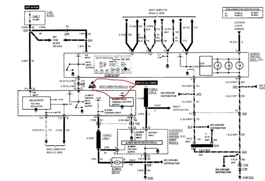

The electronic climate control and the electronic gas guages are not working at all times. Sometimes they come on and other times they don't. In Michigan it's tough to drive when you don't have heat and don’t know how much gas I have.
The 2 guages don't work consistently. Most times they're off. When they're both off the display shows what looks like small case letters c (mostly) or small case letter d.
Additionally, my brand new battery drains unless I start the car at least every other day.
Jan 22, 2021 at 4:12 AM
  • CAR REPAIR CONTRIBUTOR
Good morning,

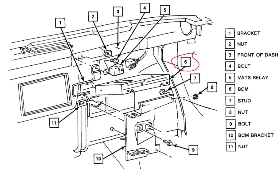

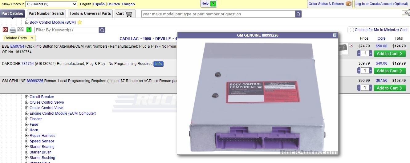

The body control module is the most common cause of this issue. It was very common for it to fail and the displays would go blank.
https://www.2carpros.com/articles/how-to-replace-a-bcm-body-control-module
I attached the diagram of it and the procedure for replacement. Rock Auto has the part and I attached that as well.

6. Glove box module.
7. Nuts securing passenger compartment discriminating/arming sensor pigtail wiring and resistor module to Diagnostic and Energy Reserve Module (DERM) / Body Control Module (BCM) bracket and position aside.
8. Nuts from BCM studs.
9. Screws from DERM/BCM bracket and bracket.
10. Electrical connector and body computer module BCM.
