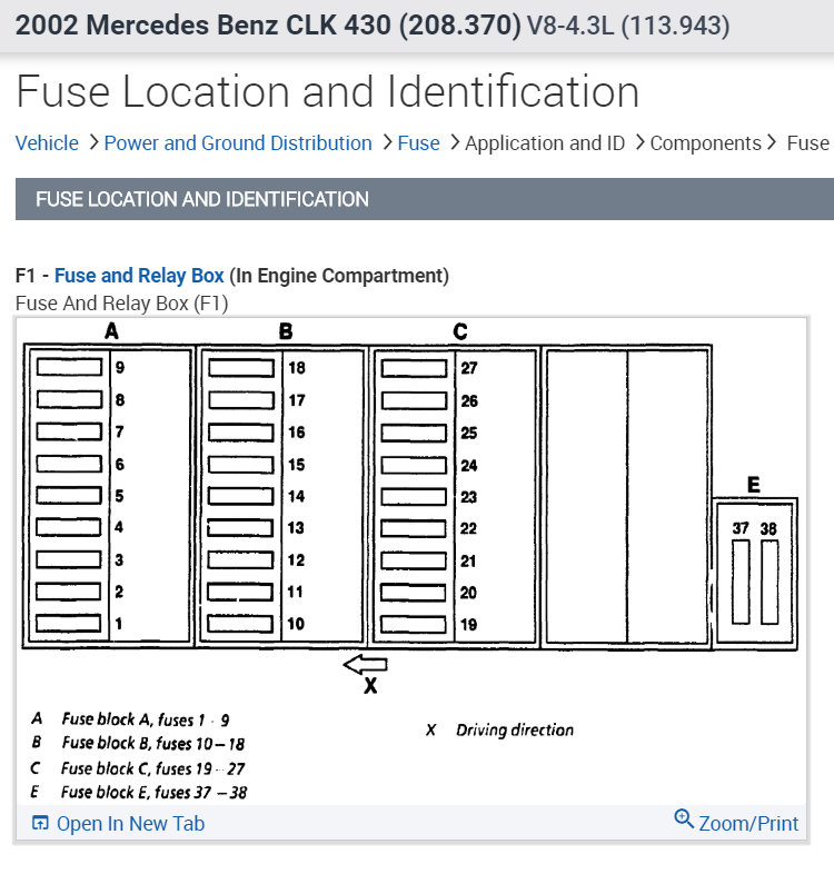

There is a drives side fuse panel that needs to be checked for power SAM fuse #5. here is a guide to check for power and the fuse location below:

I checked the fuses and other devices but the device is aren't getting the current power supply their only been a little bit of power through them I don't know why

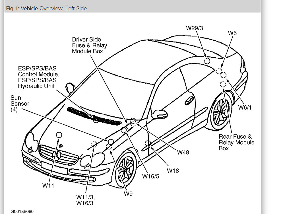

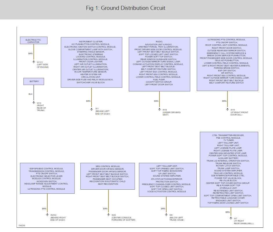

  • 55,721 POSTS

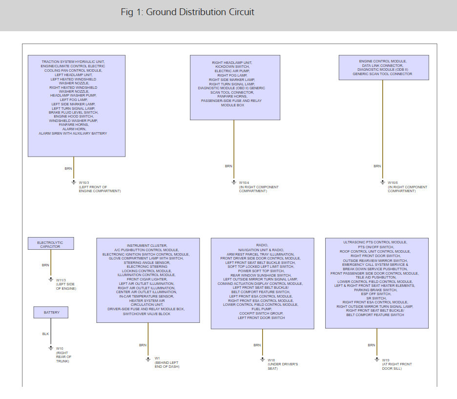

It sounds like you have a ground issue, here are the ground circuit wiring diagrams with a guide to help you check the connection, also you can do a CAN scan which will go over all network components. here is a video:
and
https://youtu.be/InIlnsjOVFA
Check out the diagrams (below). Please let us know what you find.

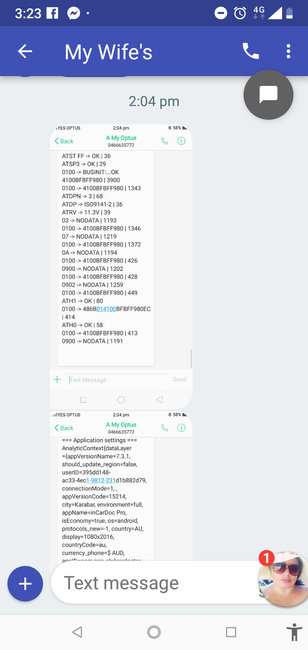

obd2 adaptor on it and it come up with the angle sensor was wrong and I check the sensor on the front of the engine and it's got a crack in the plastic but I fixed it and it's still the same problem but I'll go through the other things and see what happens.

I scanned itAnd come up the angle sensor was faulty in the exhaust sensor was running rich

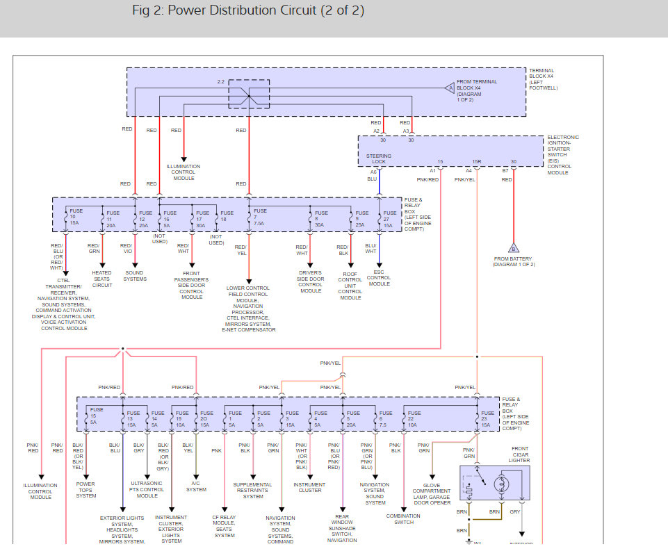

The fuses are only getting half their voltage
May 3, 2019 at 4:54 PM
BRETTLEZ3
  • 46 POSTS
wipers on a metre and it was getting 4 volts through to the right this with that turned on and the fuse is the footy infused isn't getting any power on the right hand side fuse box at all and the other fuse is the blinker fuse the right the fuse in the horn only getting half their power
May 3, 2019 at 5:12 PM
  • 55,721 POSTS
It sounds like the ignition switch has gone bad but to be sure here is a guide to help you test it with the wiring diagrams so you can see how the system works.

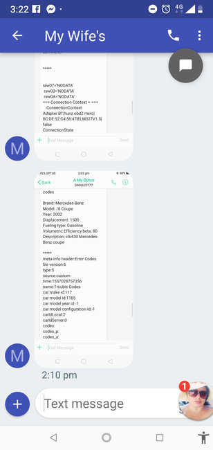

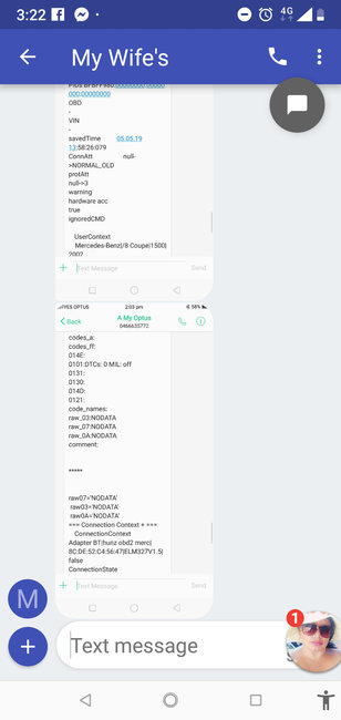

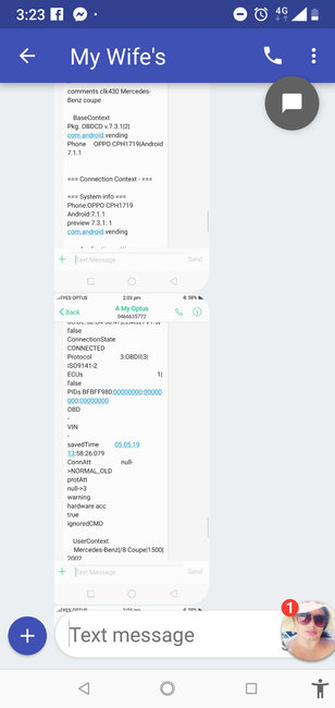

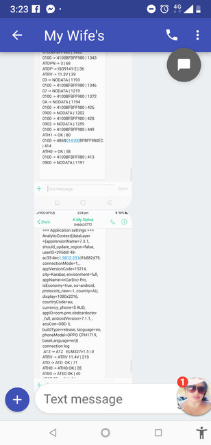

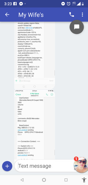

When I flicker the blinker switch the SRS light goes off and the noise stops and my right blinker will work. but when I put the left indicator on that's just starting to happen. so I don't know what the problem is. I would really drive me crazy. Hi got something to ask if you be able to give me some light on it as I am new at this trying to read the icar app i have downloaded here's the pictures from what my wife had take the picture for me to send to you if you have any idea of how to show message

The orange fuse is getting no power the others are getting a little bit of power but I checked everything else and they're getting a little bit of power so I don't know why you're not getting full power when I'm gone over everything that I don't know what it is done I don't know what it could be it's only something little though did you get the picture of the OBD read out do you know what that could be
