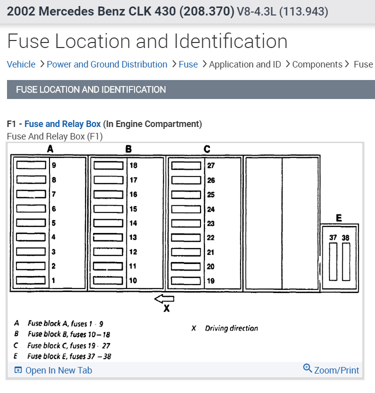

There is a drives side fuse panel that needs to be checked for power SAM fuse #5. here is a guide to check for power and the fuse location below:

I checked the fuses and other devices but the device is aren't getting the current power supply their only been a little bit of power through them I don't know why

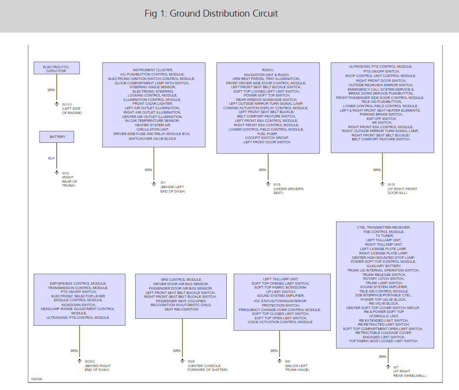

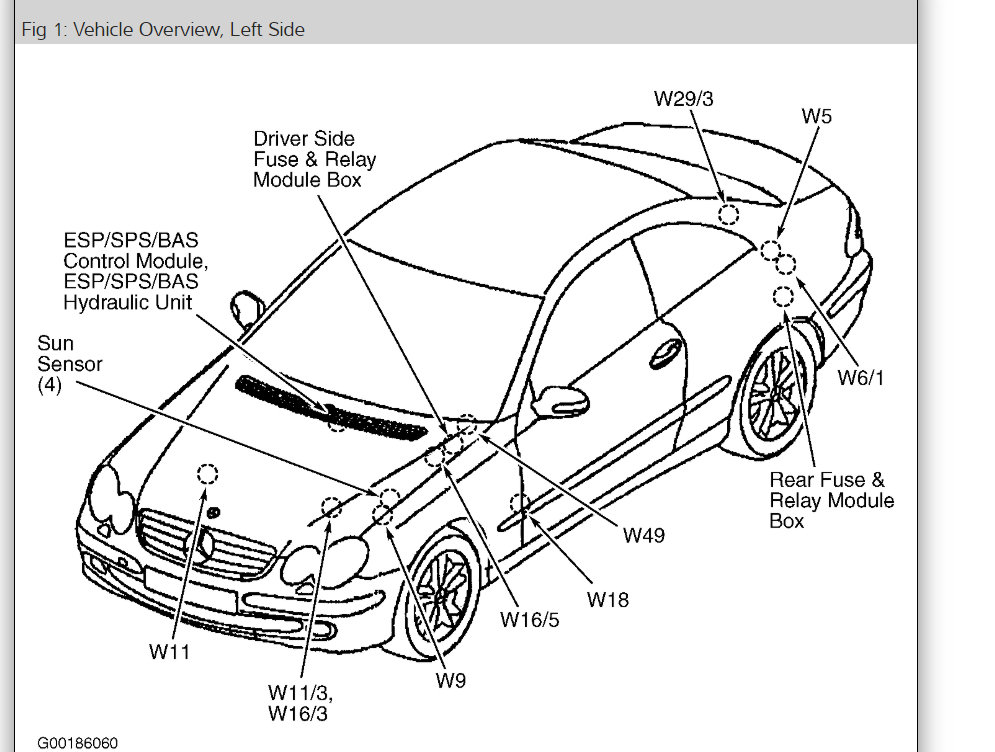

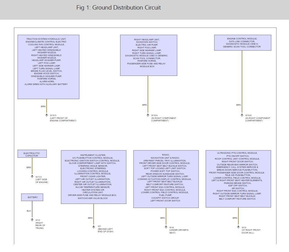

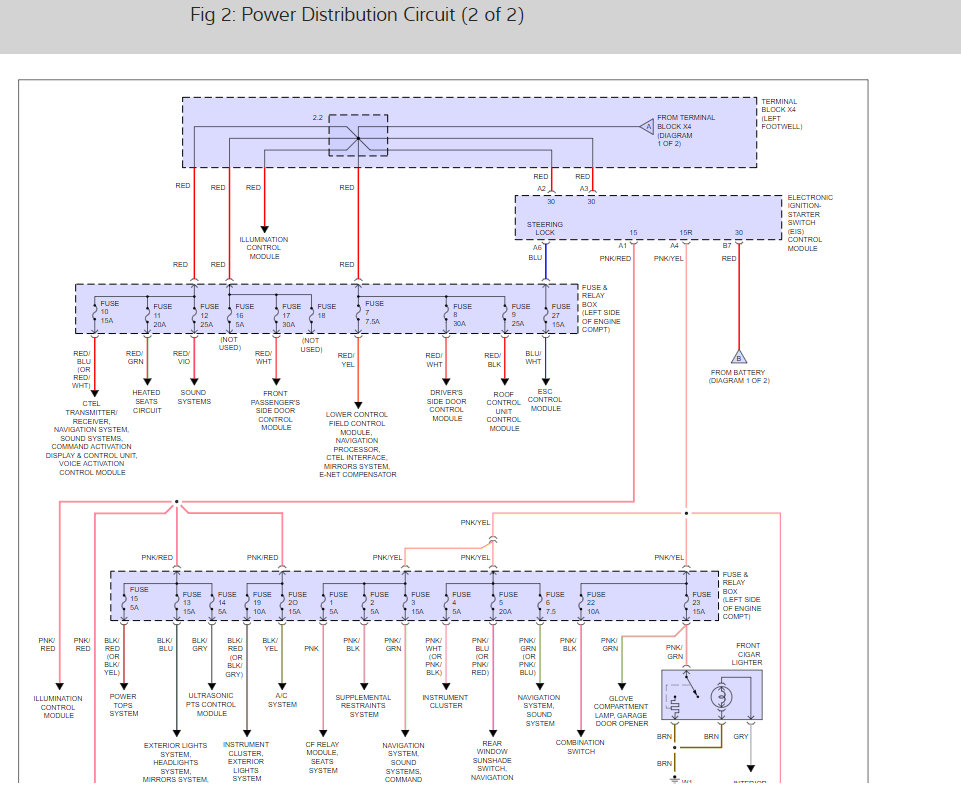

It sounds like you have a ground issue, here are the ground circuit wiring diagrams with a guide to help you check the connection, also you can do a CAN scan which will go over all network components. here is a video:
and
https://youtu.be/InIlnsjOVFA
Check out the diagrams (below). Please let us know what you find.

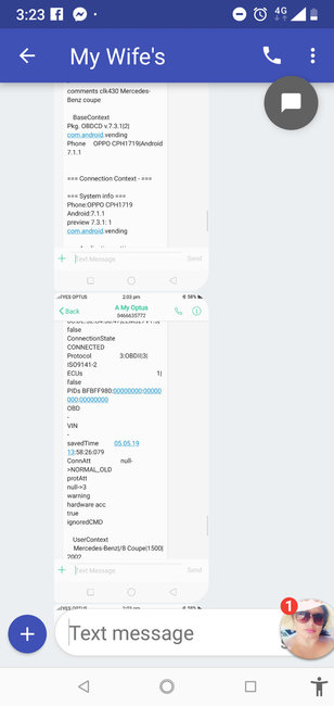

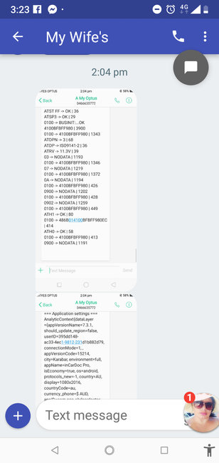

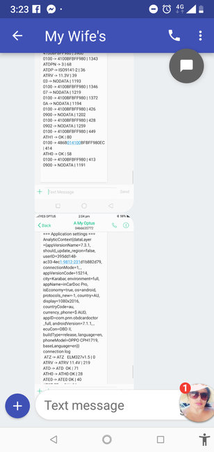

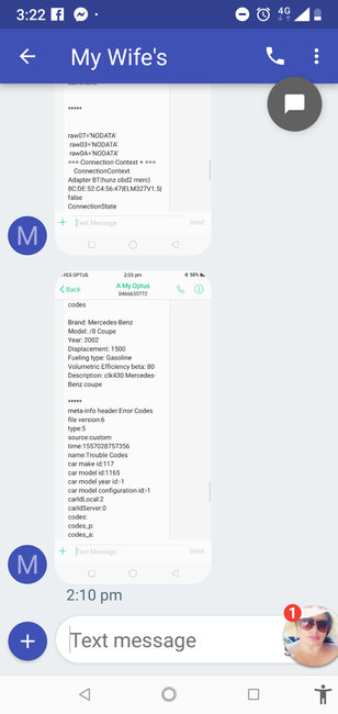

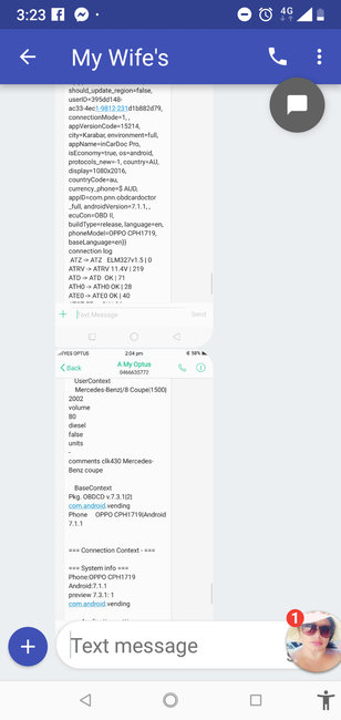

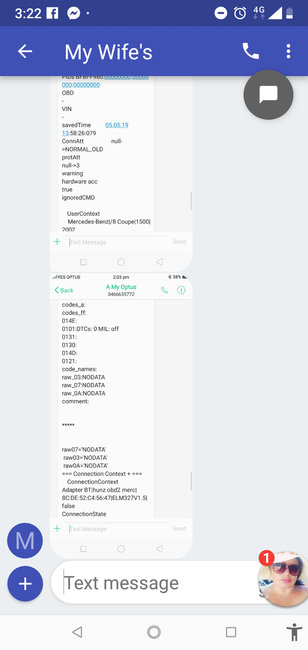

obd2 adaptor on it and it come up with the angle sensor was wrong and I check the sensor on the front of the engine and it's got a crack in the plastic but I fixed it and it's still the same problem but I'll go through the other things and see what happens.

I scanned itAnd come up the angle sensor was faulty in the exhaust sensor was running rich

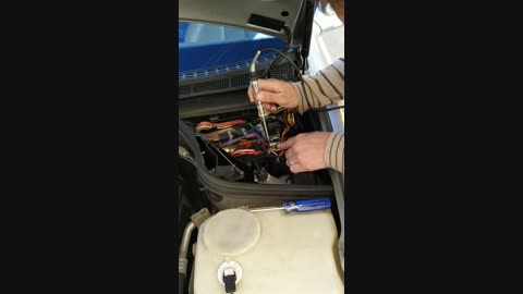

Can you please shoot a quick video with your phone so we can see what's going on, that would be great. You can upload it here with your response.

Here's a short video so just wanted you to know that I truely appreciate this. I wish there was a quicker way of doing this but as of right now it helps is gold...

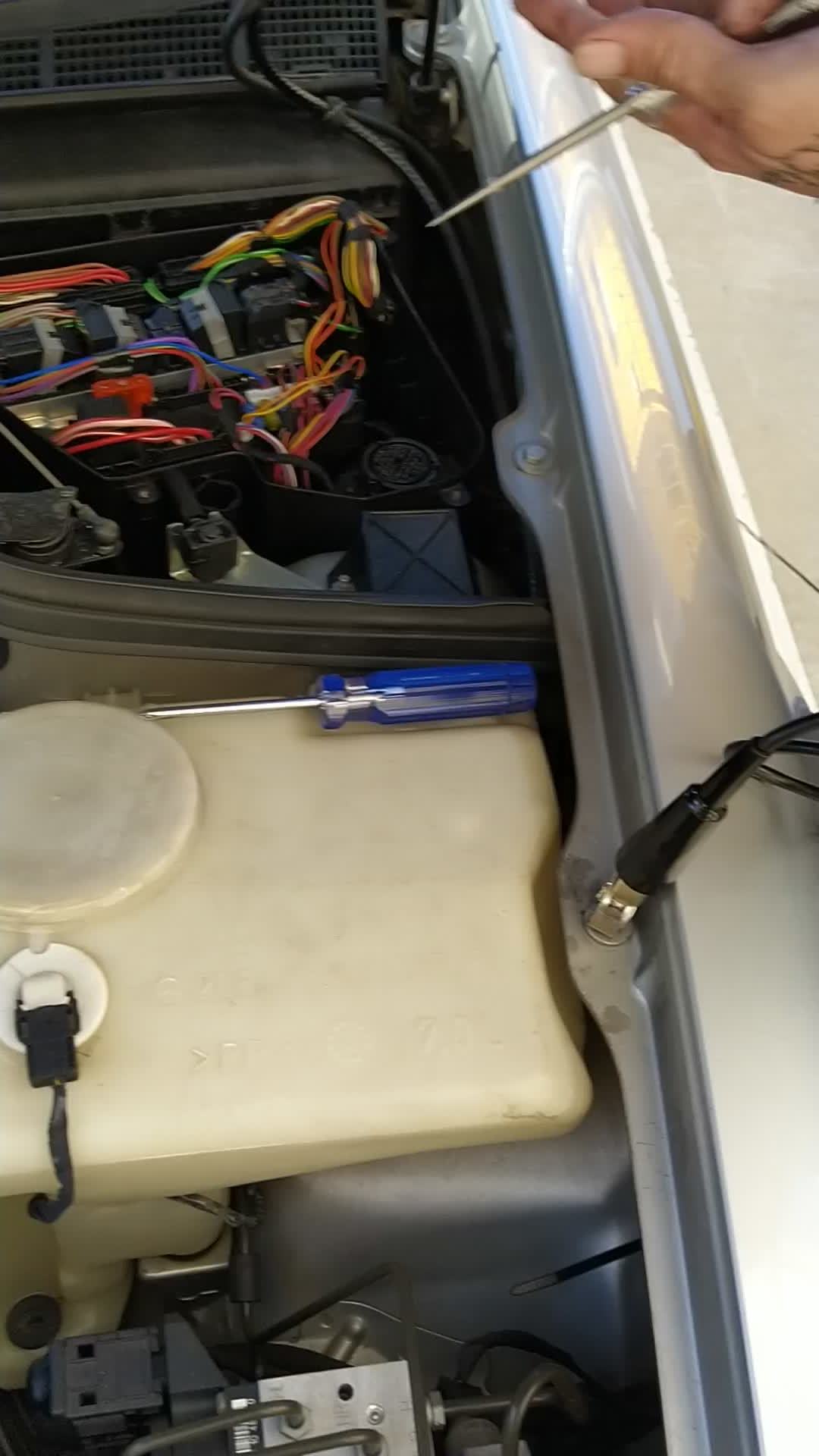

The fuses are only getting half their voltage
May 3, 2019 at 4:54 PM
BRETTLEZ3
  • 46 POSTS
wipers on a metre and it was getting 4 volts through to the right this with that turned on and the fuse is the footy infused isn't getting any power on the right hand side fuse box at all and the other fuse is the blinker fuse the right the fuse in the horn only getting half their power
May 3, 2019 at 5:12 PM
  • 55,412 POSTS
It sounds like the ignition switch has gone bad but to be sure here is a guide to help you test it with the wiring diagrams so you can see how the system works.
Check out the diagrams (Below). Please let us know what you find.

The orange fuse is getting no power the others are getting a little bit of power but I checked everything else and they're getting a little bit of power so I don't know why you're not getting full power when I'm gone over everything that I don't know what it is done I don't know what it could be it's only something little though did you get the picture of the OBD read out do you know what that could be
May 6, 2019 at 11:01 AM
BRETTLEZ3
  • 46 POSTS
I'm taking videos with the multimedia on all the fuses and I'll send it to you later.

Is the video of the metre reading? all the fuses I checked everything that you sent me and I've had no luck.
May 9, 2019 at 3:10 PM
  • 55,412 POSTS
it looks like the system has low voltage is the battery is good condition can we do a reading at the battery?
