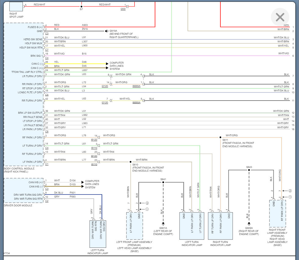

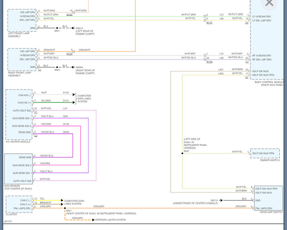

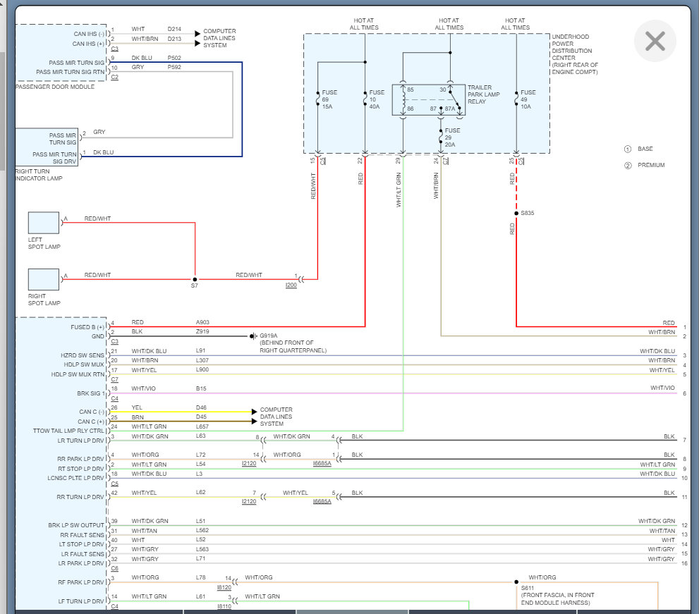

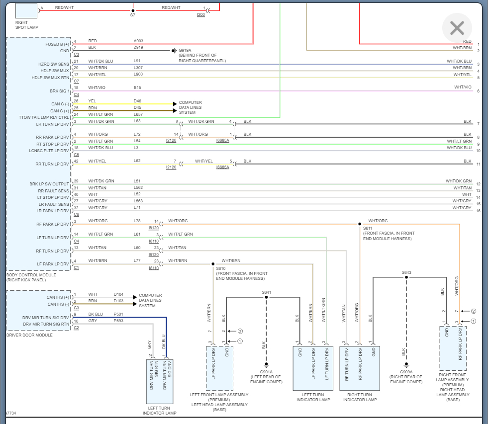

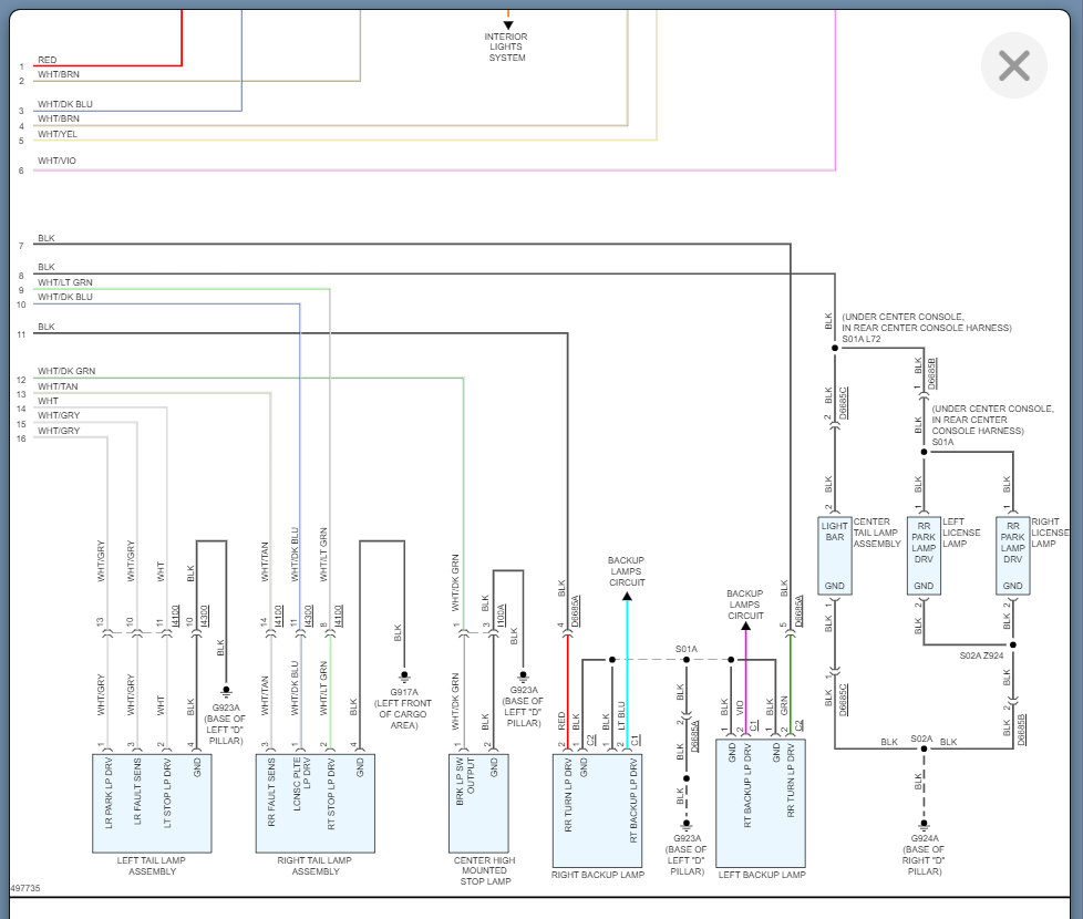

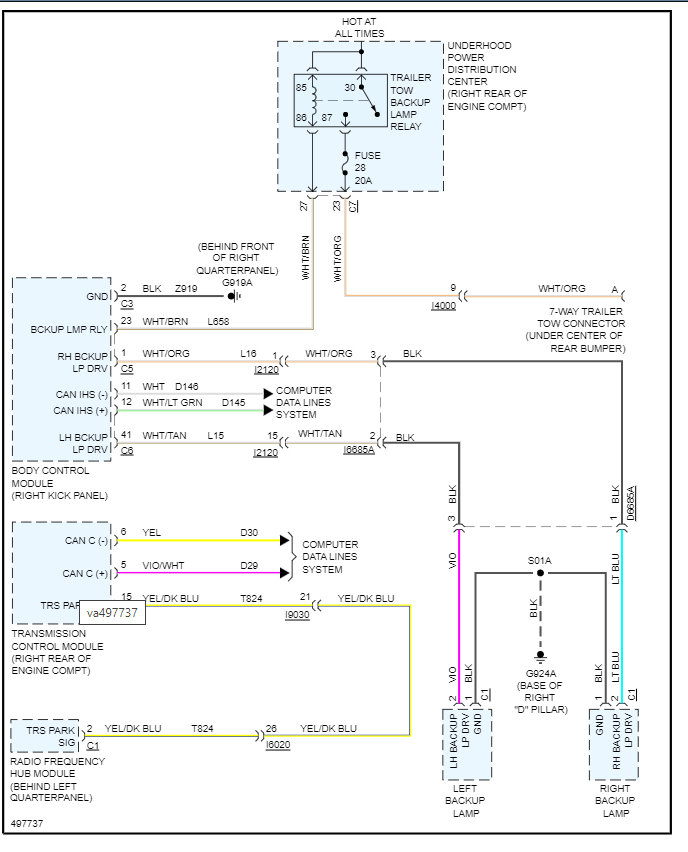

I bought Dodge Durango from USA market. I live in Poland, it is EU country and I have to change the light for EU regulations.
Could you please the Electrical wiring diagram for front and rear lights?

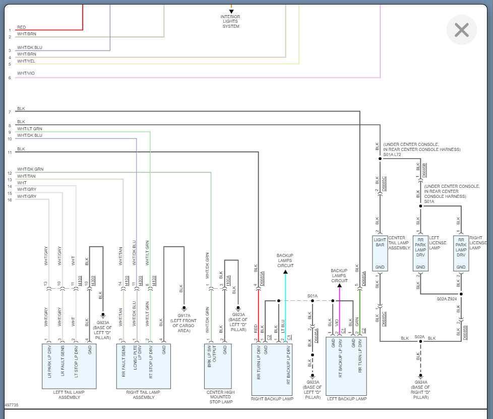

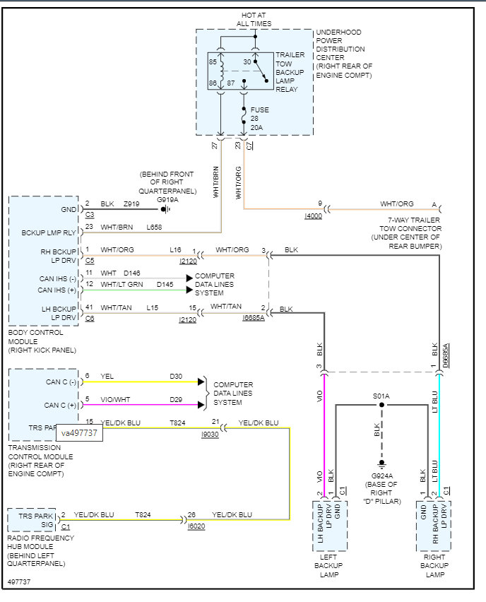

I can see that there is 4 independent bulbs for rear white light for reverse gear. And there are 4 wires for BCM or 4 wires from 4 bulbs go to split point in rear lift/door and the one wire go to BCM?
Have a nice day,
Pawel
Mar 27, 2022 at 5:09 AM

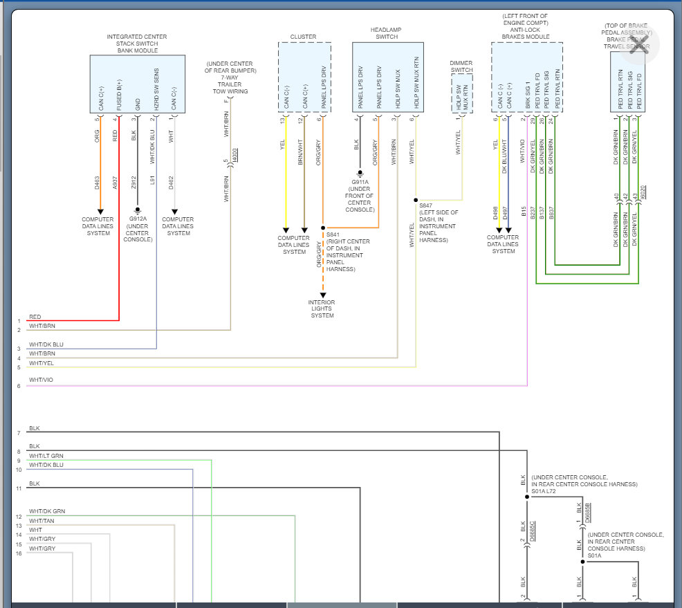

No problem.
I am attaching the diagrams below. Sorry for the delay. We had some issues with hackers earlier this week, so it looks like this got lost.
Here is a guide if you or others in the future need this:
The backup circuit is first and then the rest of the exterior lighting are the rest.
Thanks

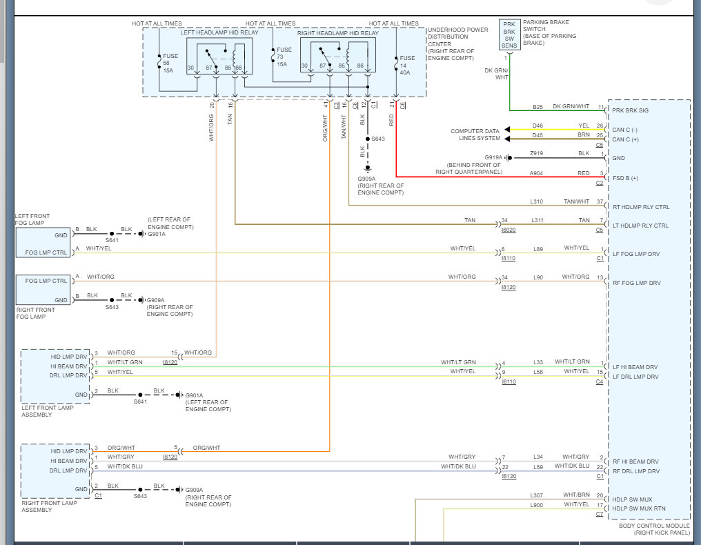

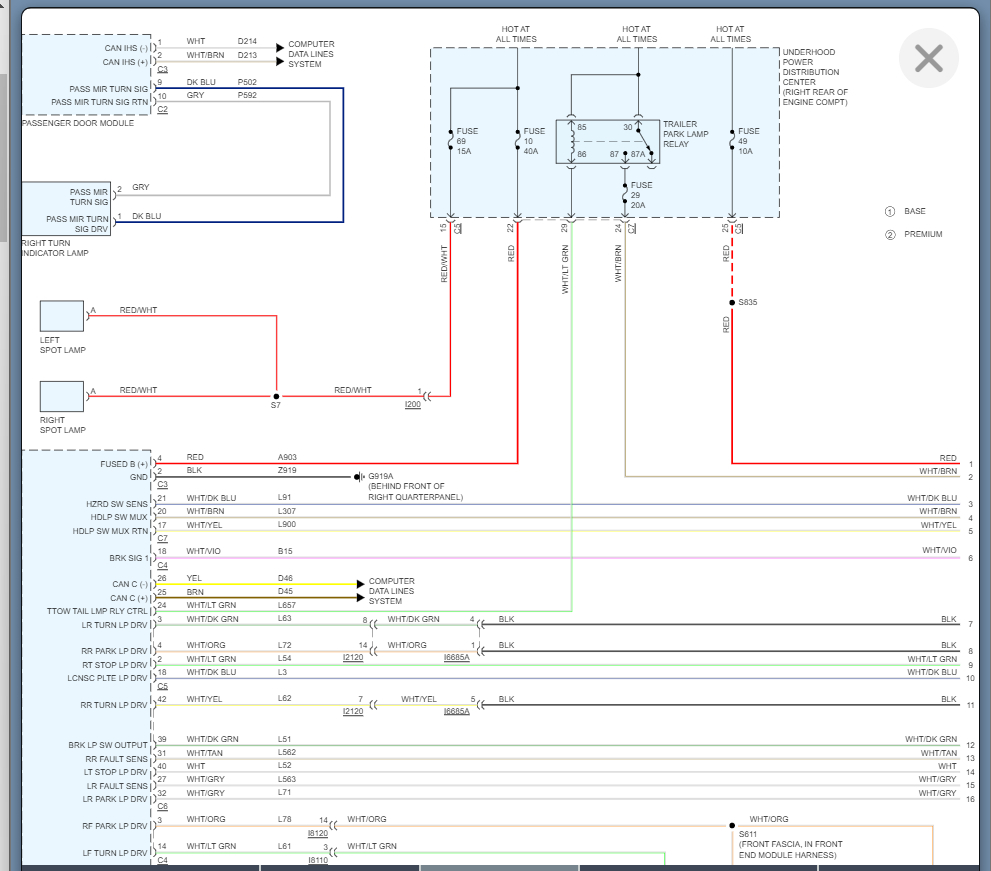

I have done the rear stop and turn lights. I have to add rear fog light yet. I would like to connect the front fog light with the rear fog bulb. Could you please add diagrams for front fog lamps? And location the proper wire/junction/connector on BCM for fog front lamps.
Have a nice day,
Pawel
Jun 27, 2022 at 11:37 AM
I am attaching the wiring diagrams below for the fog lights.
Thanks for checking back in.
Jun 28, 2022 at 11:49 AM
