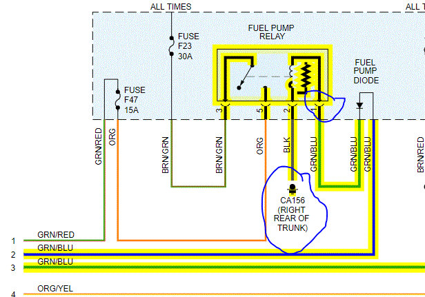

Replaced the fuel pump (electrical pump only same assembly) now i m not getting power to the pump connection at all " no priming sound ".
Observation : passenger compartment fuse box fuse f4 (inertia . Fuel pump relay) no power at fuse wires.
Battery is two months old it was kind of low charge around 12.2, now recharging it. Also previously car was running. Just fuel pressure was a bit high it was suggested replacing the electric pump.

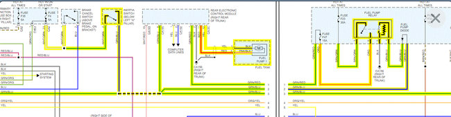

Good afternoon,
Do you have a voltmeter and a test light to do some checks?
I attached the diagram of the fuel pump and need to do some checks to find out why you have no power to the pump.

Can you go to the fuel pump relay? We need to do some testing at the relay.
Sep 5, 2020 at 11:47 PM
JAIMSTER
  • 29 POSTS
yes I just did that so when you place your hand on relay R15 no movement felt or any clicks
power at terminals 30 - 12.4 volts 87A - 10.9 volts no power at 85,86,87 AT ALL .
i m using KZYEE vehicle super probe KM10 to test power and relay tester jumper Kit 56810
i don't get it !!! those are the secondary terminals should be getting power at 85,86 if I m understanding correctly..
according to link max fusible link or max fuse has shorted where would find those on this vehicle???
Sep 6, 2020 at 1:48 AM
The control side gets its power from the ECM.
It provides power for 2 seconds with the key on for priming.
Then it will give full power once it is cranking and the ECM sees the signal from the crank sensor.
Sep 6, 2020 at 1:52 AM

The green/white comes from the ECM and should also feed the control side of the relay. If you have no power at the relay cranking, then you have a wiring issue between the inertia switch and the relay.
Sep 6, 2020 at 2:51 AM
JAIMSTER
  • 29 POSTS

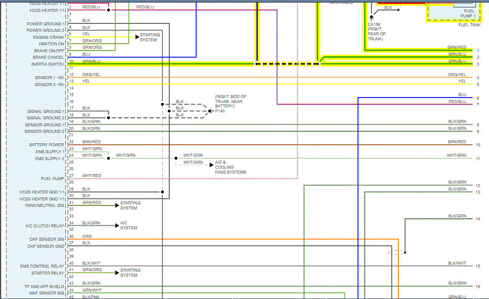

I have a 2005 astype electrical pdf according to that it is gu = green/ blue from ECM. where does the other wire black one goes to?
On electrical diagram fuel pump relay terminal 2 = 85 is black wire.
Terminal 1 = 86 is the green/blue wire. which has a diode in line there ?
And also before the relay there is a " diode " which i had already swapped from a spare at the engine compartment fuse box. i think maybe i should buy a new one unless there is a way to check resistance on those?
Sep 6, 2020 at 3:05 AM
Black goes to ground. That is not the issue as you have to power to the control side.
No resistance check at all. It should have continuity going one way only. There should be no flow going the other way.
86. The power goes through the diode to the coil in the relay.
Sep 6, 2020 at 3:20 AM
JAIMSTER
  • 29 POSTS

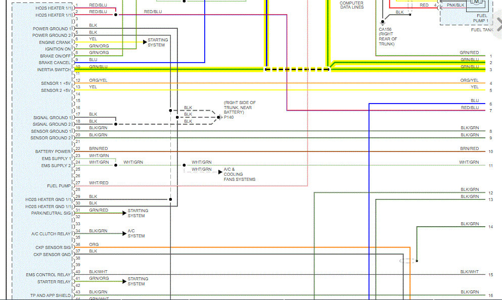

You're absolutely right Roy. gu runs from inertia to relay and other locations.
Gu wire also goes to 31 ii, 32,33, 34 all those locations 34ii is the fuel pump relay. what are the other ones ?
Should i introduce voltage via super probe to 86 on the relay to test it ?
Sep 6, 2020 at 3:53 AM
You could try that. It will tell you if the system will work and confirm the wiring issue.

Look on the diagram. There are fuses for the relay that must be checked as they provide power to the relay.
No, the ECM does not have a separate fuse for the fuel pump. If the relay is not getting power to the control side from the ECM, it is either wiring from the ECM to the relay or the ECM itself.
Sep 6, 2020 at 9:30 PM
JAIMSTER
  • 29 POSTS
Great ! I kept looking at my electrical doesn't shown f23 for #3 (30) on the relay wiring. sorry should have been looking at your diagram .. Need to verify f47 for #5(87) which should be "hot all times " it is not ...
I will let you know. Roy if it is then - i probably have a short between fuse and relay wiring will that be correct ?
Thanks Roy.
Sep 6, 2020 at 11:15 PM
Correct.

Hi Roy.
So i checked the fuses f23 it is always hot, f47 it is getting 12.5 volts. problem, i just don't see voltage at terminal 87.
So checked all 5 terminals on the fuel pump relay : terminals 85 none , 87a none , 87 none only 30 12.5 v 86 11.8 v (believe is ground side).
Tried a jump wire from fuse f47 t terminal 87, no luck...

You will not see voltage at 87 until the relay closes. When it does, 30 will send power to 87 and then to the pump.
I blew up the relay and attached it again.
No, you cannot disable it. That is factory programmed.
Sep 8, 2020 at 9:07 PM
JAIMSTER
  • 29 POSTS
I apologize Roy, somehow i got confused!
Think i am understanding it right now. When switch is "on" position ii relay 1 (85) is energized via diode - then power flows to (87) ...then pump should be getting power .
i remembered checking power at diode base after removing it was getting power so maybe possible diode is bad or wiring to is shorted out ..
Thank you for your help ..
Sep 8, 2020 at 11:13 PM
Correct.

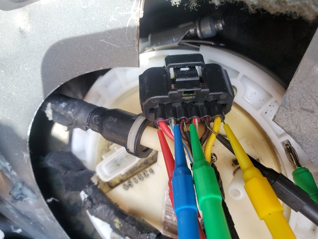

my car's fuel pump wiring connector has 6 wires not 4 as shown on the diagram ?? I wonder why I m not seeing that?
I understand in that year there were two type of pumps.
I have the 2005 Jaguar s type fuel pump 4R83-9H307-AC model on my car...
Sep 9, 2020 at 5:01 AM
I understand.
Please check the wires that I posted.
Sep 9, 2020 at 6:28 AM
JAIMSTER
  • 29 POSTS
Hey Roy,
I appreciate your help.. still confusing on the color wiring to the fuel pump assembly I have six wire plug following order and voltage readings :
(1) red 12.3 V - (2) W/U 11.1 V -(3) B/N 0.0 V -(4) W/R 11.1 V -(5) B/N 0.0 V , (6) yellow 0.0 V
I just can't find the diagram indicating those colors!

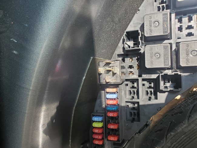

Can you post some pictures of the relay and the fuel pump connector?
Sep 12, 2020 at 3:21 AM
JAIMSTER
  • 29 POSTS
are you able to see the pictures?
Sep 12, 2020 at 4:41 AM
JAIMSTER
  • 29 POSTS
any suggestions ROY ??
Sep 12, 2020 at 9:23 AM
Yes, I got the pictures.
