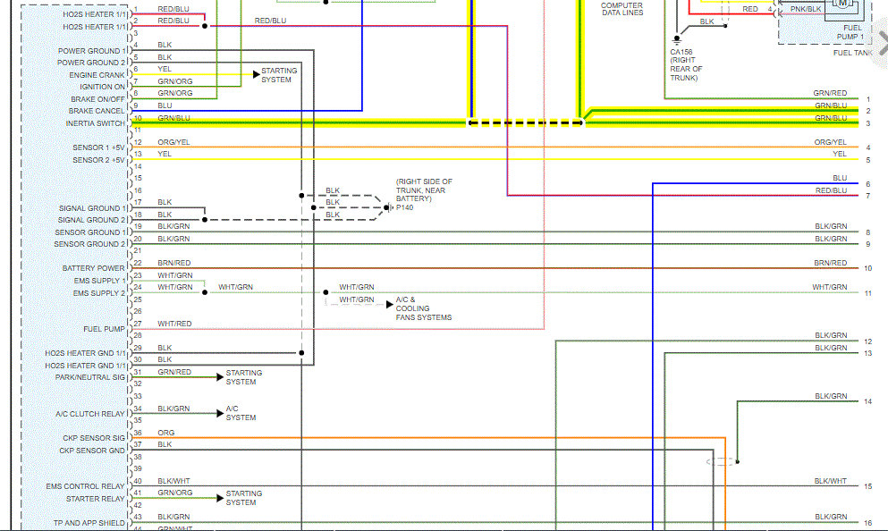

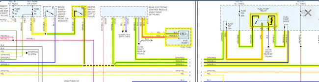

I attached the diagram of the fuel pump and need to do some checks to find out why you have no power to the pump.

the wiring diagram believe is wrong for my car's fuel pump - my is 2005 Jaguar S type fuel pump 4R83-9H307-AC which has six wire connection ..check voltage at each wire two wires (WG ) have around 1.6 volts each the other do not get any voltage at all .
Also checked voltage at inertia and its fuse both do get voltage at start .
also checked voltage at the fuel pump relay - it does seem to be getting voltage at least to wire terminals at start should i be getting voltage at all the other terminals ?
even swapped same relays around just to see if anything changes - same result.

white/green getting 12.4 when switch on. green 12.4 when start.. had a back probe wire at both of them.
Sep 6, 2020 at 2:46 AM
The green/white comes from the ECM and should also feed the control side of the relay. If you have no power at the relay cranking, then you have a wiring issue between the inertia switch and the relay.

I have a 2005 astype electrical pdf according to that it is gu = green/ blue from ECM. where does the other wire black one goes to?
On electrical diagram fuel pump relay terminal 2 = 85 is black wire.
Terminal 1 = 86 is the green/blue wire. which has a diode in line there ?
And also before the relay there is a " diode " which i had already swapped from a spare at the engine compartment fuse box. i think maybe i should buy a new one unless there is a way to check resistance on those?
Sep 6, 2020 at 3:05 AM
Black goes to ground. That is not the issue as you have to power to the control side.
No resistance check at all. It should have continuity going one way only. There should be no flow going the other way.
86. The power goes through the diode to the coil in the relay.

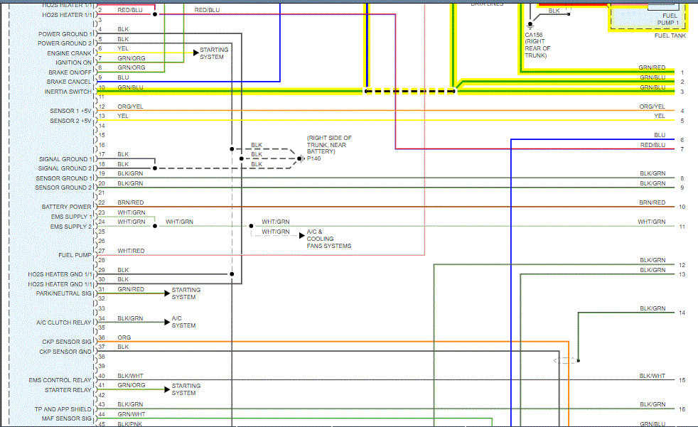

You're absolutely right Roy. gu runs from inertia to relay and other locations.
Gu wire also goes to 31 ii, 32,33, 34 all those locations 34ii is the fuel pump relay. what are the other ones ?
Should i introduce voltage via super probe to 86 on the relay to test it ?
Sep 6, 2020 at 3:53 AM
You could try that. It will tell you if the system will work and confirm the wiring issue.

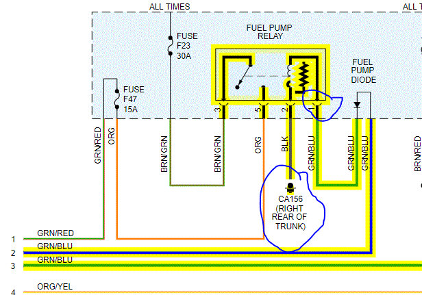

Great ! I kept looking at my electrical doesn't shown f23 for #3 (30) on the relay wiring. sorry should have been looking at your diagram .. Need to verify f47 for #5(87) which should be "hot all times " it is not ...
I will let you know. Roy if it is then - i probably have a short between fuse and relay wiring will that be correct ?

So i checked the fuses f23 it is always hot, f47 it is getting 12.5 volts. problem, i just don't see voltage at terminal 87.
So checked all 5 terminals on the fuel pump relay : terminals 85 none , 87a none , 87 none only 30 12.5 v 86 11.8 v (believe is ground side).
Tried a jump wire from fuse f47 t terminal 87, no luck...
What would you suggest next ? It almost feel the security system pats no letting it get started !! (had an experience with a BMW a while back) what warning light would it show ?

You will not see voltage at 87 until the relay closes. When it does, 30 will send power to 87 and then to the pump.

Think i am understanding it right now. When switch is "on" position ii relay 1 (85) is energized via diode - then power flows to (87) ...then pump should be getting power .
i remembered checking power at diode base after removing it was getting power so maybe possible diode is bad or wiring to is shorted out ..

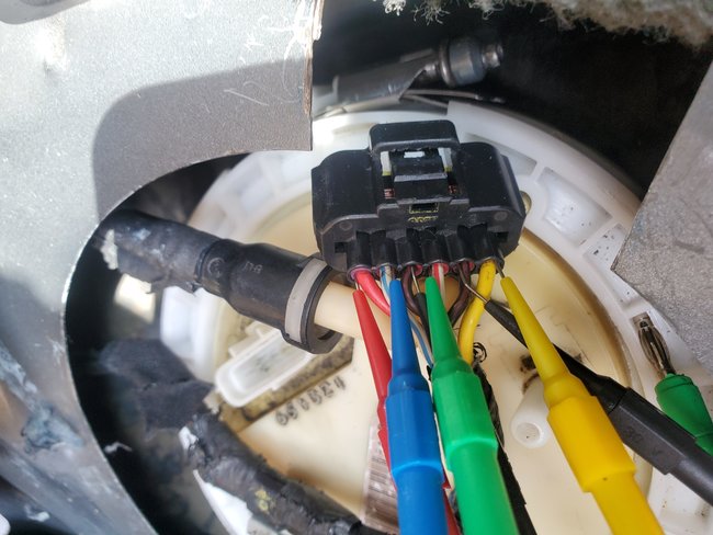

Sep 9, 2020 at 6:28 AM
JAIMSTER
  • 29 POSTS
Hey Roy,
I appreciate your help.. still confusing on the color wiring to the fuel pump assembly I have six wire plug following order and voltage readings :
(1) red 12.3 V - (2) W/U 11.1 V -(3) B/N 0.0 V -(4) W/R 11.1 V -(5) B/N 0.0 V , (6) yellow 0.0 V
I just can't find the diagram indicating those colors!
Sep 12, 2020 at 2:56 AM

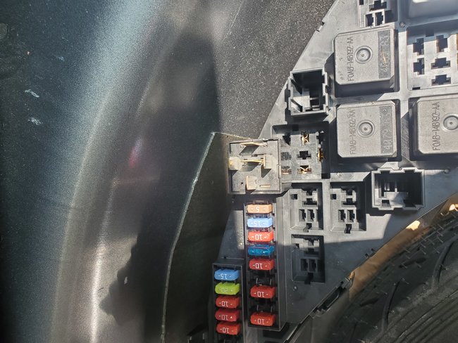

Can you post some pictures of the relay and the fuel pump connector?
Sep 12, 2020 at 3:21 AM
JAIMSTER
  • 29 POSTS
are you able to see the pictures?
Sep 12, 2020 at 4:41 AM
JAIMSTER
  • 29 POSTS
any suggestions ROY ??
Sep 12, 2020 at 9:23 AM
Yes, I got the pictures.
Trying to find a diagram for this.
