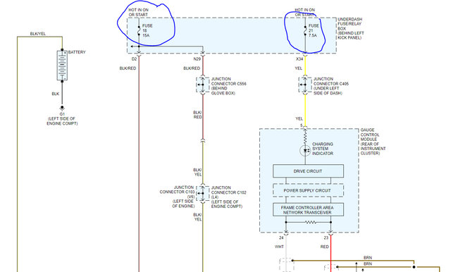

I bought the car listed above about 2 years ago, and it has had many electrical problems since. Headlights randomly dimming, internal lights sometimes not working, slow power windows, etc. Recently my car has been not turning when I turn the key in the ignition, with only a small click when I turn it initially. I measured the voltage of the battery and when it is off I measure about 11.8V, and when it occasionally turns on I get 14.2V. I'm thinking either a bad alternator or some form of electrical draining is going on, I would appreciate some help with this one. Thanks.

Good afternoon,
Your battery is no good. It needs to be 12.6 volts to be full charge.
https://www.2carpros.com/articles/how-to-charge-your-car-battery
Then you need to recheck the charging system.

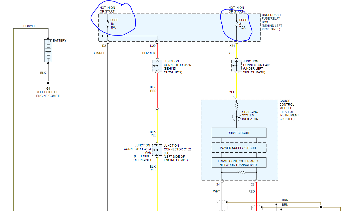

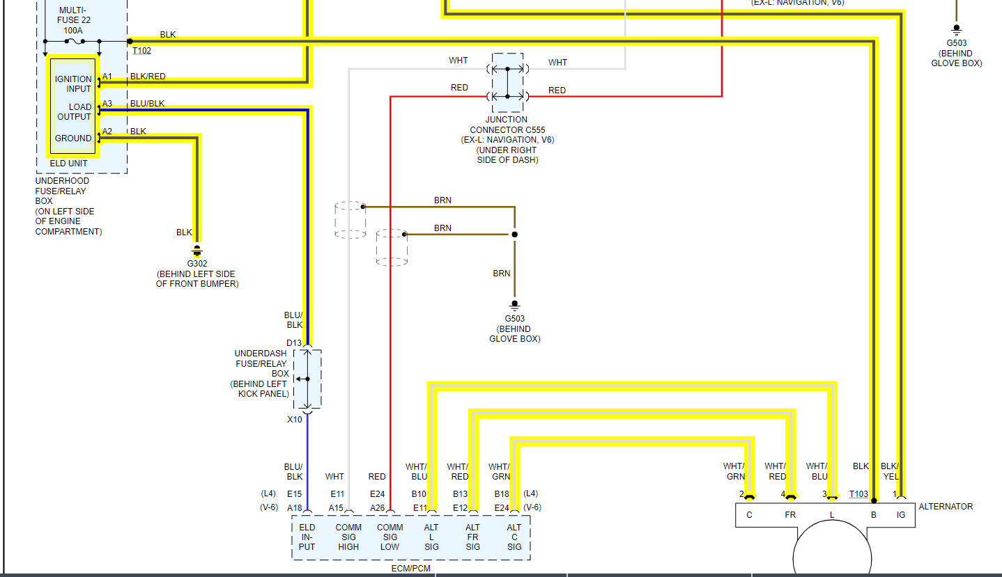

I attached a wiring diagram for you to view.
There are fuses to test and wiring to be checked for the system.
