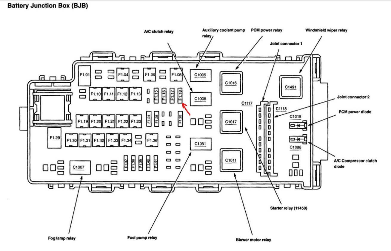

So, when the engine is running do you have a battery light on? We need to see if the alternator is charging when on the car and the engine is running.

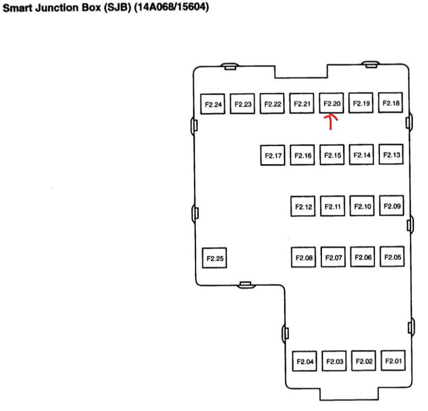

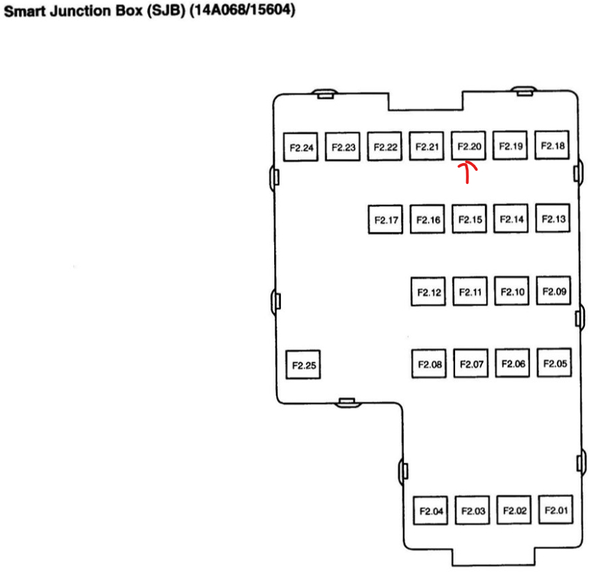

Also, let's check the fuse #f1.18 - 10 amp in the under-hood fuse panel and fuse #f2.20 - 7.5 amp in the fuse panel on the left side of the dash. Here is a guide to help you check them and the location in the images below:

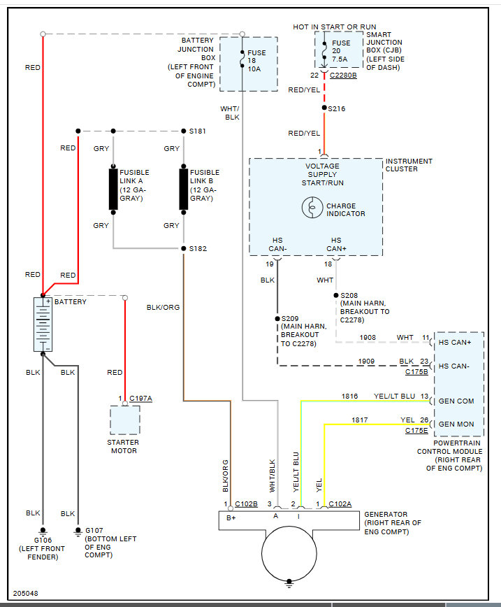

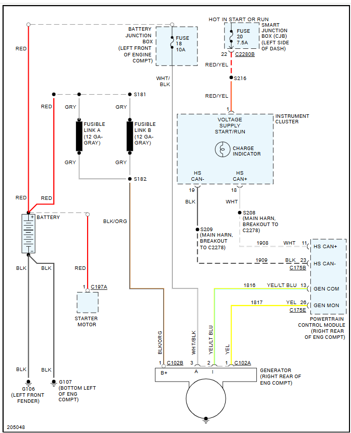

Here is the alternator wiring diagrams so you can see how the system works as well. Check out the images (below). Let us know how it goes.

Thought it was another bad alternator so we warrantied it out and replaced it again and still the same issues. Took it to auto zone and had them test it and it shows voltage regulation failed. When the cars is running and I test with the multimeter at the battery, it tests at almost 19 V which I know is way too much. I took the wipers and cowl off to visually inspect the PCM and I don’t see any melted wires, corroded plugs, or anything else. I am just stumped…and still without transportation. I have gone through and tested the fuses with a multimeter and they all test fine but I did go ahead and replace #f1.18 and #f2.20 just to be safe. Desperately seeking a solution. Thank you so much!

When the key is on, (engine nit running) does the battery light illuminate? The PCM regulates the charging voltage so it might be bad, let's run the codes to see if any are stored. This guide can help:

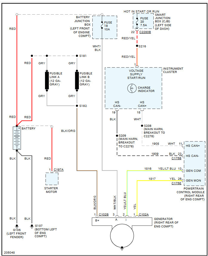

Here are the wiring diagrams so you can see how the system works. Check out the images (below). Please let us know what happens.

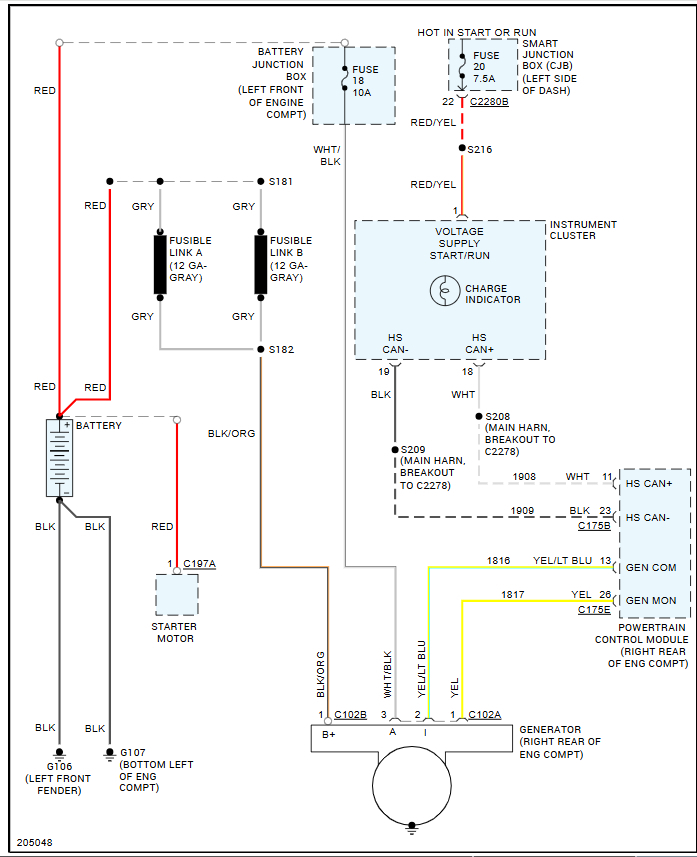

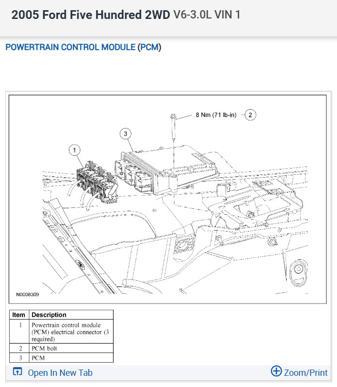

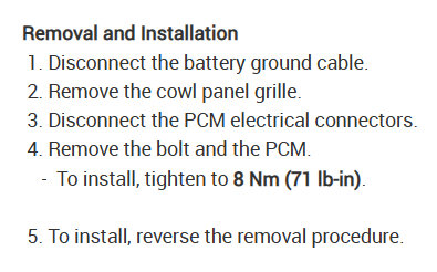

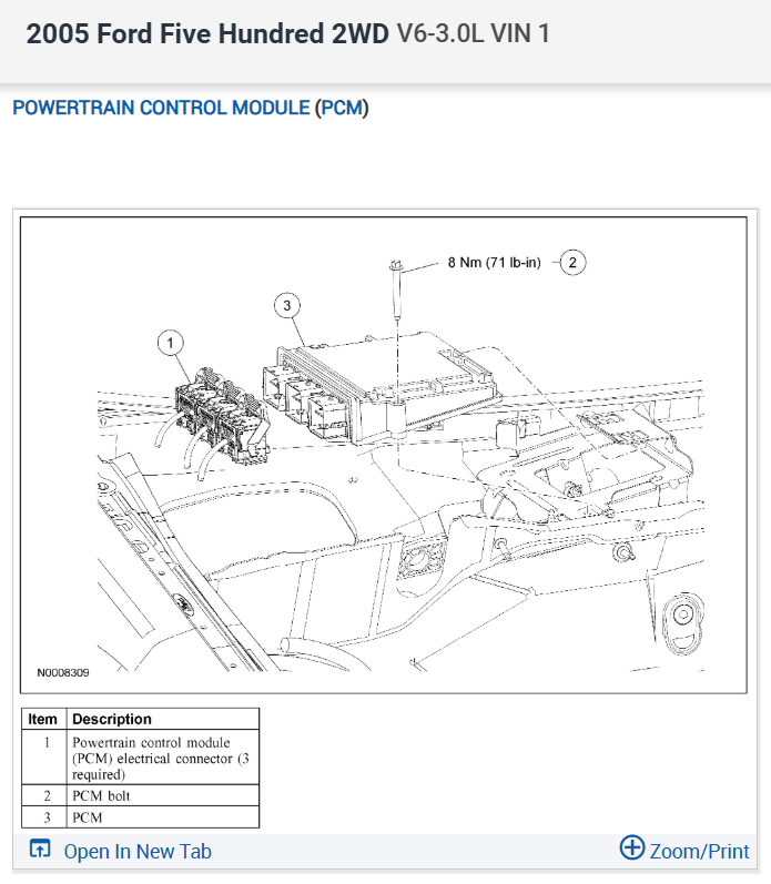

I would say you have a bad PCM which controls the voltage output of the alternator. Here is how to replace it and the wiring diagrams of the system so you can see how it works. There is no programming needed FYI. Check out the images (below). Let us know how it goes.

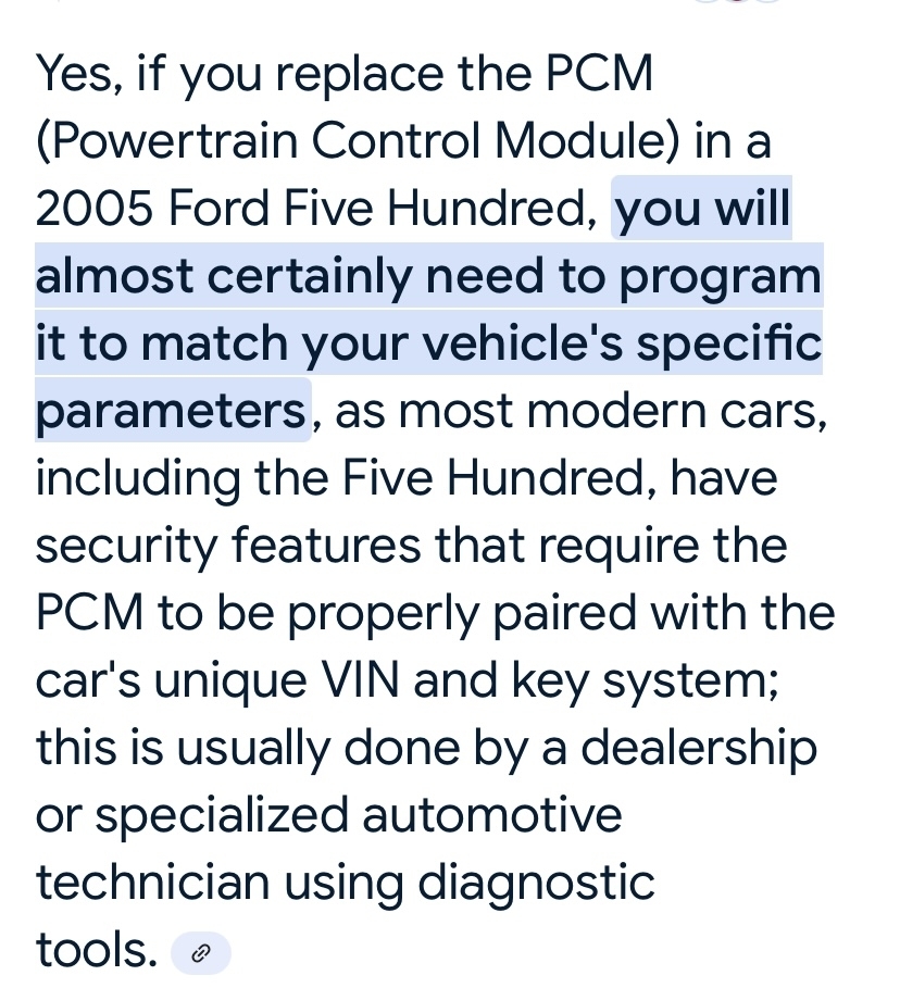

So when you say that there’s no programming needed are you referring to something other than what is being referenced in the screenshot that I attached?
Feb 1, 2025 at 3:25 AM
  • 55,433 POSTS
AllData says no, fyi, and from personal experience it does not need to be programmed, this is a Ford only, all other cars need to be programmed.
