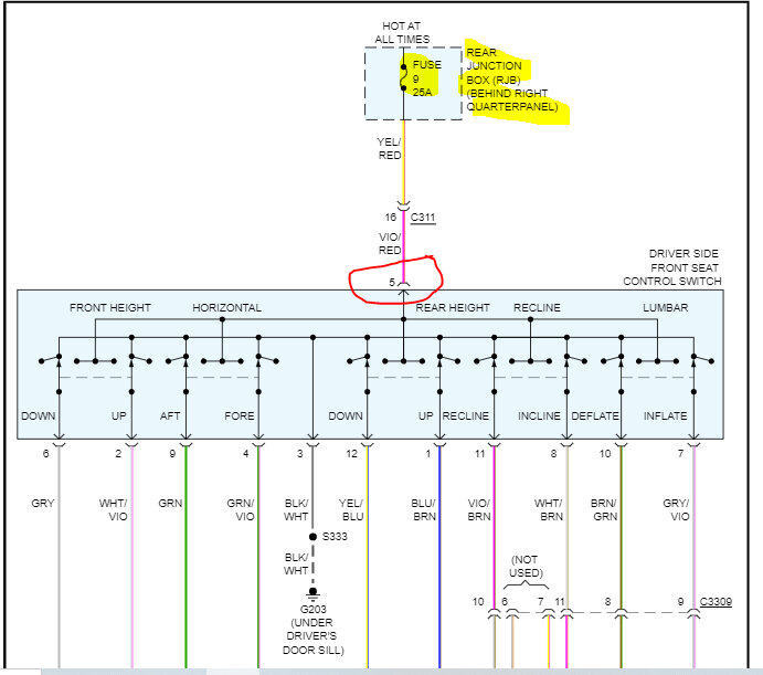

The power supply to the driver's power seat comes from fuse 9 located in the rear junction box. When you checked the fuse, did you also confirm there is power to and from it? If not, here is a link that explains how that is done:

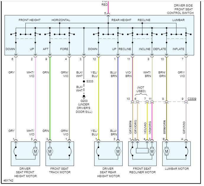

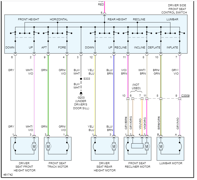

Next, at the seat switch, there will be a violet wire with a red tracer. That is the power wire. I need you to check if it has power to it. If it does, then either the switch is faulty, or the motors have failed. If there is no power, return the switch. We need to find where there is an open circuit in that wire.
I attached the wiring schematic below, so you have a reference.
Let me know what you find.
See pics below. Note: The schematic was one page. I had to cut it in half to make it readable for you. I did, however, overlap the two so you can follow from one to the next.

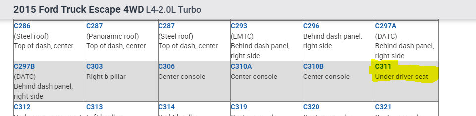

Okay, the power is available but doesn't make it to the switch. If you look at the pic I attached above, note the two different wires (colors) that are connected together (C311). C 311 is a connector. It is located under the driver's seat. see pic below.
I need you to locate that connector. Unplug the two wires and see if power is making it to the yellow wire with the red tracer. If it is, closely inspect the connector for damage, corrosion, or wire damage.
See pic below.
