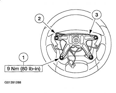

The on/off cruise control botton is broken. I understand I need to replace the entire switch. How do I remove the switch in order to replace it?

Speed Control Switch Removal and Installation Remove the steering wheel. For additional information, WARNING:When carrying a live air bag, make sure the bag and trim cover are pointed away from your body. In the unlikely event of an accidental deployment, the bag will then deploy with minimal chance of injury. Failure to follow these instructions may result in personal injury. Remove the steering wheel cover. Remove the steering wheel frame. Remove the nuts. Disconnect the ground wire. Remove the steering wheel frame. Fig. 36: Removing Steering Wheel Frame Courtesy of FORD MOTOR CO.
https://images.2carpros.com/forum/automotive_pictures/266999_36_1.jpg
Disconnect the speed control switches electrical connector. Remove the speed control switches. Remove the screws. Remove the speed control switches. To install, reverse the removal procedure.
