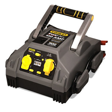

I have a portable jump starter and when I hook it up and turn the knob to the "jump" position, i get full lights, door dinging, etc. Dash says I am at like 11.9 volts.
When I turn it off from the jump position, I get nothing. No lights, no dinging, literally zero indication of any power. Also, after turning the jump off (I didn't start it, it is 5:00 am and I am not trying to wake up the neighbors), there was a slight clicking (not the clicking when attempting to start) in the front right of the vehicle (if I am at the front of the hood, front right area towards what seems to be drivers side).
