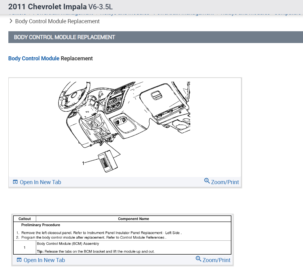

Thats a good one! This sounds like a BCM issue but to be sure let's do a CAN scan which is easy, you can get a CAN scanner (Controller Area Network) from Amazon from about $32.00.
https://youtu.be/u-4syLc-ifQ
and
Amazon CAN scanner link:
https://amzn.to/3sX8MCX

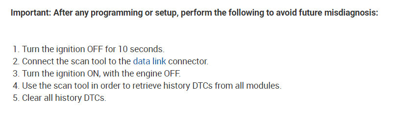

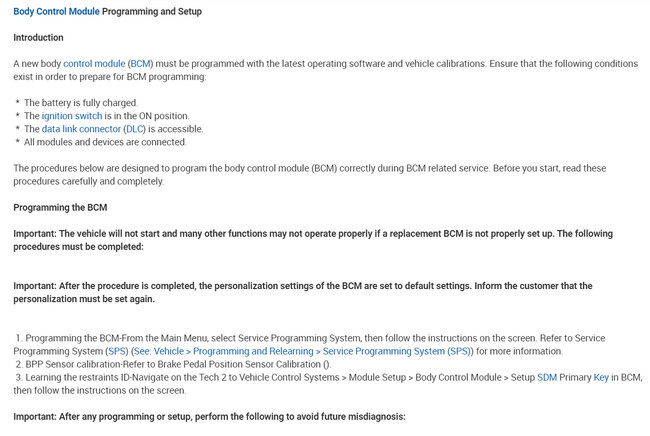

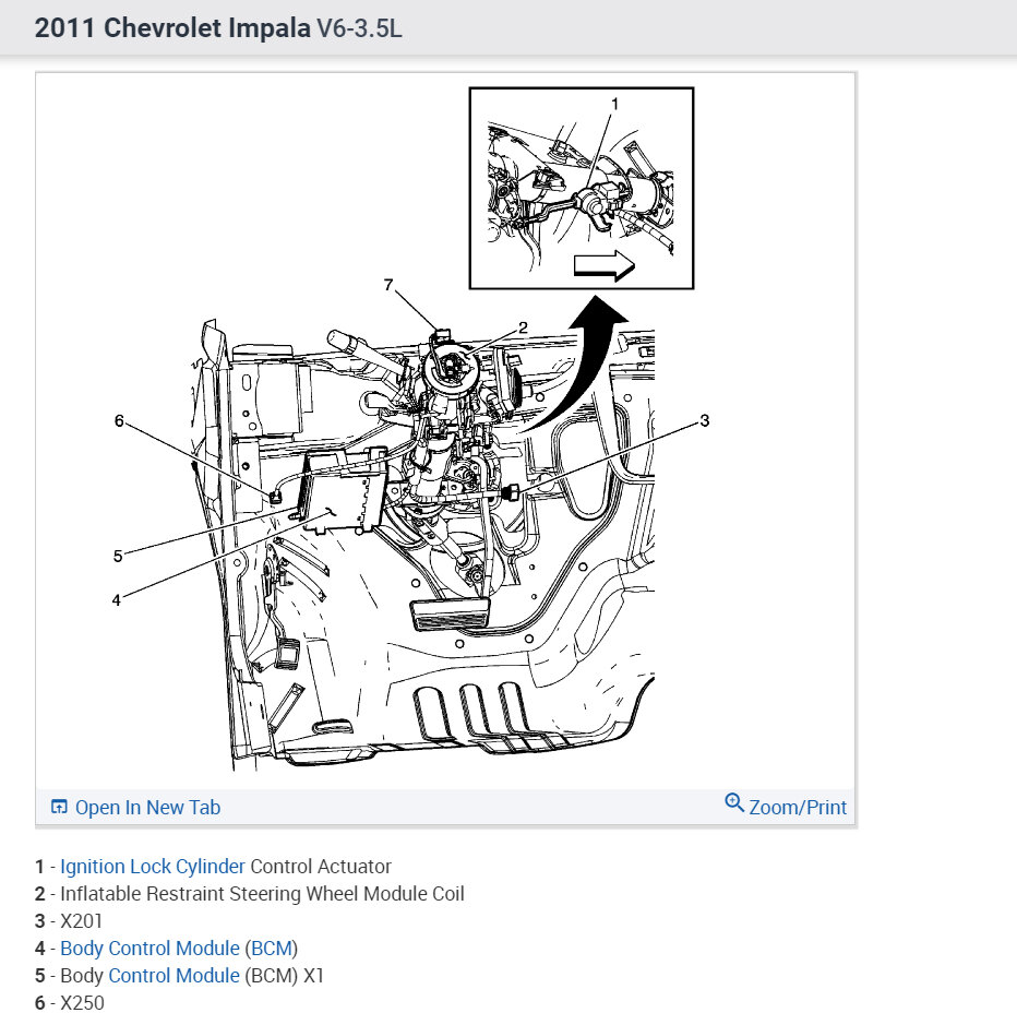

Here are the BCM location and replacement instructions in case you need them. You can get a preprogrammed unit by searching Google or eBay.
