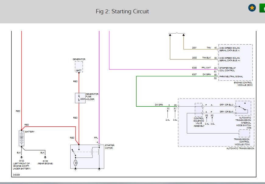

Hello again,
Okay, so in the diagrams down below I have included a wiring diagram of your vehicle's starting circuit for you. Please use this for reference. So what we are going to do is systematically work through the circuit until we find the section with the problem, and then, fix it. So, let's start with the battery. Can you test the battery by getting a voltage reading across the terminals and get back to us with what you are able to find out.
We can go from there.

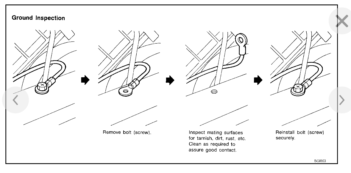

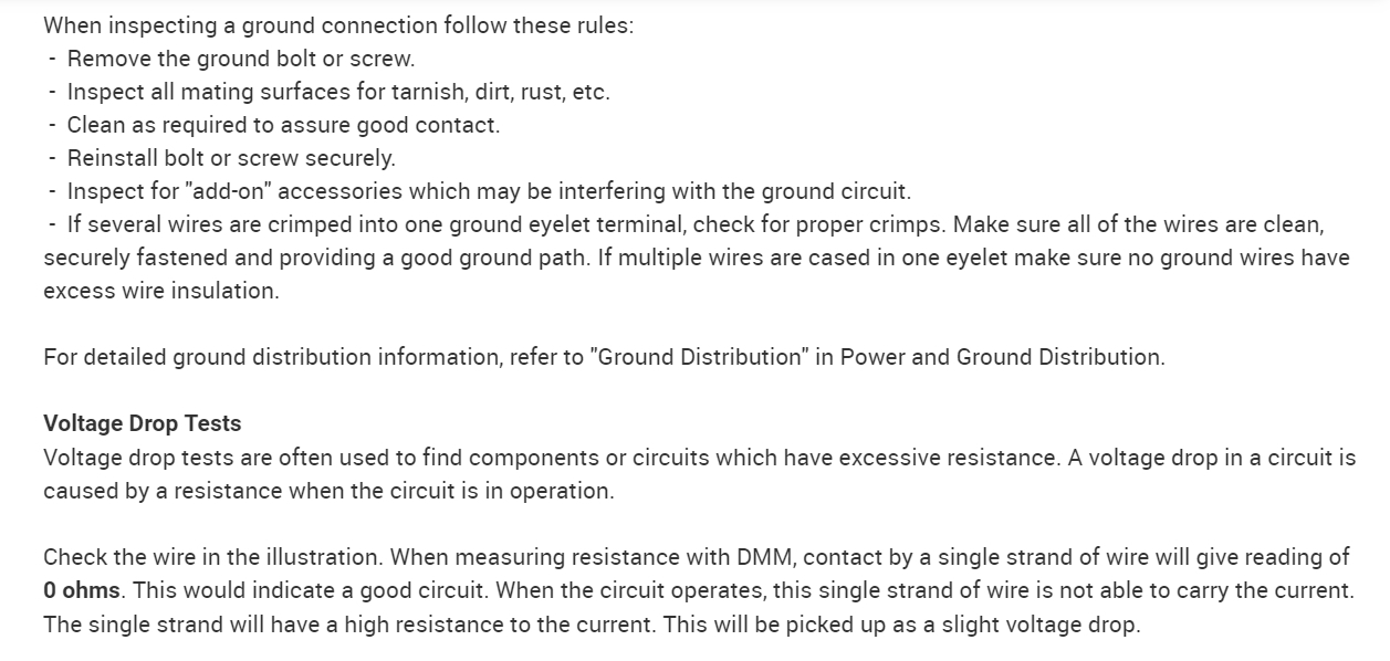

Okay, you kinda jumped the gun here by going to the starter solenoid, we're on the other end still. Okay, next please check Ground #109, located on the top rear of the engine. In the diagrams down below I have included instructions for how to properly inspect grounds for you. Please go through these guides and get back to us with what you are able to find out.

Ground is clean and good contact

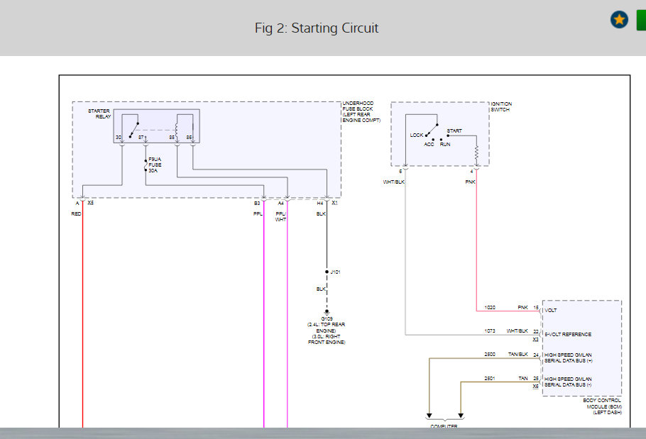

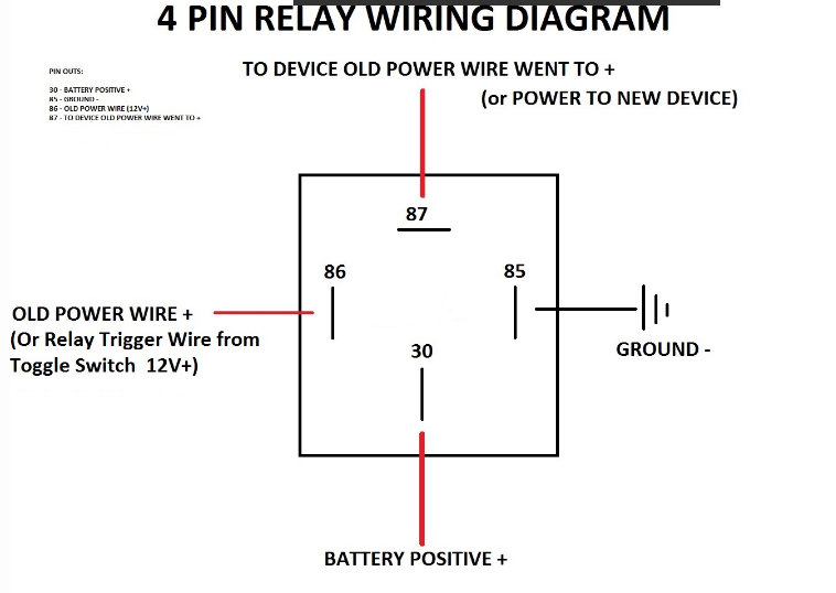

Hello again,
If you look at the starting circuit wiring diagram I provided in the first reply I sent you on the top left is the starter relay. Then dashed box around it represents the Under hood Fuse Block, where the relay is located on your vehicle. Now, if you look at the four wires going to the relay, there are corresponding numbers beside each wire where they go into the relay. These are the pin numbers on the relay. In the diagrams down below I have included a diagram of a 4 Pin relay for reference. Again, please get a voltage reading from Pin #85 of the starter relay with a helper turning the ignition key to the "start" position and get back to us with what you are able to find out.

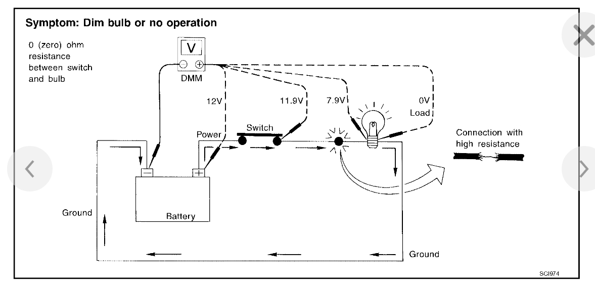

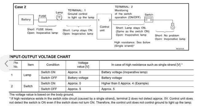

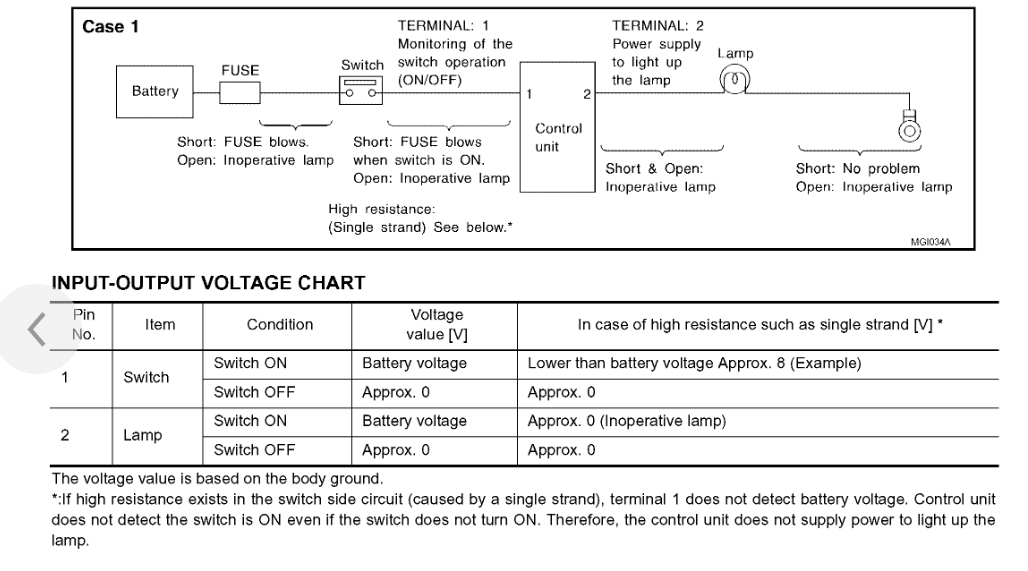

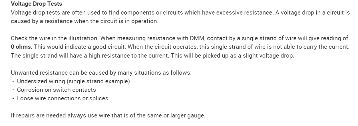

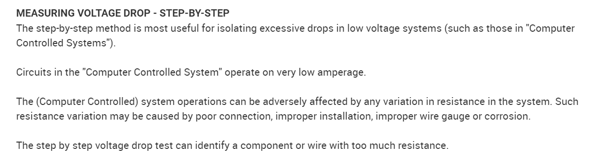

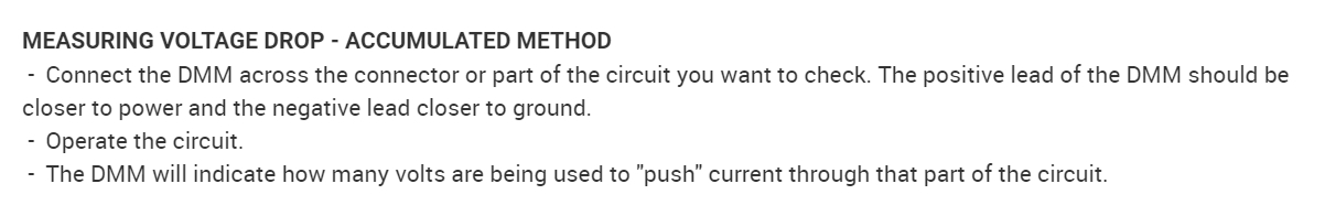

Okay, we're getting close now. Do a voltage drop test on the purple/white wire from pin #63 of the Engine Control Module (ECM) to Pin #85 of the Starter Relay. I have included instructions on how to do a voltage drop test in the diagrams down below. It is very easy to damage a connector to the ECM, so the easiest safest way to get a test probe at the ECM connector is to get a safety pin. Get it so the pin is straighten out and back probe the cavity where the wire you are testing is. The wire usually has a rubber weatherproofing grommet around it so push firmly, but not enough to push past the pin. Do not ground the safety pin. Now you have a good metal to metal contact point for the multi-meter test probe without damaging the connector. Please get back to us with what you are able to find out.

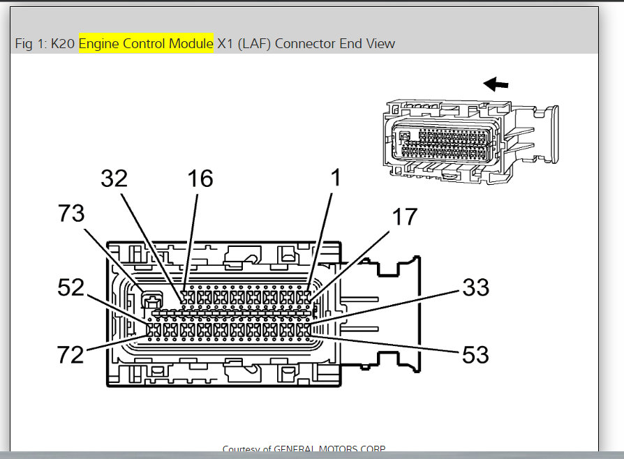

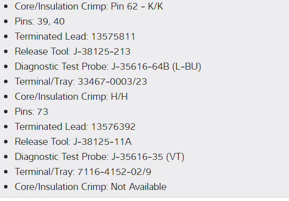

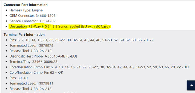

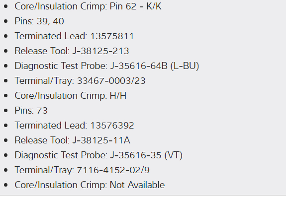

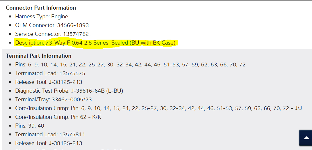

Okay, so I have 3 connectors on the ECM, blue black and grey, which purple and white would be the pin 63.
Jul 28, 2019 at 3:15 PM
SCGRANTURISMO
  • 4,897 POSTS
Hello again,
In the diagrams down below I have included the connector that the wire connects into. Please go through the guide and get back to us with what you find out. We will go from there.
Thanks,
Alex
2CarPros
Jul 28, 2019 at 8:29 PM
SEANARN
  • 15 POSTS
If I did it correctly, i was reading .017 when the key was turned to the crank position.

SCGRANTURISMO
  • 4,897 POSTS
Hello again,
Okay, with the relay out there should be 0 Volts at pin 85. Pin 85 is the Ground for the electromagnetic coil and is supplied by the ECM through the purple/white wire. Trace the purple/white wire from pin 85 to the ECM and look for a short to power anywhere along the wire. If none is found then the ECM has an internal short to power in it and will need to be replaced. Get back to us with what you find, please.
