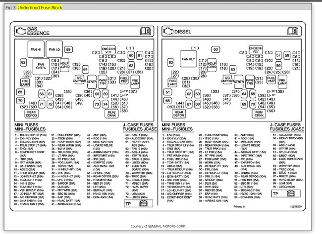

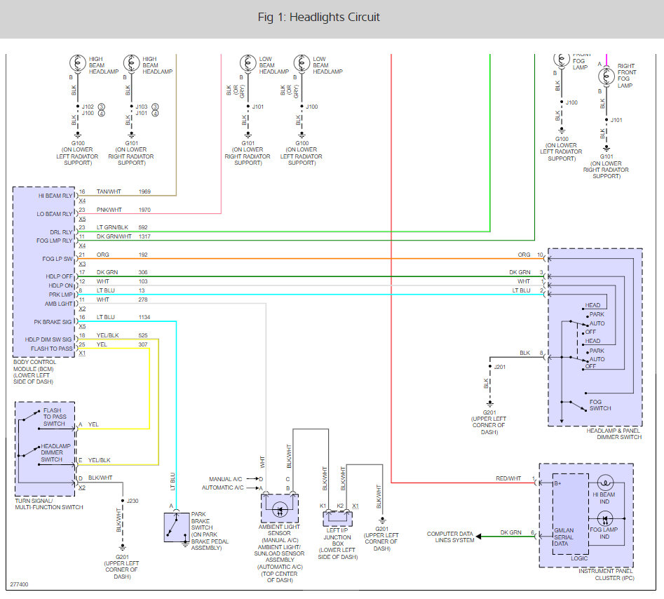

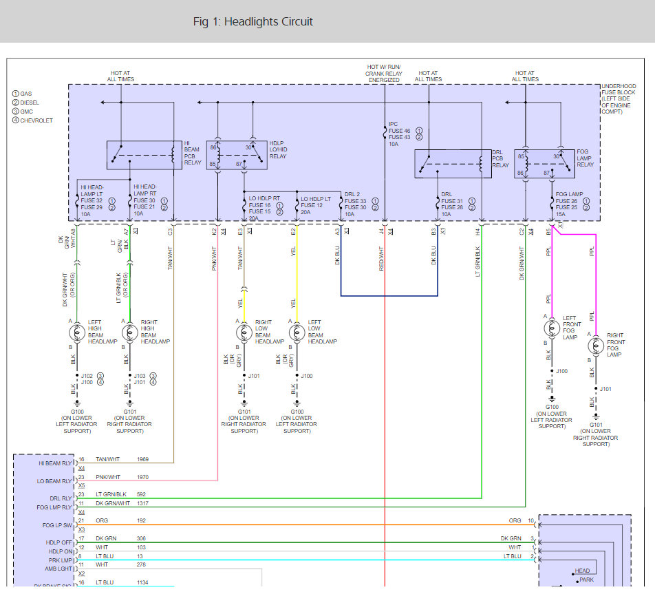

My high beams are not working. I checked the fuses. They did not light up, therefore I assumed they were burnt out. After removing them and inspecting them, they seemed fine. I then placed brand new fuses in just as a precautionary measure. Still no high beams. I am stuck I have no idea where to go from here. I have already checked the bulbs and they are fine. Can you please help me out?
Aug 7, 2017 at 12:17 PM
  • 55,745 POSTS
It sounds like you have a fuse or a relay that is out. Here are some guides and diagrams to help us get the problem fixed.
and
Please let us know what happens, we are interested to see what it is.
