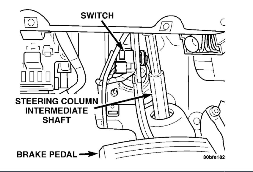

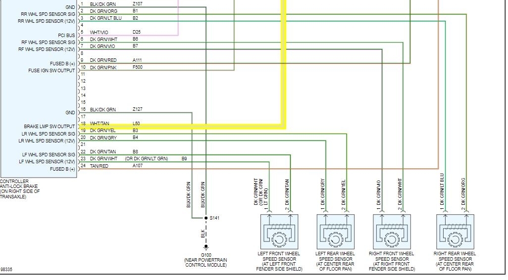

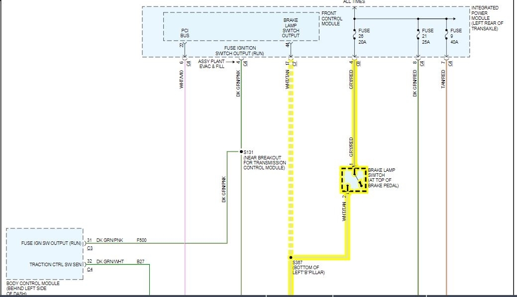

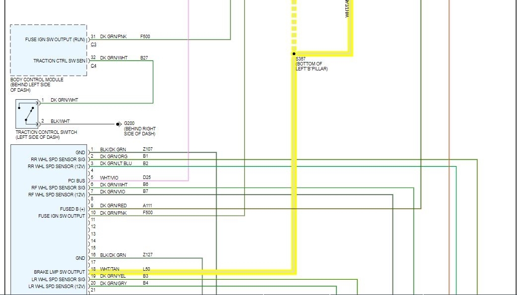

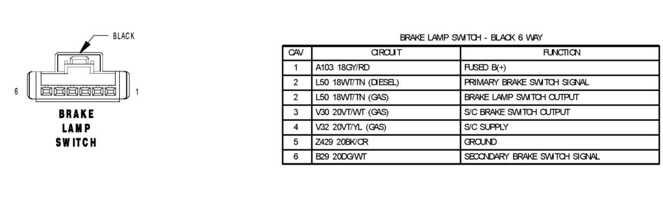

I have no rear turn signal lights and i only have the middle brake light. What is most likely the problem?
May 17, 2019 at 9:22 AM
Okay, try this:
Go under the dash and disconnect the stop light switch. I attached a picture for you.
https://www.2carpros.com/articles/brake-lights-not-working
See if the issue is still present when you press the pedal.
If it is, replace the TIPM.

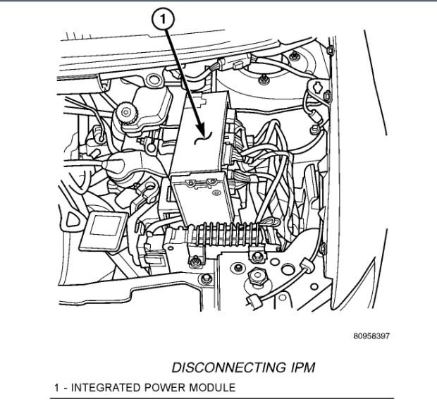

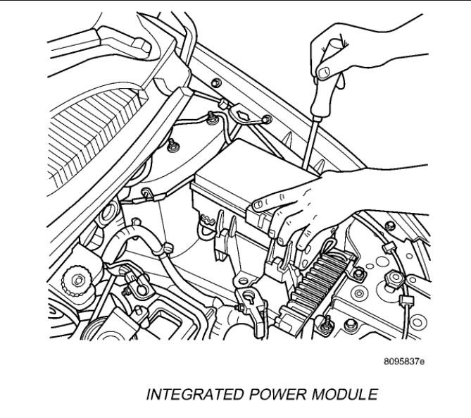

Integrated Power Module
4. Using a flat-bladed screwdriver, twist the Integrated Power Module (IPM) bracket retaining latch outward to free the IPM from its mounting bracket
Disconnecting IPM
5. Rotate the IPM counter-clockwise to access and disconnect the electrical connectors.
6. Remove the IPM bracket clips from the hinge.
