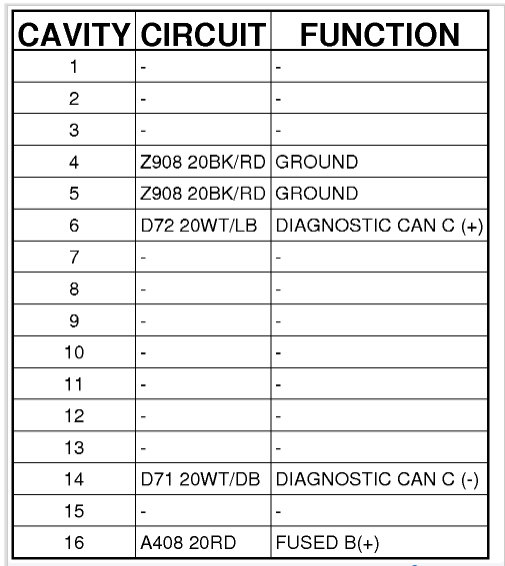

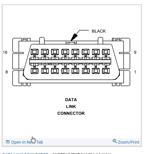

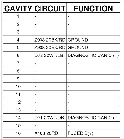

Sorry if I wasn't clear. I meant the voltage of the bus network which you get by measuring voltage at the DLC on pin 6 and ground. Then Pin 14 and ground with the key on.
Oct 21, 2019 at 4:11 PM
ROBERTMOGLIE
  • 21 POSTS
what is dlc?
Oct 21, 2019 at 4:29 PM
Sorry. It is the Data Link Connector. It is the one under the driver side dash that you plug a scan tool or code reader into.

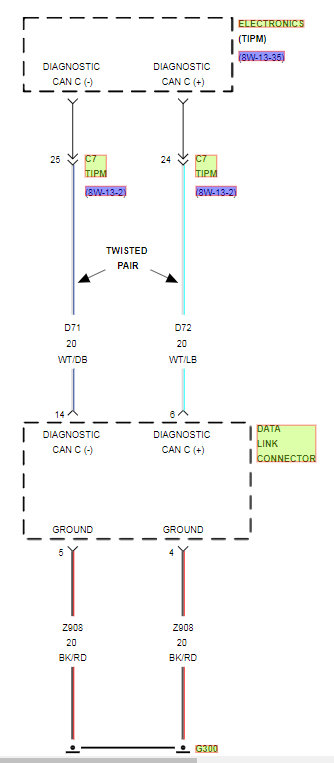

Okay Kenny. i have a 2010 Town and Country and a 2009 Town and Country. the 2009 is the one i am working on. measured 2010 pin 14 and ground came to 2.47 volts. on 2009 came to 1.7 volts. measured 6 and ground on both they are 0 on both. what next?
Nov 3, 2019 at 10:23 AM

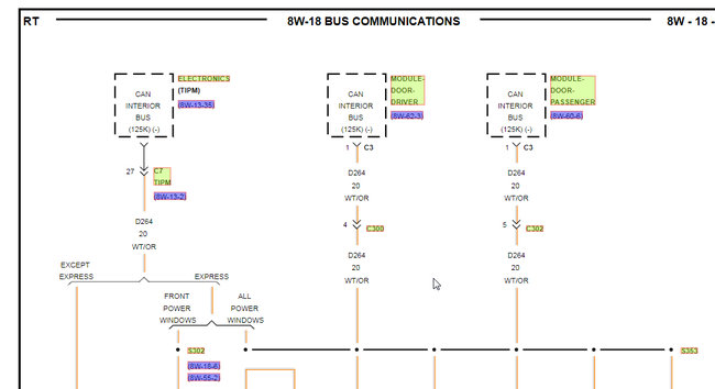

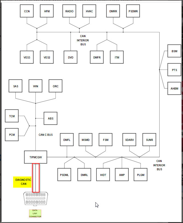

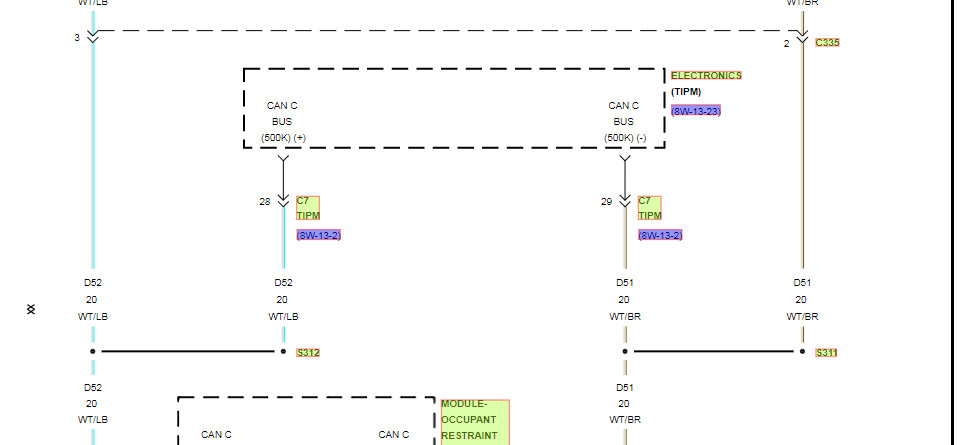

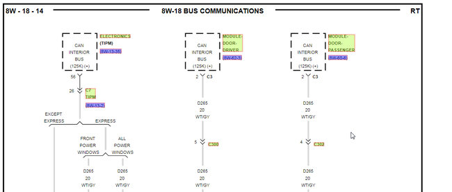

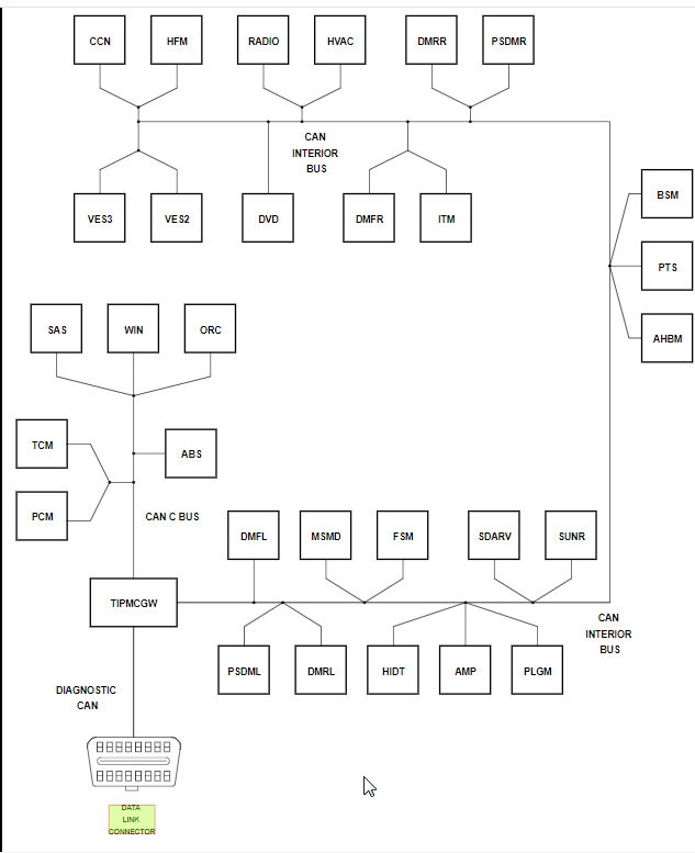

Okay. We are making progress. Hopefully I can explain this in clear terms because this is confusing.
You have a CAN bus network. This is an electrical network that allows the modules to communicate with each other. The voltage on this network needs to be correct or you will get the message of no bus like you are.
These two wires that you checked are the CAN C portion and you have the second portion called interior high speed bus (IHS). Take a look at the first attachment and it illustrates this a little more.

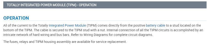

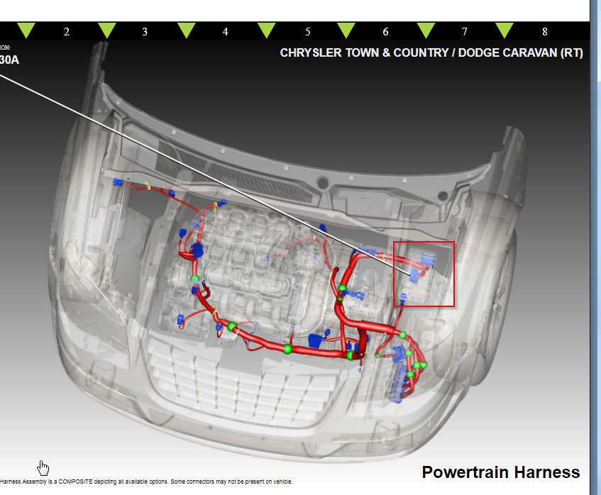

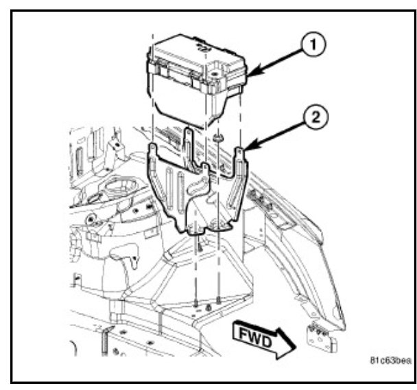

We now need to go to the back of the TIPM under the hood and back probe these specific networks and then unhook connectors (as you were) while watching these network voltages. Clearly you only have one meter so we can only do one at a time. So I want you too measure each wire individually and then let me know what they are. So that is four wires. The CAN C wires should equal 5 volts and be about 2.7 and 2.3 volts. About the same for the CAN IHS.
Based on what you found already, I imagine they are going to be low and then we will just pick one to look at when you are disconnecting connectors. When this voltage returns to normal, you will have just disconnected the issue. Either that specific connector or something down stream of it is the issue. We need to limit this down so that we can make it more manageable to find the issue.
On the back of the TIPM you will find connectors. You want C7 Pins 28 and 29 for CAN C. Then PIN 26 and 27 for IHS.
I am sure you have questions but if you can just get those voltages with the key on we can take the next step. Thanks

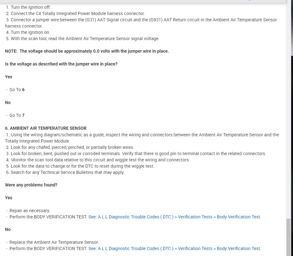

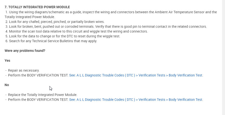

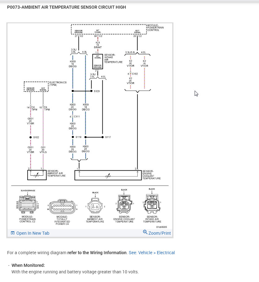

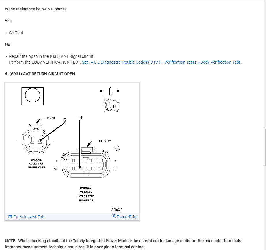

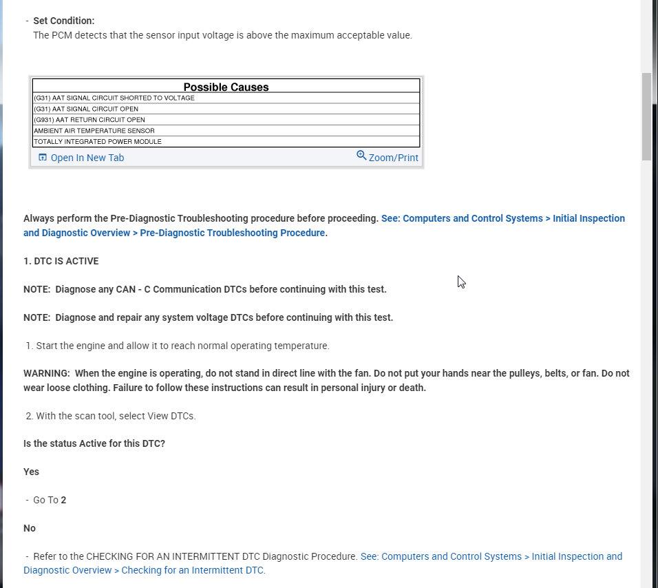

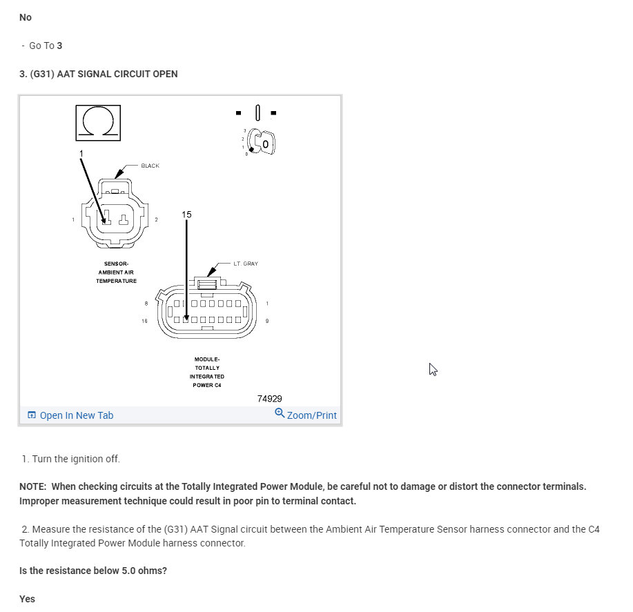

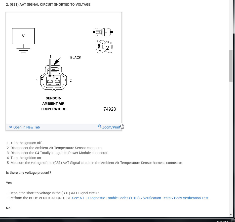

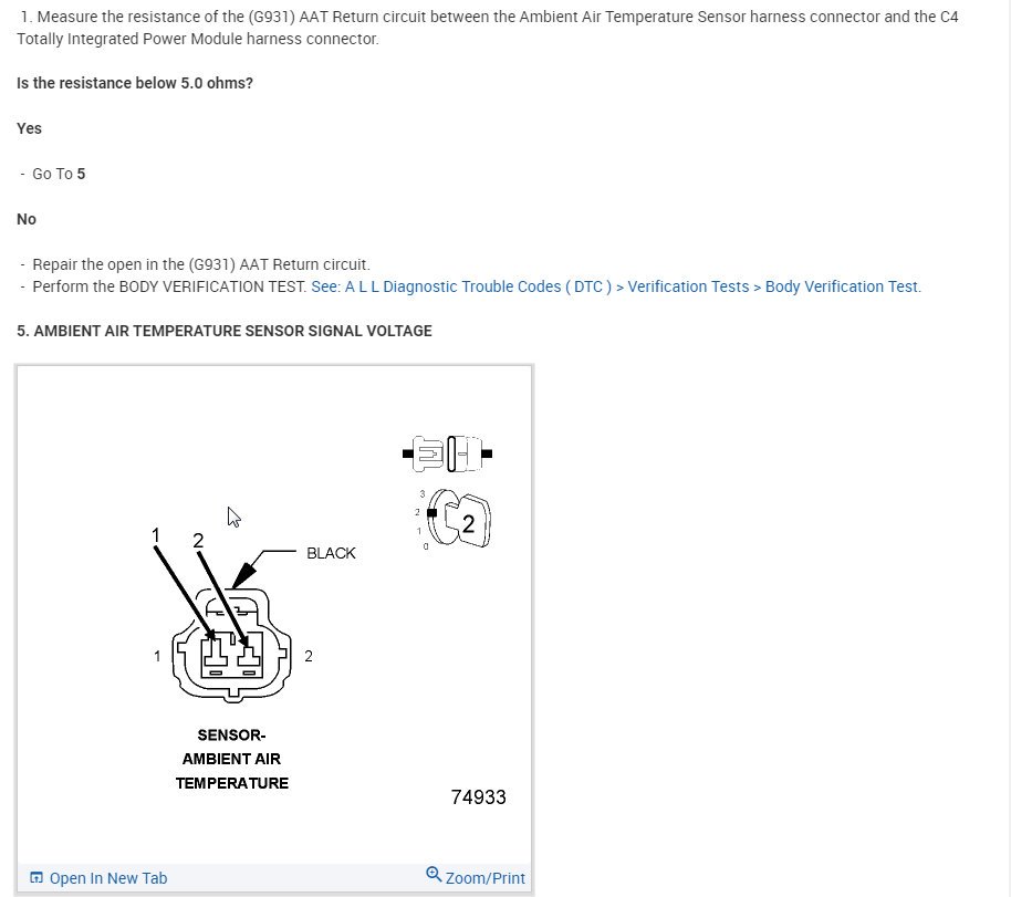

i used a different code reader it's not as nice but it worked. it reads p0073 then i/m readiness dtc #1 in red color--cat x the x is red--Hcat shows a zero with a slash in it. evap with red x.ccm green check mark. fue green check mark. also reads cal 1: a2 90 b3 bf. i cleared codes then ran the van. shut off key to on pos. reran and the cat showed up---inc Hcat n/a evap inc.o2s --inc.htr---inc egr--inc.
Nov 16, 2019 at 8:17 AM

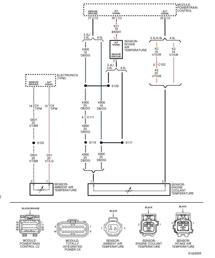

Okay. So I attached the test for this code. If you find that the issue causing this P0073 is a circuit issue you may find the issue for everything else.
Nov 16, 2019 at 3:32 PM

measured all pins.
Mar 14, 2020 at 3:07 PM
ROBERTMOGLIE
  • 21 POSTS
check pin 6 w/ground reads--3.o.
check pin14 w/ground reads1.6 volts .
with key on, connecting 4 and 16 12.2 volts.
with key on, terminals 5 andc 16 read 14.2 volts.
with key on, go to 4 and 14 terminals it reads 1.6 volts.
with key on, measuring 4 and 6 terminals for can bus reads 3.0.
I think it should read 2.63.
OHMS:
inserted 6 and 14 probes-- measured 61.5 ohms
Mar 14, 2020 at 5:03 PM

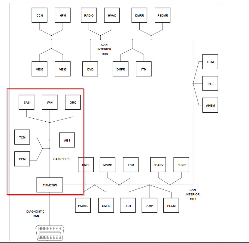

Pins 6 and 14 should equal about 5 volts and be around 2.7 and 2.3 volts. So if you are using a meter and getting 3 and 1.6 then you have an issue. At this point we need to continue to monitor this voltage and start unhooking the modules on CAN C one at a time and see when the voltage returns to normal.
I assume the last measurement you took for resistance on 6 and 14 was with the battery unhooked because that is a proper termination resistance on those two pins. If that is the case then that means you terminating resisting modules are good which if memory serves is the PCM and WIN.
If unhooking the modules does not result in any change then you most likely have a ground issue and based on the fact that this was in water, that may be the issue.
Mar 14, 2020 at 7:41 PM
