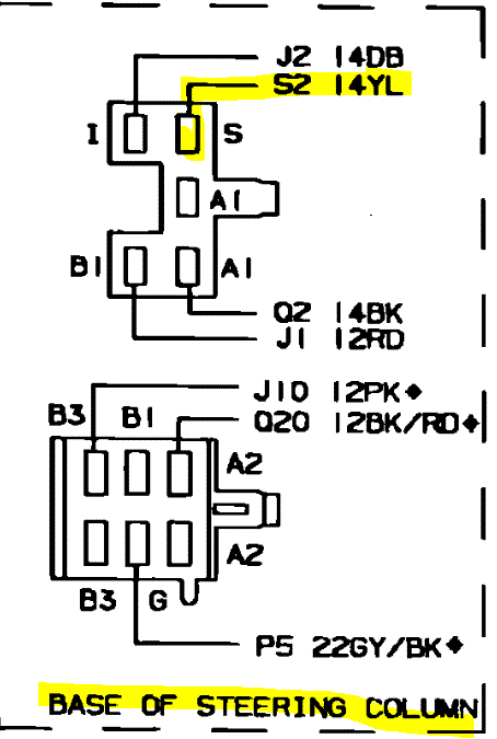

I just read over your message. Thank you for replying. The starter would not turn over by the key. I could bypass the starter relay and jump the wires at the starter, and it would engage. So, I replaced the ignition switch and the starter relay and still nothing. On the ignition switch the pk/bk wire is constantly hot. The rd/bk wire lights the test light when I turn the key in start and run position but the yellow wire going to the starter relay does not light the test light. So, I read where someone jumped the positive side of the coil to the positive side of the battery and it would start. When I did that the gauges and dash started working and it would crank over but not start. So that's where I am. The alternator is new and the battery with the ignition switch and starter relay.

Here is my issue. I'm not seeing the wire colors you mentioned. I did find the yellow and need to know where you are checking it. There is a connector at the bottom of the steering column that may have failed or corroded. See pic 1 below. Is that where you are checking power or right at the switch?

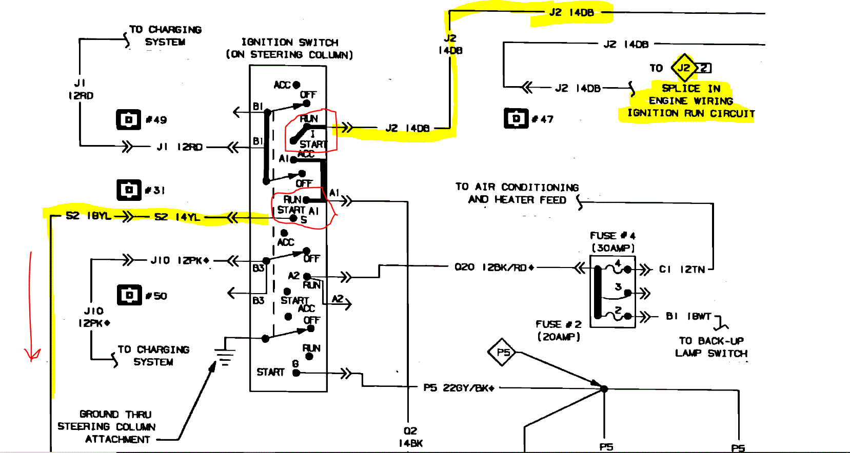

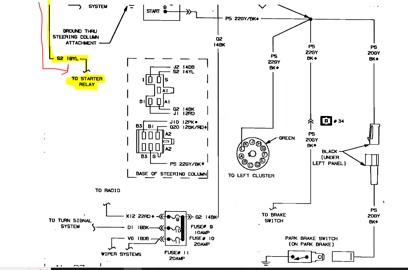

Next, I attached pics of the schematic that I'm reading. Take a look at it and let me know if the wire colors match what you have. Keep in mind, they may have faded. I highlighted the power supply to the starter relay.
I also highlighted the splice (pic 2) where I feel the problem may be located. These splices would turn green with corrosion and fail. But all the times I've dealt with them, it would crank but not start due to no power to the coil and no spark, so I'm questioning it as the issue at the same time. LOL

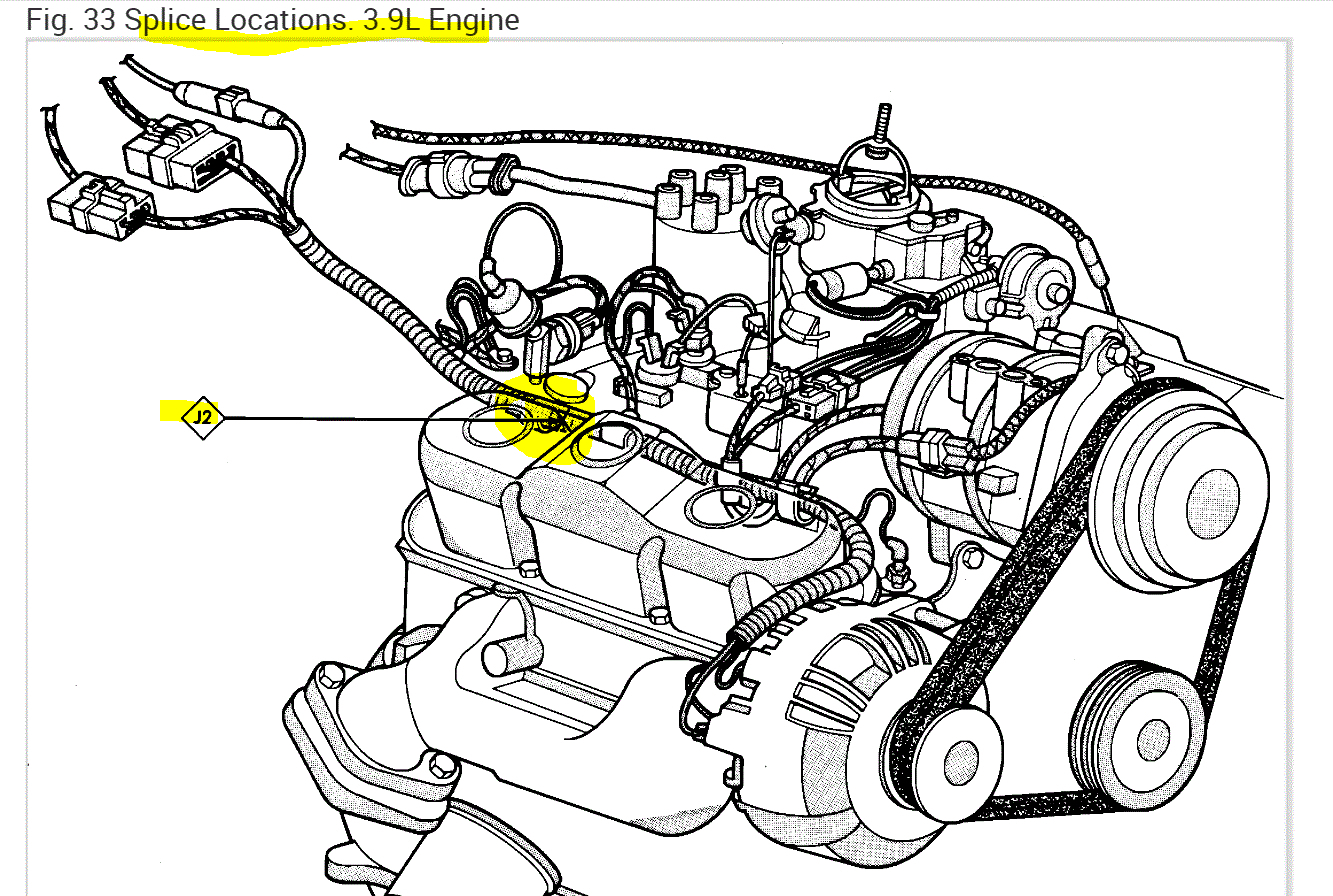

However, that is where I need you to start. Disconnect the negative terminal on the battery. Then, locate the splice in the engine wiring harness. See pic 4 for location. It should be a dark blue wire.
Do this and let me know what you find or if you have questions.
See pics below. You know, the more I think about this, the more I'm thinking that is the problem area. I love these old square-body Dakotas. We need to get this one running.
