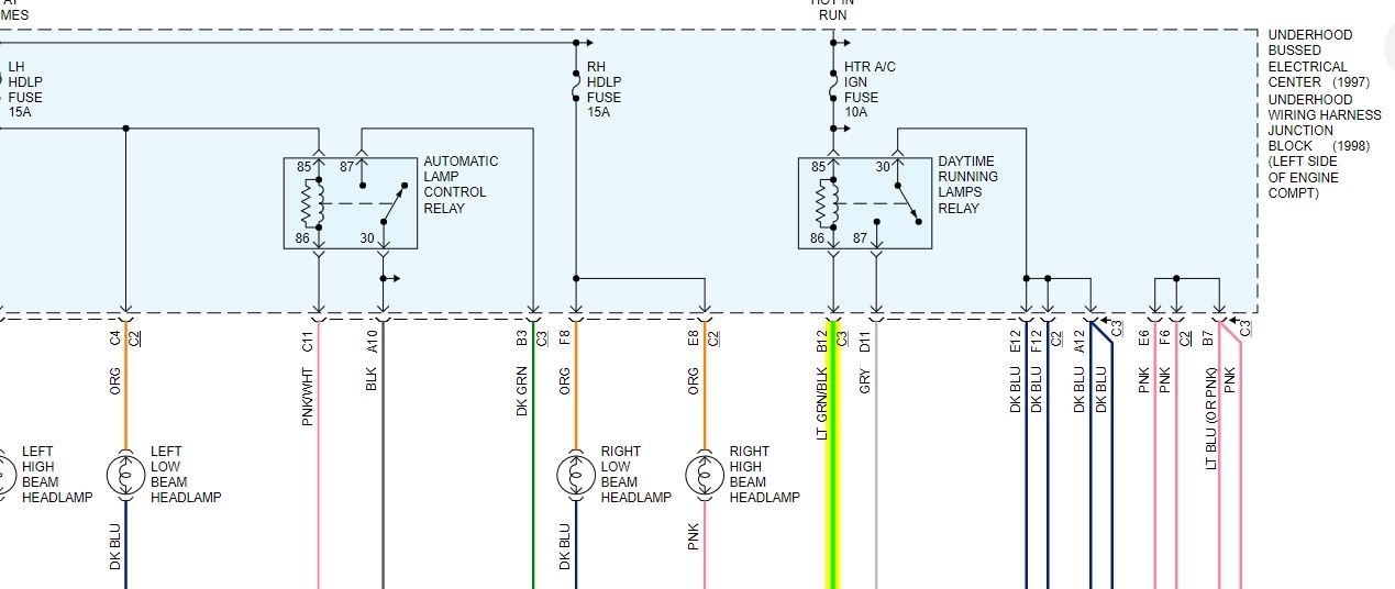

Okay, turn it on manually and they work? That is because you covered up the sensor.
The auto high beams is disabled until the DRL system is corrected.
Daytime Running Lamps (DRL) are standard on all automobiles sold in Canada and the United States. The daytime running lamps improve the visibility of the vehicle when viewed from the front in daylight. The normal DRL system utilizes low beam headlamps at reduced voltage supplied by a DRL control module located in the engine compartment.
Applying the parking brake before turning the ignition switch ON overrides the DRL feature. With the ignition switch ON and the parking brake off, the DRL's are fully active and unaffected by any further operation of the park brake. A DRL indicator in the I/P cluster alerts the driver to DRL system operation when the ignition is on and the ambient light level is low, such as at dusk.

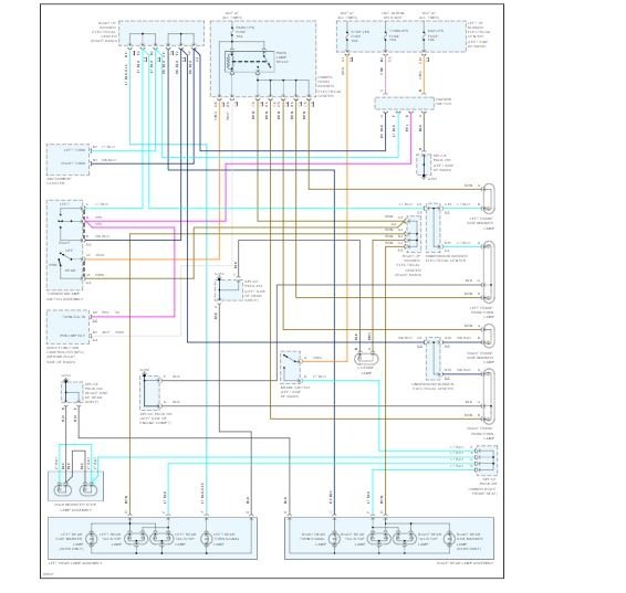

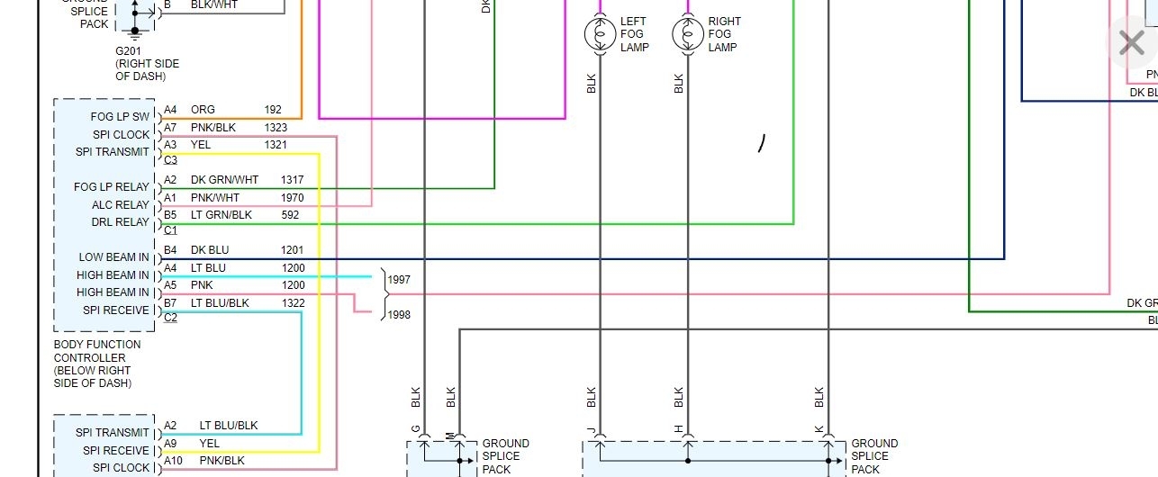

I attached some diagrams for you to view. Make sure the DRL relay is functioning.
Mar 4, 2019 at 9:46 PM
