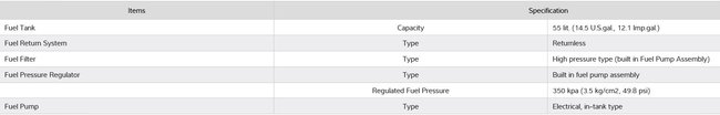

Hi. I have two electric fuel pump with a little different. first one has 3.5 bar operating pressure and 90 lph flow. the other has 3.1 bar with same flow. Which one is better for my v6 2.7 engine?

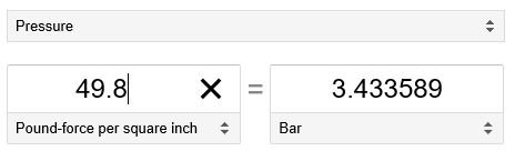

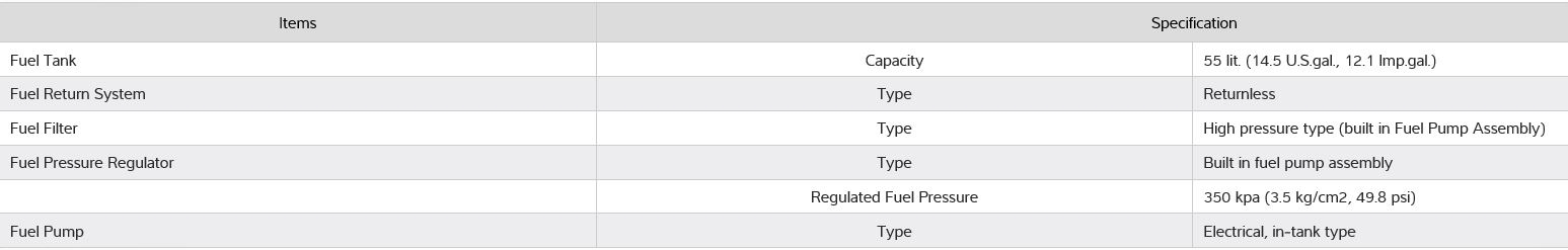

The spec for fuel pump pressure is 49.8 psi and that converts to 3.43 bar. You need the 3.5 bar then.
