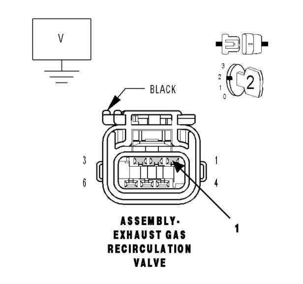

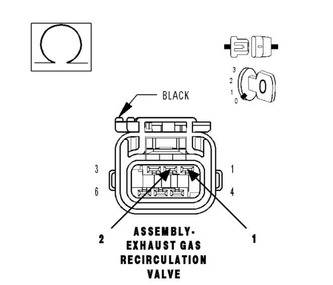

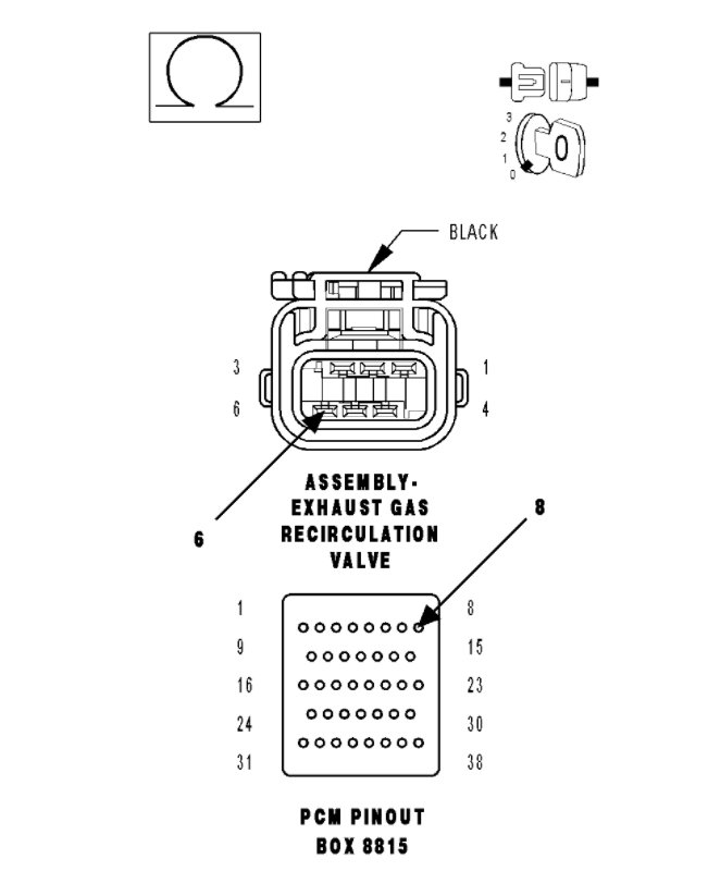

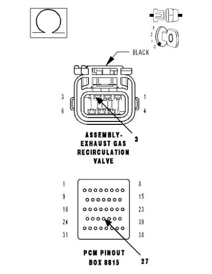

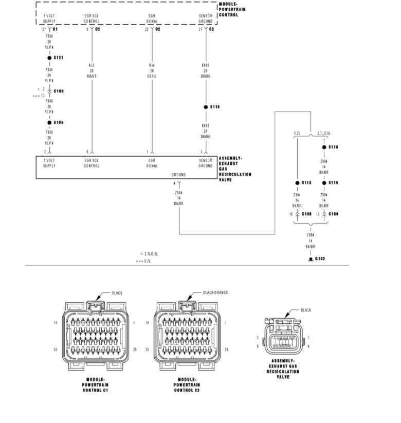

Okay, the indicates a circuit issue with the EGR itself. I would follow the flow chart to make sure you made the correct call. I have my doubts the EGR was the issue.
P0406-EGR POSITION SENSOR CIRCUIT HIGH
For a complete wiring diagram refer to: Electrical Diagrams
When Monitored
With the ignition on. Battery voltage greater than 10 volts.
Set Condition
EGR position sensor signal is greater than 4.89. One trip Fault.
Possible Causes
- (K34) EGR POSITION SENSOR SIGNAL CIRCUIT SHORTED TO (F856) 5-VOLT SUPPLY CIRCUIT
- (K34) EGR POSITION SENSOR SIGNAL CIRCUIT SHORTED TO BATTERY VOLTAGE
- (K34) EGR POSITION SENSOR SIGNAL CIRCUIT OPEN
- (K900) SENSOR GROUND CIRCUIT OPEN
- EGR SOLENOID ASSEMBLY
- PCM
Always perform the Pre-Diagnostic Troubleshooting procedure before proceeding.
Diagnostic Test
1. EGR POSITION SENSOR VOLTAGE ABOVE 4.5 VOLTS
Start the engine.
With the scan tool, read the EGR Position Sensor voltage.
Is the voltage above 4.5 volts?
Yes >> Go To 2
No >> Go To 8
2. (K34) EGR POSITION SENSOR SIGNAL CIRCUIT SHORTED TO THE (F856) 5-VOLT SUPPLY CIRCUIT
Turn the ignition off.
Disconnect the EGR Solenoid harness connector. Disconnect the PCM harness connectors.
Measure the resistance between the (K34) EGR Position Sensor Signal circuit and the (F856) 5-volt Supply circuit in the EGR Solenoid harness connector.
Is the resistance below 100 ohms?
Yes >> Repair the short between the (K34) EGR Position Sensor Signal circuit and the (F856) 5-volt Supply circuit.
Perform POWERTRAIN VERIFICATION TEST. See: A L L Diagnostic Trouble Codes ( DTC ) > Verification Tests > Powertrain Verification Test
No >> Go To 3
3. (K34) EGR POSITION SENSOR SIGNAL CIRCUIT SHORTED TO BATTERY VOLTAGE
Ignition on, engine not running.
Measure the voltage on the (K34) EGR Sensor Signal circuit in the EGR Solenoid harness connector.
Is the voltage above 0 volts?
Yes >> Repair the short to battery voltage in the (K34) EGR Position Sensor Signal circuit.
No >> Go To 4
4. EGR SOLENOID ASSEMBLY
Connect the PCM harness connectors.
Connect a jumper wire between the (K34) EGR Position Sensor Signal circuit and the (K900) Sensor ground circuit.
With the scan tool, monitor the EGR Position Sensor voltage. Ignition on, engine not running.
Is the voltage below 0.5 of a volt?
Yes >> Replace the EGR Solenoid Assembly.
No >> Go To 5
NOTE: Remove the jumper wire before continuing.
5. (K34) EGR POSITION SENSOR SIGNAL CIRCUIT OPEN
CAUTION: Do not probe the PCM harness connectors. Probing the PCM harness connectors will damage the PCM terminals resulting in poor terminal to pin connection. Install Miller Special Tool #8815 to perform diagnosis.
Measure the resistance of the (K34) EGR Position Sensor Signal circuit from the EGR Solenoid harness connector to the appropriate terminal of special tool #8815.
Is the resistance below 5.0 ohms?
Yes >> Go To 6
No >> Repair the open in the (K34) EGR Position Sensor Signal circuit.
6. (K900) SENSOR GROUND CIRCUIT OPEN
Measure the resistance of the (K900) Sensor ground circuit from the EGR Solenoid harness connector to the appropriate terminal of special tool #8815.
Is the resistance below 30 ohms?
Yes >> Go To 7
No >> Repair the open in the (K900) Sensor ground circuit.
7. PCM
NOTE: Before continuing, check the PCM harness connector terminals for corrosion, damage, or terminal push out. Repair as necessary.
Using the schematics as a guide, inspect the wire harness and connectors. Pay particular attention to all Power and Ground circuits.
Were there any problems found?
Yes >> Repair as necessary
No >> Replace and program the Powertrain Control Module per Service Information.
8. EGR POSITION SENSOR SWEEP
NOTE: The engine will run rough and possibly stall in the following test. Feather the accelerator pedal to keep the engine from stalling.
Start the engine.
With the scan tool, enter System Test and then EGR System Test. Push the 4=VARIABLE function.
Monitor the EGR voltage while slowly pushing the up arrow.
Is the voltage change smooth?
Yes >> Refer to the INTERMITTENT CONDITION Diagnostic Procedure.
No >> Replace the EGR Solenoid Assembly.

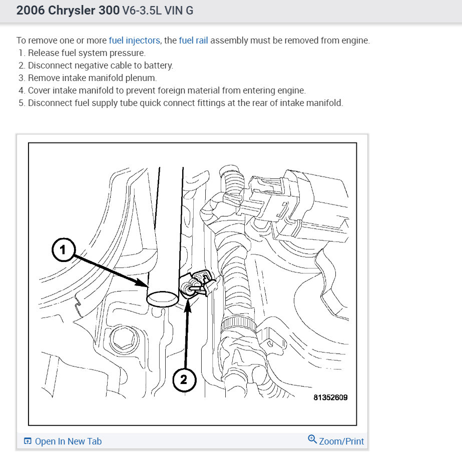

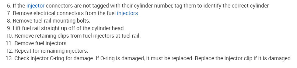

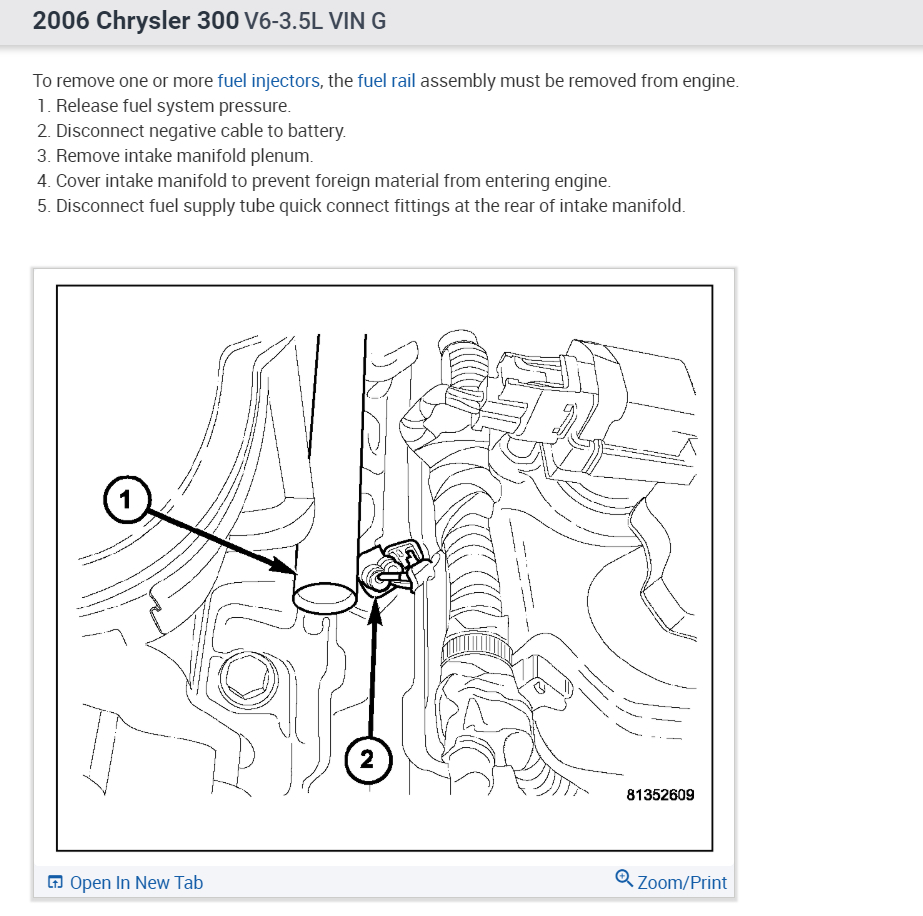

Thanks for the video. The engine sounds okay, it looks like you may have an fuel injector out causing the problem. Here is a guide to help test it to confirm with diagrams below to show you how to remove the injector:
https://www.2carpros.com/articles/how-to-test-a-fuel-injector
and
https://www.2carpros.com/articles/how-to-replace-a-fuel-injector
Check out the diagrams (below). Please let us know what you find.

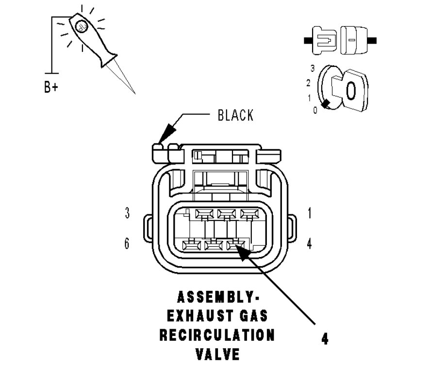

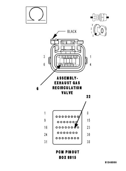

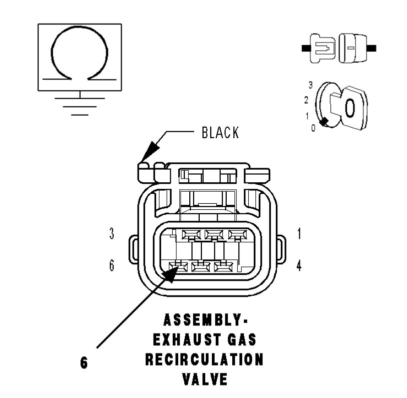

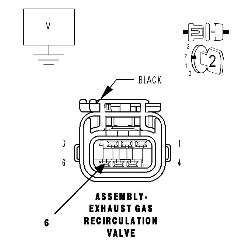

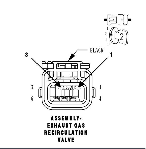

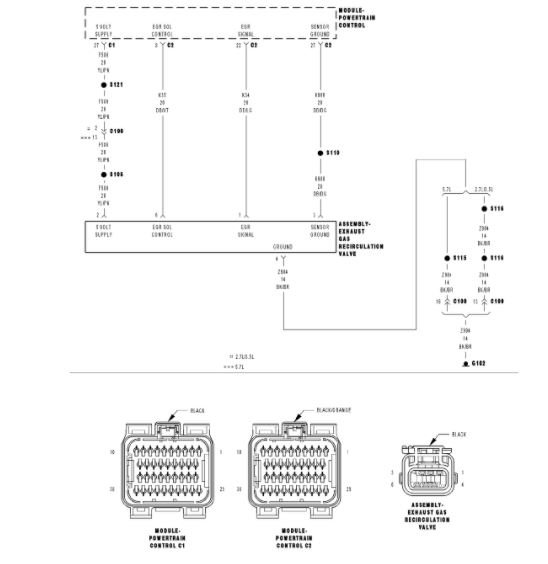

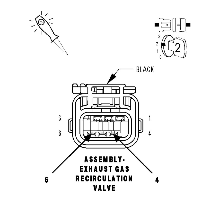

I attached a flow chart for you to view to determine the failure. I also posted connectors for you for testing.
When Monitored
Engine running. Battery voltage greater than 10 volts.
Set Condition
The EGR solenoid control circuit is not in the expected state when requested to operate by the PCM. One Trip Fault.
Possible Causes
- (Z904) EGR SOLENOID GROUND CIRCUIT OPEN
- (K35) EGR SOLENOID CONTROL CIRCUIT SHORTED TO BATTERY VOLTAGE
- (K35) EGR SOLENOID CONTROL CIRCUIT SHORTED TO GROUND
- (K35) EGR SOLENOID CONTROL CIRCUIT SHORTED TO THE (K900) SENSOR GROUND CIRCUIT
- (K35) EGR SOLENOID CONTROL CIRCUIT OPEN
- PCM
Diagnostic Test
1. ACTIVE DTC
Ignition on, engine not running. With a scan tool, read DTCs.
Is the DTC active at this time?
Yes >> Go To 2
No >> Refer to the INTERMITTENT CONDITION Diagnostic Procedure.
2. EGR SOLENOID ASSEMBLY
Turn off all accessories.
Using a 12-volt test light connected to the (Z904) EGR Solenoid ground circuit, probe the (K34) EGR Solenoid Control circuit.
With a scan tool, actuate the EGR solenoid.
Does the 12-volt test light flash on and off?
No >> Go To 3
3. (Z9048) EGR SOLENOID GROUND CIRCUIT OPEN
Using a 12-volt test light connected to the 12-volts, probe the (Z904) EGR Solenoid ground circuit in the EGR Solenoid harness connector.
Does the test light illuminate brightly?
Yes >> Go To 4
No >> Repair the open in the (Z904) EGR Solenoid ground circuit.
4. (K35) EGR SOLENOID CONTROL CIRCUIT SHORTED TO BATTERY VOLTAGE
Measure the voltage on the (K35) EGR Solenoid Control circuit in the EGR Solenoid connector.
Is the voltage above 1.0 volt?
Yes >> Repair the short to battery voltage in the (K35) EGR Solenoid Control circuit.
No >> Go To 5
5. (K35) EGR SOLENOID CONTROL CIRCUIT SHORTED TO GROUND
Measure the resistance between ground and the (K35) EGR Solenoid Control circuit in the EGR Solenoid harness connector.
Yes >> Repair the short to ground in the (K35) EGR Solenoid Control circuit.
No >> Go To 6
6. (K35) EGR SOLENOID CONTROL CIRCUIT SHORTED TO THE (K900) SENSOR GROUND CIRCUIT
Measure the resistance between the (K35) EGR Solenoid Control circuit and the (K900) Sensor ground circuit in the EGR Solenoid connector.
Yes >> Repair the short between the (K900) Sensor ground circuit and the (K35) EGR Solenoid Control circuit.
No >> Go To 7
7. (K35) EGR SOLENOID CONTROL CIRCUIT OPEN
Measure the resistance of the (K35) EGR Solenoid Control circuit from the EGR Solenoid harness connector to the appropriate terminal of special tool #8815.
Yes >> Go To 8
No >> Repair the open in the (K35) EGR Solenoid Control circuit.
8. PCM
