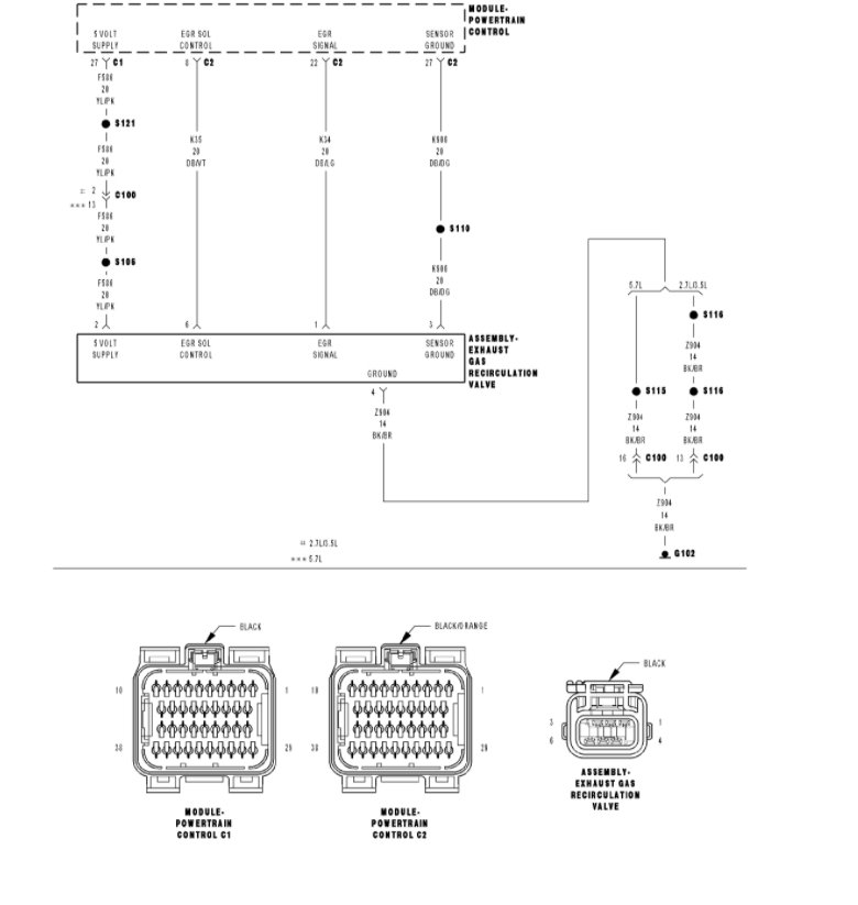

So when my friend gave me the car, the check engine light was on but it was not running rough, after a few days of driving it, four to five days, the car started shaking when at a red light, it takes a while to get up to speed, it smells way to much like gasoline, and at some points the rpm's will shoot up but the car wont advance much. Also, the check engine like makes a sound and flickers whenever i drive it. My question is, have i already messed this car up? I do not have the money to get the piece replaced right now and i want to continue to drive it at least another week. Please help.
Feb 3, 2019 at 8:08 AM
  • 110,241 POSTS
Honestly, the symptoms can be caused by several different issues. The first thing I need you to do is have the computer scanned. If the check engine light is flashing, then the engine has a misfire. That needs attention before other problems occur. However, I need to try to determine what is causing the misfire. That is why I need the trouble codes.
With that being said, here is a quick video that shows how to scan the computer:
https://youtu.be/YV3TRZwer8k
Now I realize most people don't own a scanner. However, most parts stores will do it for free. Have this done and let me know the codes that are found. At that point, I can direct you on what to check, replace, fix. Without the codes, it becomes a guessing game.
Let me know what you find.
Feb 3, 2019 at 11:28 AM
KIAGOKING
Thank you so much for responding Joe. I actually went ahead and got that done, it was only one code: P0403.
Feb 3, 2019 at 11:36 AM
  • 110,241 POSTS
Welcome back:
Okay, that deals only with the EGR. It is an electrical issue that can be caused by any of the following:
POSSIBLE CAUSES
- (Z904) EGR solenoid ground circuit open
- (K35) EGR solenoid control circuit shorted to battery voltage
- (K35) EGR solenoid control circuit shorted to ground
- (K35) EGR solenoid control circuit shorted to the (K900) sensor ground circuit
- (K35) EGR solenoid control circuit open
- EGR solenoid assembly
- PCM
_____________________________________

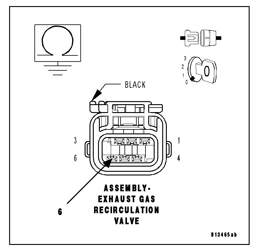

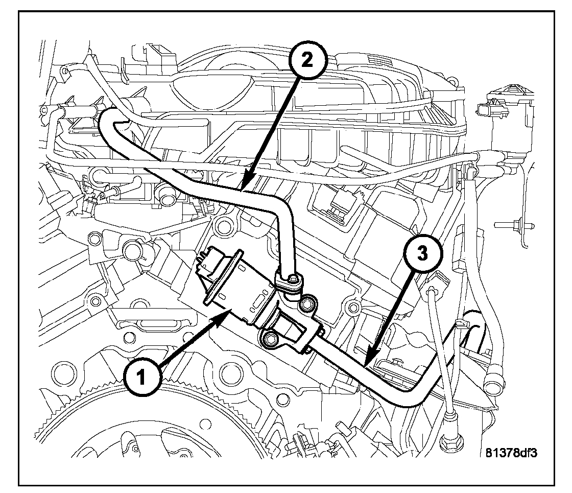

Diagnostic test/you already did this and know the code is present. Jump to #2
1. ACTIVE DTC
Ignition on, engine not running.
With a scan tool, read DTCs.
Q: Is the DTC active at this time?
YES: Go To 2
NO: Refer to the INTERMITTENT CONDITION Diagnostic Procedure. See: Computers and Control Systems > Component Tests and General Diagnostics > Intermittent Condition
Perform the POWERTRAIN VERIFICATION TEST. See: A L L Diagnostic Trouble Codes ( DTC ) > Verification Tests > Powertrain Verification Test

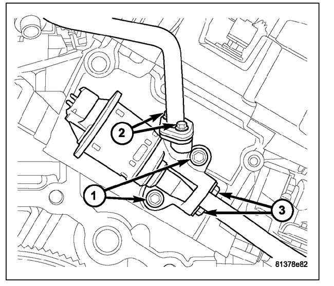

Picture 1

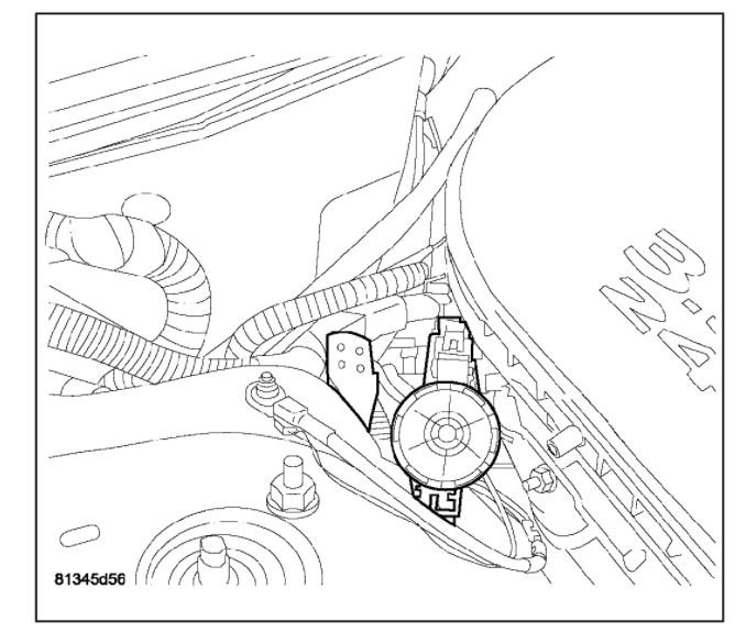

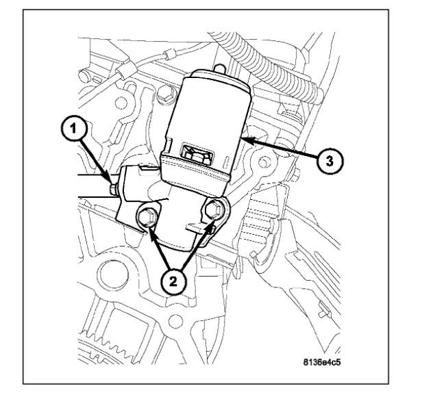

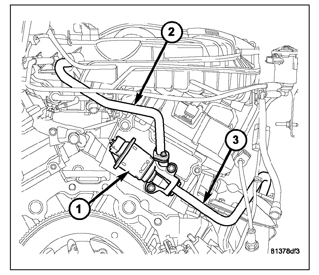

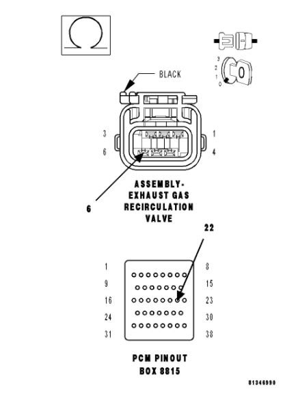

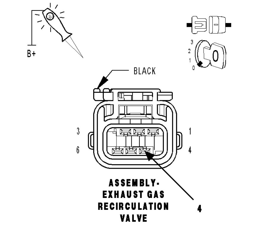

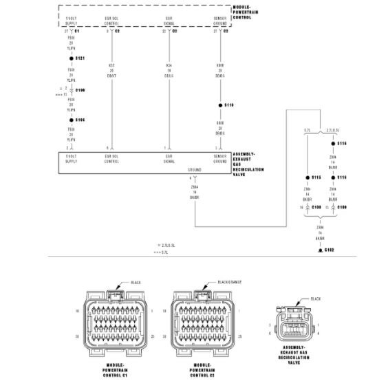

2. EGR SOLENOID ASSEMBLY
Turn the ignition off.
Disconnect the EGR Solenoid harness connector
Turn off all accessories.
Using a 12-volt test light connected to the (Z904) EGR Solenoid ground circuit, probe the (K34) EGR Solenoid Control circuit.
With a scan tool, actuate the EGR solenoid.
Q: Does the 12-volt test light flash on and off?
YES: Replace the EGR Solenoid Assembly. Perform the POWERTRAIN VERIFICATION TEST. See: A L L Diagnostic Trouble Codes ( DTC ) > Verification Tests > Powertrain Verification Test
NO: Go To 3

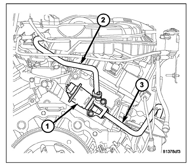

Picture 2

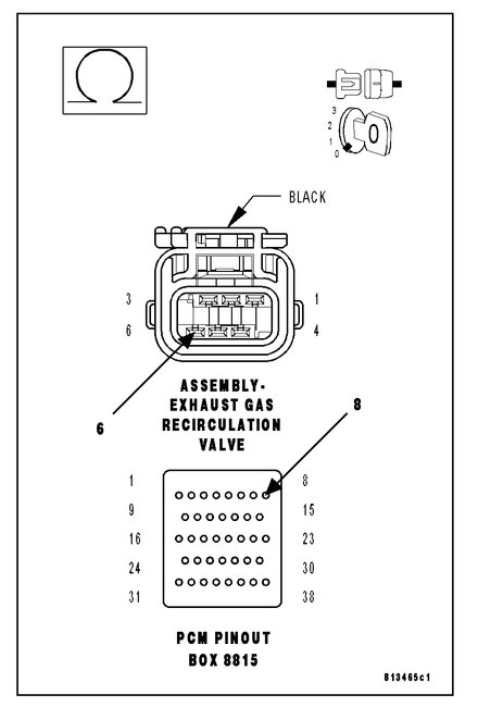

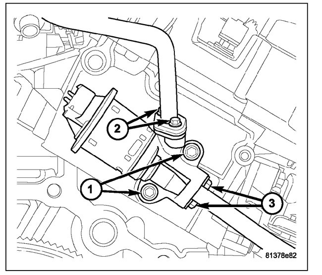

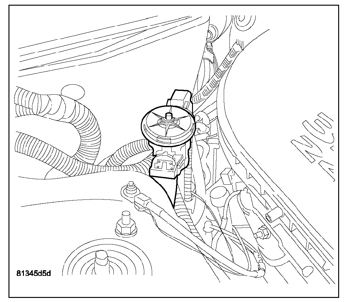

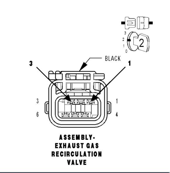

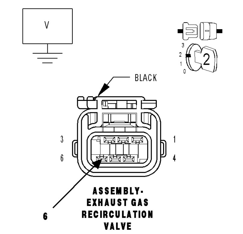

3. (Z904) EGR SOLENOID GROUND CIRCUIT OPEN
Disconnect the PCM harness connectors.
Using a 12-volt test light connected to the 12-volts, probe the (Z904) EGR Solenoid ground circuit in the EGR Solenoid harness connector.
Q: Does the test light illuminate brightly?
YES: Go To 4
NO: Repair the open in the (Z904) EGR Solenoid ground circuit. Perform the POWERTRAIN VERIFICATION TEST. See: A L L Diagnostic Trouble Codes ( DTC ) > Verification Tests > Powertrain Verification Test

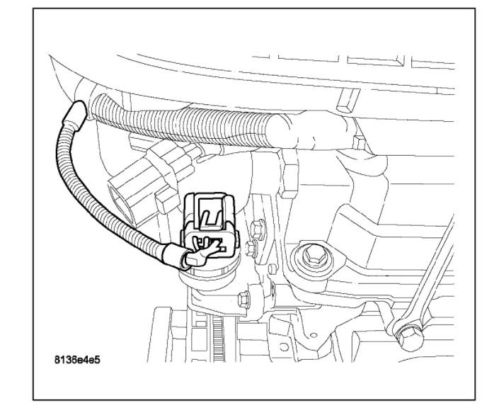

Picture 3

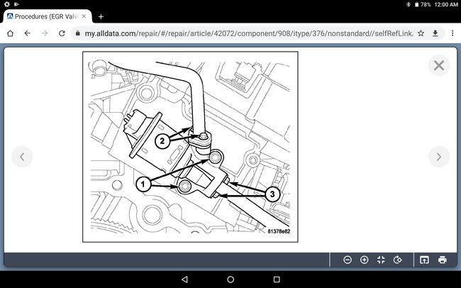

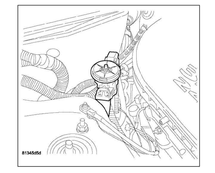

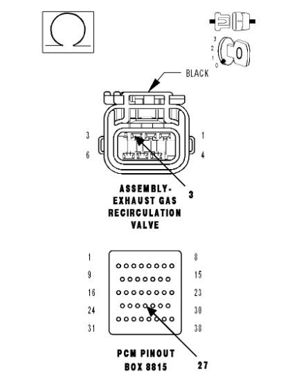

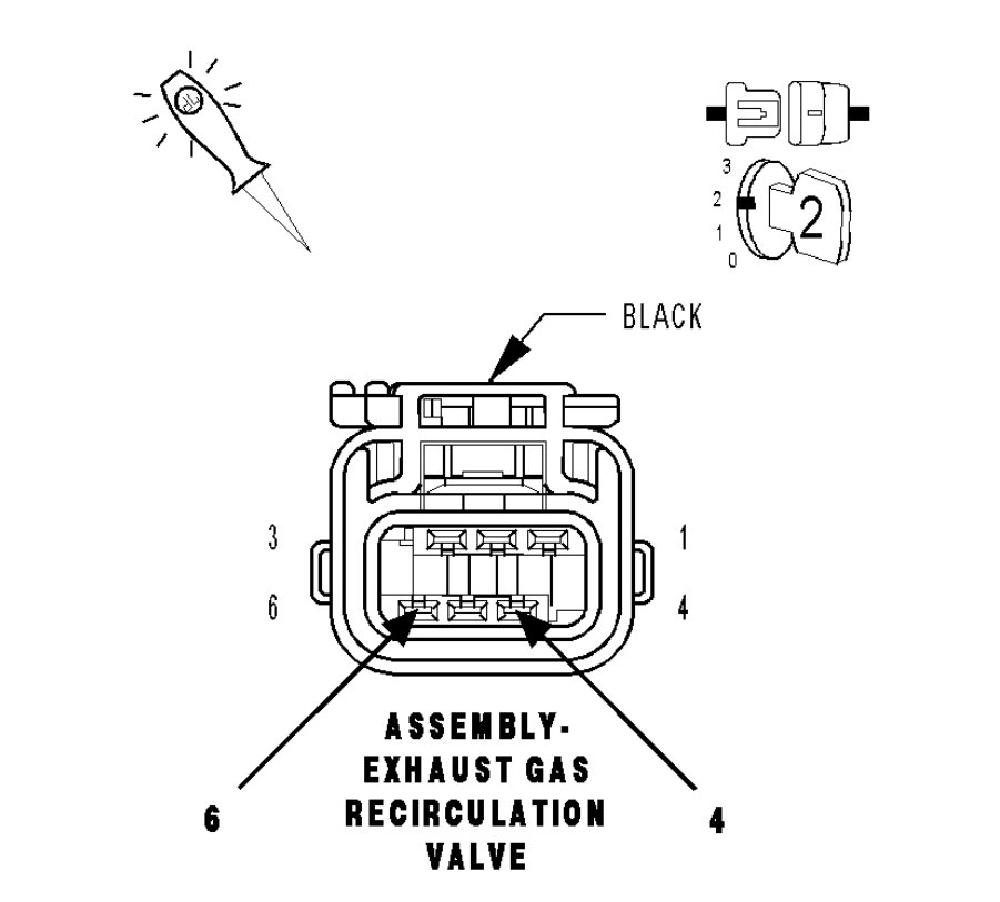

4. (K35) EGR SOLENOID CONTROL CIRCUIT SHORTED TO BATTERY VOLTAGE
Measure the voltage on the (K35) EGR Solenoid Control circuit in the EGR Solenoid connector.
Q: Is the voltage above 1.0 volt?
YES: Repair the short to battery voltage in the (K35) EGR Solenoid Control circuit. Perform the POWERTRAIN VERIFICATION TEST. See: A L L Diagnostic Trouble Codes ( DTC ) > Verification Tests > Powertrain Verification Test
NO: Go To 5

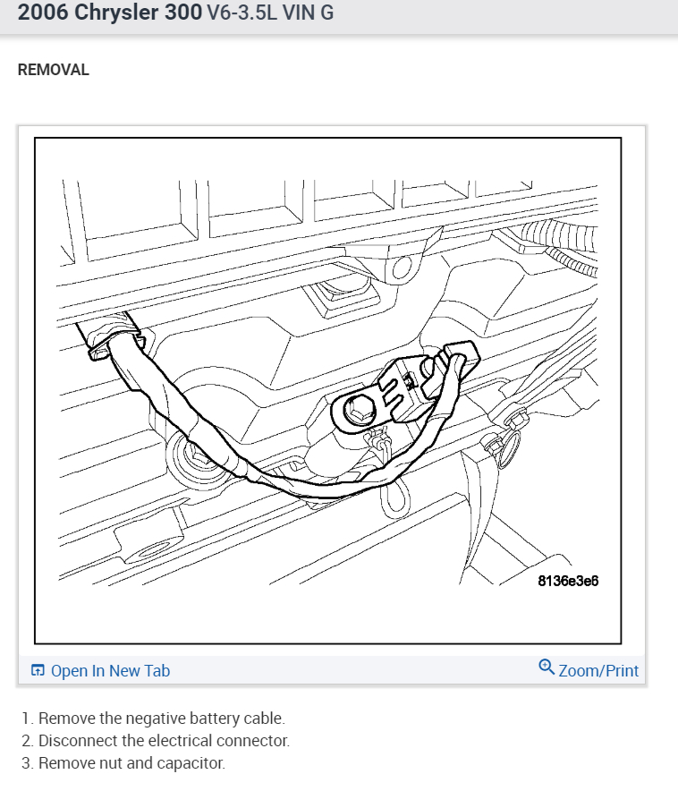

Picture 4

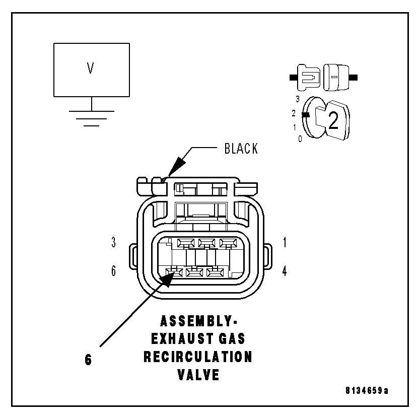

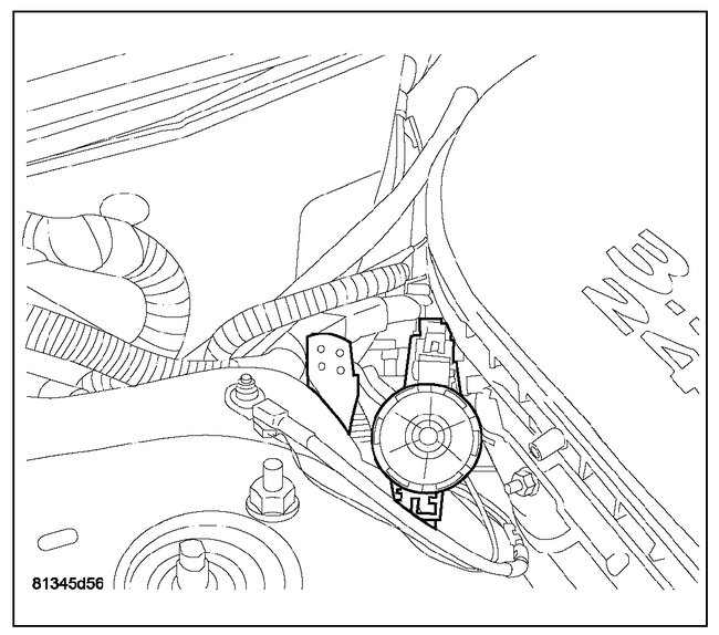

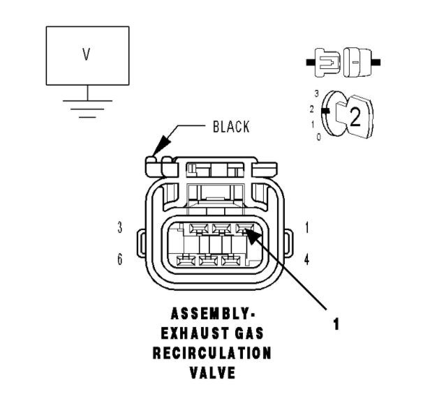

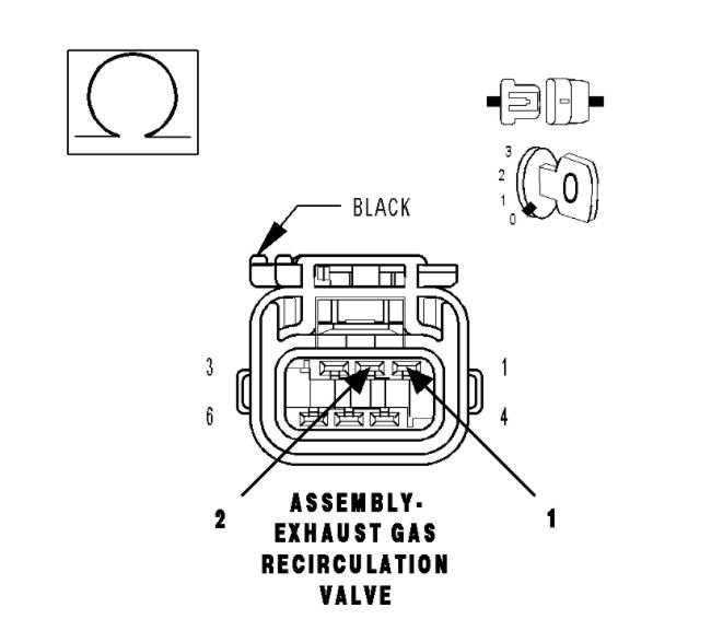

6. (K35) EGR SOLENOID CONTROL CIRCUIT SHORTED TO THE (K900) SENSOR GROUND CIRCUIT
Measure the resistance between the (K35) EGR Solenoid Control circuit and the (K900) Sensor ground circuit in the EGR Solenoid connector.
Q: Is the resistance below 5.0 ohms?
YES: Repair the short between the (K900) Sensor ground circuit and the (K35) EGR Solenoid Control circuit. Perform the POWERTRAIN VERIFICATION TEST. See: A L L Diagnostic Trouble Codes ( DTC ) > Verification Tests > Powertrain Verification Test
NO: Go To 7

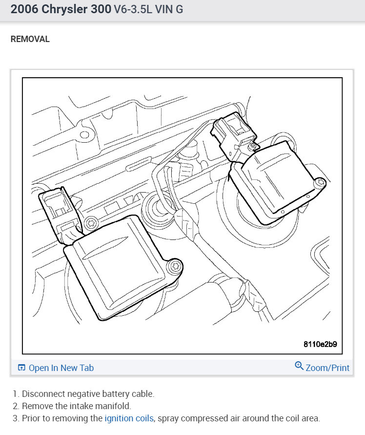

Picture 5

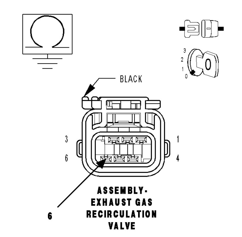

7. (K35) EGR SOLENOID CONTROL CIRCUIT OPEN
CAUTION: Do not probe the PCM harness connectors. Probing the PCM harness connectors will damage the PCM terminals resulting in poor terminal to pin connection. Install Miller Special Tool #8815 to perform diagnosis.
Measure the resistance of the (K35) EGR Solenoid Control circuit from the EGR Solenoid harness connector to the appropriate terminal of special tool #8815.
YES: Go To 8
NO: Repair the open in the (K35) EGR Solenoid Control circuit. Perform the POWERTRAIN VERIFICATION TEST. See: A L L Diagnostic Trouble Codes ( DTC ) > Verification Tests > Powertrain Verification Test

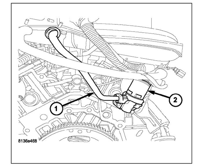

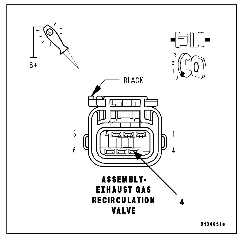

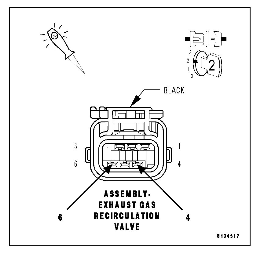

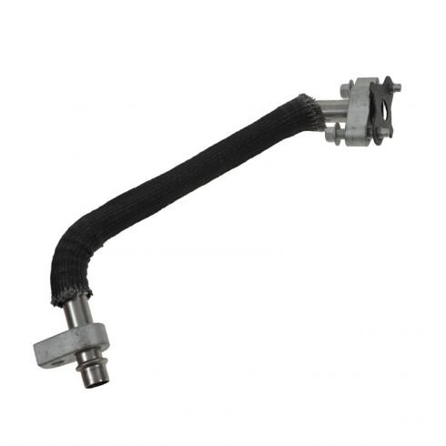

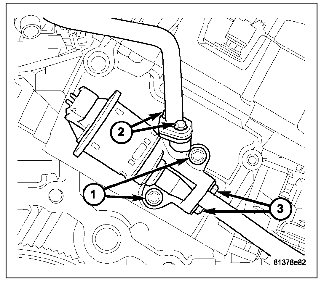

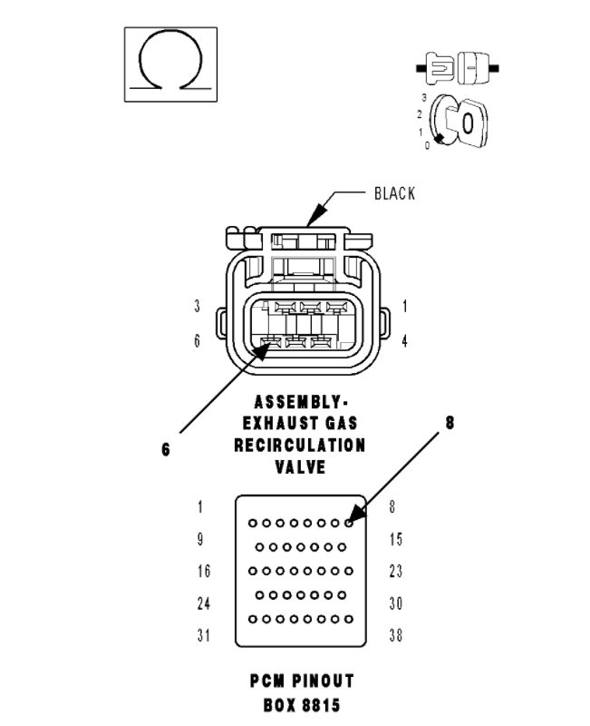

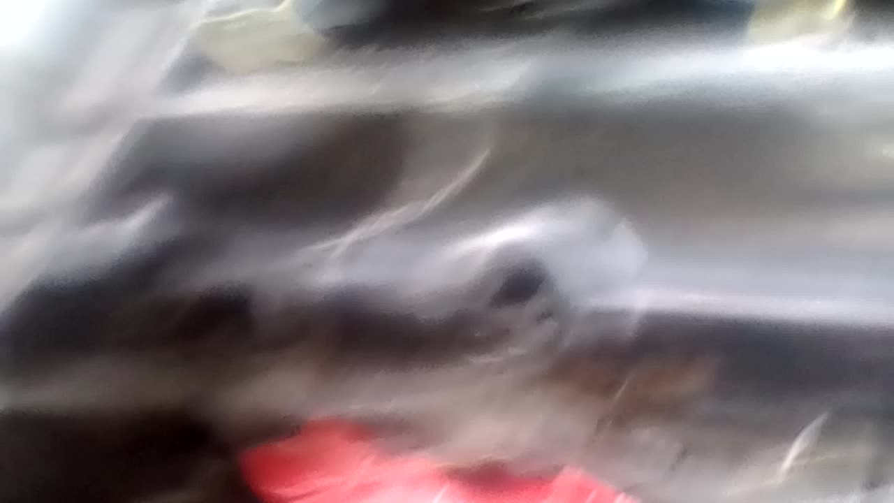

The pictures below show the connection on the EGR. They indicate what pins in the connector should have specific results based on different tests. If you don't feel comfortable doing this, I suggest the following:
Disconnect the EGR connector and inspect for damage to the wiring, connector, corrosion. Anything that looks like it needs fixed.
If it looks good, then I suggest removing the EGR and inspect it for excessive carbon build up and the tubes that connect it to the intake manifold for blockages.

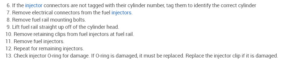

Here are the directions for removal and replacement. The pictures, starting with number 6, correlate with these directions.

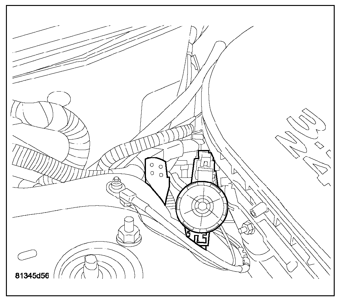

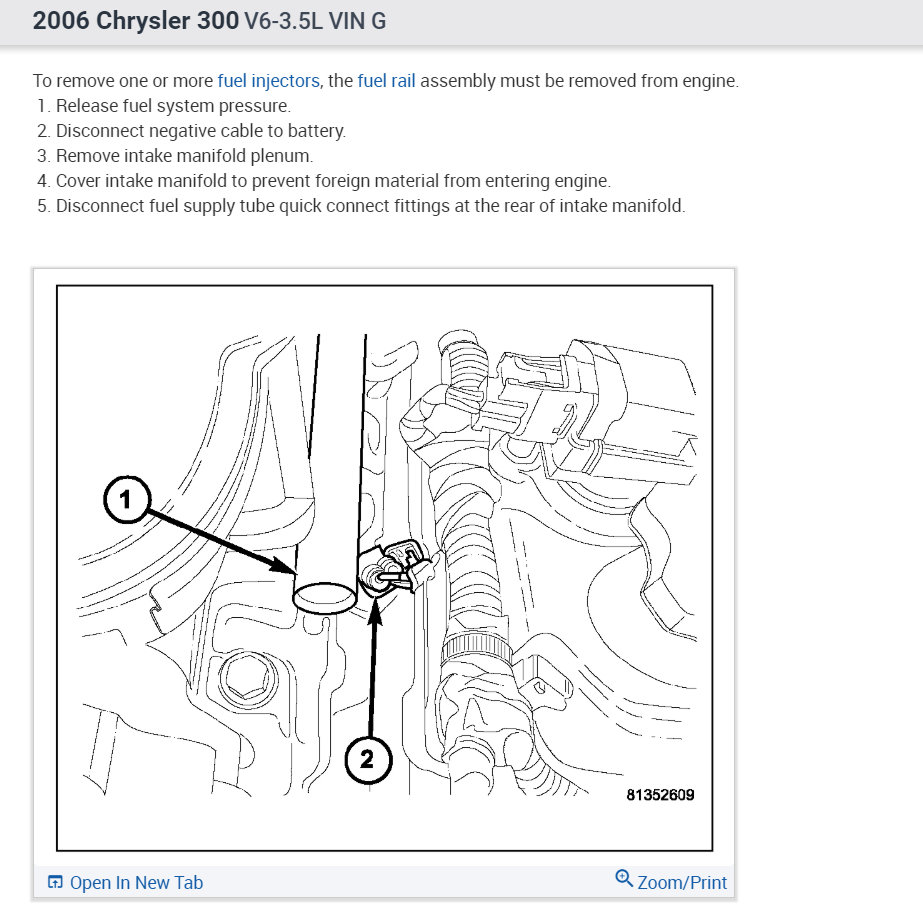

Trying now to narrow down P0202 misfire, and what out of the 5 or so things one that cylinder can be causing it. I have changed the spark plug and the car is "Skipping" or running badly still upon starting(just sitting still). What little I can see the wire plug to the ignition coil looks fine and the heat shrink looks fine. Can tell what's happening deeper in the harness.
So, I swapped out the old ignition coil I had in another cylinder, bc I didn't really think it was bad. And I don't know if I had all the 3 codes I'm showing now that I found after borrowing an OBD2 tester from Auto Zone. I got the P0202 just from the dash. Now I have P2305(Ignition Coil 2 Secondary Circuit-Insufficient Ionization and P0113(Intake Air temp Sensor Circuit High). Maybe the dash only shows 1 at a time.
I swapped the ignition coils back out and still have the P2305. Not sure if I just need to erase that one and see if it comes back or not. Probably try that.
I also have tested the IAT w/multi-meter. So 1st question: W/it on 200K on OHMs setting, I get 11.6 and 11.8 when swapping around the leads btwn the 2 prongs more towards the top of the prongs. First I had one towards the base of 1 of the prongs to help it stay in place(bc I don't have alligator clips) and 1 at top of the other prong on 2 dif. Days(inside the house), they read 8 to 9.5. Are these too high, and does that mean the sensor is bad in some way? It does go down on the reading as it should when some heat is added near.
2. When I was told that the P0202 was general misfire, that's why I changed the sparky and swapped the coil, but if it is really a Fuel injector problem for real as the specific code says(circuit open), do you think Seaform cleaner is could be tried to see if it helps or don't bother?
And can the 202 be making the 113 show up?

How did the plug look coming out? If it is white with no burn marks I would say fuel injector but it sounds more like a coil which have problems. Once one goes bad I would do them all if you are going to keep the car. There is an ignition capacitor please make sure that is connected. Here are diagrams below to help with the repair. Codes wont come up unless you drive it for a while. Let me know.
Feb 12, 2021 at 2:39 AM (Merged)
TRA
  • 41 POSTS

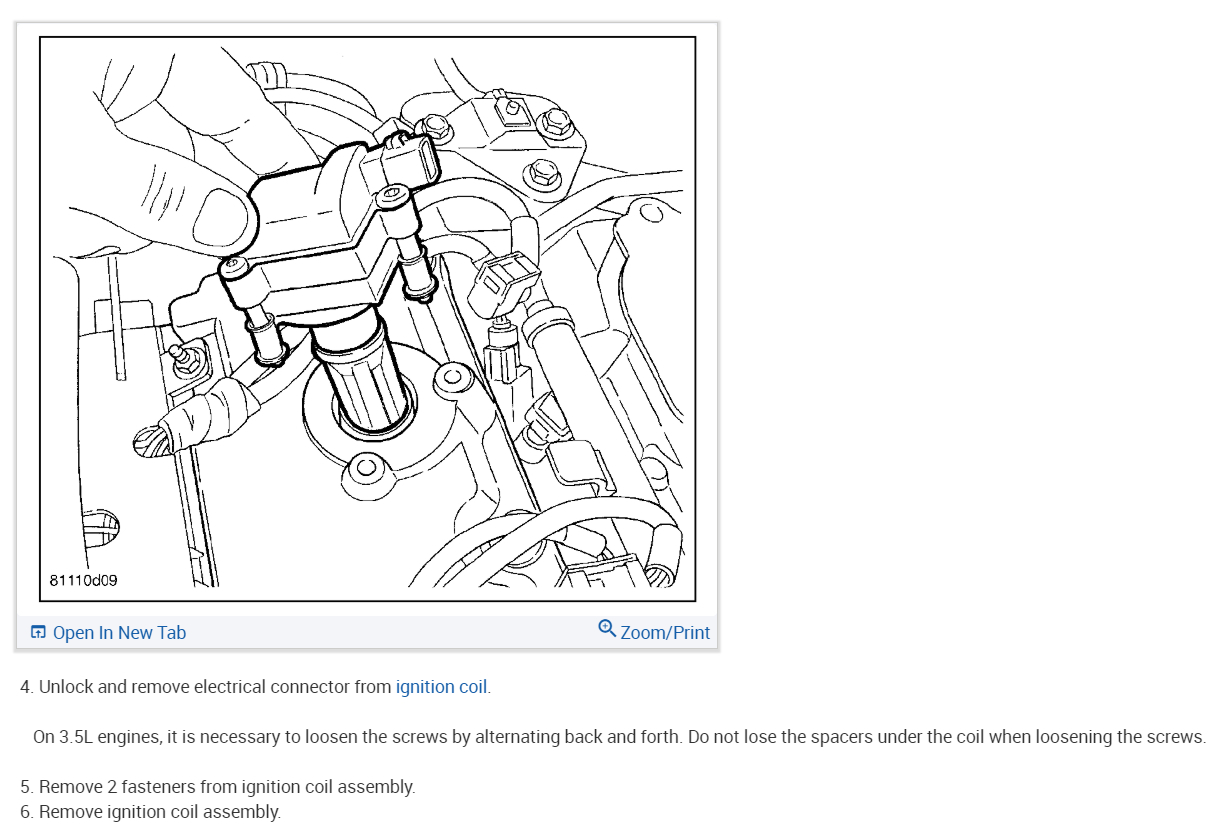

No not white at all, black. If you can find pictures of where that ignition capacitor is on a 2.7L engine, that would be great. That's the one I have not 3.5L.
Thanks very much. Very helpful.
  • 55,399 POSTS
It is the same as the third image in the post above. Here it is for your engine below.

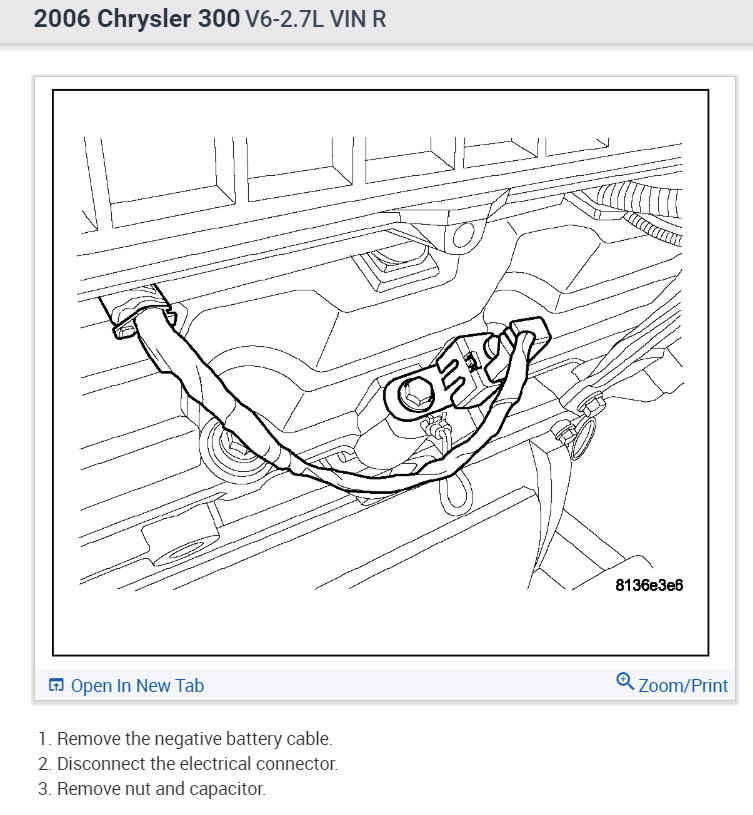

Had the EGR valve changed on my car listed above Limited and now it runs rough. Both gaskets were changed as well as the rubber seal on the EGR tube. Don't hear any air noise coming from the tube. Can't figure out what's going on with it now. Thank you.
TRA
  • 41 POSTS

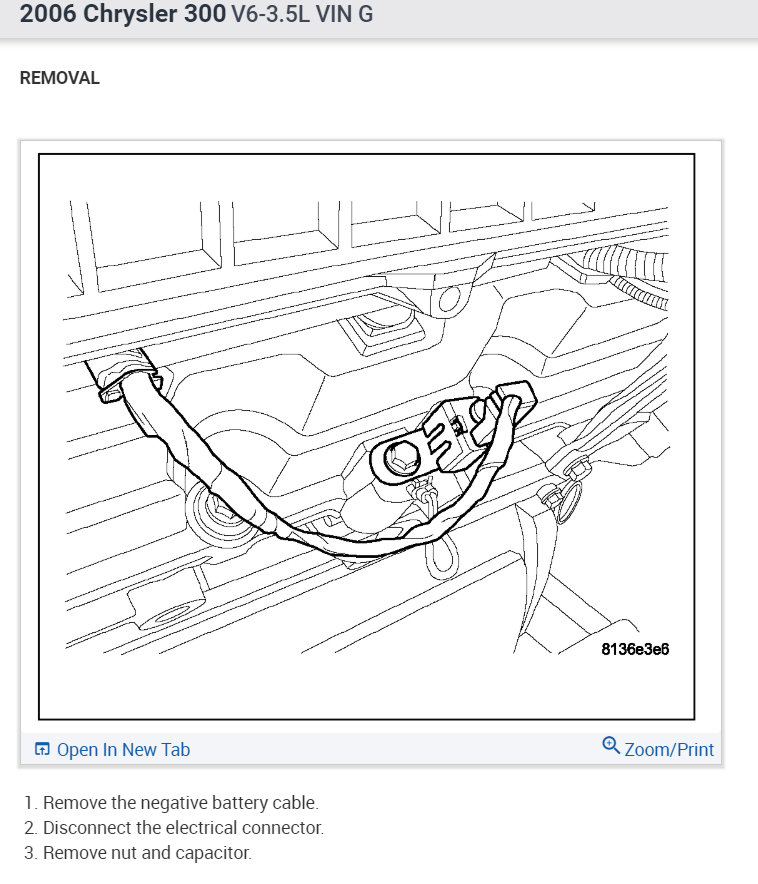

Brand new ignition coil and still doing same. More detail about what it is doing: When I start the car, it immediately acts like I'm holding down the pedal. But I don't touch the pedal to start it at all. Then while letting it run, the RPM needle goes up and down, up and down; it acts like the petal is being pumped. The again pedal is not being touched at all. Sounds/feels like it will cut off, and I hear some little bang or knock.
Could this have anything to do with the EGR tube being damaged or off somewhere at the opposite end from the intake manifold? It's plugged into the manifold fine. I'm not sure if the guys helping me take that off wrenched something there, because when I went to put it back on the tube was way down and pushed back a good bit. I didn't realize they had done that turn around on the manifold to get it off.
The person putting it back on owns a shop and seemed not to think anything was wrong with pulling it back up with slight steady pressure. Can't see the other end from the top.
What do think?

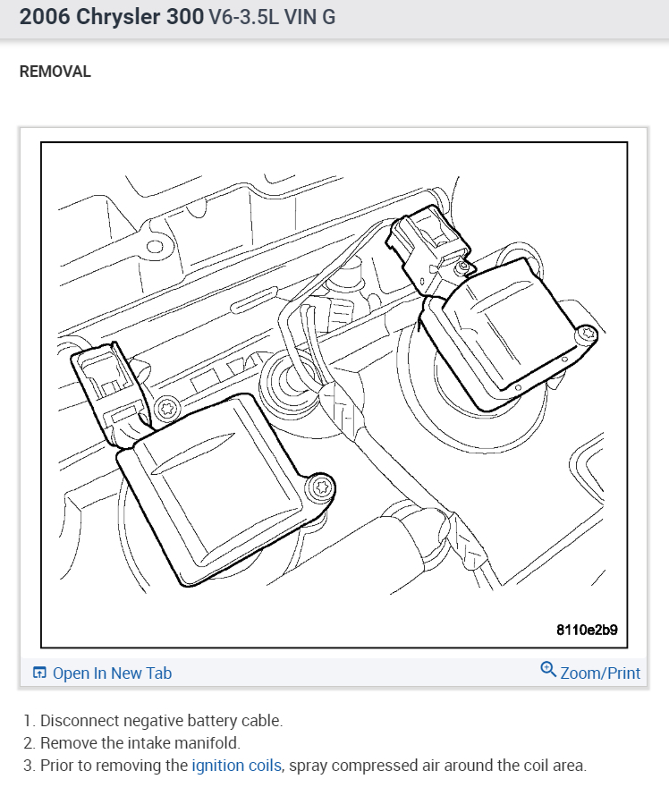

The capacitor is attached fine. Below is a picture I found from Rock Auto for how one on my car looks. Found it after the #6 coil on that row. Couldn't tell from those pictures above where that was. Didn't see anything on my car exactly like that. So, I never pulled on that too much so hopefully it's okay. Does anything become disconnected at the other end of those too easily? Wire looks okay. At the immediate end of the wires by the plug may have lost a cm of some insulation or heat shrink, but doesn't look frayed.

Perform POWERTRAIN VERIFICATION TEST. See: A L L Diagnostic Trouble Codes ( DTC ) > Verification Tests > Powertrain Verification Test
No >> Go To 3
3. (K34) EGR POSITION SENSOR SIGNAL CIRCUIT SHORTED TO BATTERY VOLTAGE
Measure the voltage on the (K34) EGR Sensor Signal circuit in the EGR Solenoid harness connector.
Is the voltage above 0 volts?
Yes >> Repair the short to battery voltage in the (K34) EGR Position Sensor Signal circuit.
No >> Go To 4
4. EGR SOLENOID ASSEMBLY
Connect the PCM harness connectors.
Connect a jumper wire between the (K34) EGR Position Sensor Signal circuit and the (K900) Sensor ground circuit.
With the scan tool, monitor the EGR Position Sensor voltage. Ignition on, engine not running.
Is the voltage below 0.5 of a volt?
Yes >> Replace the EGR Solenoid Assembly.
No >> Go To 5
NOTE: Remove the jumper wire before continuing.
5. (K34) EGR POSITION SENSOR SIGNAL CIRCUIT OPEN
Measure the resistance of the (K34) EGR Position Sensor Signal circuit from the EGR Solenoid harness connector to the appropriate terminal of special tool #8815.
Yes >> Go To 6
No >> Repair the open in the (K34) EGR Position Sensor Signal circuit.
6. (K900) SENSOR GROUND CIRCUIT OPEN
Measure the resistance of the (K900) Sensor ground circuit from the EGR Solenoid harness connector to the appropriate terminal of special tool #8815.
Is the resistance below 30 ohms?
Yes >> Go To 7
No >> Repair the open in the (K900) Sensor ground circuit.
7. PCM
NOTE: Before continuing, check the PCM harness connector terminals for corrosion, damage, or terminal push out. Repair as necessary.
Using the schematics as a guide, inspect the wire harness and connectors. Pay particular attention to all Power and Ground circuits.
Were there any problems found?
Yes >> Repair as necessary
No >> Replace and program the Powertrain Control Module per Service Information.
8. EGR POSITION SENSOR SWEEP
NOTE: The engine will run rough and possibly stall in the following test. Feather the accelerator pedal to keep the engine from stalling.
Start the engine.
With the scan tool, enter System Test and then EGR System Test. Push the 4=VARIABLE function.
Monitor the EGR voltage while slowly pushing the up arrow.
Is the voltage change smooth?
Yes >> Refer to the INTERMITTENT CONDITION Diagnostic Procedure.
No >> Replace the EGR Solenoid Assembly.

Thanks for the video. The engine sounds okay, it looks like you may have an fuel injector out causing the problem. Here is a guide to help test it to confirm with diagrams below to show you how to remove the injector:
https://www.2carpros.com/articles/how-to-test-a-fuel-injector
and
https://www.2carpros.com/articles/how-to-replace-a-fuel-injector
Check out the diagrams (below). Please let us know what you find.

Not really because exhaust will come out of any open ports. If you would like to test the EGR here is video:
https://youtu.be/DqUCbbKdWf4
TRA
  • 41 POSTS
Are you familiar w/how the EGR tube looks on a 2006 300? Do you know if the "knob" end on that can be taken off without cutting it off and welding on to another tube? This Mopar4 All dealers sent me one that does not fit my car. Even though their catalog tells them it does. https://encrypted-tbn1.gstatic.com/shopping?q=tbn:ANd9GcR_R7oolNB-cDv2qzDIPCK3y-C5M2S_sHp9D2woQGJZBbkuCpD6mxmwM0weTh4ZAgOMjz4vhEg&usqp=CAc- Or https://encrypted-tbn3.gstatic.com/shopping?q=tbn:ANd9GcSpZVyFzzbGxOsQfb1LKNkiV-LlVCkPUBr5EGVQFVzDG5Je3KXvAHfWnqk7ye3kfu5BcRBR1TIp&usqp=CAc
Mine looks like ones in the links above.
They sent me what looks on the end like: https://encrypted-tbn3.gstatic.com/shopping?q=tbn:ANd9GcRVuq28PkvTNNGvELfqqRQ7QYzX7Bw_tK4TAJ9DkBt2vlOXzYEiYgrNNeW1UCBBpicXiWSzVRGp&usqp=CAc

i have a 2005 chrysler 300 2.7L that has had the engine code p0404 for a while. had it checked out by mopar ppl and said i need spark plugs and egr valve is not getting a signal to open. I replaced the egr valve which was a pain but got it in correctly and put new plugs in. car runs great now and is not shaking the whole car now. but the engine code p0403 is now on which is egr malfunction code. idk do i need to change the egr purge solenoid or somethin im just not sure.
  • 55,399 POSTS
You should not have to remove anything to weld it should be a direct fit. what seems to be the matter?

I attached a flow chart for you to view to determine the failure. I also posted connectors for you for testing.
For a complete wiring diagram refer to: Electrical Diagrams
When Monitored
Engine running. Battery voltage greater than 10 volts.
Set Condition
The EGR solenoid control circuit is not in the expected state when requested to operate by the PCM. One Trip Fault.
Possible Causes
- (Z904) EGR SOLENOID GROUND CIRCUIT OPEN
- (K35) EGR SOLENOID CONTROL CIRCUIT SHORTED TO BATTERY VOLTAGE
- (K35) EGR SOLENOID CONTROL CIRCUIT SHORTED TO GROUND
- (K35) EGR SOLENOID CONTROL CIRCUIT SHORTED TO THE (K900) SENSOR GROUND CIRCUIT
- (K35) EGR SOLENOID CONTROL CIRCUIT OPEN
- EGR SOLENOID ASSEMBLY
- PCM
Always perform the Pre-Diagnostic Troubleshooting procedure before proceeding.
Diagnostic Test
1. ACTIVE DTC
Ignition on, engine not running. With a scan tool, read DTCs.
Yes >> Go To 2
No >> Refer to the INTERMITTENT CONDITION Diagnostic Procedure.
Disconnect the EGR Solenoid harness connector.
No >> Go To 3
3. (Z9048) EGR SOLENOID GROUND CIRCUIT OPEN
Yes >> Go To 4
No >> Repair the open in the (Z904) EGR Solenoid ground circuit.
Yes >> Repair the short to battery voltage in the (K35) EGR Solenoid Control circuit.
No >> Go To 5
5. (K35) EGR SOLENOID CONTROL CIRCUIT SHORTED TO GROUND
Measure the resistance between ground and the (K35) EGR Solenoid Control circuit in the EGR Solenoid harness connector.
Is the resistance below 100 ohms?
Yes >> Repair the short to ground in the (K35) EGR Solenoid Control circuit.
No >> Go To 6
Yes >> Repair the short between the (K900) Sensor ground circuit and the (K35) EGR Solenoid Control circuit.
No >> Go To 7
Yes >> Go To 8
No >> Repair the open in the (K35) EGR Solenoid Control circuit.
8. PCM

Yep, I agree it should be a direct fit. This Mopar dealer sent me a part that is not correct for my car as their catalog told them, and as they advertised. My old part may be a quicker weld if I find someone. Trying to avoid going on a junk yard again; and definitely not paying around $100.00 for it.
  • 55,399 POSTS
Sometime the part can look a little different but do the same thing, do the ends look like they will work?
TRA
  • 41 POSTS
Nope not at all. One end does. Second end that goes into the manifold doesn't.
  • 55,399 POSTS
Wrong part then, you should not need to cut and weld, I would try a new parts guy.
