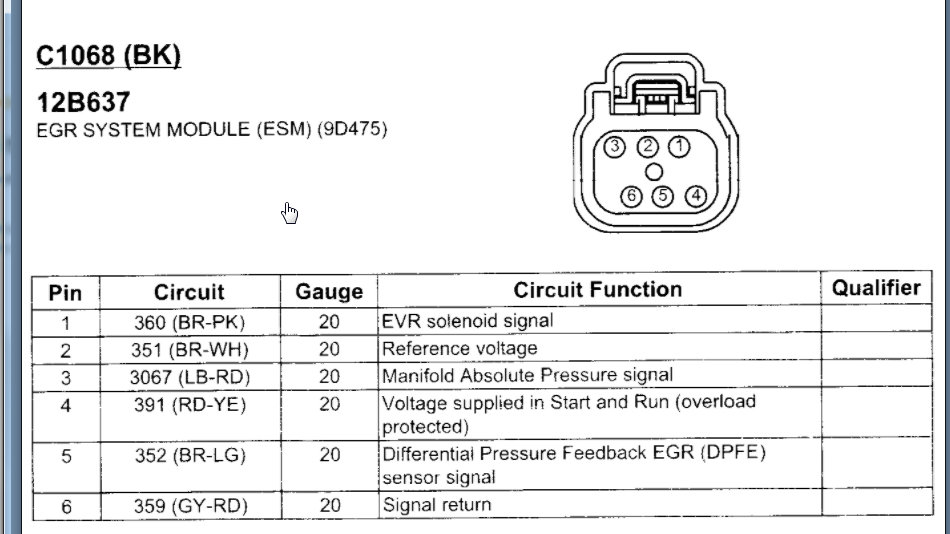

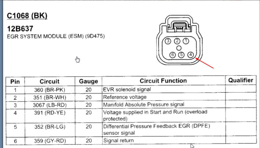

Okay, i have some of the answers you asked for.. There are 2 codes P0402 and P0403... I also did a test with a multimeter... Here are the readings starting from the top left wire first 1, 9.4. Second 1, 4.9. Third 1, 4.4. Bottom row left first 1, 9.4. Second 1, 2.2. Last wire no reading! I did not see any letters as to A,B,C,D,E to follow any sequence...
Oct 15, 2020 at 12:48 AM

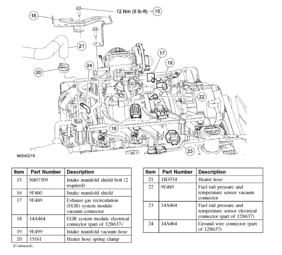

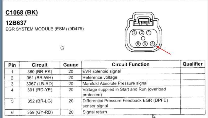

Okay. That helps. Can you confirm that your vehicle has the EGR module and not just a valve? The fact that you have 6 wires I am sure you do but I need you to look at the connector and tell me what these wires have for voltage. I understand you said top left but I am not sure if you had it plugged in or which way you were looking at it so can we match up the wires and tell me what pin 1-6 had according to this connector view?
Once we get this, I will run through the testing and let you know if we have another issue or provide more guidance. Plus I will know which testing to send over once we get this info.
Oct 15, 2020 at 12:44 PM
BADDOG03
  • 10 POSTS

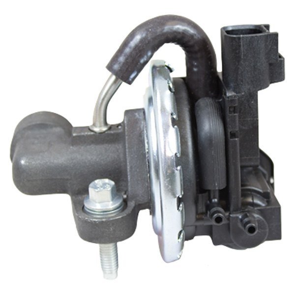

Yes, i believe that it is a Module. I saw the attachments you sent me. The connector that is shown is the same as mine. I just didn't have my numbers configured as the picture . So i am sending you the number i got with multimeter the way that your attachment shows.. #3, 9.4 #2, 4.9 #1, 4.4 #6, 9.4 #5, 2.2 #4, No reading... When i tested it the car was in the KOEO Mode.. I did not test it with the car running.. I want to let you know that the car does not run rough when running...It Purrs like a kitten. I also want to say i do have a problem with comprehension when read. But i am mechanically inclined. I am more of a hands on type person. So please bare with me. I how what i have sent you is helpful...
Oct 15, 2020 at 11:25 PM

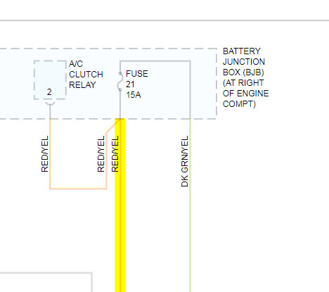

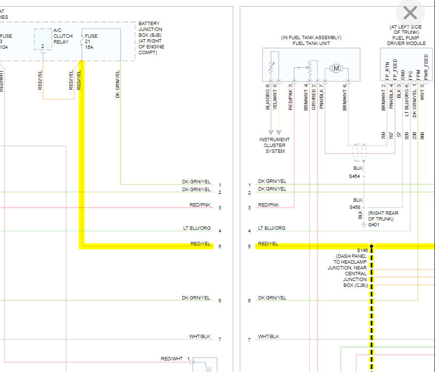

Okay. We have some digging to do with this because some of those don't sounds correct namely the 9.4 volts. However, pin 4 cannot be 0 so we need to start there. Fuse 21 in the battery junction box is what we need to check and go from there. Let me know if this fuse is okay and if it is we are going to need to jump 12 volts to this pin and retest the operation.
Oct 16, 2020 at 11:39 AM

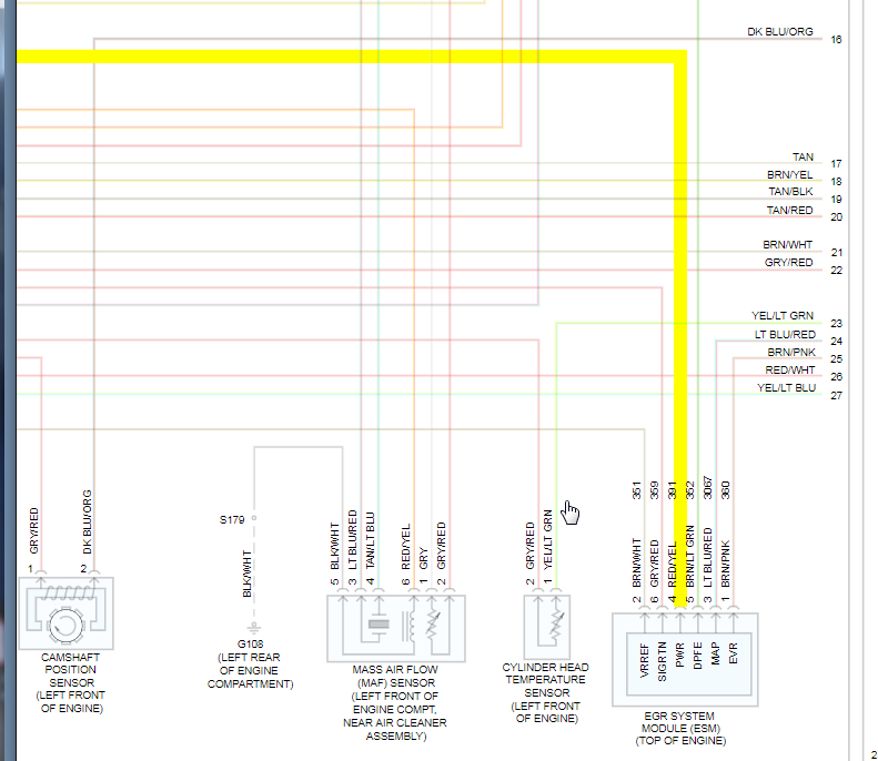

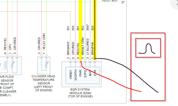

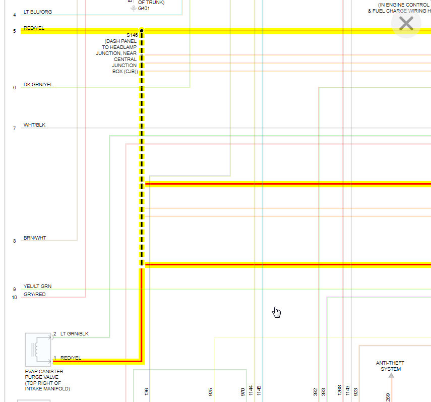

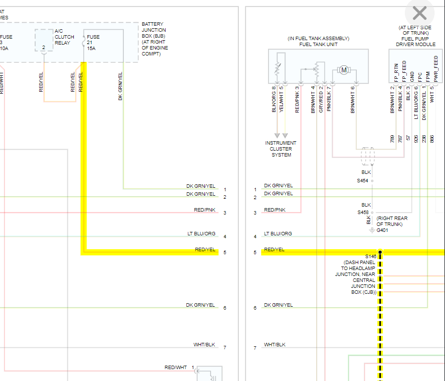

Just to clarify, you jumped 12 volts to the EGR module or you put 12 volts to the connector with it unplugged? That circuit is the voltage supply circuit that is a 12 volt supply from fuse 21 in the battery junction box.
If you put 12 volts to the EGR module and it almost burned up the wire then that may be the issue. You need 12 volts on that wire so if your jumper almost melted then that wire from the fuse may have melted as well. A short to ground will cause the wire to melt.

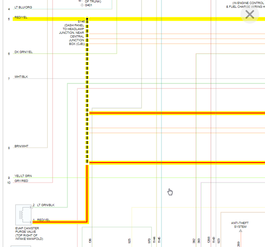

As you can see in the wiring diagram that fuse splices off and feeds other things as well. So we need to check for a short to ground on that wire and the EGR. You do that by unhooking the connector and put your meter on continuity or ohms and then put one lead on that pin and the other on the negative battery terminal. It should be an open circuit or the meter should say OL.
Oct 19, 2020 at 11:16 AM

Just to Clarify. I spliced into #4 wire on the Connector with a wire Then i plugged the Connector into the Modulator, Then I hooked the wire to the + side of the battery.. That is when the wire got red hot so i Pulled it off.. I see from your Schematic that you are showing the wire color to be Red/ Yellow and it is showing the wire to be # 5...Just to Clarify. The wire that I am Not getting any reading is #4 on the connector in my car and the Color of That wire is Grey/ Red... According to the configuration of the connector that you sent me in a previous attachment... I also sent you in my last message the colors of the wires in my car that are in the configuration of the connector of your attachment.. I am not that good a following Schematics, But I looked at the 3rd page of your attachment and the Colors with the Numbers beside them DO NOT Correspond with the Color or Numbers with the Ones that i sent You That I keep referring back to, that are in the Configuration of the Connector of the picture in the attachment you sent me... We need for both of us to be on the same page here !! The Colors and Number on the 3rd page of your Schematic attachment are #2 Brn/Wht , #6 Gry/Red , #4Red/Yel ,#5 Brn/ Lt Grn ,#3 LtBlu/Red , #1Brn/Pink... This might be the reason the wire you asked me to attach to 12 volts got so HOT. Just saying.. as i said we need to be on the same page and make sure that we are not doing more harm than good.. I had also looked at a few YouTube videos and they only talked about and showed only checking 5 wires and talked about A B C D & E .. There wasn't anything about "D" .... I am not saying that the letters Coincide with #s being 1,2 ,3 .4. 5 with the connector or anything else. But when we first started this conversation about my problem i stated the numbers being a as such. I look forward to you reply and resolving the problem because my Emissions is coming up soon and the Colder weather is starting to settle in. I don't have a garage to work in..
Oct 19, 2020 at 10:47 PM

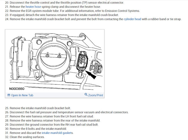

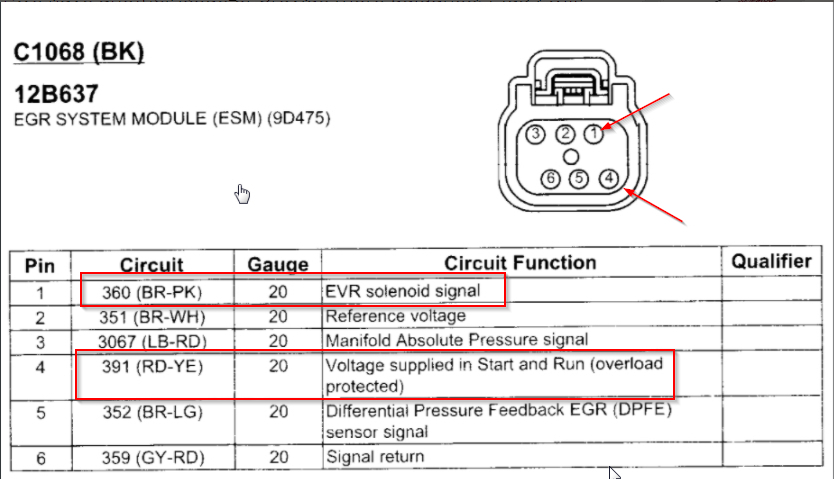

We need to make sure we are in the correct cavity of the connector. There is no question that there needs to be 12 volts on terminal 4 as it is labeled as the power wire. When you are looking at the diagram below this is showing the connector disconnected. So you are looking at the inside of the connector and then number 4 should on the lower right corner. If you are looking at this from the back side of the connector, you would actually be looking at number 6 in the lower right corner which would be a grey/red wire. I think you jumped 12 volts to the signal return which is a 5 volt reference circuit and would make sense why the wire got hot.
Can you get a picture of the connector as you are looking at it? I think that is why we are not on the same page.
Once we straighten that out, we need to find out why we don't have 12 volts on pin 4 so we need to test for a short to power and ground.
Oct 20, 2020 at 1:36 PM
BADDOG03
  • 10 POSTS
Okay, Just to clarify. I have and have been testing the connector connected to the EGR Modulator from the back of the Connector.. Not the inside of the connector.. From the beginning when started talking to you i thought it was odd that the numbers were left to right instead of right to left. So just to clarify all the voltage numbers i gave you were as i gave them from the back of the connector. #1, 4.4 #2, 4.9 #3, 12.0 #4,12.0, #5 2.2, #6, no reading..so in actuality #4 has 12 volts and #6 which a grey/red wire there isn't any reading.. I don't need to take a picture all of my testing are from left to right and all the wire colors are also left to right from the back of the connector.. I guess i misread the attachment of the wire connector that you has sent me. As i said i thought it was odd the numbers were going from right to left... So now that is all straight, we can proceed with the problem of the codes p0402 and p0403 and engine light be on!!
Oct 20, 2020 at 9:15 PM
Okay. Glad we got that figured out. Here is the testing for these codes. It is lengthy but will take us through to the solution.

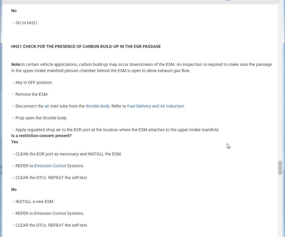

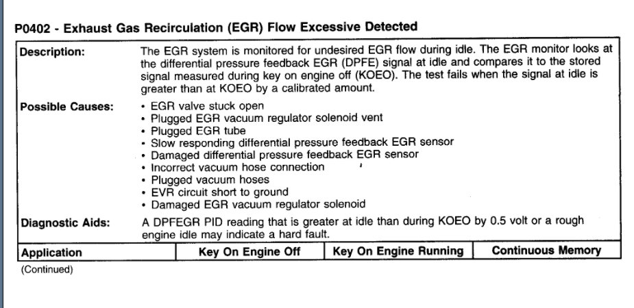

I have seen this problem I would remove the EGR valve and check the ports leading up to and going into the intake manifold I have seen them clog up which causes this issue. An easy way to do this is too remove the EGR and start the car, it should be loud then stall quickly if the passages are open. Here is how to remove the intake to be hot tanked or replaced if this is the problem. Check out the diagrams (below). Please let us know what you find. We are interested to see what it is.

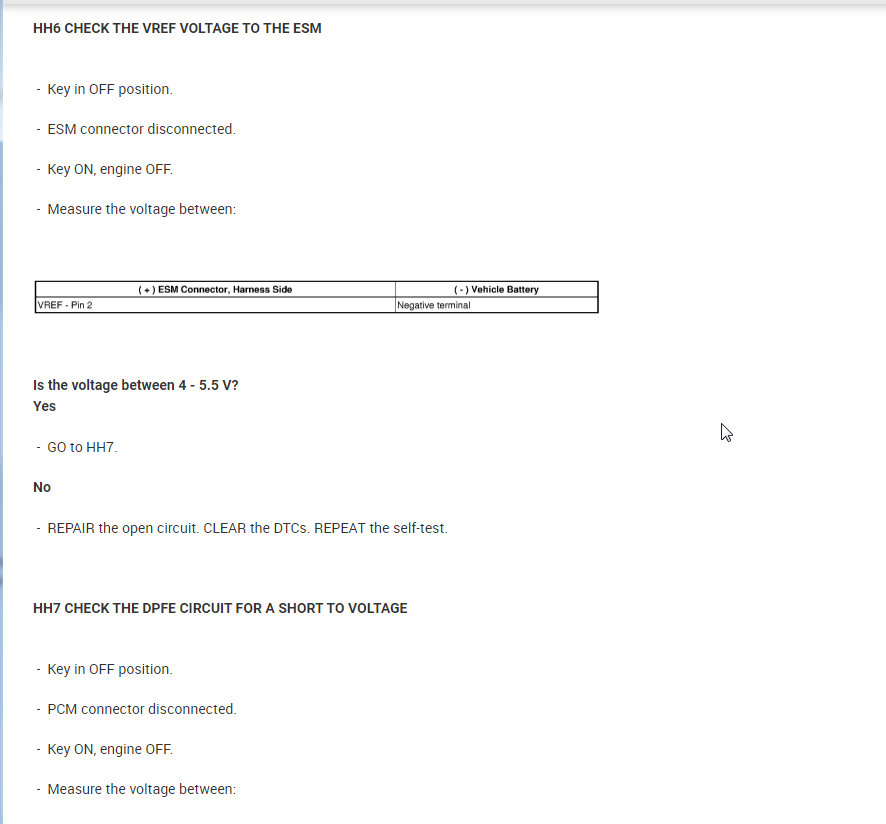

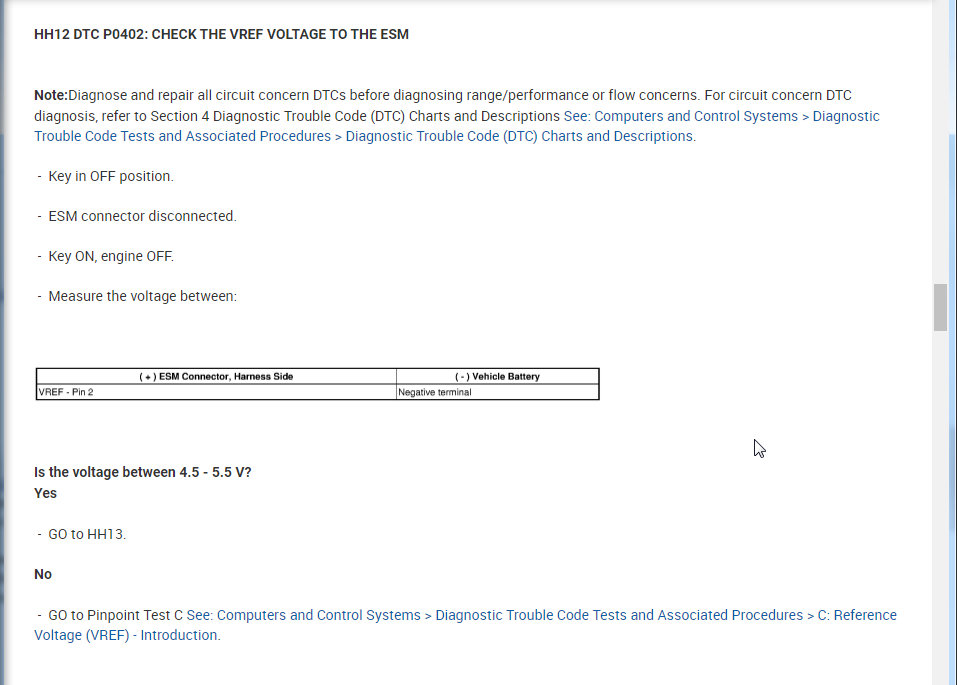

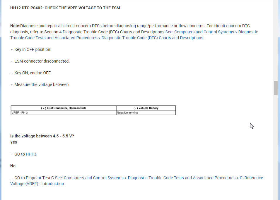

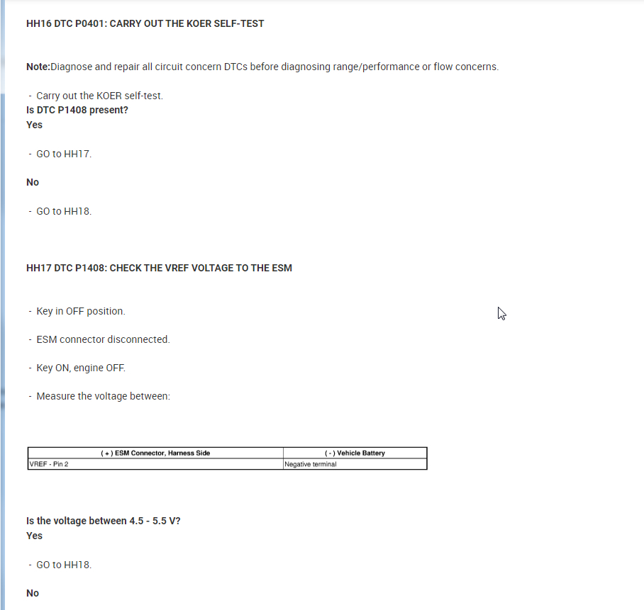

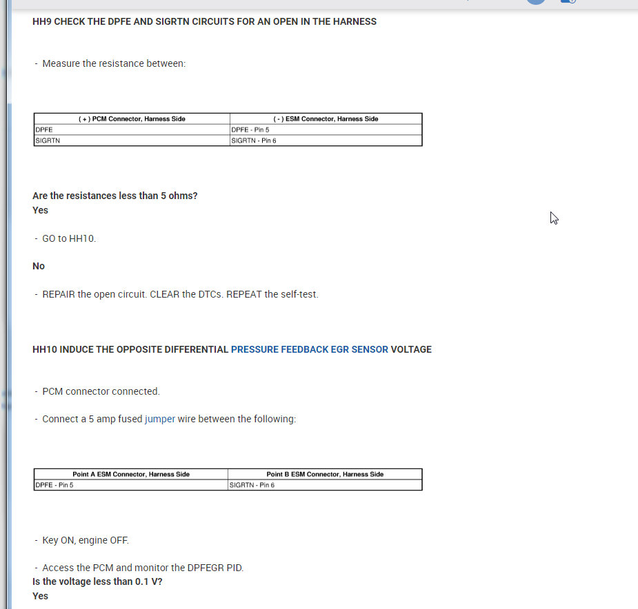

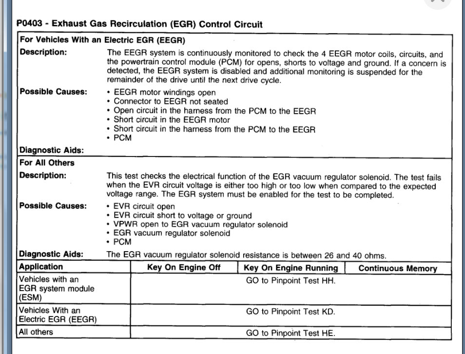

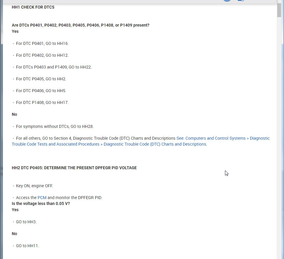

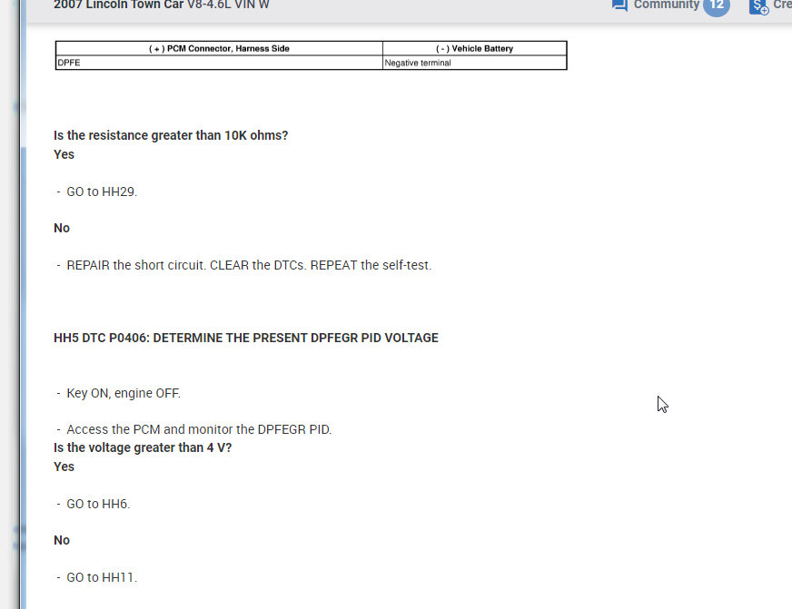

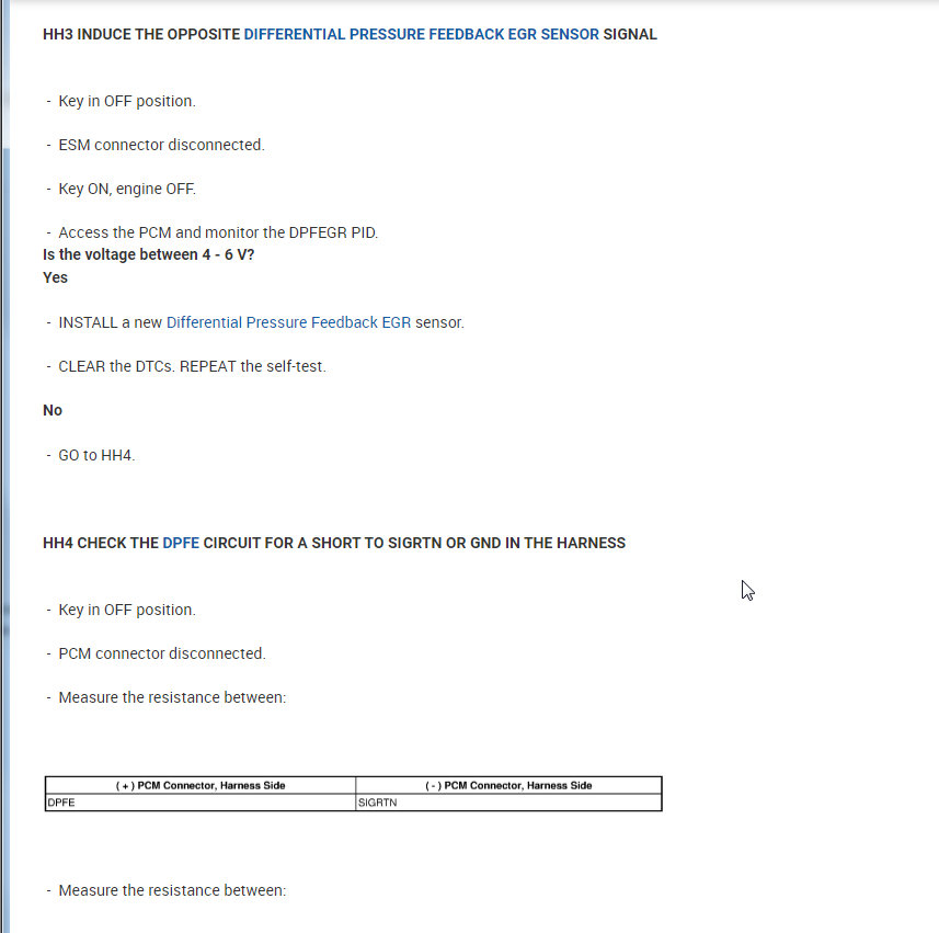

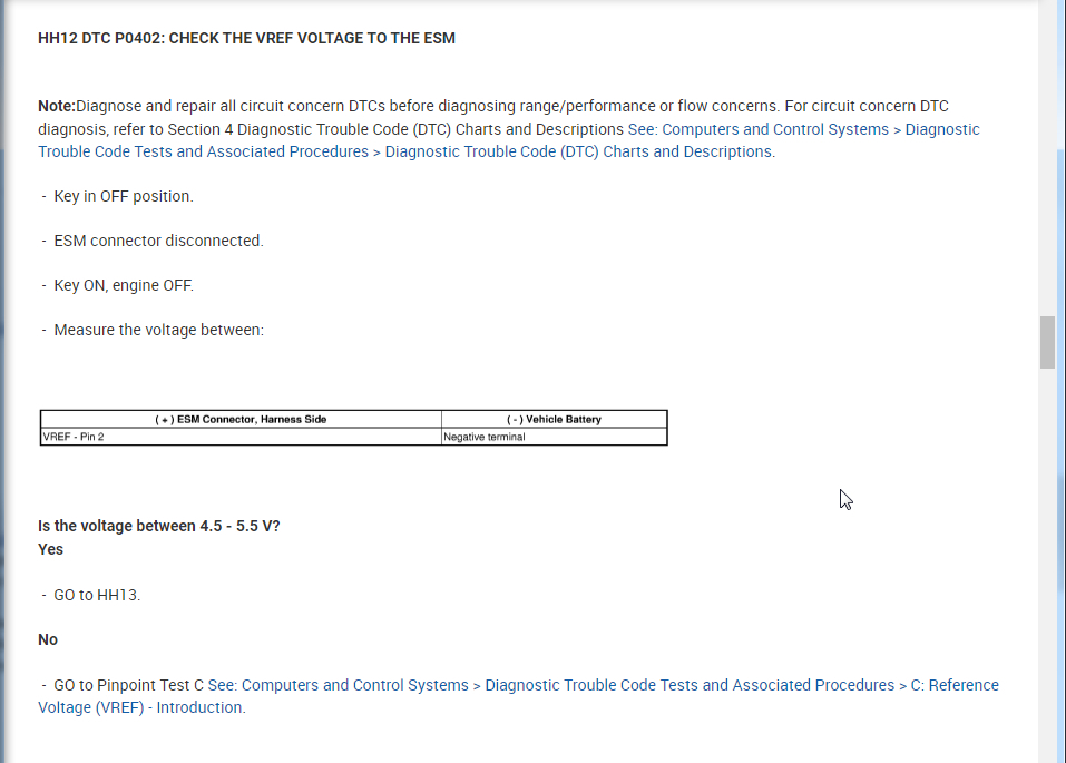

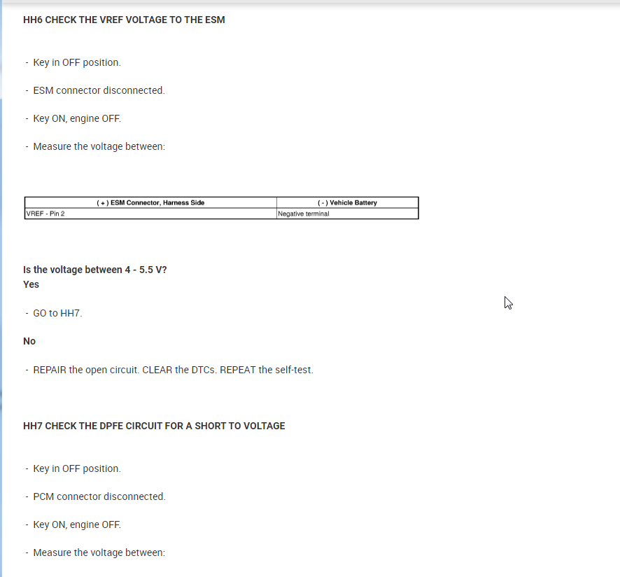

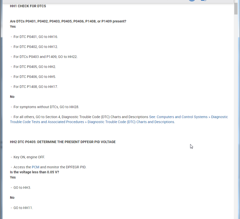

So let's walk through this testing to see if we can figure something out. Your codes are 0402 and 0403. As you can see on step one that sends you to HH12 for the P0402 and HH 22 for P0403.
Let's start with HH12.

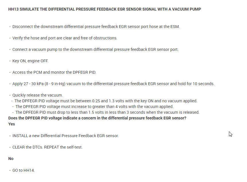

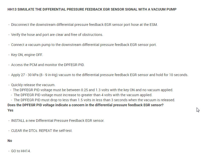

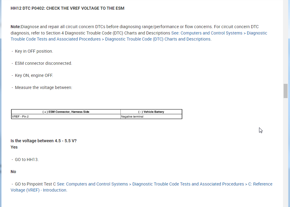

HH12 tells you to disconnect the EGR module (ESM) and check voltage on pin 2. Based on what you said it was 4.9v. It then asks you if it is between 4.5-5.5v. The answer is yes so you go to HH13.

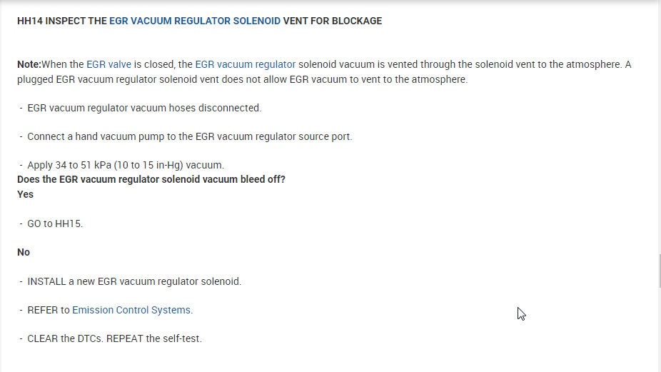

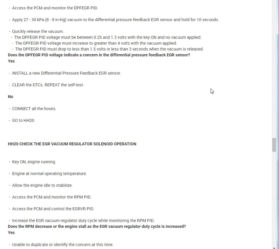

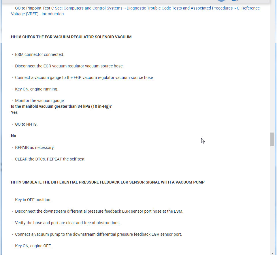

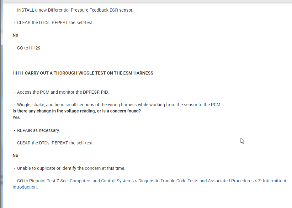

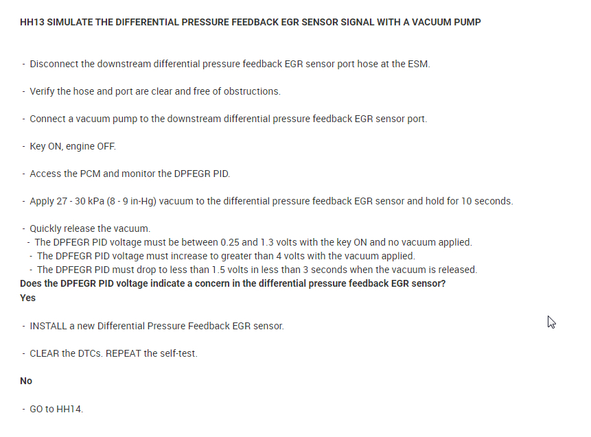

HH13 says to monitor the data in the PCM with a scan tool. If you don't have that then you can monitor the voltage on the DPFE and get the same info. You will need a vacuum gauge/hand pump so that you can pull it into a 8-9 inch of mercury vacuum as it asks. Let's say it passes that and you move to HH14. If it did not then you replace the DPFE.

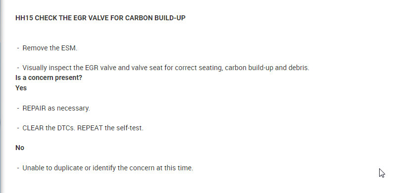

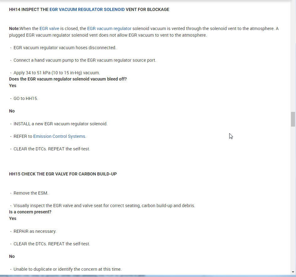

HH14 asks you to check for a blockage in the EGR regulator solenoid. Again, you need the vacuum hand pump again to pull it into a 10-15 in-hg vacuum. If this does not bleed off then you need a new EGR vacuum regulator solenoid. Let's say that passed and you move onto HH15.

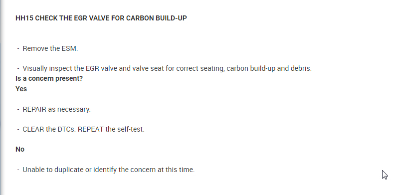

HH15 is asking you to inspect the EGR valve for carbon build up. If you find it, you can clean it or replace it. If there is none then the issue is not currently present.

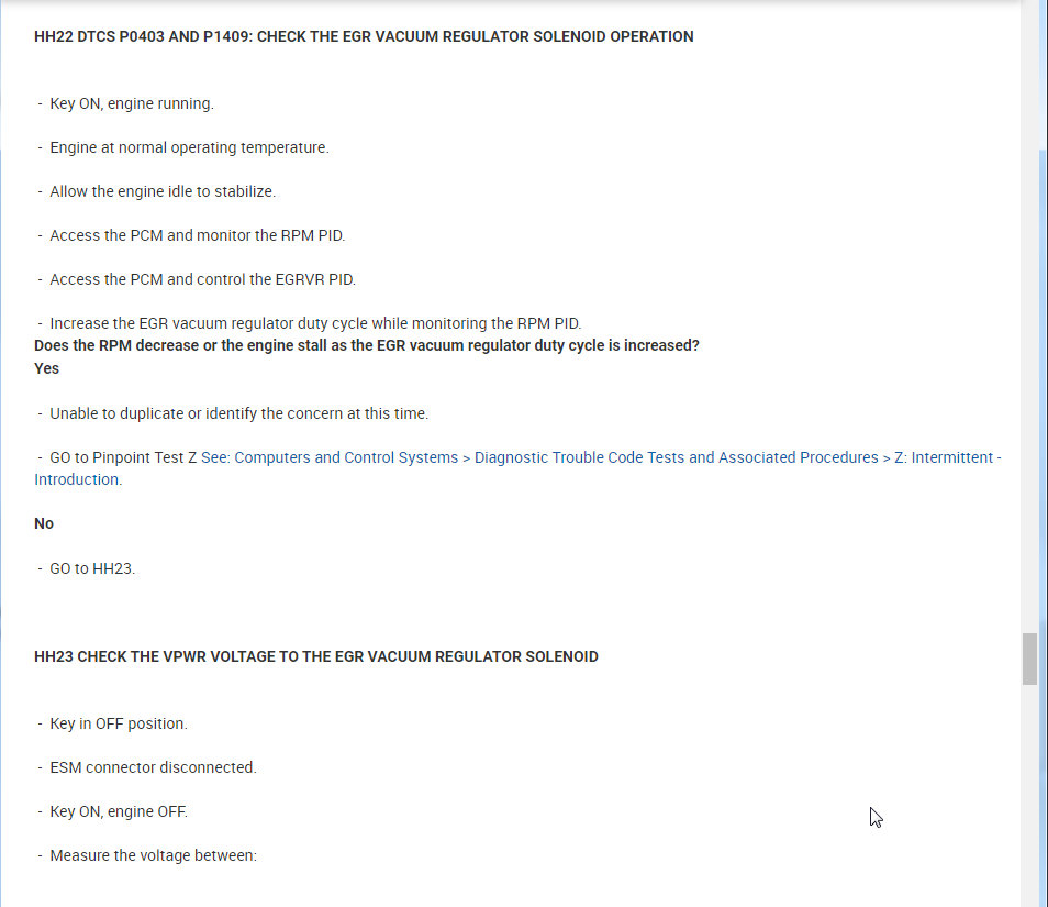

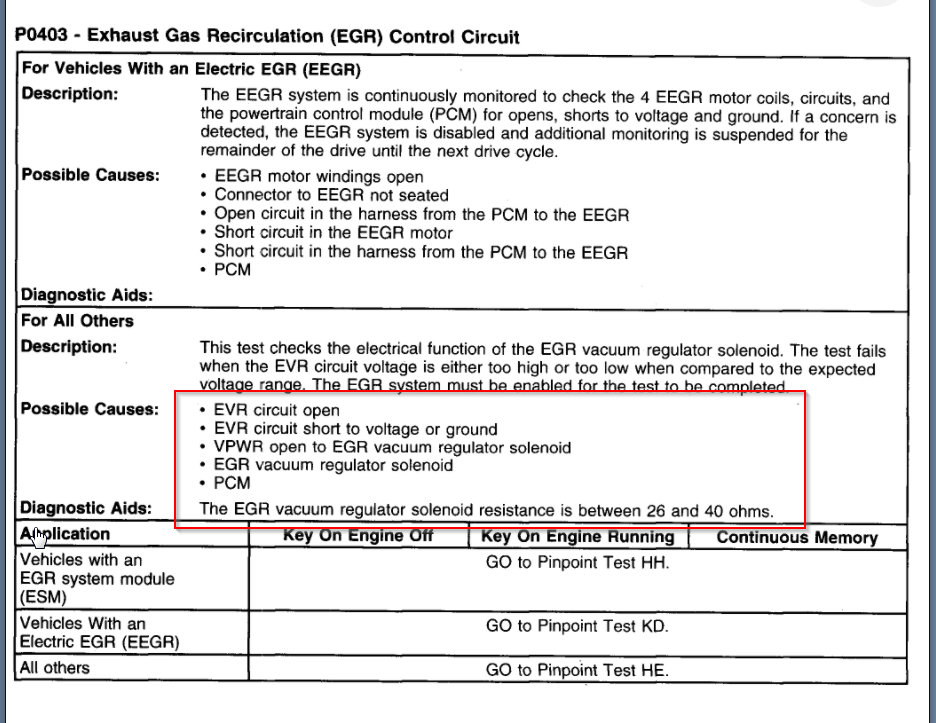

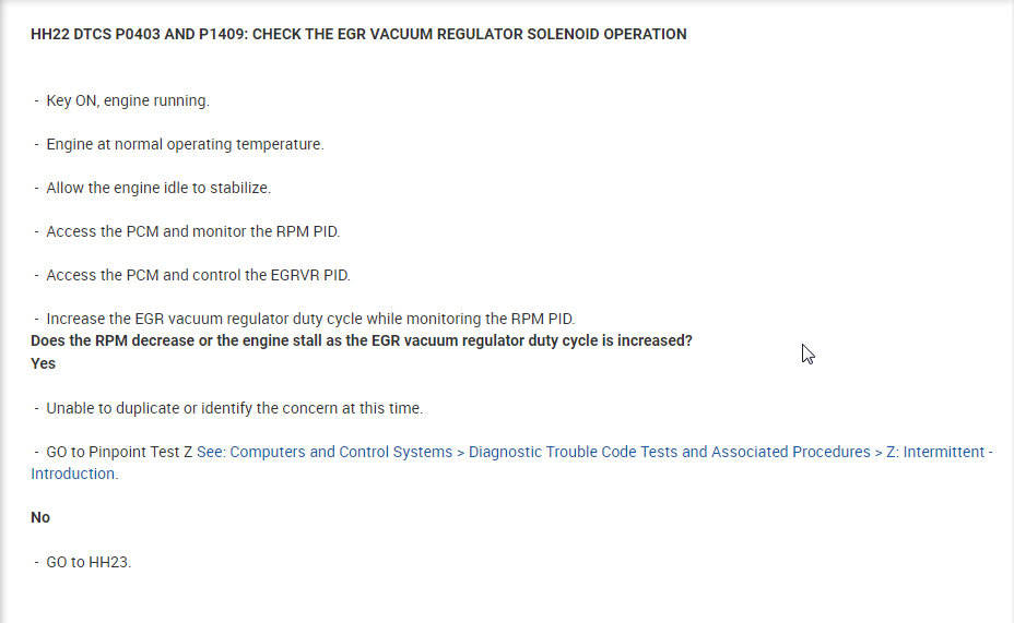

For P0403 you start at HH22. This is asking you to check the operation of the EGR by using a scan tool. You don't have one so let's assume it does not stall when you perform this test because if it does then the issue is not present at this time so let's assume it is currently broken so it would answer this question as "No" and you go to HH23.

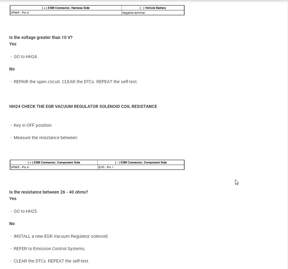

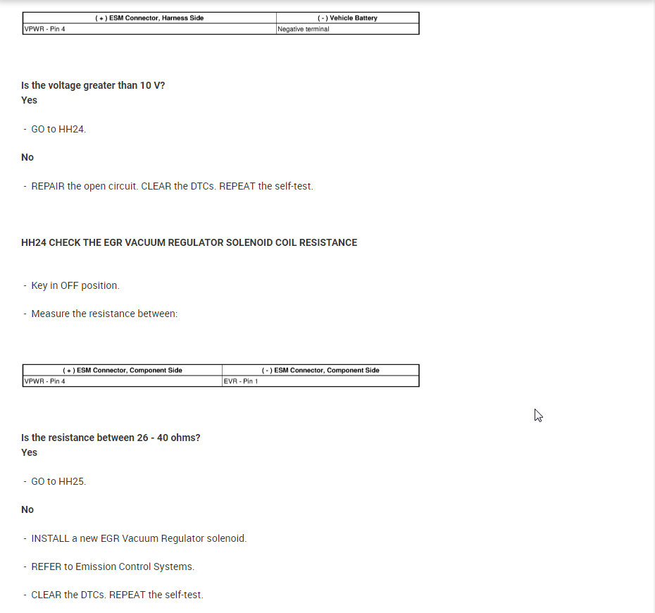

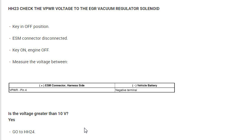

HH23 is asking you to check voltage from the EGR module (ESM) for voltage and based on your reading of 12 volts, you would answer yes that it is greater then 10v. Go to HH24

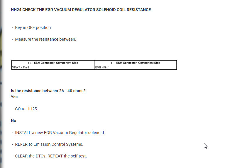

HH24 needs you to check the EGR coil and you do this by disconnecting the connector and measure resistance between pin 4 and pin 1. What is the resistance reading? Is it between 26-40 ohms? If it is not then you replace the EGR vacuum regulator solenoid. Let's assume it is and you go to HH25

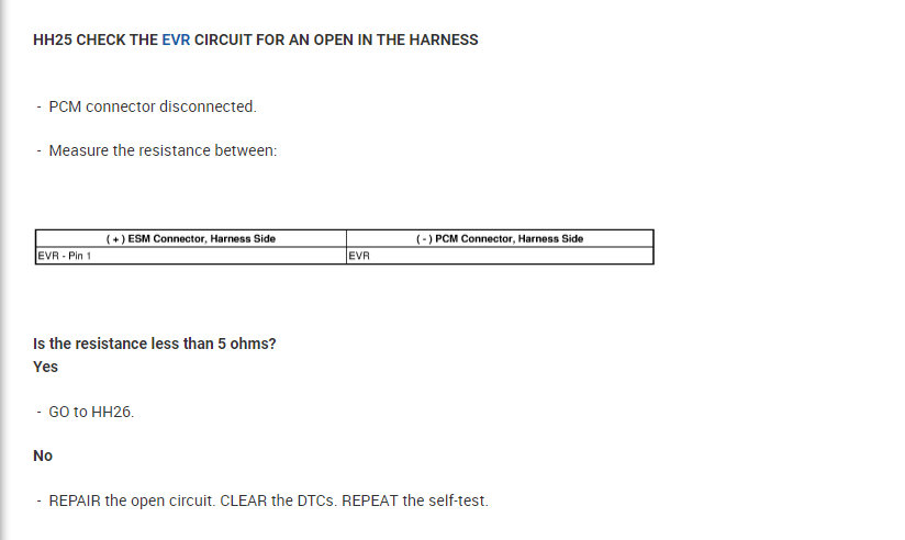

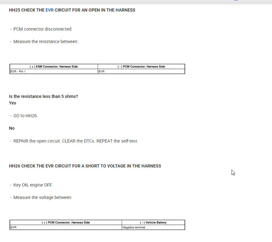

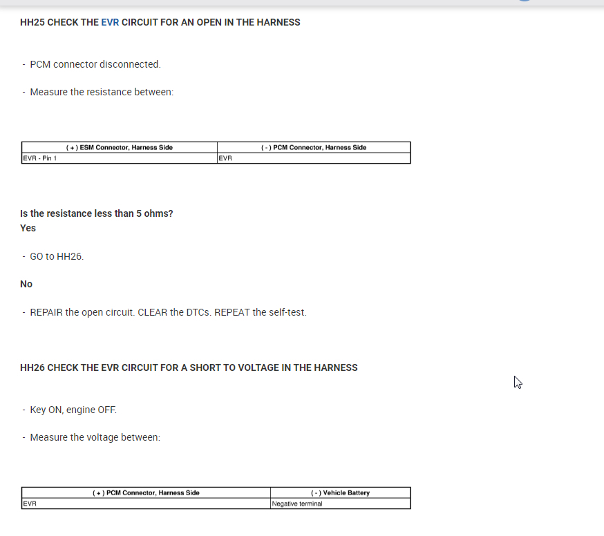

HH25 is asking you to check the harness for an open circuit. You need to disconnect the EGR Solenoid and the PCM and check resistance on that wire. The chart shows where to put your leads but basically you need to be on both ends of the wire. Let's assume it is less then 5 ohms. If not you have an open or high resistance and need to repair that wire.

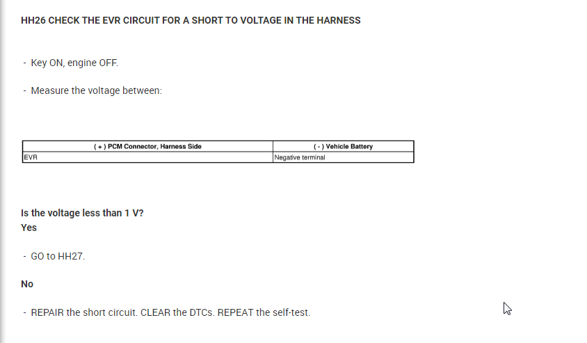

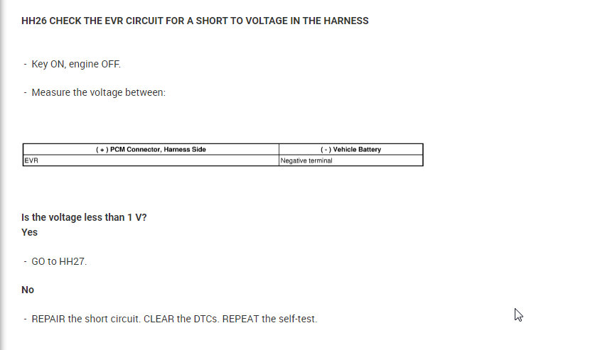

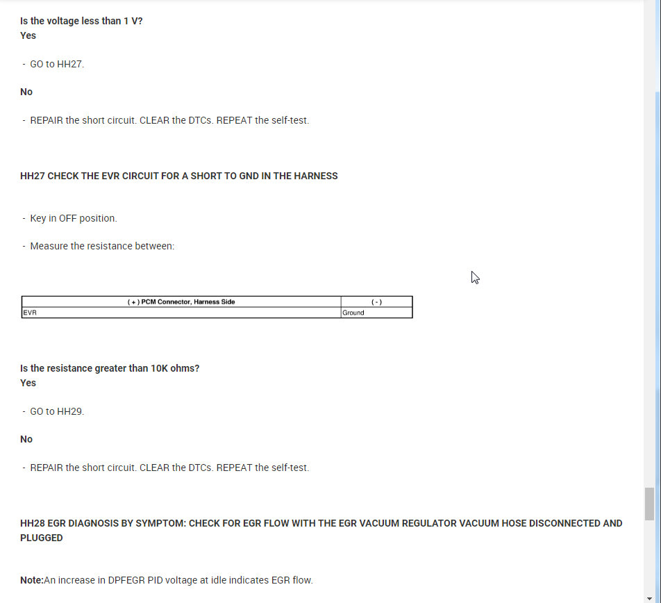

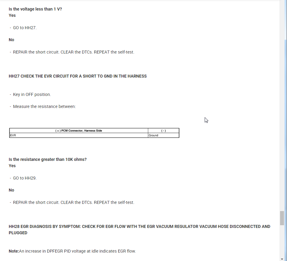

HH26 is asking to check the harness for a short to voltage. Put the leads as it says in the chart. Repair the wire if there is more the 1 volt on it.

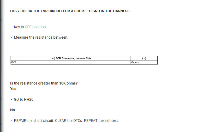

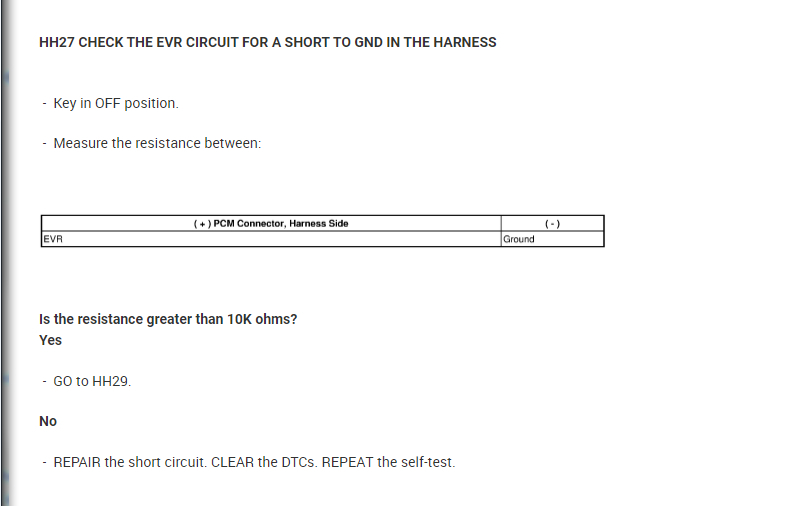

HH27 is asking to test for a short to ground. Again put your leads where it asks and do you have more then 10k ohms of resistance? If yes, then you have no continuity to ground which is good. If you do then you need to repair that wire. Proceed to HH29 if it passed.

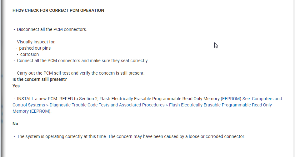

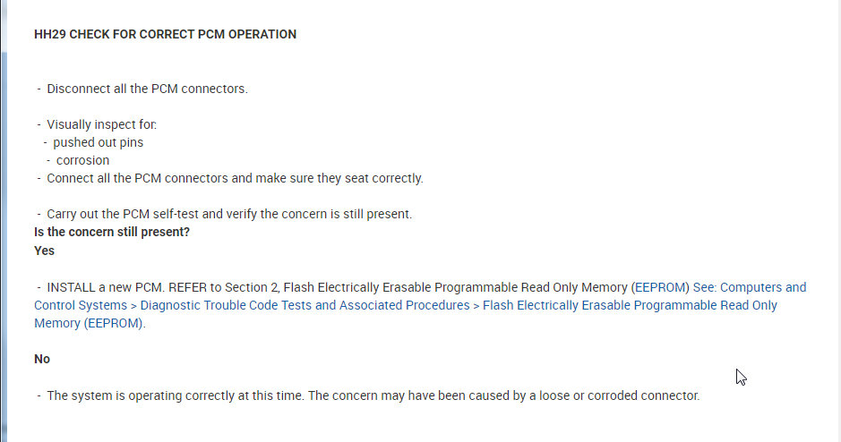

HH29 is telling you to inspect the PCM for any visual issues like corrosion or pin/terminal issues. If not, put a PCM in it.
So this means you could just replace these parts and if that does not fix it you will need to replace the wiring harness.

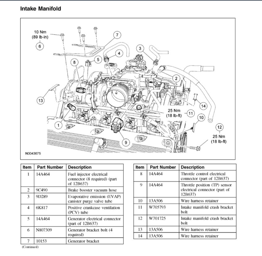

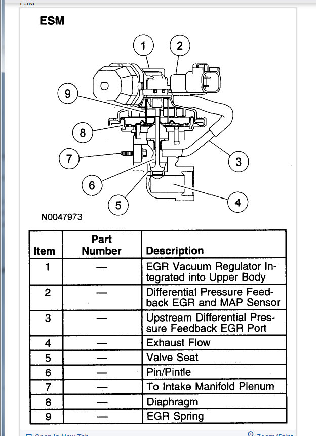

Okay, I still don't think we are on the same page.. I sent you a picture of my EGR Modulator.. It is a 1 piece unit.. There are not separate parts to replace. As your directions are stating in your attachments. I am also having a issue with understanding what these Mean 1. DPFE,
3. ESM, 4. PCM.. I need to understand what they are before i can Check them.. It sure make it easier for me to understand better with a Simple Drawing than me reading all of these attachment. It just gets too Confusing for me to grasp it. I thought i explained that to you in my previous messages. Scholar or a ASE Mechanic. I do appreciate your help. I did do a few test of my own which were, i Blew Air through the vacuum hole and where the filter is on the unit. (air passes through) I also poured Fluid in the Inlet pipe connection hole and it did not leak out. I do have a hand vacuum pump but i don't have the right size hose to do the test at this time to see if the Diaphragm opens or has a leak...I need to look into that...So i can do that test.
Oct 22, 2020 at 9:21 PM

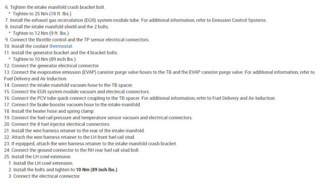

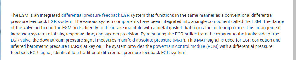

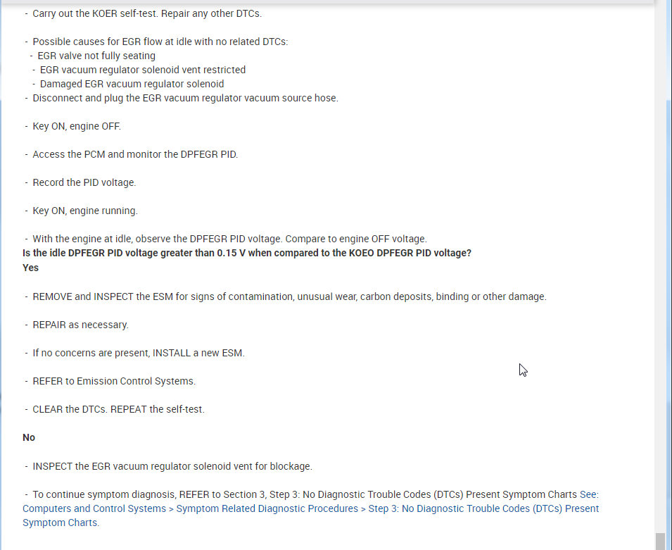

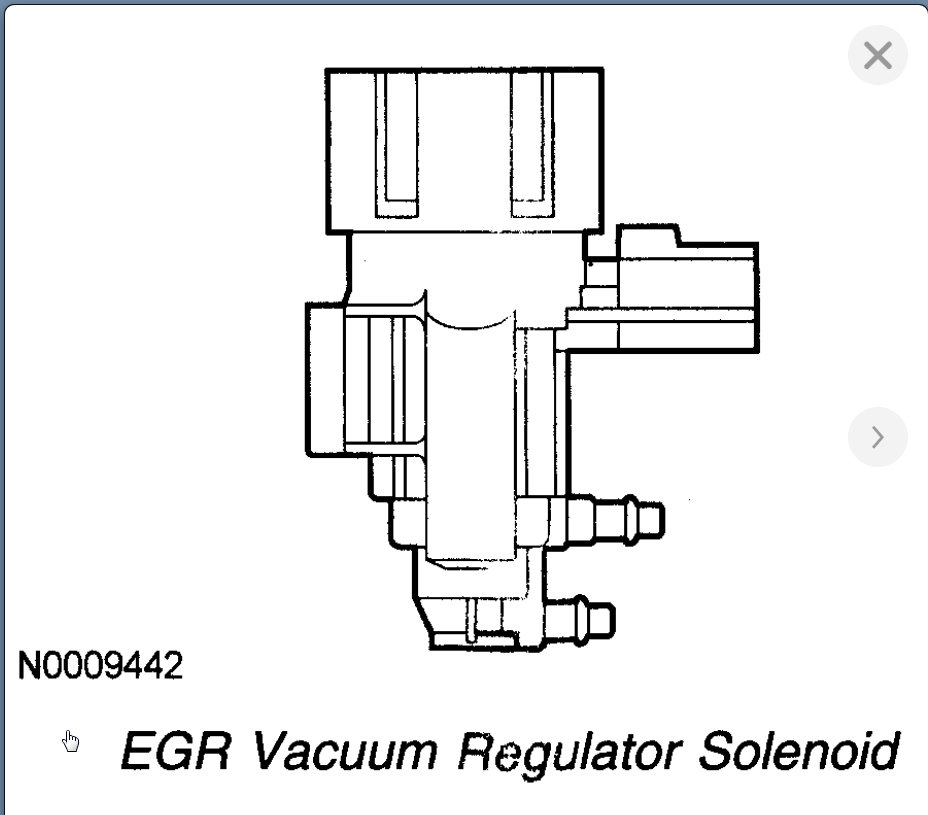

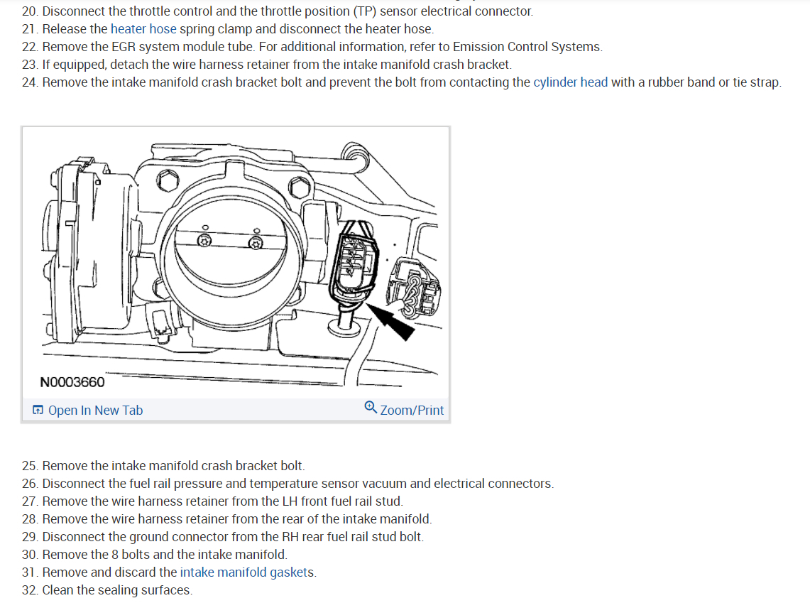

As I said in my response, ESM means EGR System Module. It is the assembly that you showed prior and what I attached below. Also, DPFE is part of this assembly and detailed in the attachment. So if you replaced this years ago and just replaced it again and the codes are still there, then we have one of the other issues.
I understand it is frustrating that I can't just tell you what to replace but unfortunately we need to go through the testing to know for sure what the issue is. Otherwise we can just start replacing parts and hope one of them fixes it. This gets expensive and even more frustrating. You are attempting to perform pretty heavy diagnostic work and I understand you are not a mechanic but that is just going to complicate things as there is not a basic level of understanding that is needed to do this heavy of diagnostic work.

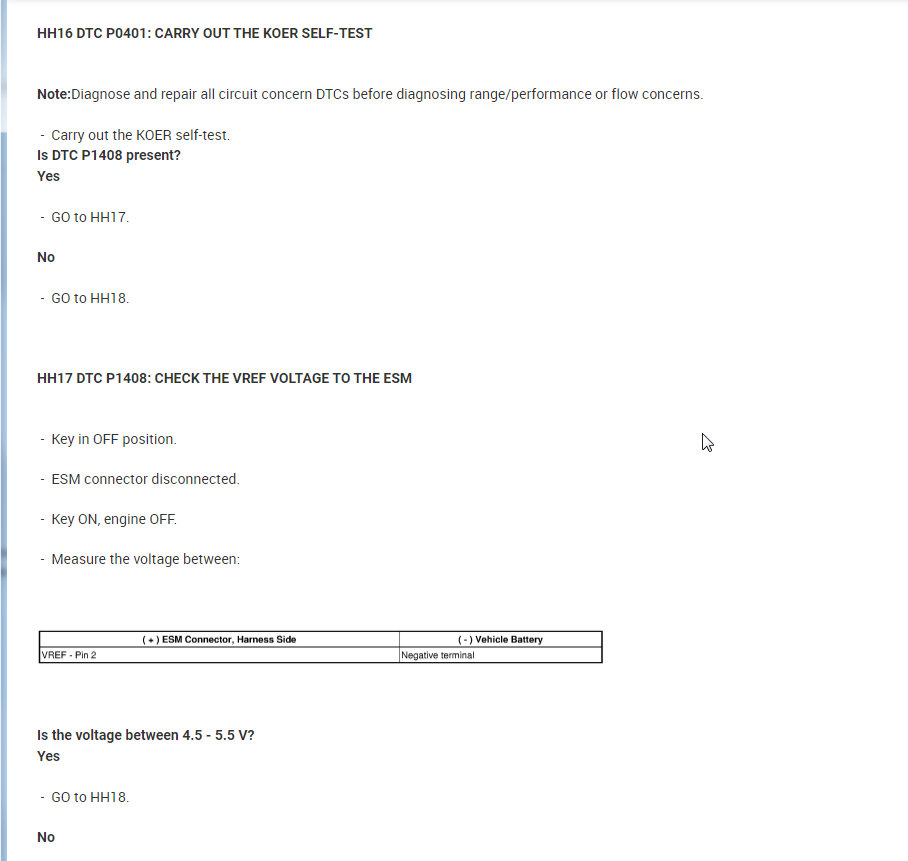

However, let's try to simply this, if you have replaced the ESM and the codes are still there, I suspect the P0403 is the cause of this. Take a look at the third attachment. This lists the possible causes of this code. As you can see it is saying the wiring is the issue or the EGR solenoid, which is part of what you replaced, and finally a PCM (Powertrain Control Module).
This means we need to perform the wiring testing that I attached in those documents and spelled out in my response.
So we need to start at HH 22. Let's assume it passed. Go to HH23. Your reading you told me for that was 12 volts. That passes so we go to HH24. You need to take this reading. Take a look at attachment 4 of this post. You need to measure resistance between pin 1 and 4 of the connector of the ESM. So disconnect that connector and use the diagram of the connector (attachment 5) to check the resistance. What is this number from your meter?
Once we know the result here we can take the next step.
