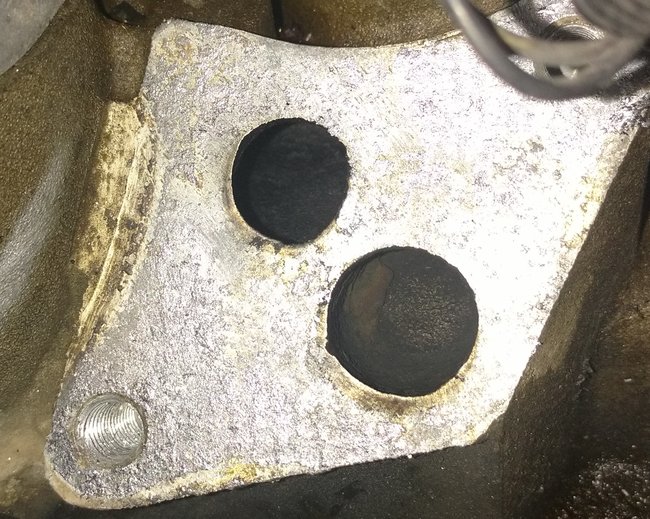

your issue is not in the throttle body at all. it is the exhaust as I stated. you need to clean the passage from where the EGR is mounted to the exhaust manifold.
Mar 29, 2018 at 7:05 AM
TMINER
  • 49 POSTS
Okay. I am cleaning both ports where the EGR mounts to. My speedo cable isn't going far into the passage yet. I do see some black coming out though.
Mar 29, 2018 at 7:08 AM
ok
Mar 29, 2018 at 7:20 AM
TMINER
  • 49 POSTS
After I cleaned the ports as best I could, I blew air through both ports and ran the engine. I didn't test drive it yet but will tomorrow. It now sounds like it has a slight knock. Should I change the oil soon if it isn't just low?

It doesn't fall flat on it's face anymore but does still shake at stop signs and when accelerating at different spots. I did have a squeak that was in a pattern when starting up the truck and until the engine was hot like a pulley noise or something. Never heard it before. Once I drove the truck some just now it went away. Maybe just an oil change will help? I did put a little Sea Foam in the oil too.
The SEL is flashing again even though it is running much better. I will have them reset codes when I buy oil and a filter.

I made a mistake which caused the massive knock.
I now still have a knock and it is not all the time, but biggest problem now is when truck is in park or gear when stopped and engine is warm the rpm will fluctuate from 500-800 then smooth out back and forth. When engine rpm goes down to 500 the knock is worse then the knock gets a lot quieter when rpm evens out. Do you think a bad EGR valve or a messed up gasket could cause this? The truck also has a vibration when in park or gear still.
Apr 23, 2018 at 8:04 AM
No, the EGR would not cause the knock unless you knocked a piece of carbon into a cylinder from the intake system.
Yes, if you have a bad gasket it would cause the rough idle.
