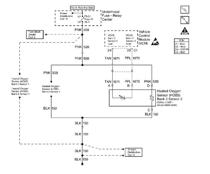

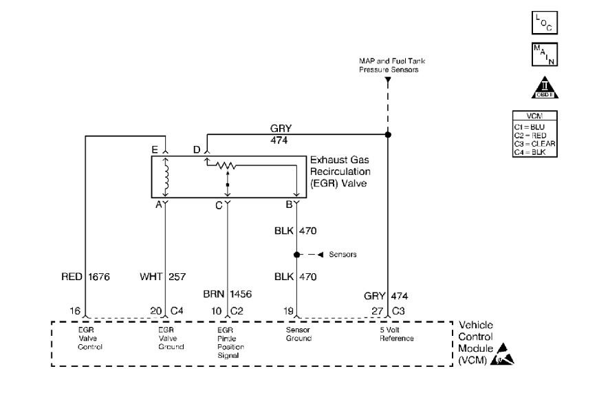

I have a K2500, I can pinpoint exactly when it started other than a couple of weeks ago. I keep getting code P0160 and P0401. I have replaced the EGR valve once and the O2 sensor three times. On a scanner the EGR opens and closes (at least it moves) when taken from zero to 100 percent. I get no other codes and this first happened after about six miles and the last time I reset the codes it lasted for twenty six miles.

Good morning,
The 160 code is related to the O2 sensor but more to wiring than the sensor.
The 401 is for the EGR. I would make sure the passages are clear of any debris. That is the most common failure for this code.
Circuit Description
The heated oxygen sensor (HO2S) is a sensor designed to create a voltage relative to the oxygen content in the engine exhaust stream. The control module supplies the HO2S with signal high and low circuits. Ignition voltage and ground are supplied to the HO2S heater by independent circuits. The oxygen content of the exhaust indicates when the engine is operating lean or rich. When the HO2S detects that the engine is operating rich, the signal voltage is high, and decreases the signal voltage as the engine runs leaner. This oscillation above and below the bias voltage, sometimes referred to as activity or switching, can be monitored with the HO2S signal voltage.
The HO2S contains a heater that is necessary in order to quickly warm the sensor to operating temperature. The heater also maintains the operating temperature during extended idle conditions. The HO2S needs to be at a high temperature in order to produce a voltage. When the HO2S reaches operating temperature, the control module monitors the HO2S bias, or reference, voltage. It also monitors the HO2S signal voltage for Closed Loop fuel control. During normal Closed Loop fuel control operation, the control module will add fuel, or enrich the mixture, when the HO2S detects a lean exhaust content. The control module will subtract fuel, or "lean-out" the mixture, when the HO2S detects a rich exhaust condition.
Certain vehicle models utilize an oxygen sensor behind the catalytic converter in order to monitor catalyst efficiency.
This diagnostic trouble code (DTC) determines if the HO2S is functioning properly. It checks for an adequate number of HO2S voltage transitions above and below the bias range of 300-600 mV. This DTC sets when the vehicle control module (VCM) fails to detect a minimum number of voltage transitions above and below the bias range during the test period. Possible causes of this DTC are:
- An open or a short to voltage on either the HO2S signal or HO2S low circuits.
- A malfunctioning HO2S.
- A problem in the HO2S heater or its circuit.
- A faulty HO2S ground.
This DTC determines if the HO2S is functioning properly by checking for an adequate number of HO2S voltage transitions above and below the bias range of 300-600 mV. This DTC sets when the VCM fails to detect a minimum number of voltage transitions above and below the bias range during the test period. Possible causes of this DTC are listed below.
- An open circuit or a short to voltage on either the HO2S signal or HO2S low circuits.
- A poor HO2S ground.

401
Circuit Description
An exhaust gas recirculation (EGR) system is used in order to lower oxides of nitrogen (NOx) emission levels caused by high combustion temperatures. The EGR accomplishes this by feeding small amounts of exhaust gases back into the combustion chamber. When the air/fuel mixture is diluted with the exhaust gases, combustion temperatures are reduced.
A linear EGR valve is used on this system. The linear EGR valve is designed in order to accurately supply exhaust gases to the engine without the use of intake manifold vacuum. The valve controls exhaust flow going into the intake manifold from the exhaust manifold through an orifice with a control module controlled pintle valve. The control module commands the EGR by applying a 12 volt duty cycle to the EGR valve. This can be monitored on a scan tool as desired EGR position.
The control module can monitor the pintle position with the EGR pintle position signal. This sensor uses a variable resistor with a 5 volt reference, a signal circuit, and a ground. The signal circuit monitors changes in voltage on the variable resistor as the pintle moves.
The VCM tests the EGR system during deceleration by momentarily commanding the EGR valve open. The pressure in the intake manifold increases when the EGR valve is open. The VCM monitors the Manifold Absolute Pressure (MAP) sensor signal during the EGR system diagnostic in order to determine the amount of EGR flow. The MAP sensor will detect an increase in manifold pressure as the EGR is cycled ON. If the amount of manifold pressure observed is less than expected by the VCM, a DTC P0401 will be set.
